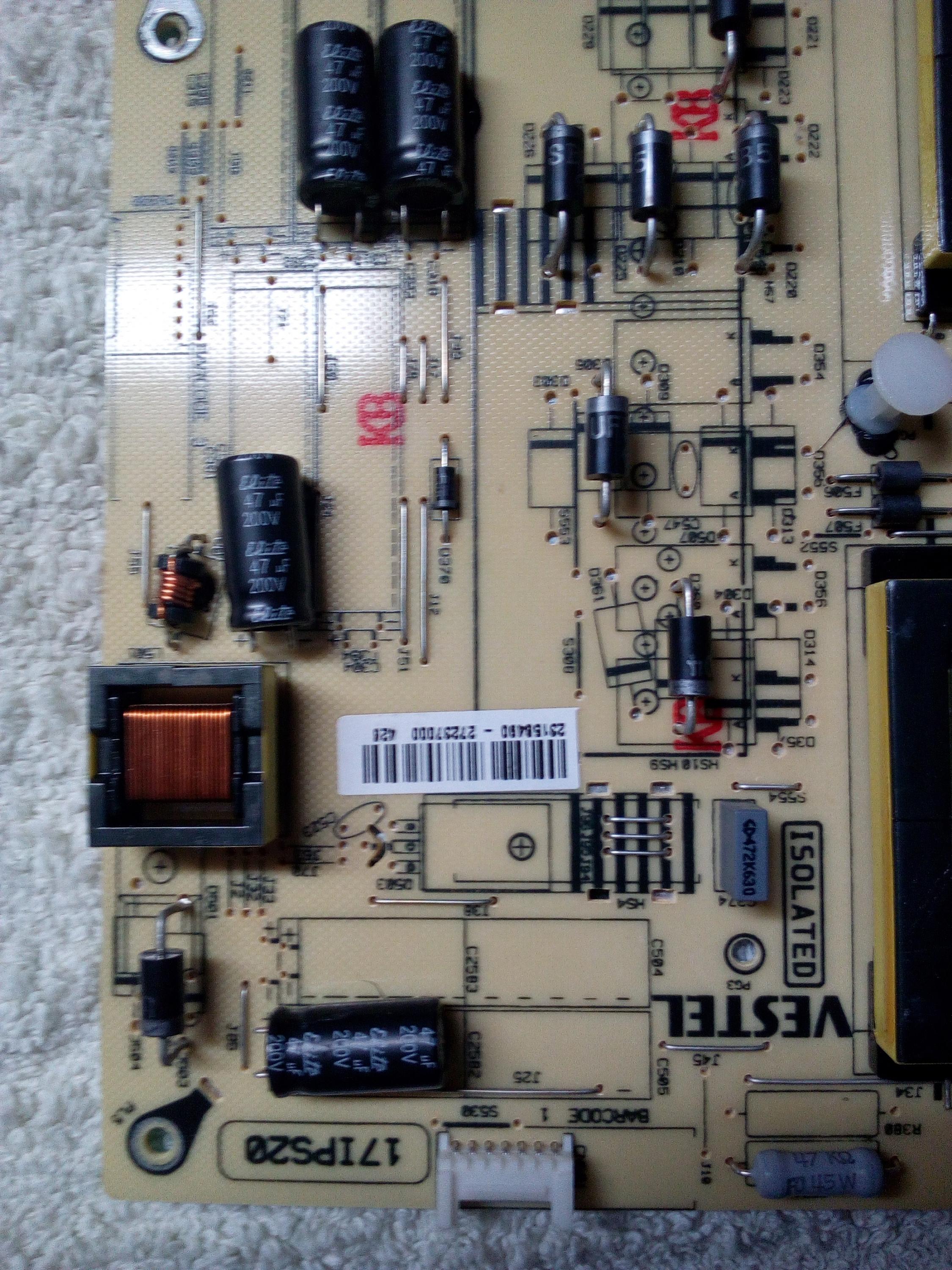

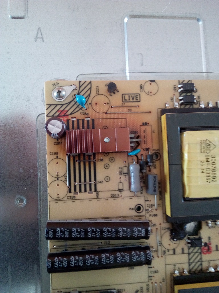

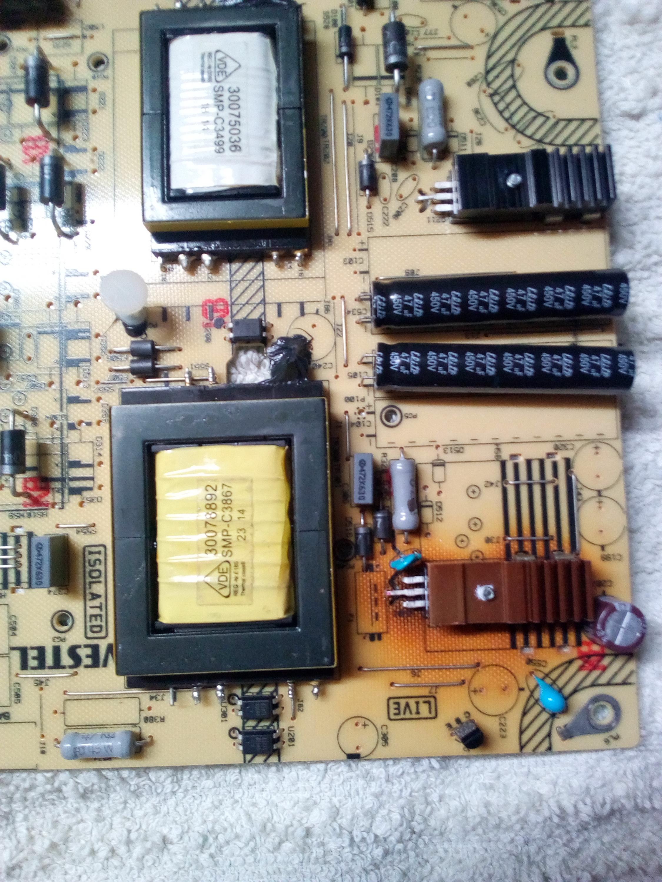

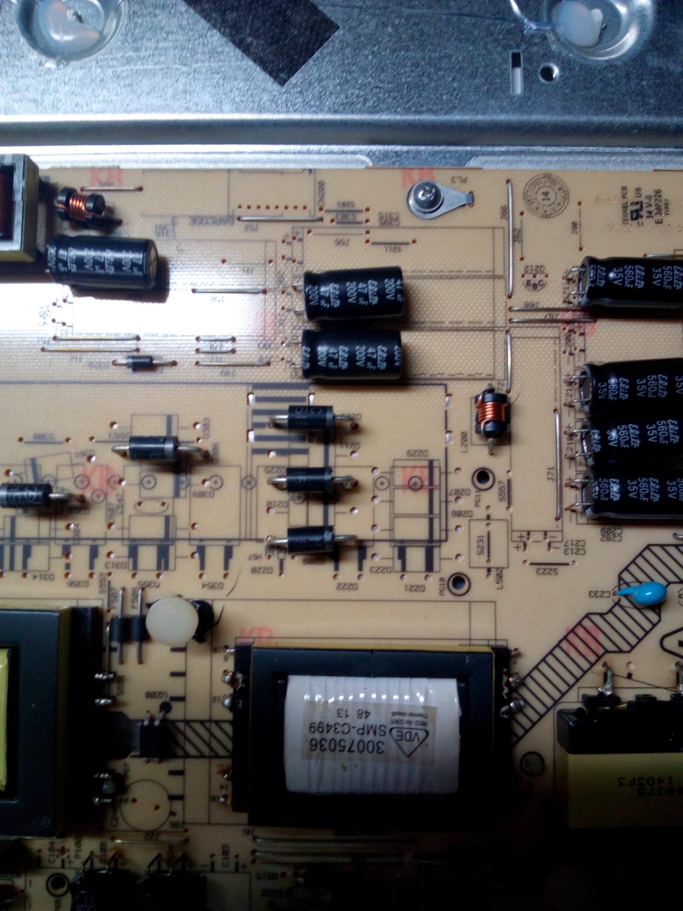

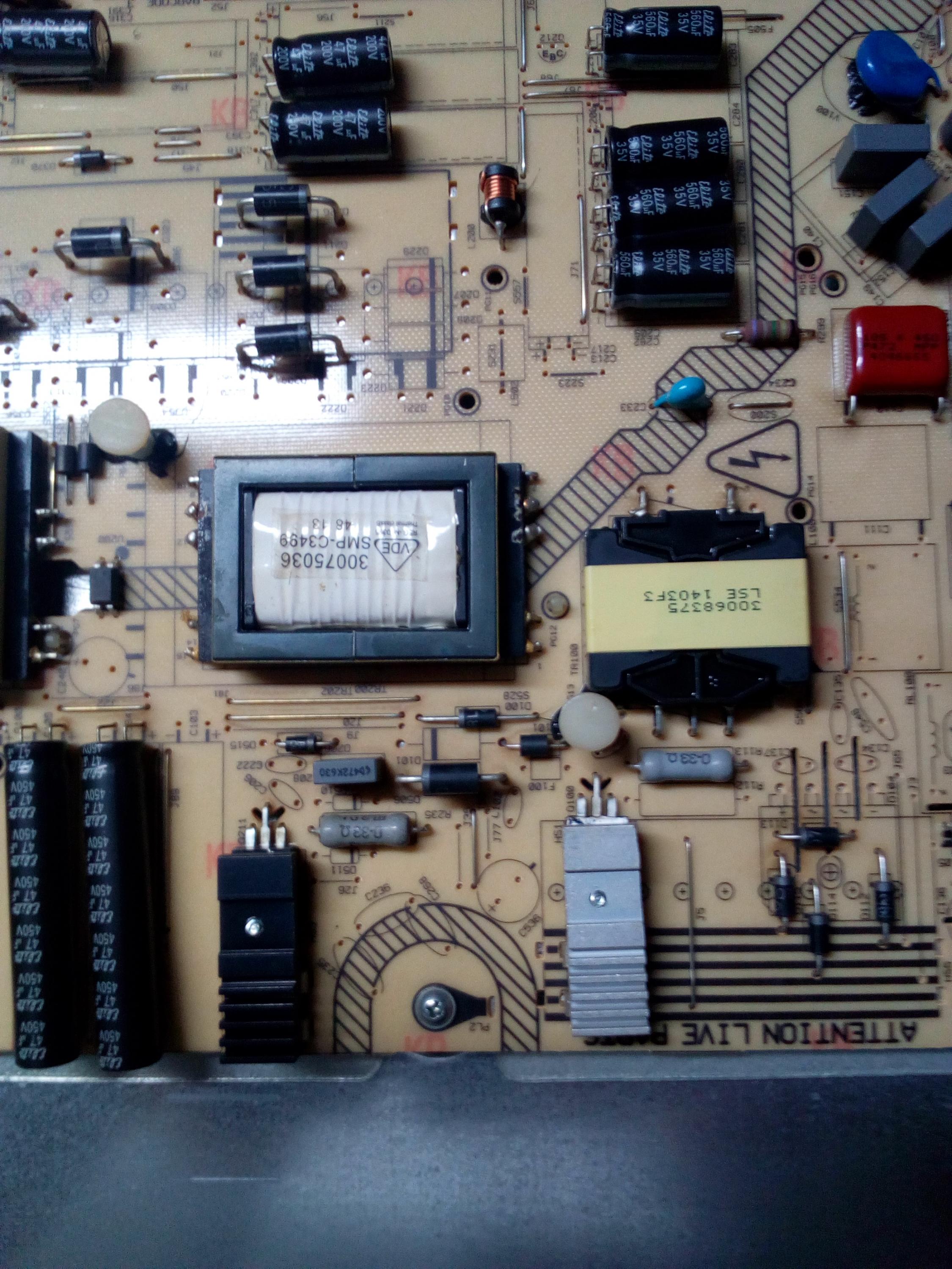

          Hello

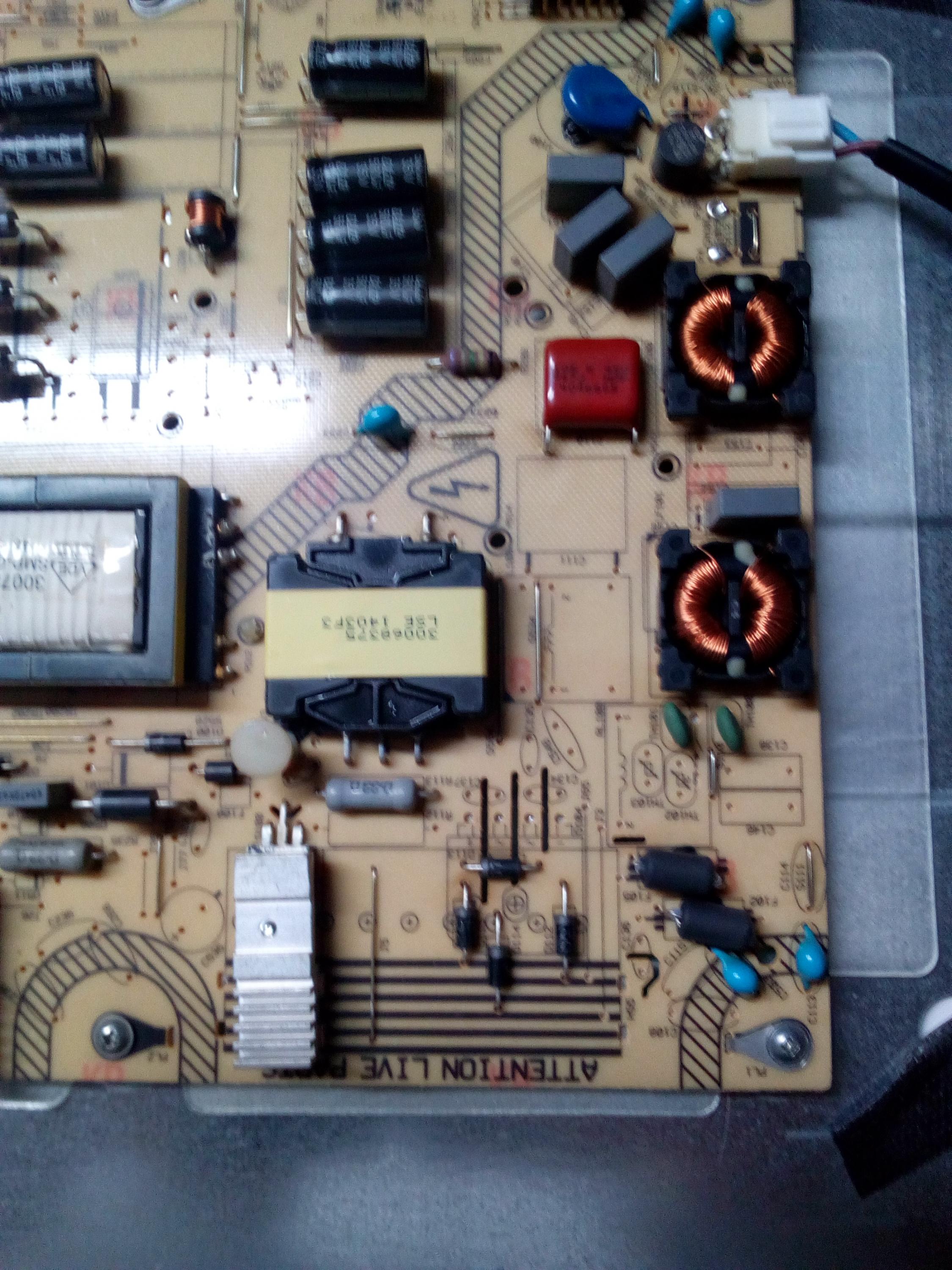

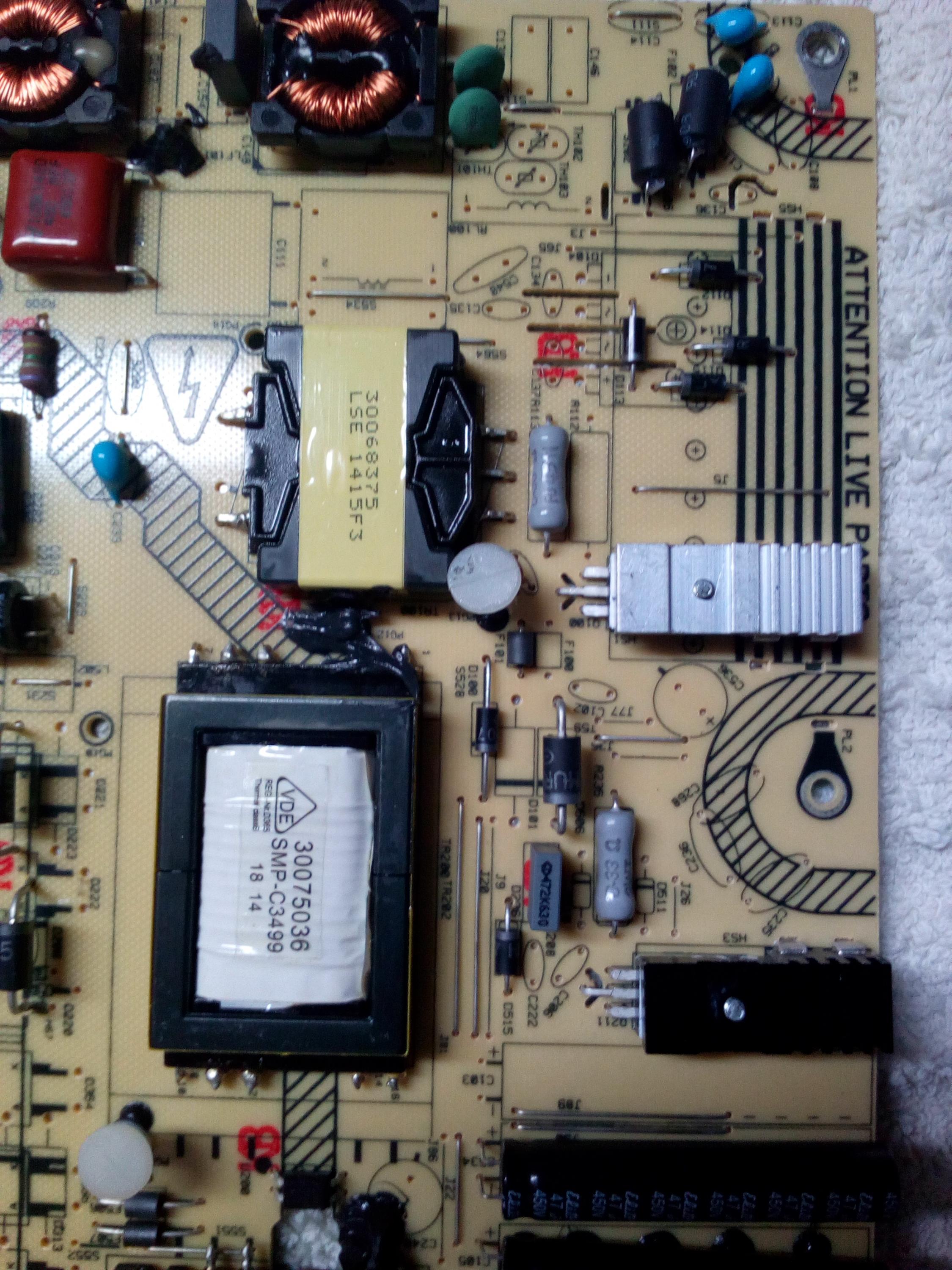

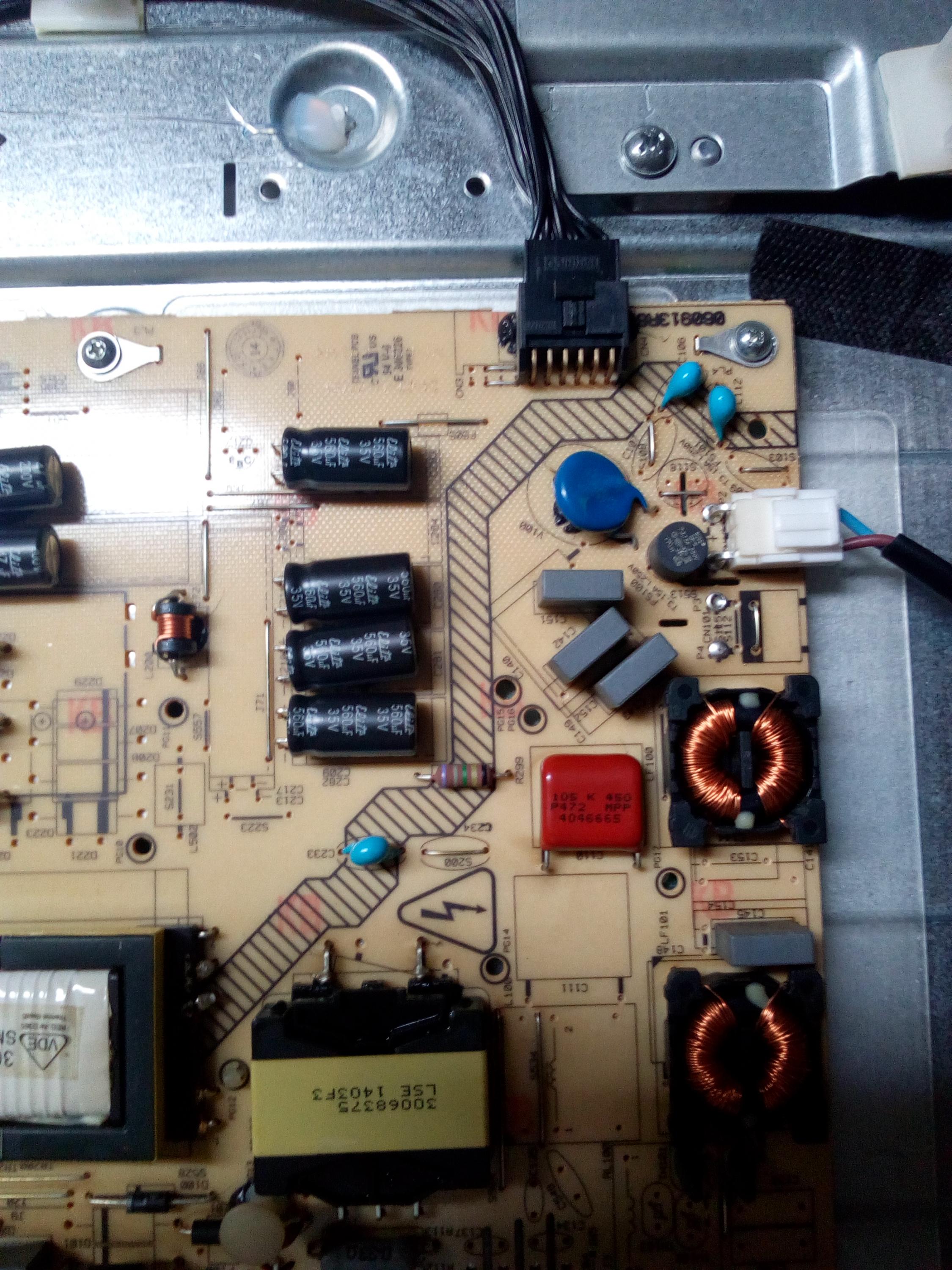

          Not anything at all, when the indicator goes green, there is not even a quarter of a second or the screen turns on ... desperately black.
          I opened the TV and I attach some photos
          Thank you again for your help
          Jerome
          • yohnsee
            Semi-noob
            • Dec 2017
            • 198
            • Hungary
            Re: Toshiba 40L3433DG blinking red/green power indicator
            Ok, now you will need a multimeter to measure voltages, and a lot of patience. And I shouldn't mention, but be very careful, as the upcoming measures will be with the power turned on, so don't touch anything on the mains side.
            First, please measure the DC voltage between the 2 legs of one capacitor, seen on your 3. photo (Elite, 47uF, 450V) I write it because I can't see the position numbers. Once again, be very careful, this should be around 390-400V DC.
            Please take a measurement in standby, and also in switched on state.
            After this, put the negative (black) probe of your multimeter on the metal plate of the display. With the red one, measure the pins that are connected with a cable between the power supply and the main board. Also do this twice, once in standby, once powered on.
            Write down here please the results.
            Cheers, Janos

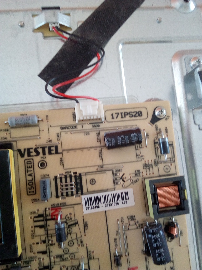

              Hello

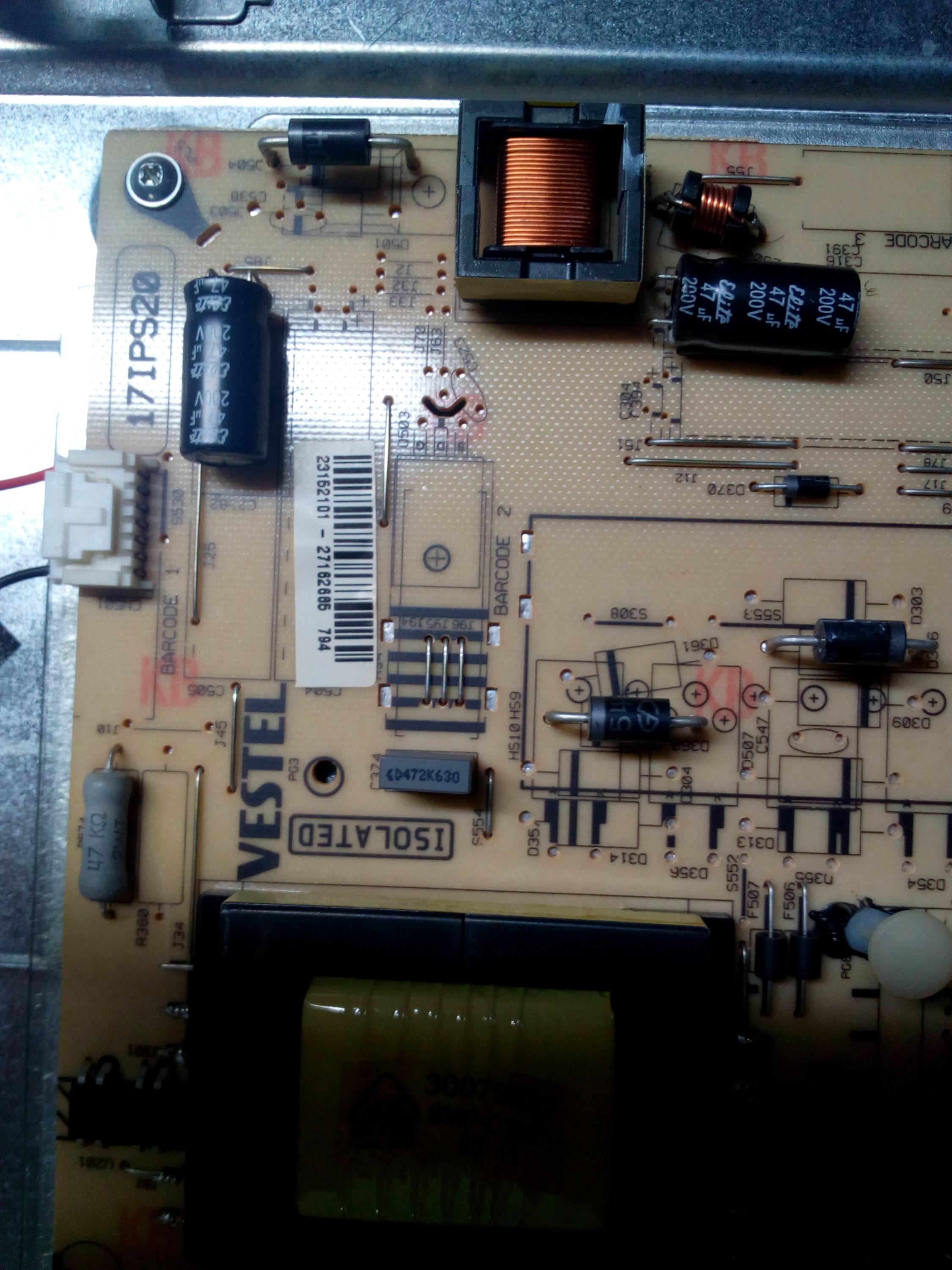

              Thank you for your help . I just discovered that the transistor Q301 is short ciruit between these two outer tabs, control welded and unsoldered.
              The current transistor in place is a FQPF7N80C whereas on the diagram shows that it is normally a FQPF8N60C ..
              The platinum is a 17IPS20
              What should I do, back a new with the same reference or the one shown on the diagram that may not be my tv
              thank you for your help
                If you repair a few Vestel pcbs, you will see that a lot of thing are different on their schematic and on their real boards.
                Schematic has FQPF8N60C, that is a 600V 7.5A FET, while FQPF7N80C is a 800V 6.6A one. Both suits the job, I think factory went with 7N80C because it was cheaper. Or has greater safety margin in voltage.
                Anyway, if you already soldered it out, and it tested short this way, then you should change it. But you should test first, if no other components went also wrong. Also, if you have an oscilloscope, you can probe the output of the SMPS chip, if it gives a good pwm signal to control the FET.
                On the schematic, there is a relay. Is it also on your PCB? Does it click? Or did it click, before desoldering this FET?
                Cheers, Janos

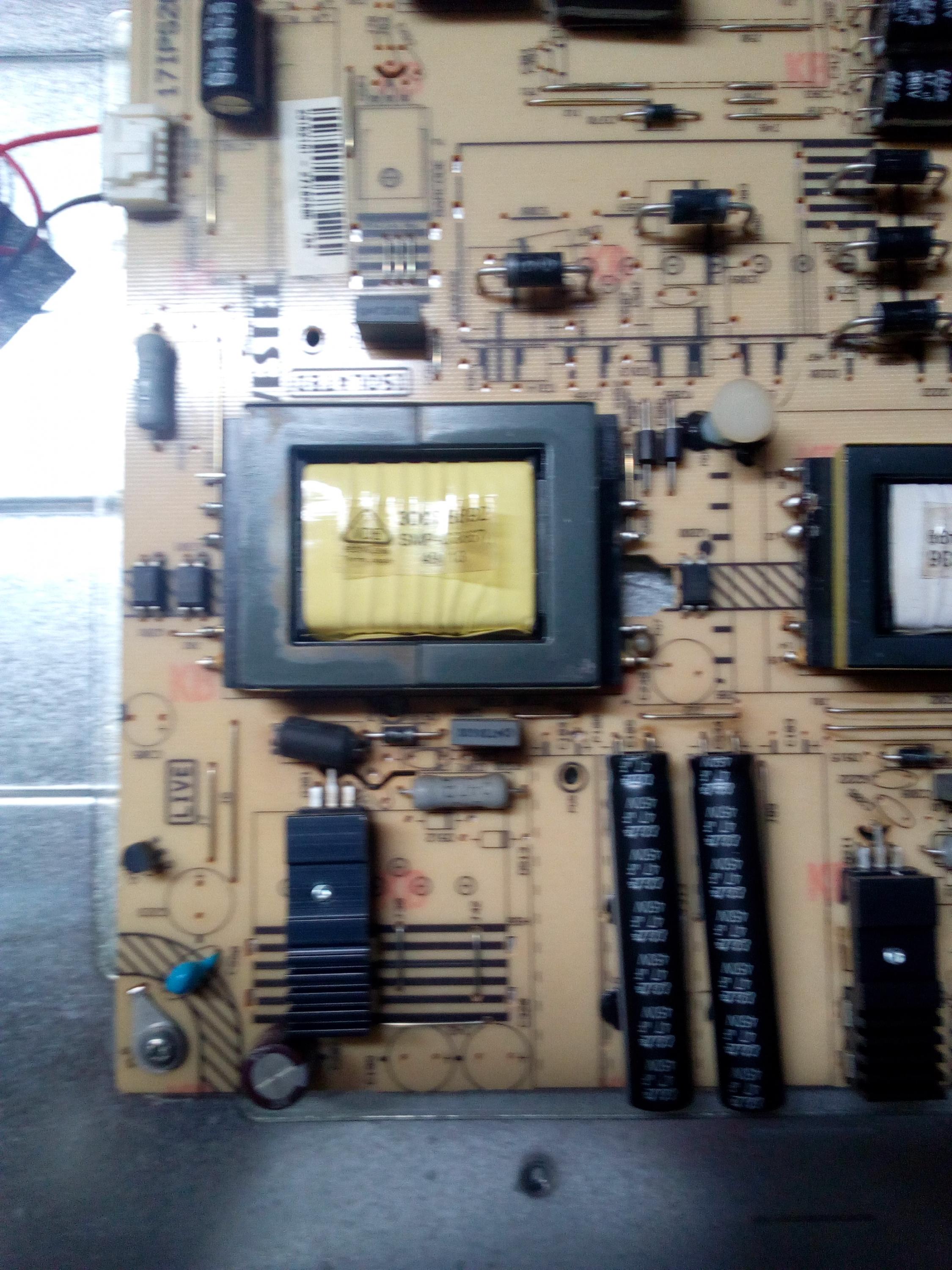

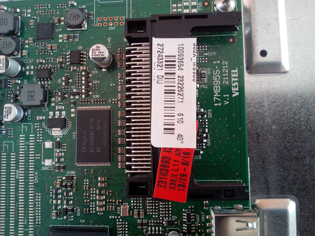

                        can you post clear pictures of the new board? I am interested in the connection headers. Maybe the problem lies there. But also take it into the list, that maybe the defective power supply has damaged the mainboard.
                        Cheers, Janos

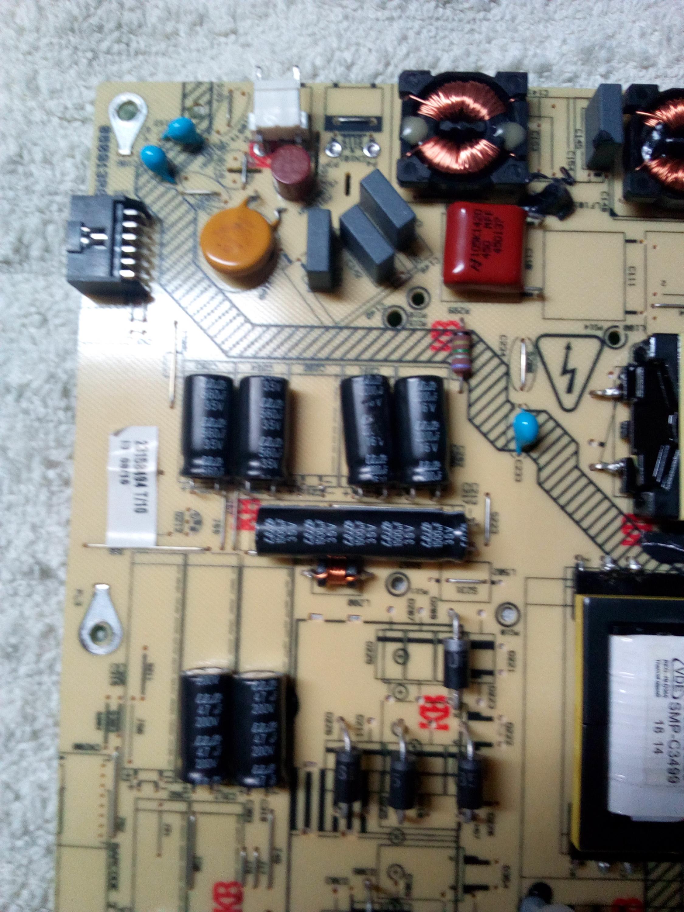

                          Good evening
                          Find attached photos of the old TV power ... the first 4 photos ... the next 6 correspond to the new food purchased on the internet. You will see that both cards are 17ips20 060913R6, but the barcode labels stuck on the cards are different. You will also see that the components around the transitor changed are different (one less diode and one self more)
                          When turning on the tv the voltage on the connector feeding the leds is 116 v, then fall after a few seconds ... test realized by having disconnected the connection cable between the motherboard and the tcon ...
                          cordially
                          Jerome
                          • yohnsee
                            Semi-noob
                            • Dec 2017
                            • 198
                            • Hungary
                            then you need to test the power board first. Disconnect the main board from it, but keep the backlight connected. Now be very careful, you need to measure the voltages. First, find the standby voltage. Should be 5V, and it must be there, regardless the set is off. If it is OK, then grab 2 resistors, 100-1000 ohm is ok, value is not critical. Now, connect one leg of resistor to standby voltage, the other to Pin3 of the black connector. Now you started the power board without mainboard. Now measure, do you have 12V on the connector pin10, 11 or 12.
                            If yes, then only one more step on this testing. Grab the other resistor, connect one of its legs to 5V like before, the other leg to pin5 on connector. This should light up the backlight LEDs. If so, then your power supply is OK, you will have problem(s) on the mainboard.
                            Cheers, Janos
