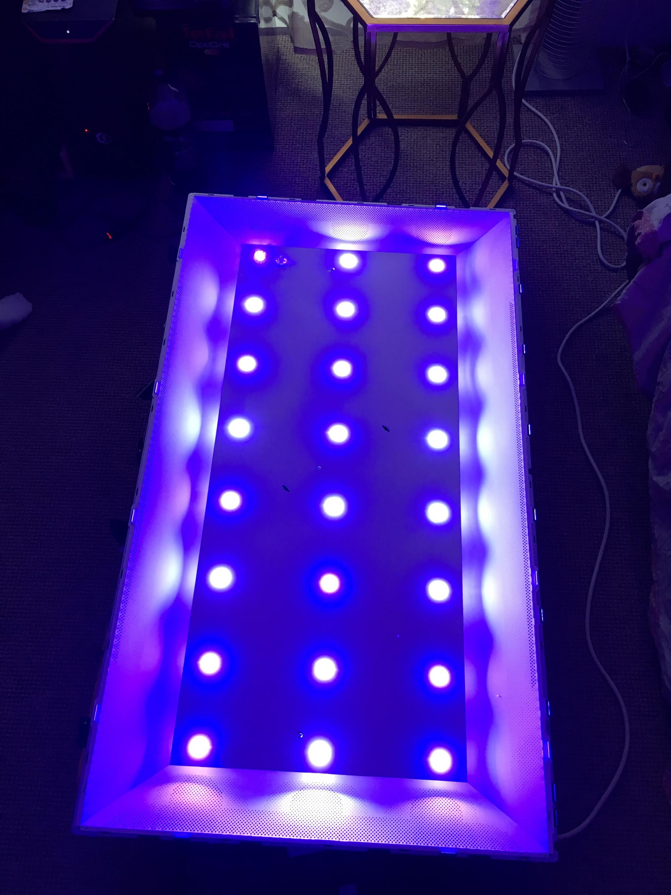

    Lg 43uh610v
    This tv have a blue tint colour on the background. I dissasambled the panel and most part of leds have blue light. Only few leds in the middle of the panel has white colour. Is 3 rows with 8 leds each. The power supply for backlight is 77v/600mA. I checked and I had 76.5v , backlight 100 on settings.
    Could be power supply faulty, or I have to change the leds ?
    Thank you

    Re: Lg 43uh610v
    I recently saw a post similar to this, with the blue/purple light background that turned out to be the backlights were purple. I would replace ALL the backlight strips to the normally used cool white type. You would have to verify if they a3V or 6V LEDs. I think however they may just be the usual 3V type. That will solve your problem before any circuits/component go bad.

        Re: Lg 43uh610v
        It is odd, from what I read, they can turn blue when they get old/worn out.

              Re: Lg 43uh610v
              An overdrive led go blue .

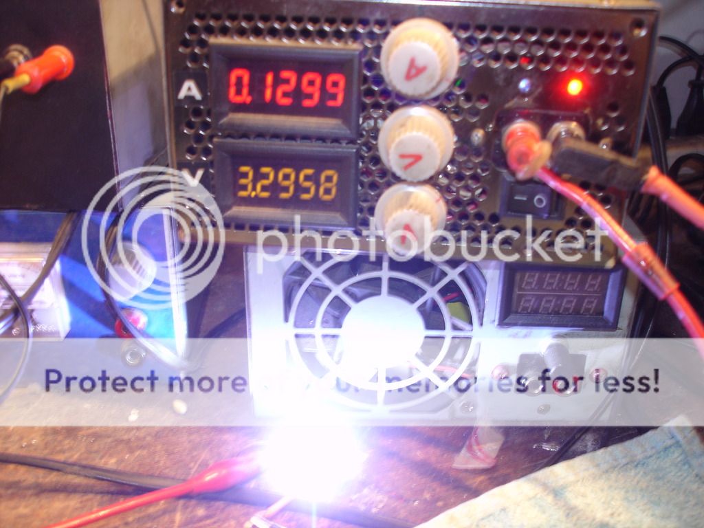

              • tehmatix
                • Nov 2012
                • 180
                Re: Lg 43uh610v
                This backlight is with 1 + 2 row,1 bar with 8 leds in line = 24V, another's two bars 8x3+8x3=48v. I power up first bar with 24v from an external adjustable power supply and is the same thing like with board from tv.
                I order 3 bars from internet.

                            Re: Lg 43uh610v
                            The problem is with the yellow coating on each LED cracking. If youremove the lense you will see that the yellow coating has failed therefore changing the colour of the LED from a white colour. This is happening to all LG Tvsincluding 43” 49” 55” and theworst thing is the LEDS aren’t available only full replacement strips
