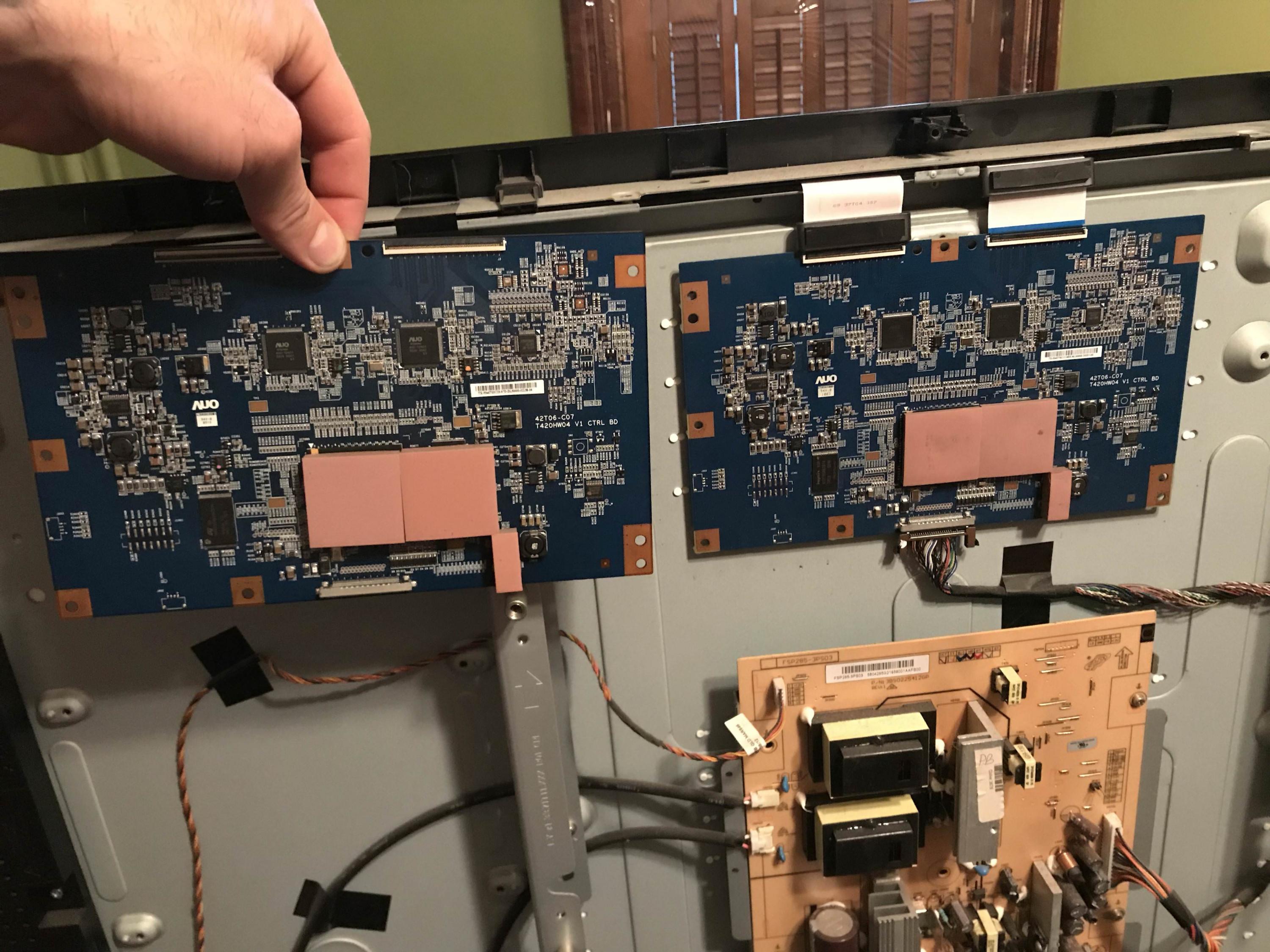

    Was gifted a 46" Insignia LCD TV.
    TV was turn-key okay, except for the solarized image.
    Tested volts at the video gamma tests points and came back with:
    1. 16.02
    2. 15.75
    4. 10.68
    6. 6.68
    8. 6.33
    10. 7.82
    ...etc
    Ordered a used-tested-ok T CON board from China: 42T06-C07 T420HW04 for an easy $30
    Image was washed out (https://imgur.com/a/PmF5HhR) <- Imgur album
    VG points tested at:
    1. 15.20
    2. 15.02
    4. 11.72
    6. 10.47
    8. 9.41
    10. 8.05
    11. 7.85
    12. 7.23
    13. 6.71
    15. 4.77
    17. 3.63
    19. 2.67
    21. 0.63
    22. 0.31
    I'm far from an expert but these seem okay. I did a search here and saw there's common issues with the AS15 chips. I did notice that the chip on the left got far more hot than the chip on the right. I assume this is my problem?
    I've never replaced a chip before and I'm certain I'm not setup for that kind of repair. I'm also assuming I could have someone test the old chip/board and swap the two if that's the issue? Or would it be more cost effective to return the "new" board and just purchase an actual new one from Shop Jimmy?
    This is my first post here and I'm a newbie at all this so please bear with me!

    any straight shot, high resolution pictures to go with this?

      Did you flick open the two connector tabs on the Tcon to re-insert them back in and then flick them back down to lock them in place. Unclear from your photo if they are inserted all the way in.

        There's an Imgur album included in the post. There's not really much more to show other than what I included.
        Yeah, those ribbon connectors are locked properly in place.

          You most likely received a 'bad' T-CON Bd. Another 'working' T-CON Bd. should fix your issue.

                          Re: Insignia NS-L46Q120-10A
                          The PCBA P/N as printed on the bar code sticker matched your original board bar code sticker?
                          Example: http://www.shopjimmy.com/auo-55-46t0...-con-board.htm
                          42T06-C07 T420HW04 V1 is the BLANK circuit board P/N.
                          55.46T03.C23 is PCBA (Printed circuit board assembly) P/N which the board is stuffed with parts for particular LCD panel.
                          The one you bought from EBAY, the seller did not provided the PCBA P/N only the blank board P/N.
                          Blank board can be stuffed to make many different PCBA's.

                              • eatgoodneighborhood
                                • Jun 2018
                                • 8
                                Ah.
                                Old Board: 55*46*T03C23
                                New: 55*42*T6C12
                                So, they specified only for 42" TV's because although the P/N numbers are the same, the PCBA P/N apparently specifies for a 42" TV.
                                So, they clarified it's only for a 42" TV, but I was going off the P/N number's matching, but they did say it's only for 42", so...hmm. I guess we're at an impasse. I'll clarify the situation and politely ask for a refund, if not, I guess I'll just sell the new board on ebay or something.

                                  You were going by matching the blank PCB P/N instead of matching the PCB and PCBA number, that is the key. Live and learn.

                                        Hey, I got this board installed yesterday and all issues are solved. Thanks for this heads up, great price and the TV works now.
                                        Thanks to everyone for their help, this kind of repair is a whole new world to me and gotta say, I'm kind of intrigued. I think I might find another inoperable TV and work on repairing it. Down another rabbit hole I guess...
