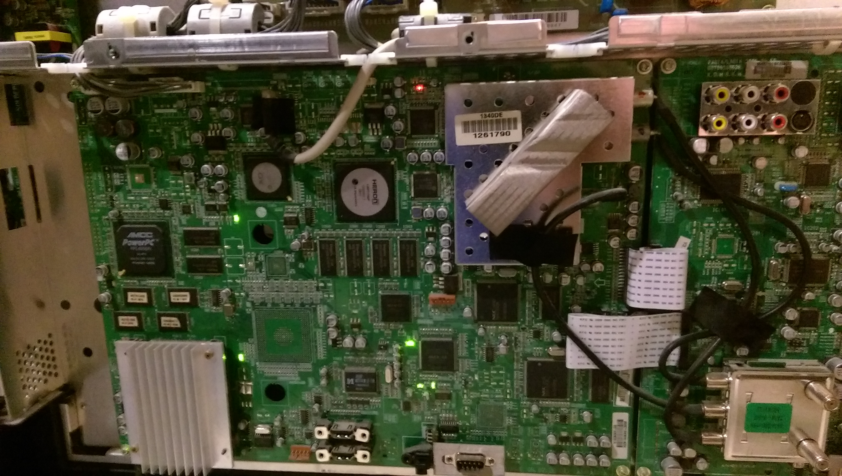

                  All voltages at normal rating! Scoped the Ysus driver and Zsus boards and all signals appear normal. I do however have one red LED on the logic board (all others are green).

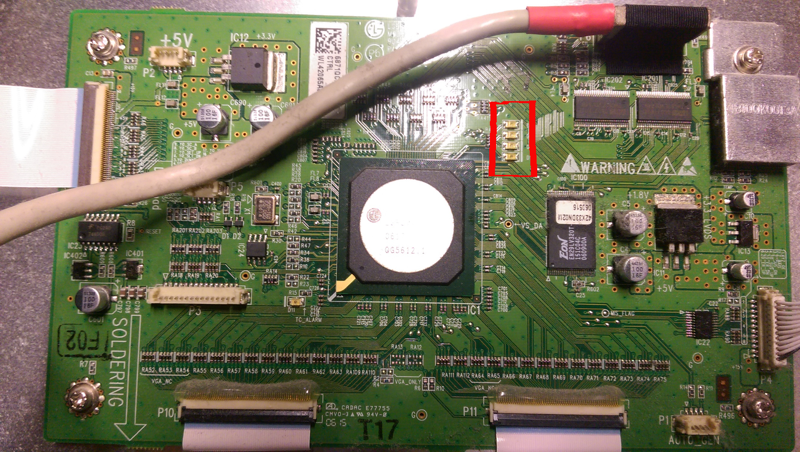

                          Look at the CTRL Bd and search for 2 pins/holes labeled AUTO-GEN. Disconnect the Main Bd. from the CTRL Bd. Solder/connect a jumper between the AUTO-GEN pins/holes. Apply the ac and if the Panel is good the Test Patterns should show. If the screen shows a perfect White display, then the Panel is OK and your Main Bd. or LVDS cables is the fault.

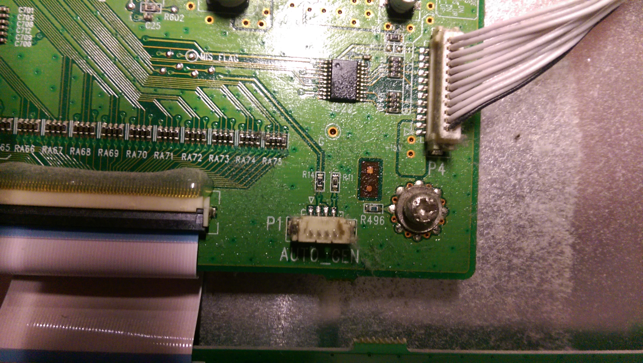

                              Finally got to that TV and found the auto-gen, problem is that it is a 4 pin header and not sure which pins need to connect.
                              • R_J
                                • Jun 2012
                                • 9583
                                Re: LG 42PC1D No Video
                                The center 2 pins are common, I would think either pin 2or3 to pin4. Other ctrl boards auto_gen connect the 2 pins with the resistors off them.

                                  OK, Jumpered pins 3 and 4 on auto-gen header with and without LVDS cable connected. Still black screen! The only difference noted was that LED 1 and 3 came on in the CTRL board rather than LED 2 and 3 without the jumper. They are outlined in red.

                                        To do the AutoGen test, you have to disconnect the PSU from the Main Bd. and the Main Bd. from the CTRL Bd. Then you would have to put the PSU in Self-test mode to turn it on.
