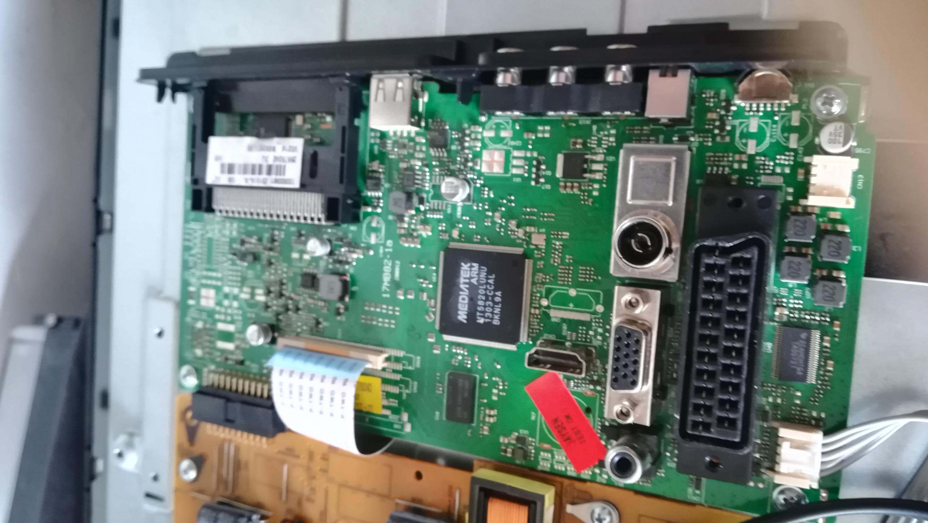

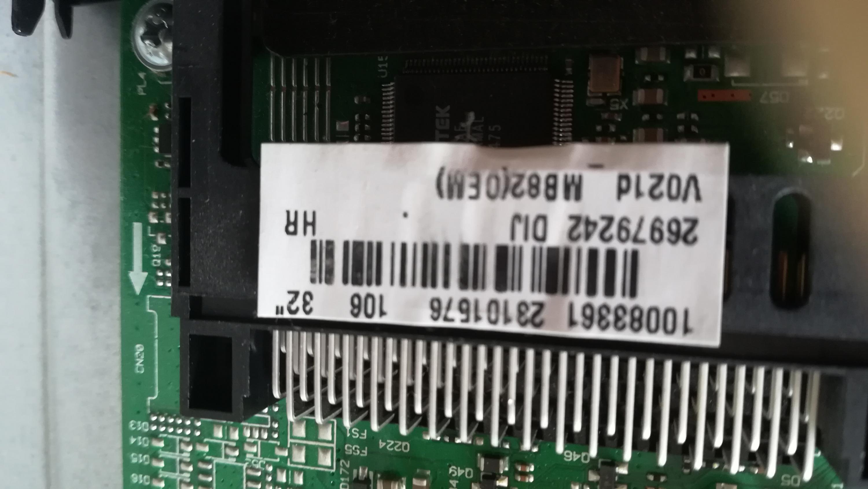

    Someone has a working dumps from this TV??
    I tried 2of them from this website but nogo on this mainboard
    MB82 mainboard...see pictures...
    tnx

    Re: FLASH DUMPS QUADRO 32BN40 25Q64 i 25Q16
    panel nr.....

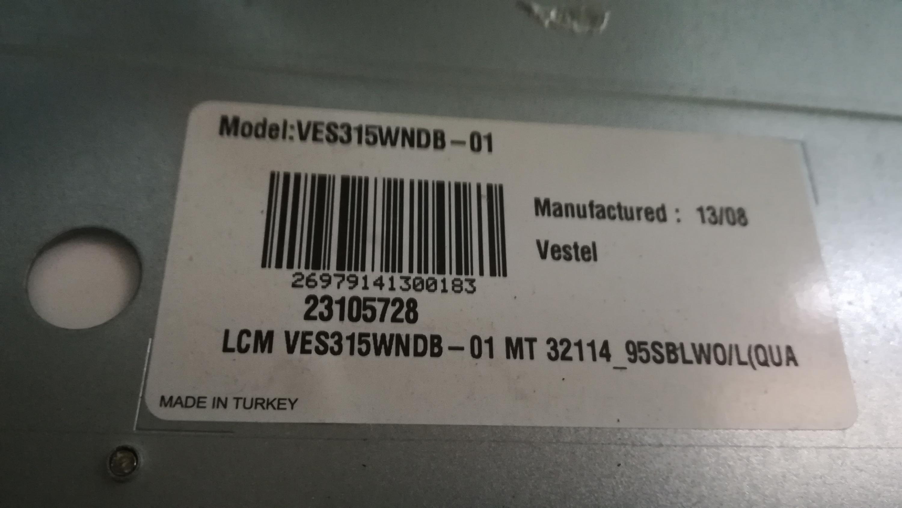

      ves315...
        panel picture...
          u10+u12 for the same main+panel
                It was power supply...
                I just got identical TV and swap PS-s...OMG
                Now have to repair it...
                anyone??
                • dick_barton
                  • Aug 2015
                  • 6643
                  • Wales
                  Any photo's of your power supply. Have you taken any voltage readings?
                  • kiko1
                    • Apr 2016
                    • 48
                    • croatia
                    I just got fake batch of SG6742MR...or this PS is really develped "on the edge"...
                    I replaced new fake 6742 with old one from scrap board...all works..
                    sorry for wasting a space here, but this one really pissed me off...
