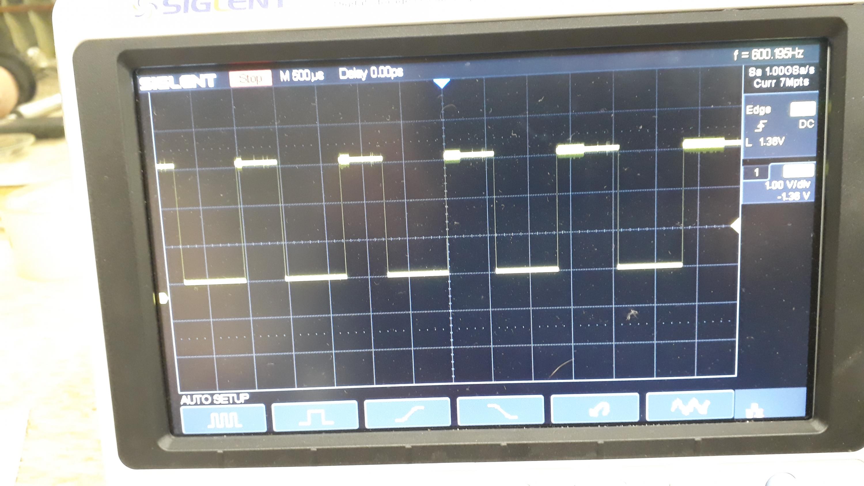

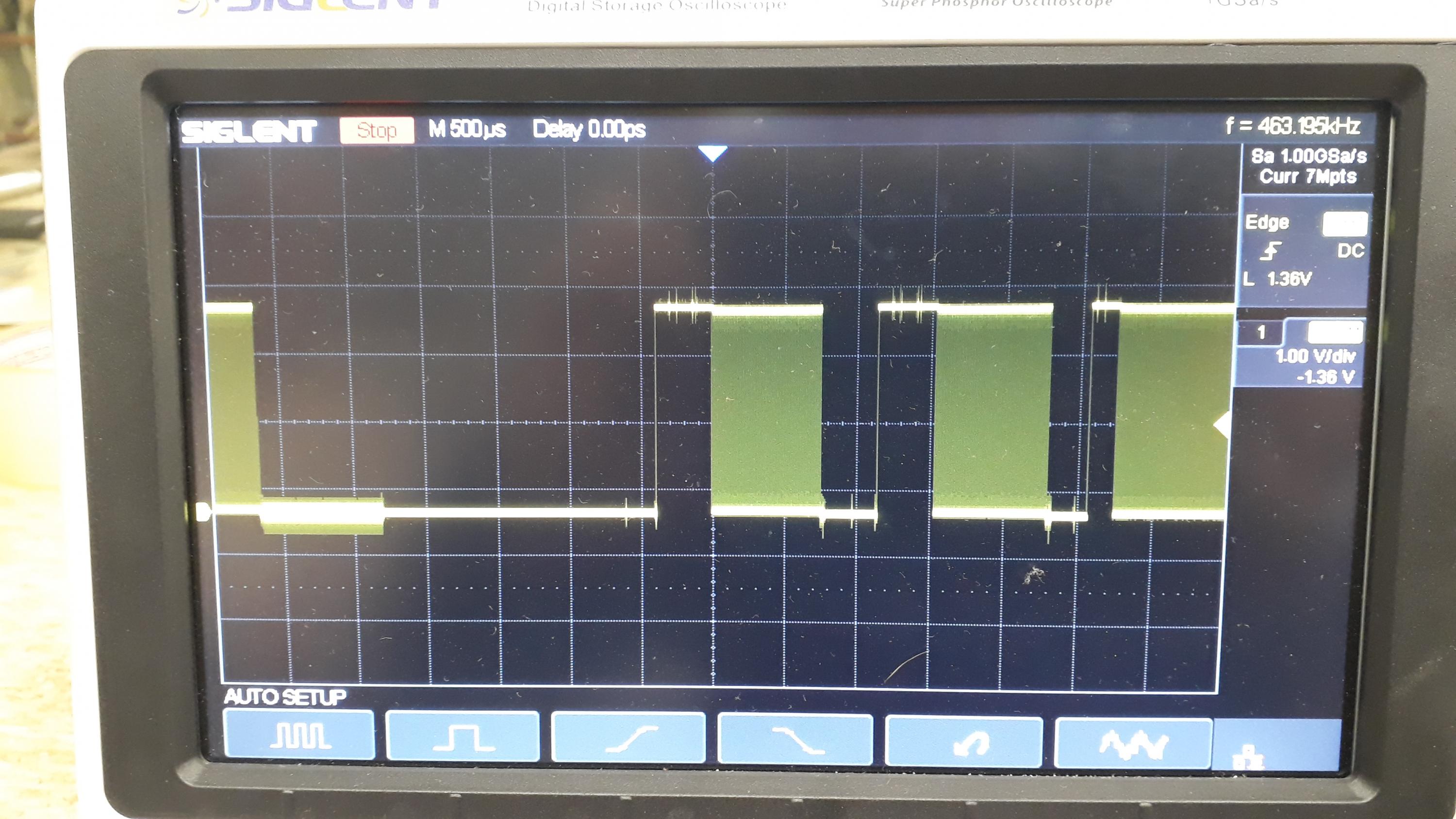

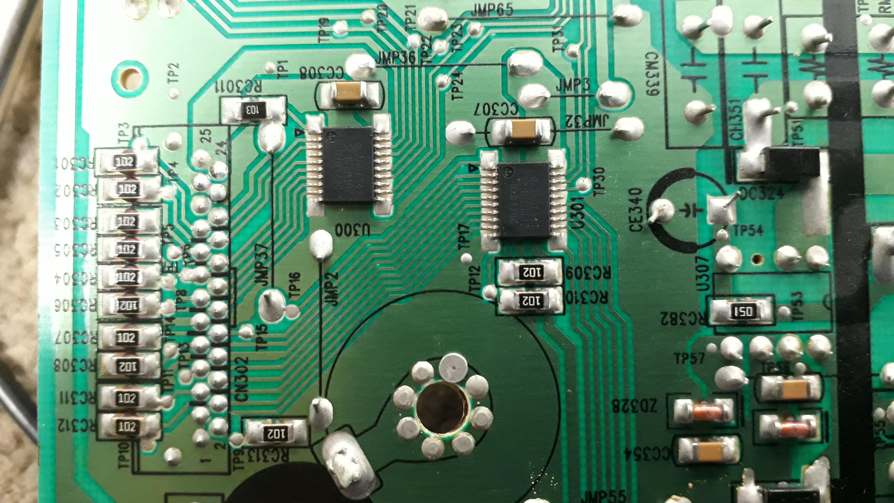

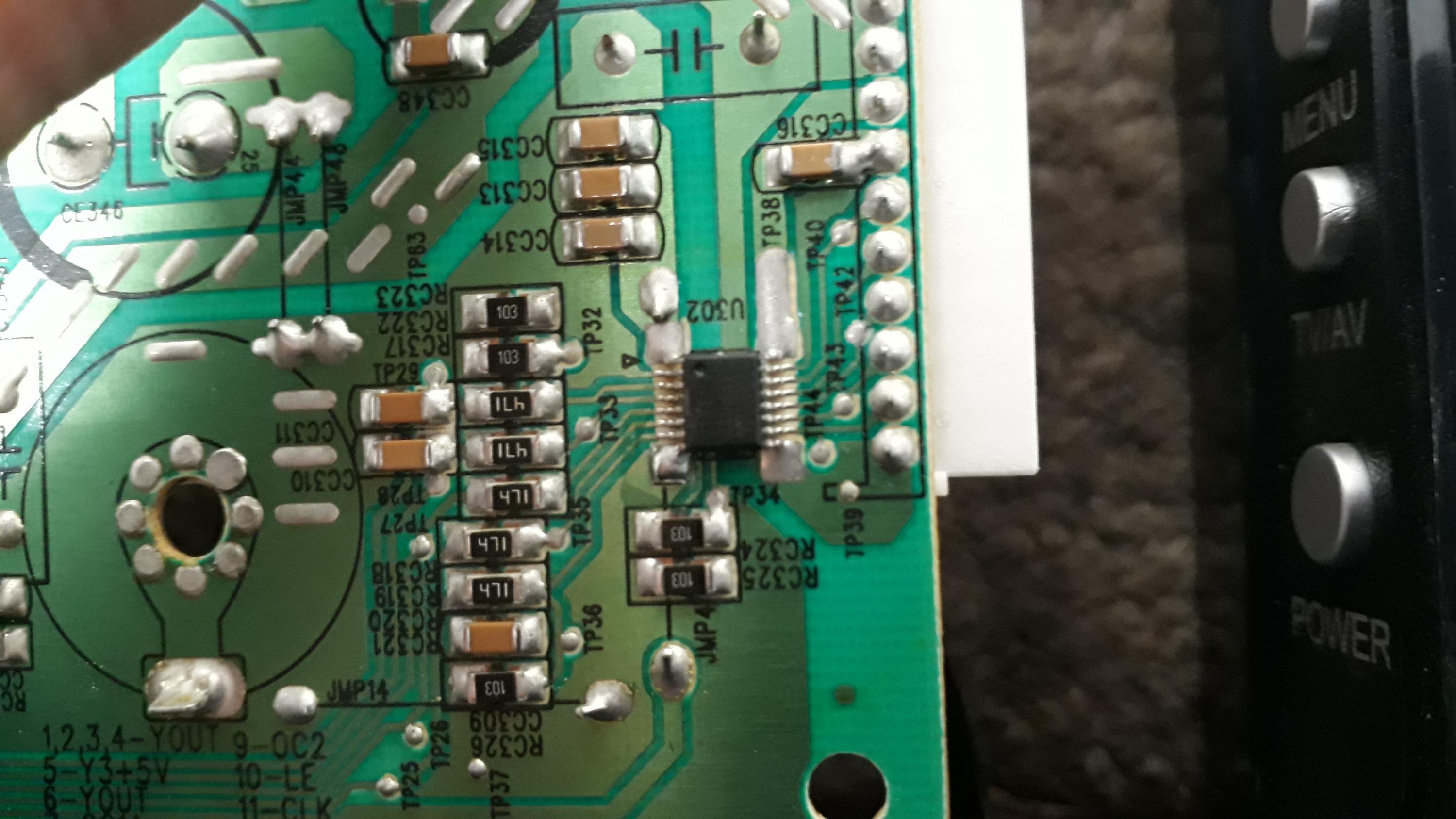

        HeLlo again, i managed to take some pictures of the underside of the Y-Sustain board where the flat ribbon enters from the logic board to show you the data comms. There are two Octal buFfer driver IC's and their output goes straight to the y buFfer board whereupon there is another octal buffer ic. The marking is 541 on the smd. It is a AHC1541.
        I have also added oscillogram waveforms of two of the points coming in on the flat ribbon between the logic and Y-Sustain board. I chose the "OC1" and "LE" labelled points on the ribbon. Check out the pictures.

          If it's an AHC1541 then use your 'scope and check the Input to Output pins. What goes in on the INPUT pins should appear on the OUTPUT pins so I would scope pins
          2 --> 18,
          3 --> 17,
          4---> 16 etc of all the AHC1541.
          The In and Out signals should be identical

            I added some oscilloscope wave forms for your perusal. These were taken on the data ribbon coming from the logic board going to the Y-Sustain board. These were marked as "LE" and "OC1" I don't know what they mean. I also googled the IC's and they are Octal address buffer IC's. Something like AHCT541. There are two close to the ribbon connection (I took a photo to show you) and there is another one on the Y buffer board. What if one of these chips is messing around? I really don't want to have to order a Y- Sustain and Y buffer board to sort out this problem as its going to push up the repair costs drastically.

                  I don't think those IC's are the problem. They appear to buffer the individual bits of the digital signal and if they weren't working properly then I don't think you would see anything like a picture that you currently have, even though it's only part of the overall picture.
                  I would think it'd either a buffer fault or an addressing problem on the logic board.

                      What makes you think it's NOT the buffer board ? Depending on design a failed buffer IC will prevent any data being passed to the following IC in the chain giving you the symptoms you're seeing.

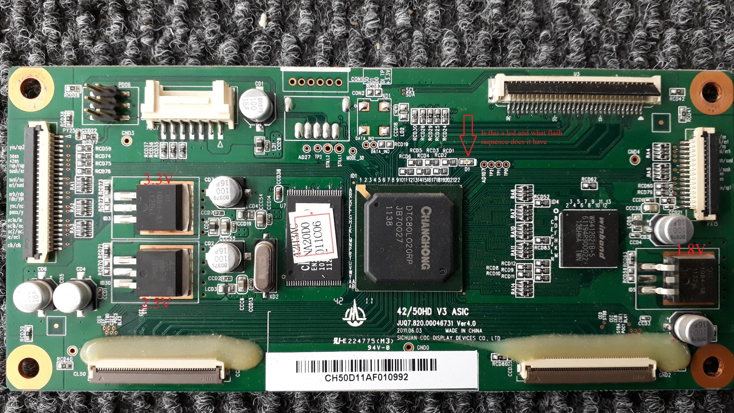

                            There appears to be 3 voltage regulators on your logic board. Possibly 3.3V, 2.5V and 1.8V
                            Are those voltage there.
                            Is there also a led and does the flash sequence change when when you lose the large part of the picture on screen

                              Kudo's goes to Mmartell who said that the buffer IC's are daisy chained. The problem being that the customer had not brought in the footpiece and i could not do proper fault diagnosing. Today with the TV on its footpiece i went straight to the third buffer IC from the top and sprayed it with cold spray when the symptom started. It solved the issue temporarily. So i now know its either the chip or dry joint on IC. I removed that mucky silicon and will try to reflow the IC to see what happens.
