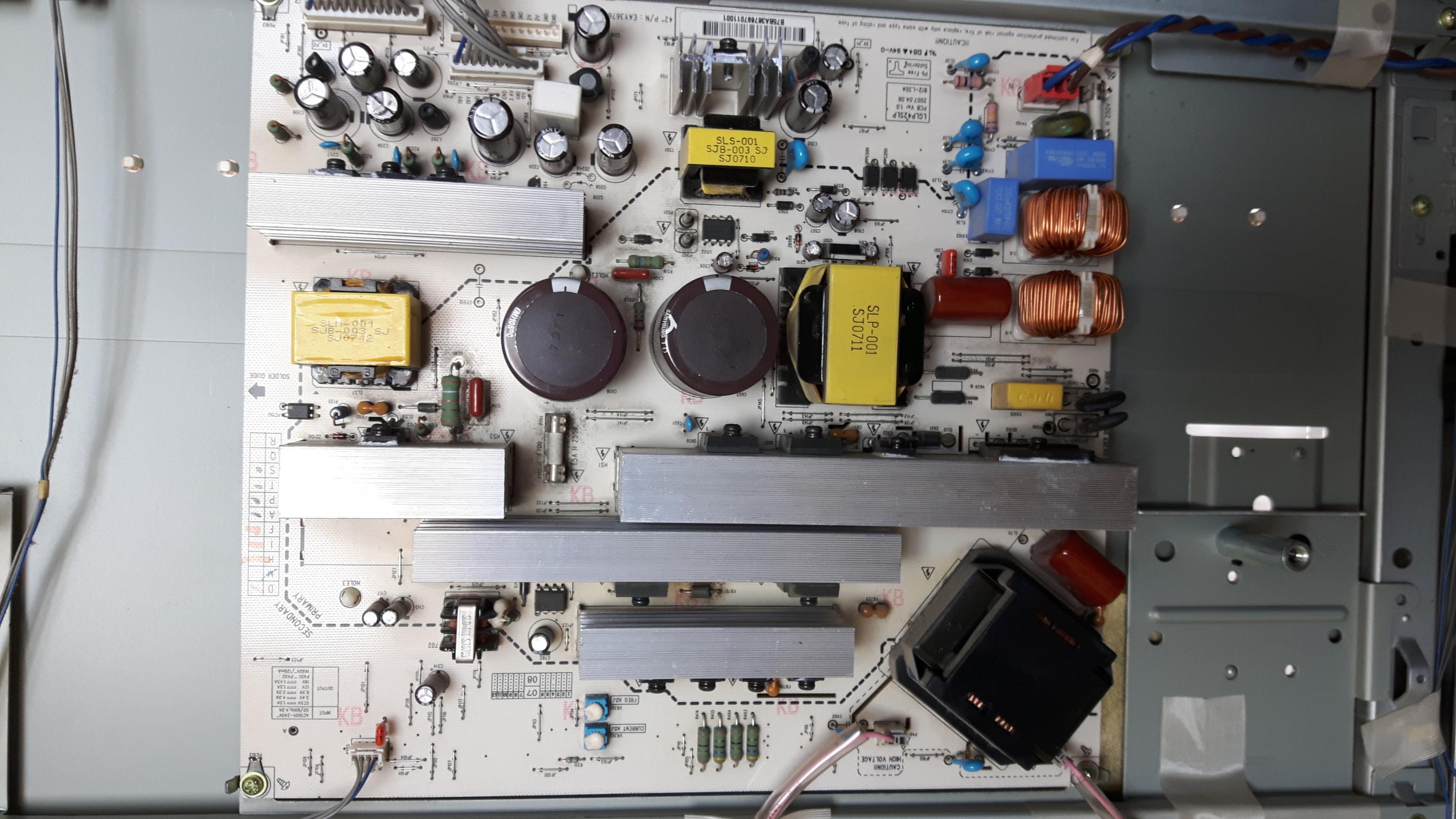

    hi all
    i picked up a tv,but it comes with a problem. it can stay on for 10 -mins to half an hour then can turn off yet sometimes it can be seconds. i ve changed one bulging capacitor.
    ive also notieced the black box on the power supply makes arc sound before it goes off,yet when running ok its quite.
    so what i like to know is the black box the problem ,is it easy to change or am i better off getting another board. anyinfor appricated
    thannkyou

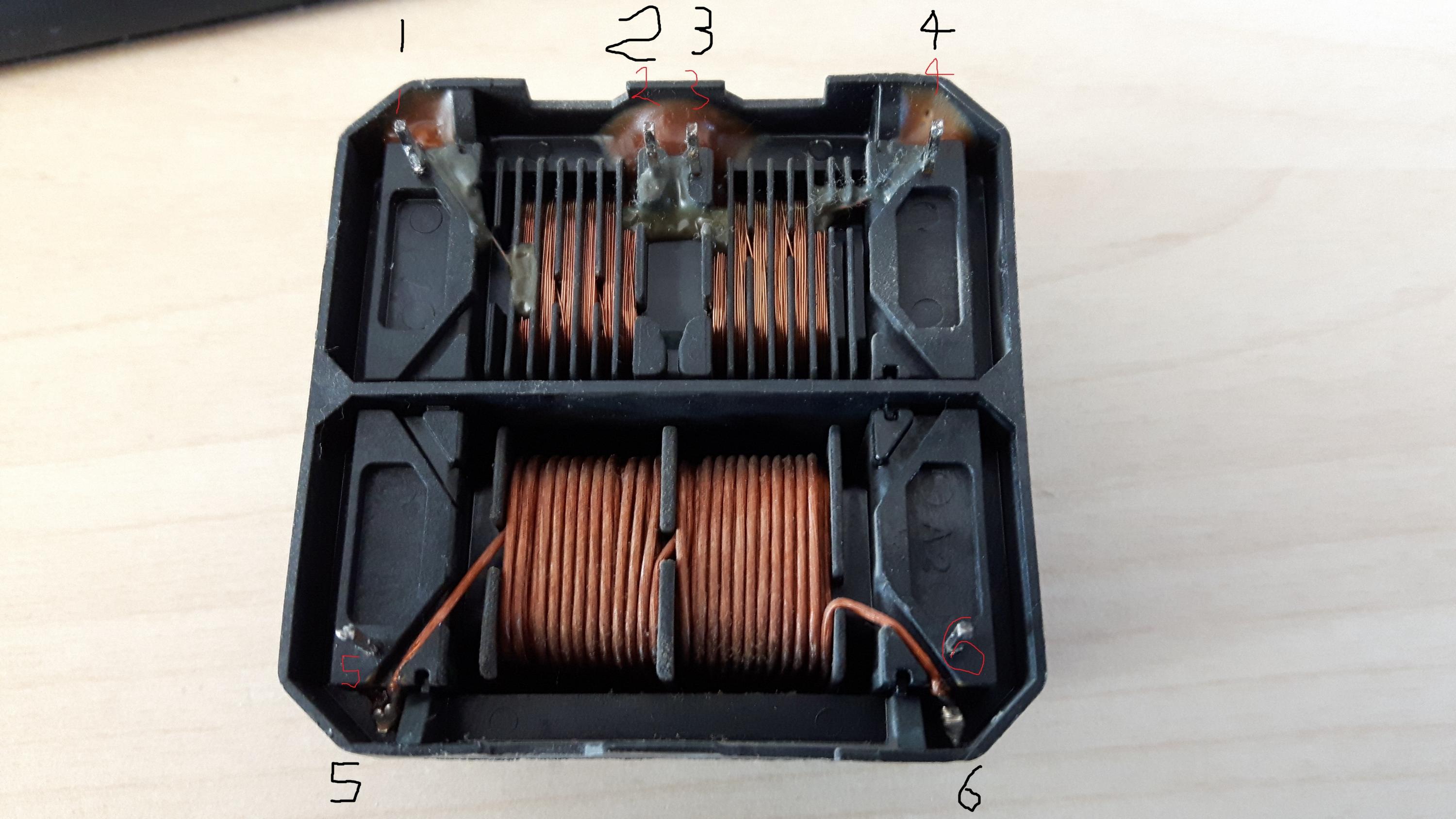

        ive tried the resolder and it seems to be the same so ive takin the black thing off and used a multimeter in diode mode
        1 to 2 nothin
        3 to 4 beep
        5 to 6 beep
        could someone confirm ive done this right or wrong
        oh and i think it might be a transformer
        thankyou

                  On your transformer you should measure resistance between, 1 & 2, 3 & 4 , 5 & 6
                  Beeps only mean there is some continuity but every meter beeps at different resistance,
                  So measure the resistance on either the 200Ω or 2000Ω scale
                  recheck 1 & 2
                          recheck 1 & 2
                          hi there
                          right here goes
                          1-2 27.2
                          3-4 OL
                          5-6 0.5
                          this done on fluke 113 so my ohms is auto
                          thankyou for input
                          • R_J
                            • Jun 2012
                            • 9588
                            Re: LG42LC55 sound from main board
                            So the winding between 3 & 4 is open (OL), it should read the same as 1 & 2
                            5&6 is the primary, 1&2 is one secondary and 3&4 is another secondary
                            Check where the wire from the winding connects to the pin it could be broken at the pin, if not the winding is open.
                            On your meter you can push the "range" button to select the resistance range. 600Ω, 6kΩ, 60kΩ
                            In post #4 you said 1&2 were open (nothin)

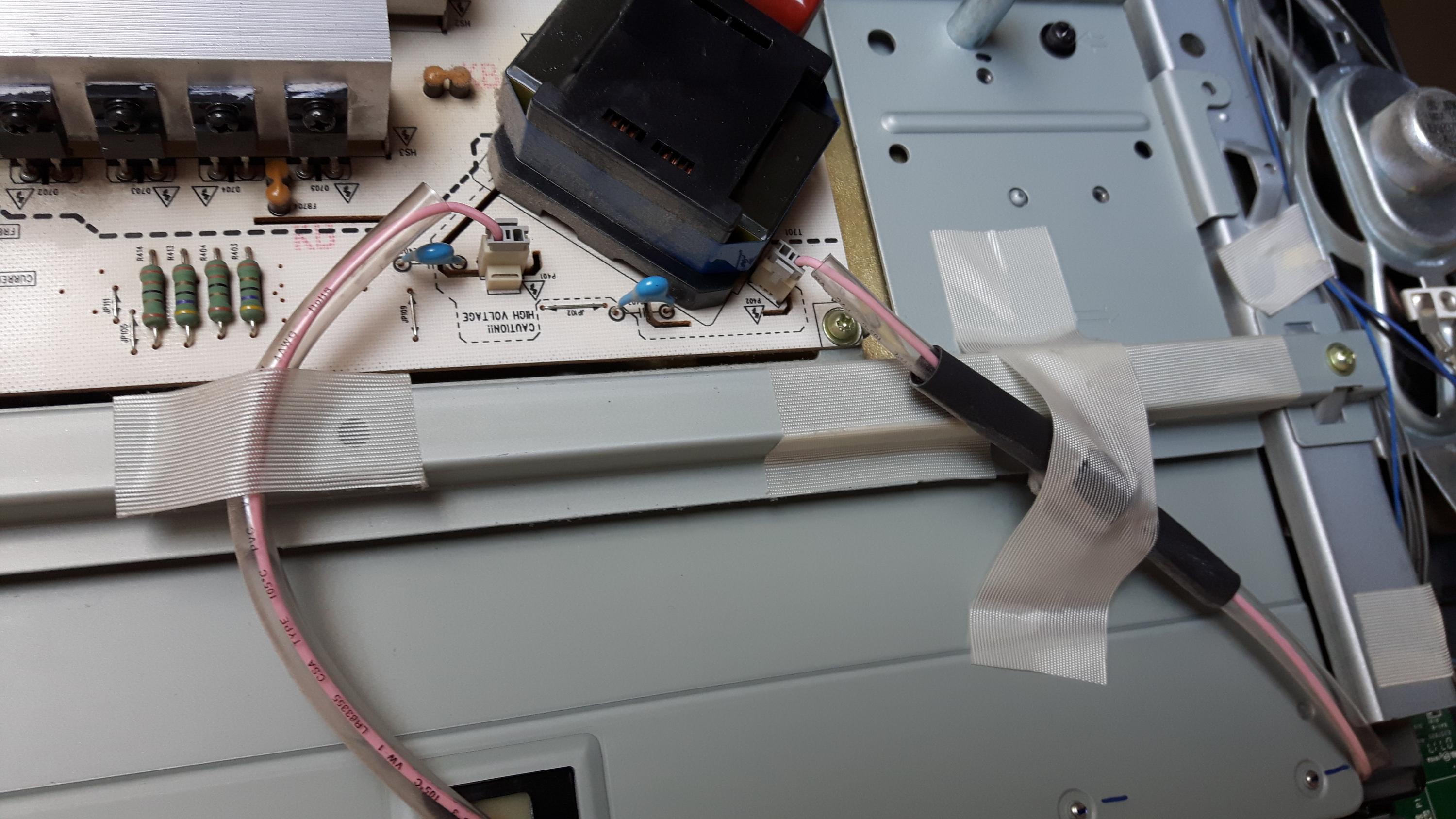

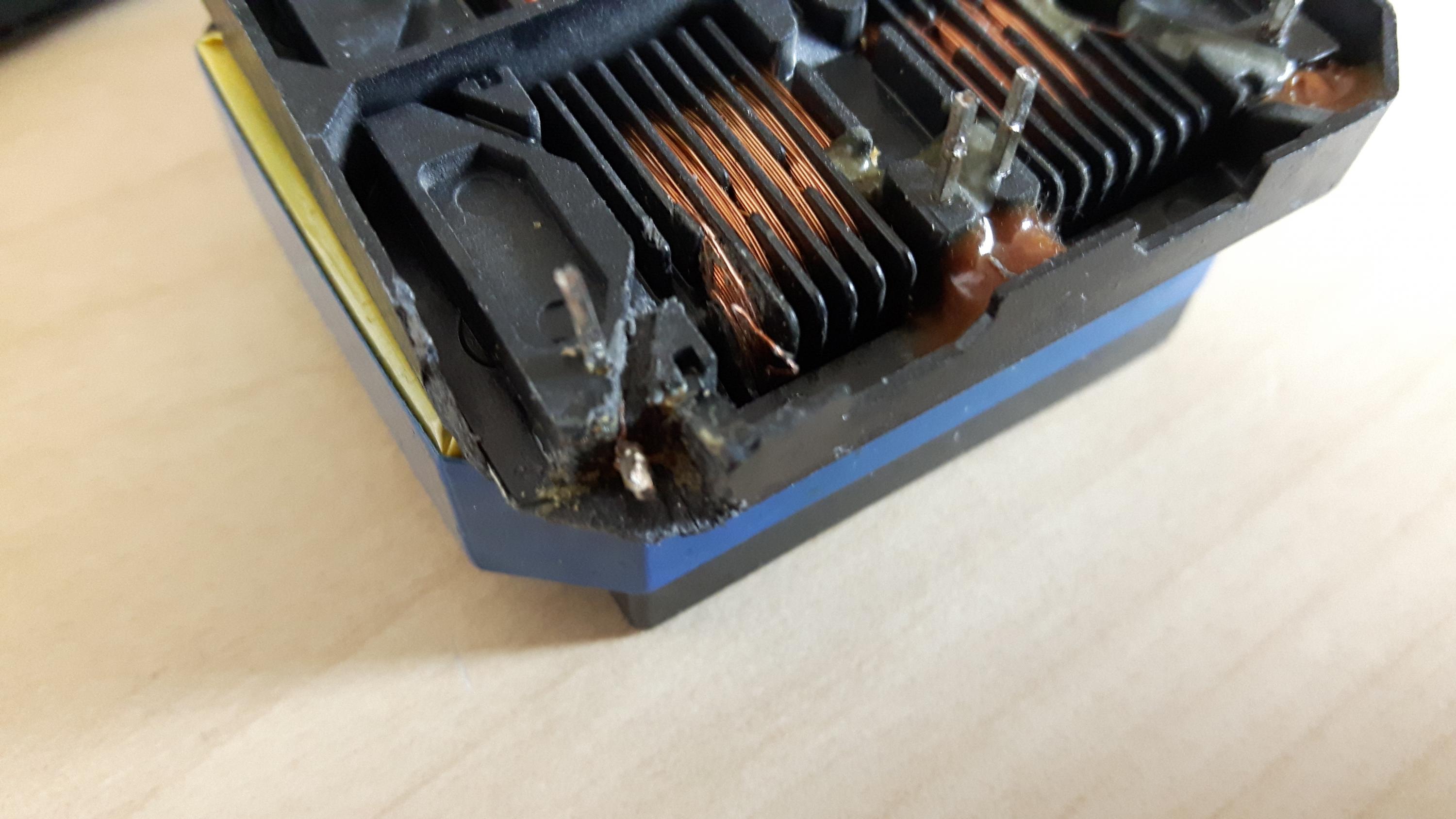

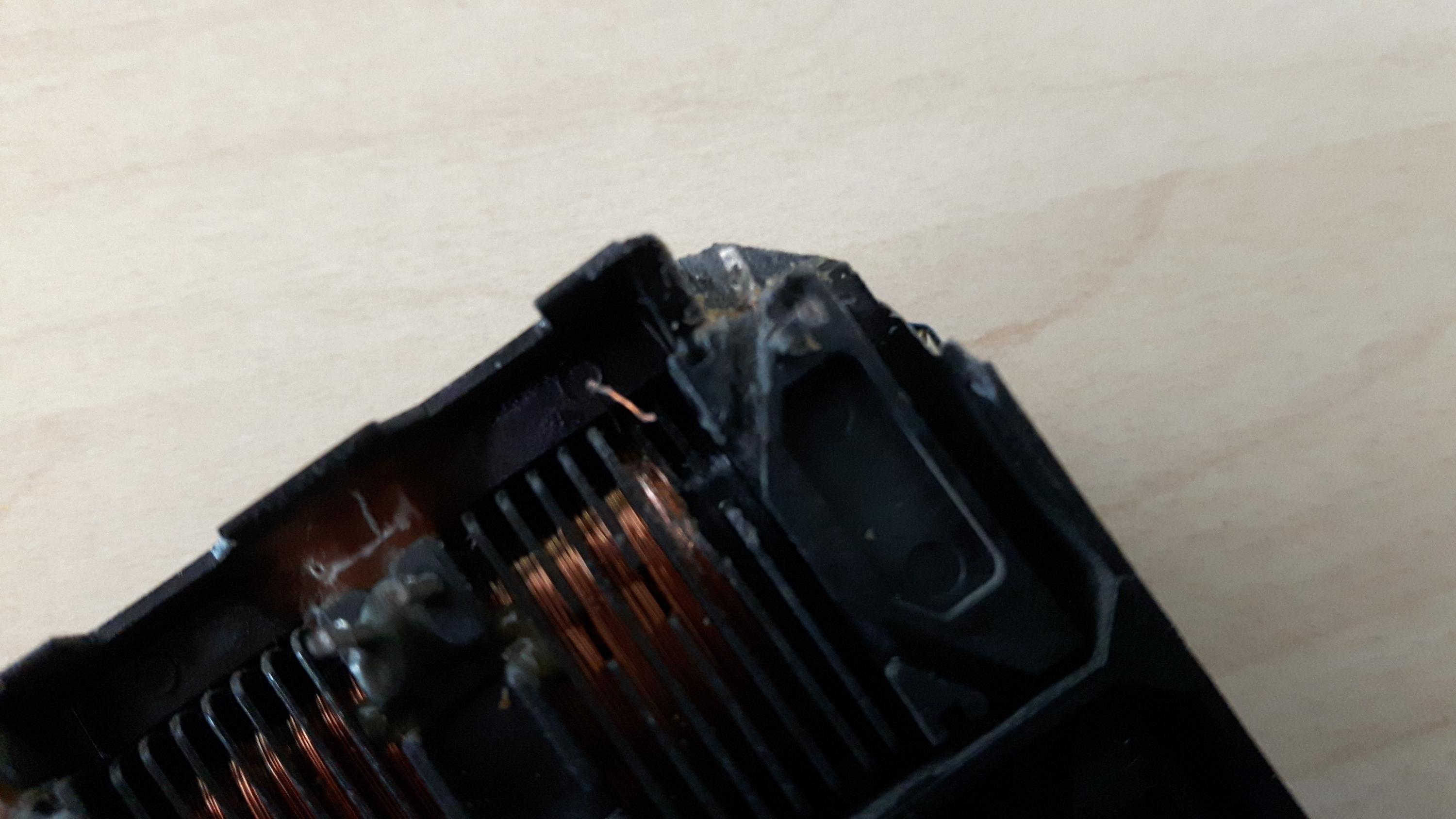

                                    ive found were the wire has snapped near the pin,although not longer enough to solder direct to the pin. so is it possible i could solder a new pieace of wire in to make the connection. if thats possible what could i use to cover the pin from as i had to remove sort of hard glue type stuff which covered the pin .
                                    thankyou
                                    • petehall347
                                      • Jan 2015
                                      • 4437
                                      • United Kingdom
                                      extend it or see if a turn can be removed for more length
                                      • andrewblueboy
                                        • Feb 2017
                                        • 47
                                        • uk
                                        tried to unwind the wire to make it longer but it so tightly wrapped also i put meter on the piece off wire and theres no reading at all on that winding. been trying to dismantle but no joy. do you know were i could get a replacement as im having no joy except ebay and thats a complete board.
                                        thanks for infro tho
