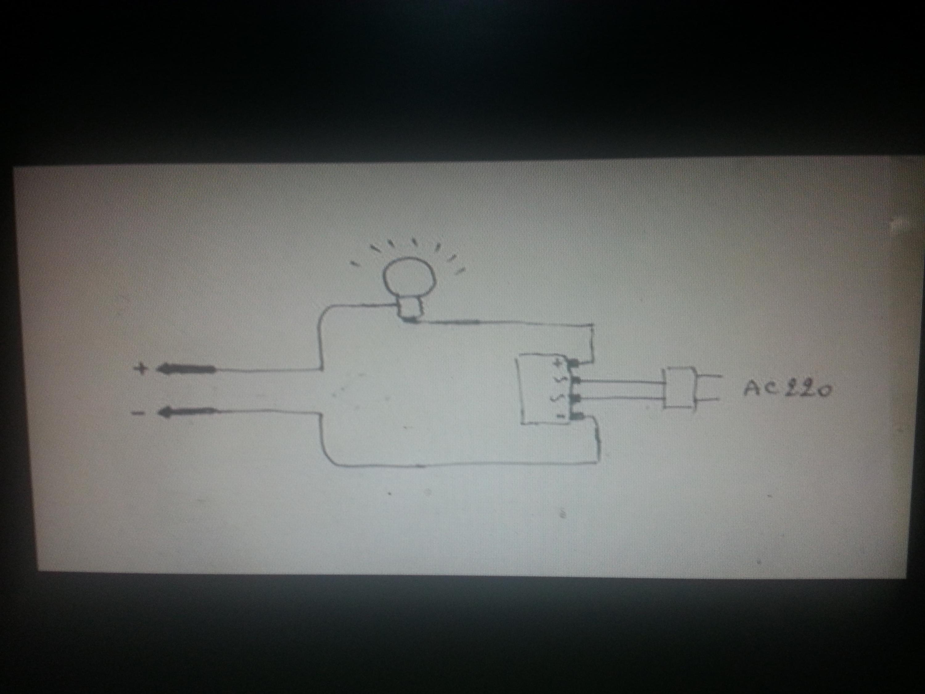

You can make led tester easly in home. To test led bars and find the bad led
Just with Btodge diod and lamp 15watt
