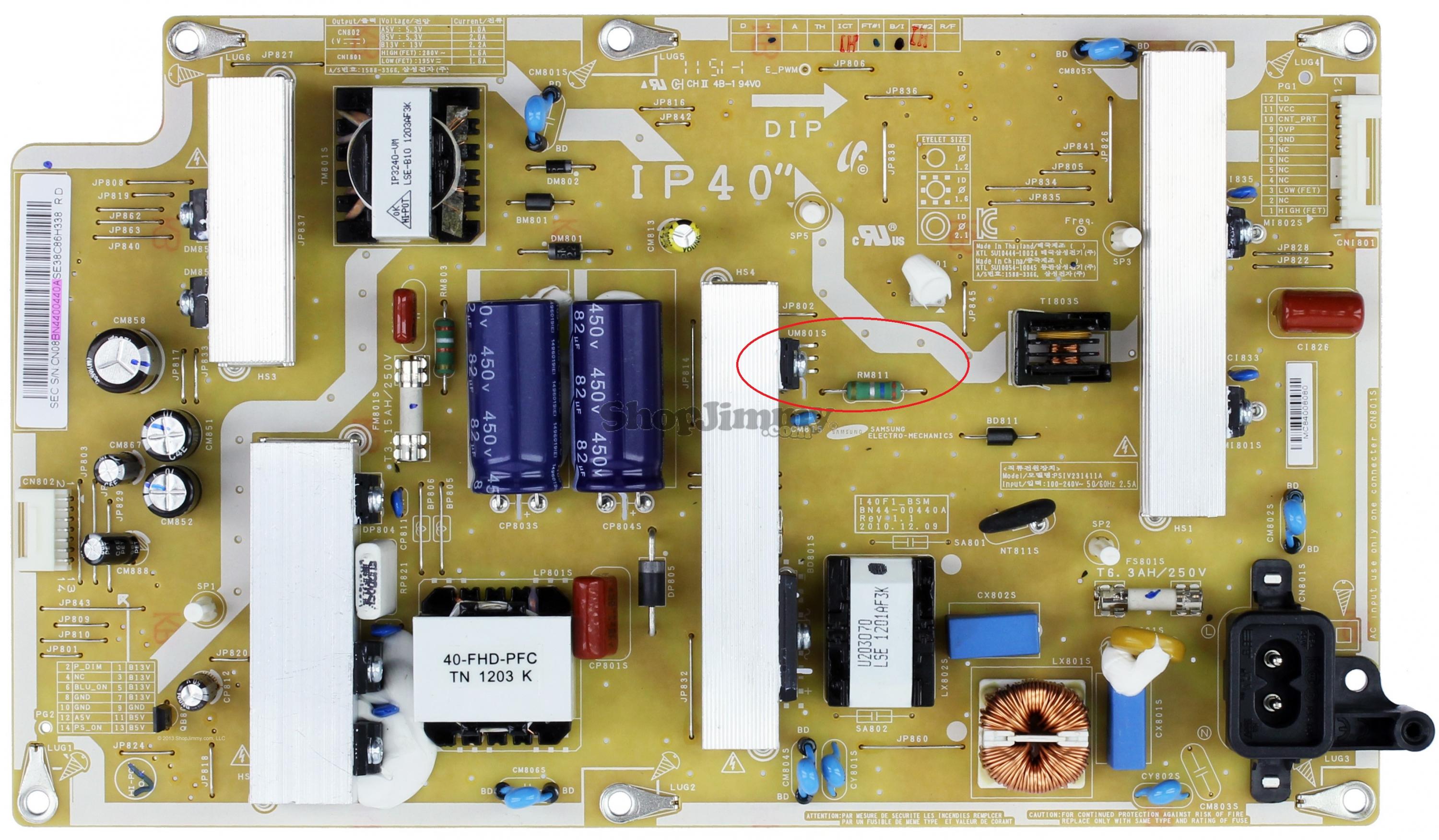

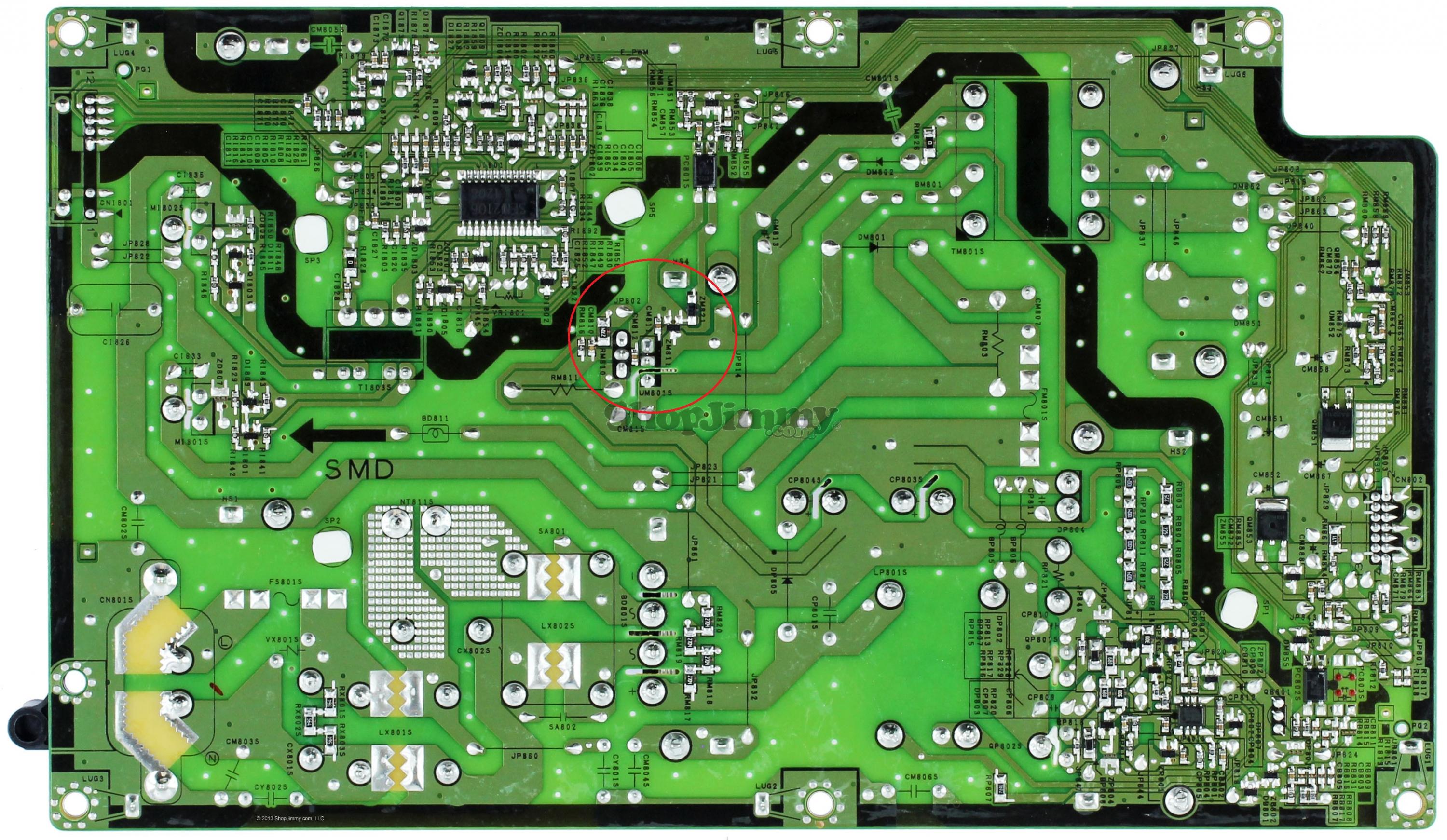

    So I am working on a Samsung LN40D550K1FXZC that wasn't powering on.
    SMPS BN44-00440A in it had UM801S and RM811 burned. After replacing those two it still didn't have output voltages. So I found a ZM821 between leads(pins) 3&5 and 6 of UM801S that read 20ohm in both directions. After removing it SMPS came back on and I have output. Across those two pads that ZM821 was soldered to is 0.9V. Under a microscope ZM821 marked with Z18. My guess that it is a 1.8V zener diode.
    As far as I know schematic isn't available for this SMPS.
    The question: is anybody knows for sure what that ZM821 is and can I run SMPS without it?

    Z18 is very likely an 18 volt zener
      Re: ZM821 in BN44-00440A power supply
      That Zener is connected in parallel with the output (Emitter-Collector) side of the OPTOISOLATOR PC801S (used for feedback to regulate the output Voltage), you should check the resistance between the two pads where you remove the Zener ZM821, more likely the OPTO is also damaged when the SMPS IC (STRW6052??) blew up.
      Most power supply do not install that Zener.

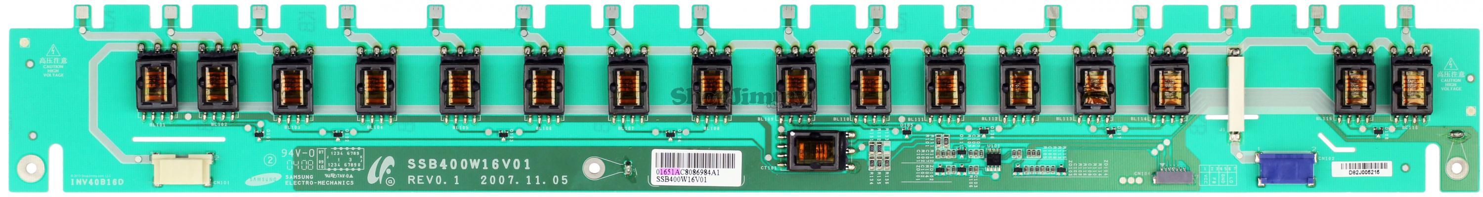

                  Does this tv have a seperate backlight inverter? does it look like this? Maybe post a picture of the rear of the tv with the back off

                    It has inverter transformers board, the drive circuit (half-bridge) for the primary of the inverter transformers is on the power supply board.
                    I expect the backlights should at least flash on for seconds if the drive Voltage (over 200VAC (high frequency) was present.
