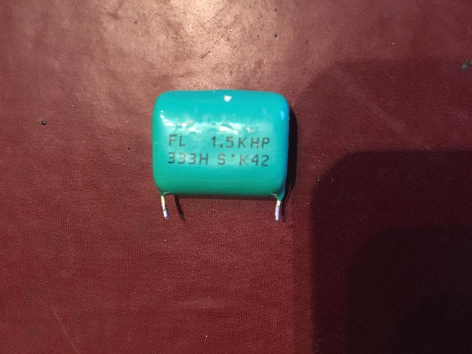

    My issue is a LG plasma tv (60pv450). I read enough to see that the cap on c802 was bad. I'm trying to decode this cap & im just not getting it. Can u help me. The cap reads FL 1.5 KHP 333H S K42, so far I've got out of this is
    33000pf at 1.5kdv .

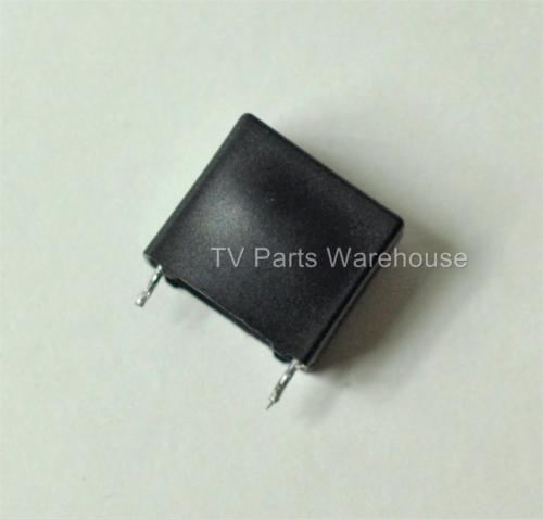

    does it look like this one ? http://www.signalsuk.com/Shop/Capaci...500V-592H.html

          It has the marking that I referenced in the Initial post
            Re: I need help decoding a bad cap
            Hey guys. Would u mind taking a look at this. Tell me what u can make of ut

              Are you sure the cap is bad? it is usually the black square type that bulge that are bad.
              This one from digikey would work 495-4767-nd or 399-12622-ND (2kv)

                I'm fairly sure it's bad. It appears to be bulging on the sides. However I didn't test it yet. Was trying to identify it first.
                Thank u so much for the product code
                  That green cap you posted looks ok. it looks original and not bulged, it was never square. I believe that cap that goes bad is on a different power supply board but same location.
                  Since you never mentioned what the problem is, I suspect there are other issues.

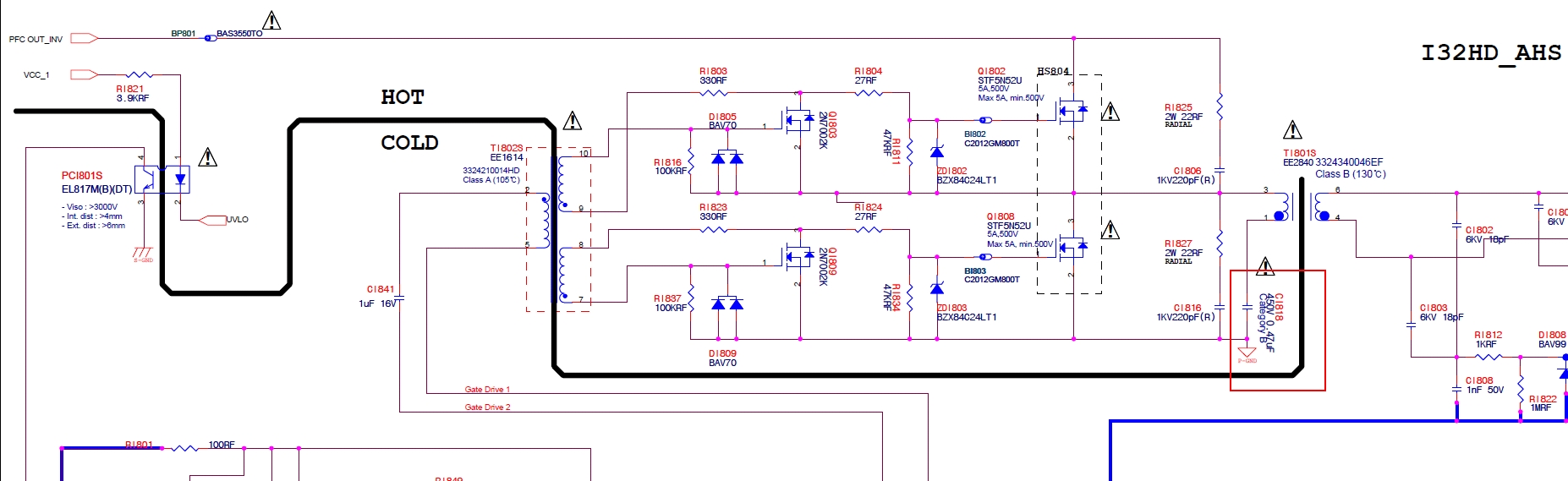

                        CI818 seems to point to many different inverter board capacitors... but how is this thing stressed to cause it to bloat like that -- or is it just a capacitor manufacturing QC problem?
                          Many models, the cap that failed is used for coupling/DC blocking from the Bridge drive to the primary winding of the inverter transformer, or power transformer.
                          "but how is this thing stressed to cause it to bloat like that" I have no idea, it is needed to be taken apart and analyzed.

                            Okay that one is a bit more voltage "stressed" - I saw another schematic when I searched for a Samsung CI818 that was a 0.01uF filter capacitor hooked up directly to an input of a LM393 op amp and was wondering how that could possibly be stressed...
