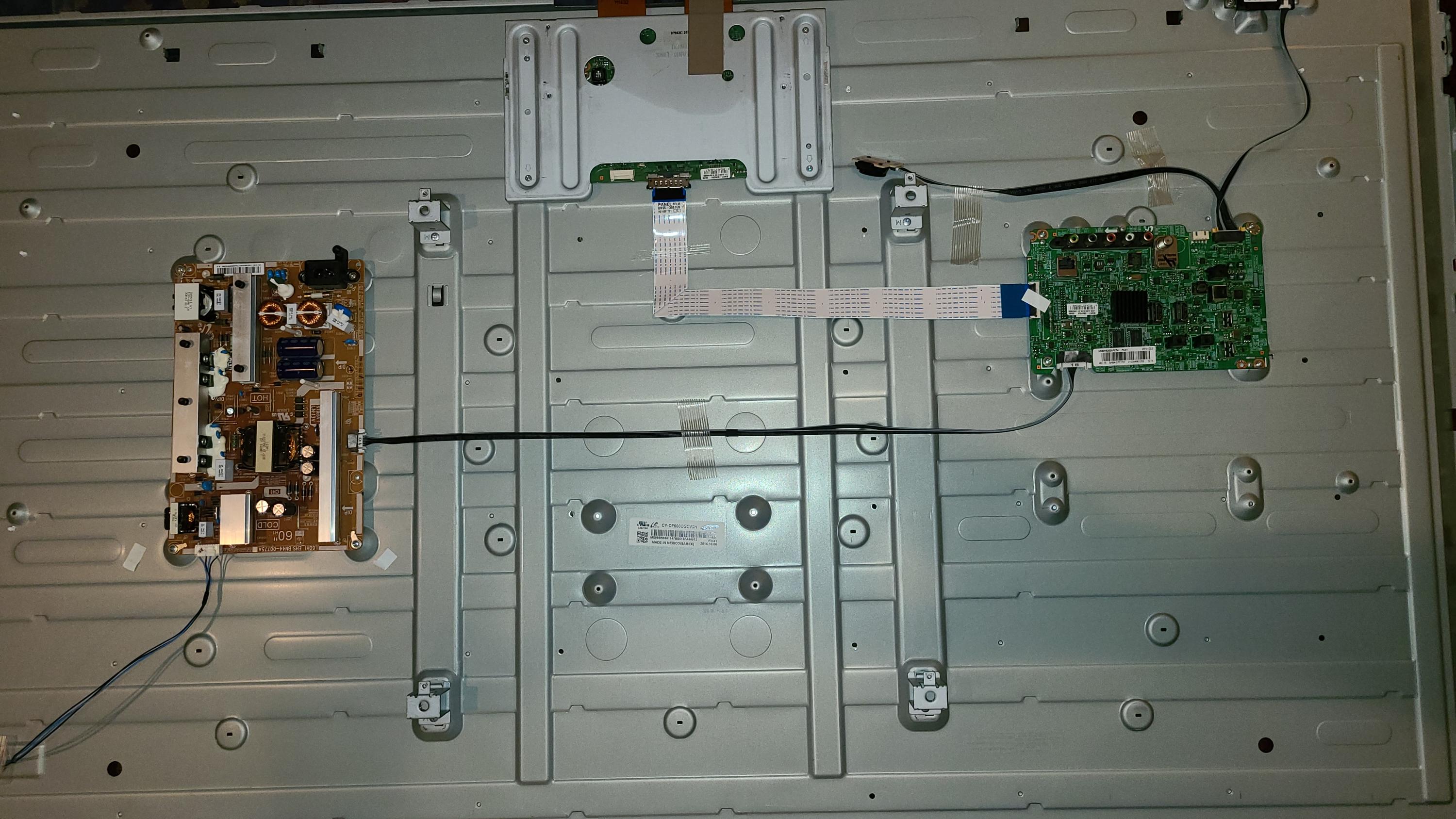

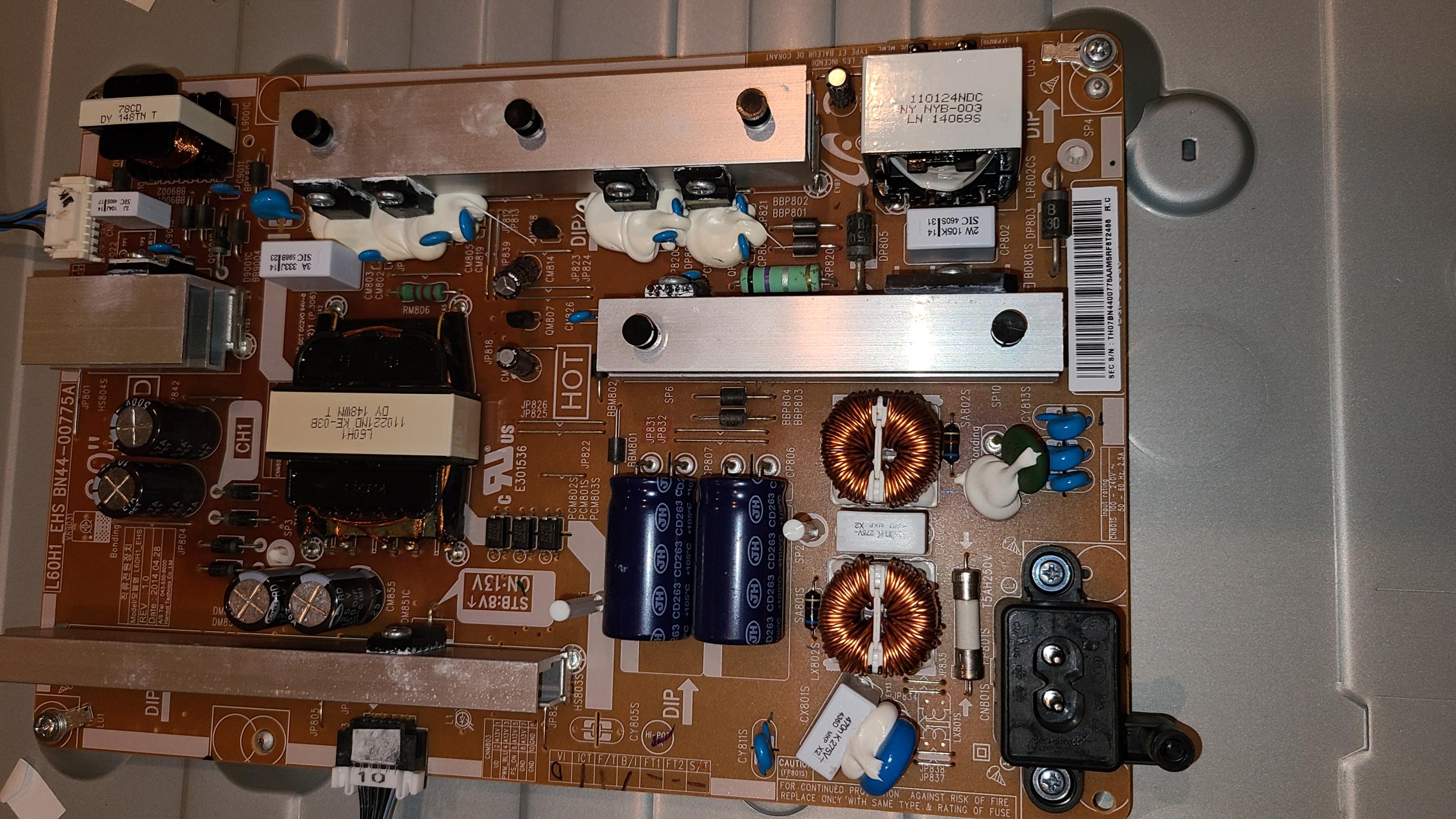

                              Hi, old thread so hope someone can still help. Same bn44-00775a board on a un60h6203. Original problem was one strip of lights went out so i got the strobing. Replaced the entire set of backlight strings and no lights at all. Forced backlight on mode and still 405v with no lights. I tested the individual leds again and all of them work. I have continuity on the wiring harness and measure 405v at the + of the top string and have voltage at each + on each strip all the way down enough that it should light the strips. Like the thread above, I can measure V from chassis grnd to s+ or s- at the connector pin on the psb and the lights all barely light up. I can also measure V from chassis gnd to the very last - on the very bottom led strip and all leds light very dimly. If unplugged for a whiile, i can plug psb in and all leds shine bright for a few milliseconds, then completely off. Seems like a continuity problem but i can figure out where or what else to try. Any ideas?

                                      Re: Samsung UN60H6203AF LED TV Screen Won't Turn On
                                      Originally posted by Bambam33
                                      I just put the multimeter into diode test mode and measured from chassis gnd to that very last - and all leds light up bright to full strngth. Same for the very last +. ???
                                      So the TV is powered up and turned on, then you set meter in Diode mode and put the probes on the chassis and the - pin of the LED connector, you better check to see if your meter is still OK.
                                      You can only use Voltage mode when testing live circuit, do not use Ohm or Diode mode to test live circuit, you can damage your meter and the board.
                                      What you did is providing the - (Cathode) return to circuit ground through your meter, instead of going through the MOSFET and current sensing resistor to circuit ground.
                                      Show us good clear straight shot pictures of the whole top and bottom side of YOUR power supply board, and also the whole back side of the TV showing all the boards.
                                          I tried to get the lighting right on the pocs without reflection. I didnt have the tconn board uncovered.
