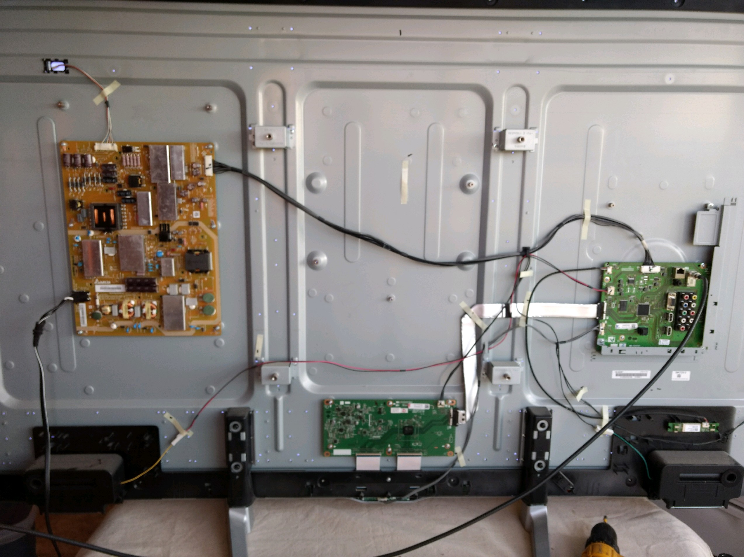

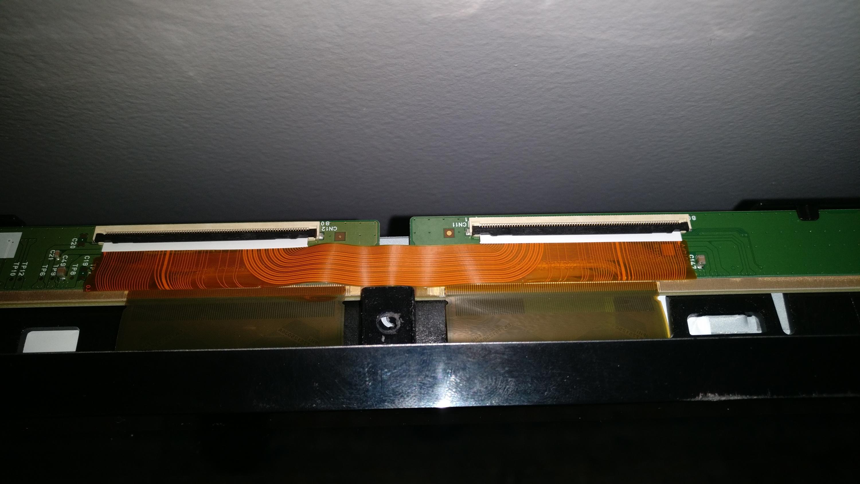

    Today I got a call from a guy with this TV claiming the main board was bad. I paid $40.00 for it.
    Got it back to the house, took the back off and found the ribbon cable unhooked from the t-con at the main board. I hooked it back up and started checking voltages. The power supply was fully functional but I found no power from the main to the t-con. I tried heating the main board with no change in status.
    The backlights would flash and I could see there was something on the screen. With repeated on-off and looking at the screen I was beginning to believe the display was bad. I saw horizontal lines on the screen and parts of the display appeared not to be working.
    I was getting ready to re-install the back cover when I thought to try disconnecting the ribbon cables from the t-con to the buffers. I unplugged the left connector and the right side of the screen came up with the "Sharp" logo and looked good.
    So I plugged it back in, re-connected the left cable, unplugged the right one and the left side of the screen came up and looked good.
    The truth, I was a bit stumped. I couldn't believe each side only worked with the opposite side unhooked.....and then it hit me....has to be a bad connection, right? So I plugged the right cable back in, hit the power button, the TV came on, stayed on and now IT WORKS!!!!!!!!!!
    Either the guy forgot to hook the LVDS back up....or thought the panel was bad and left it unhooked so no one could see the screen flash and the appearance of a bad panel.
    I must now go clean the hash marks outta my shorts! I don't believe it, I just don't believe it!!! This is WAY WAY COOL!!!!!!!!!! After I get a change of underwear I'm going to unhook the t-con to buffer cables and clean all the connections just to be thorough.

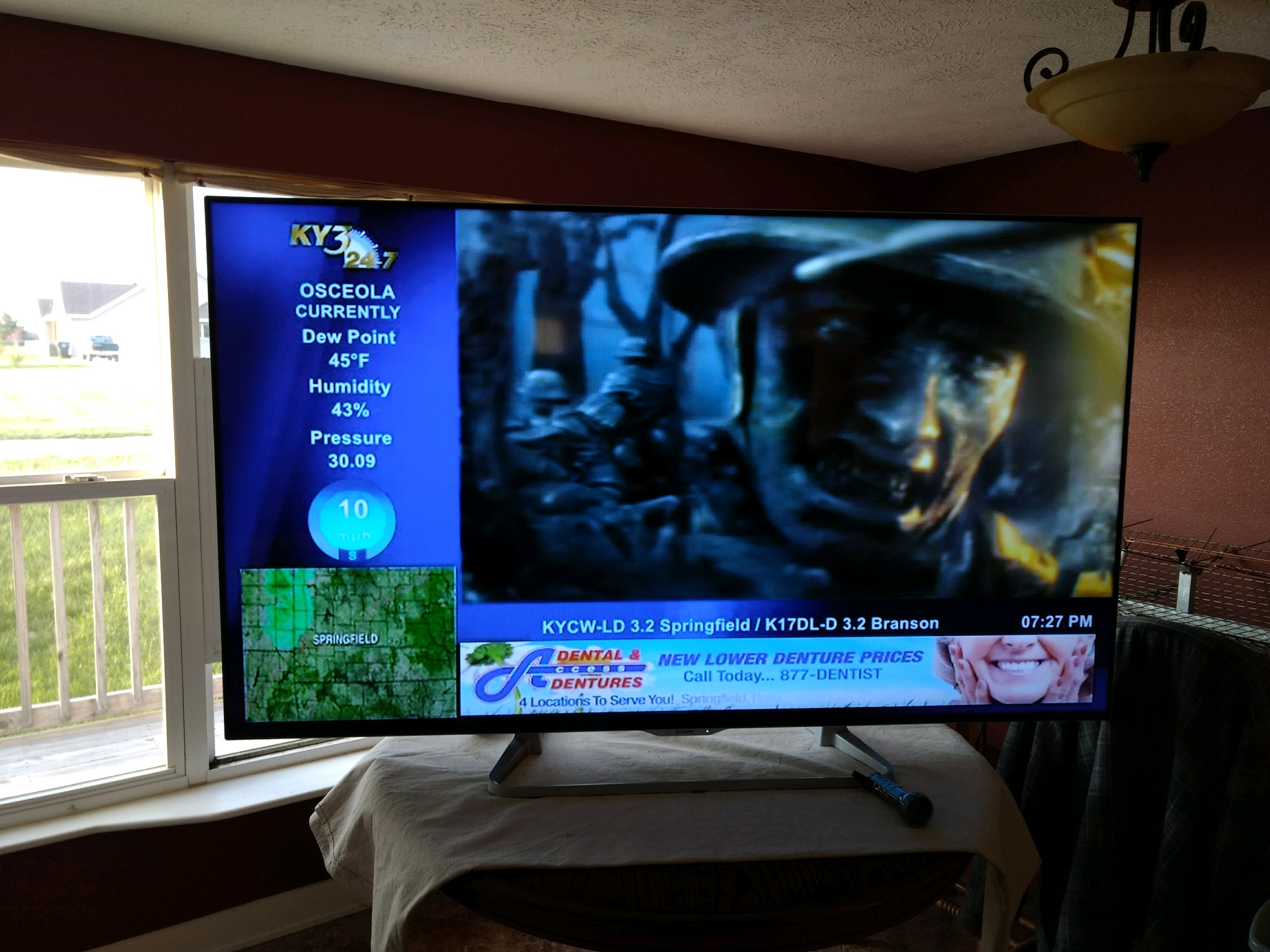

      Thanks, it's running in my living room right now! I feel just luckier than a two-peckered dog!

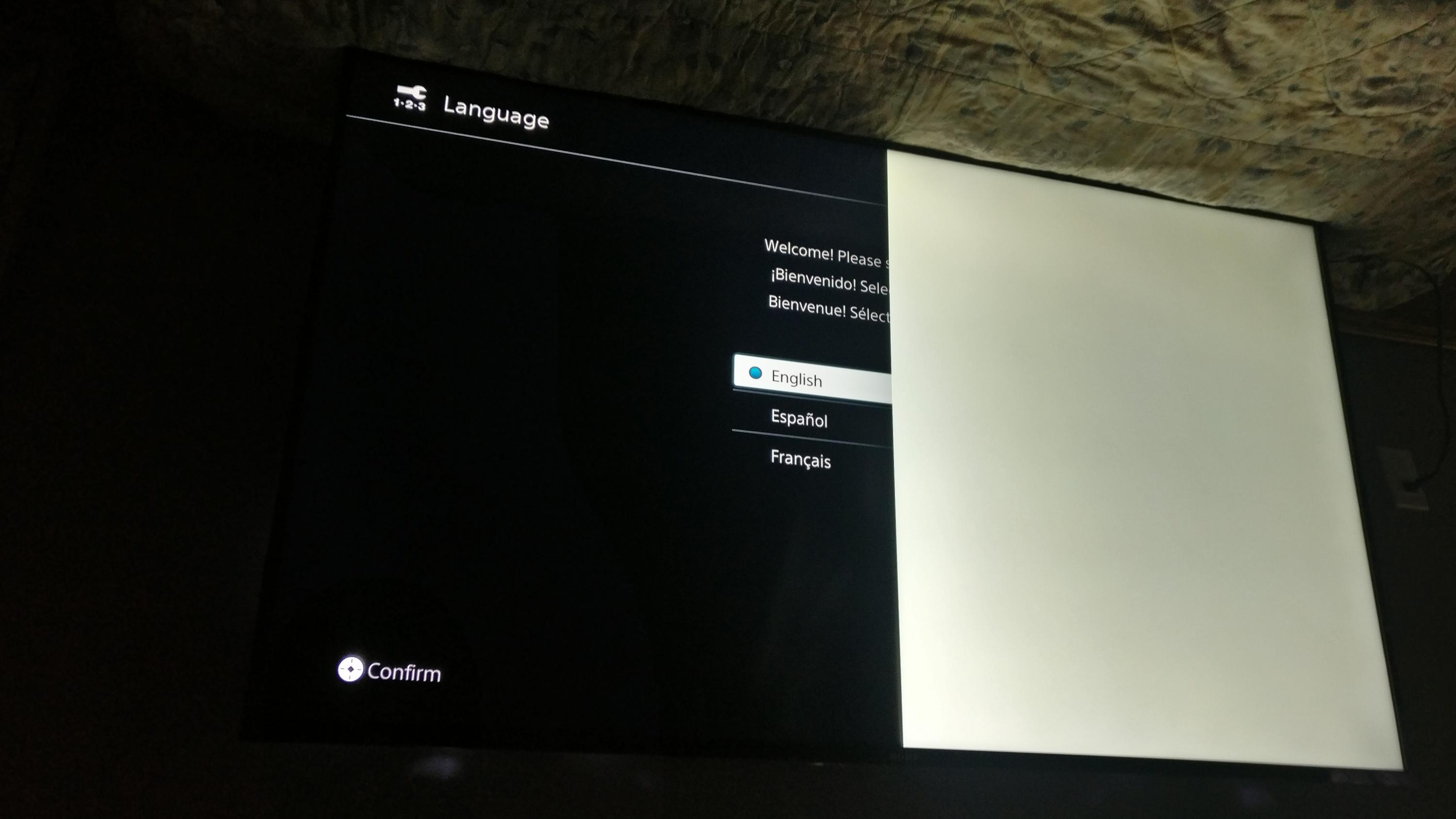

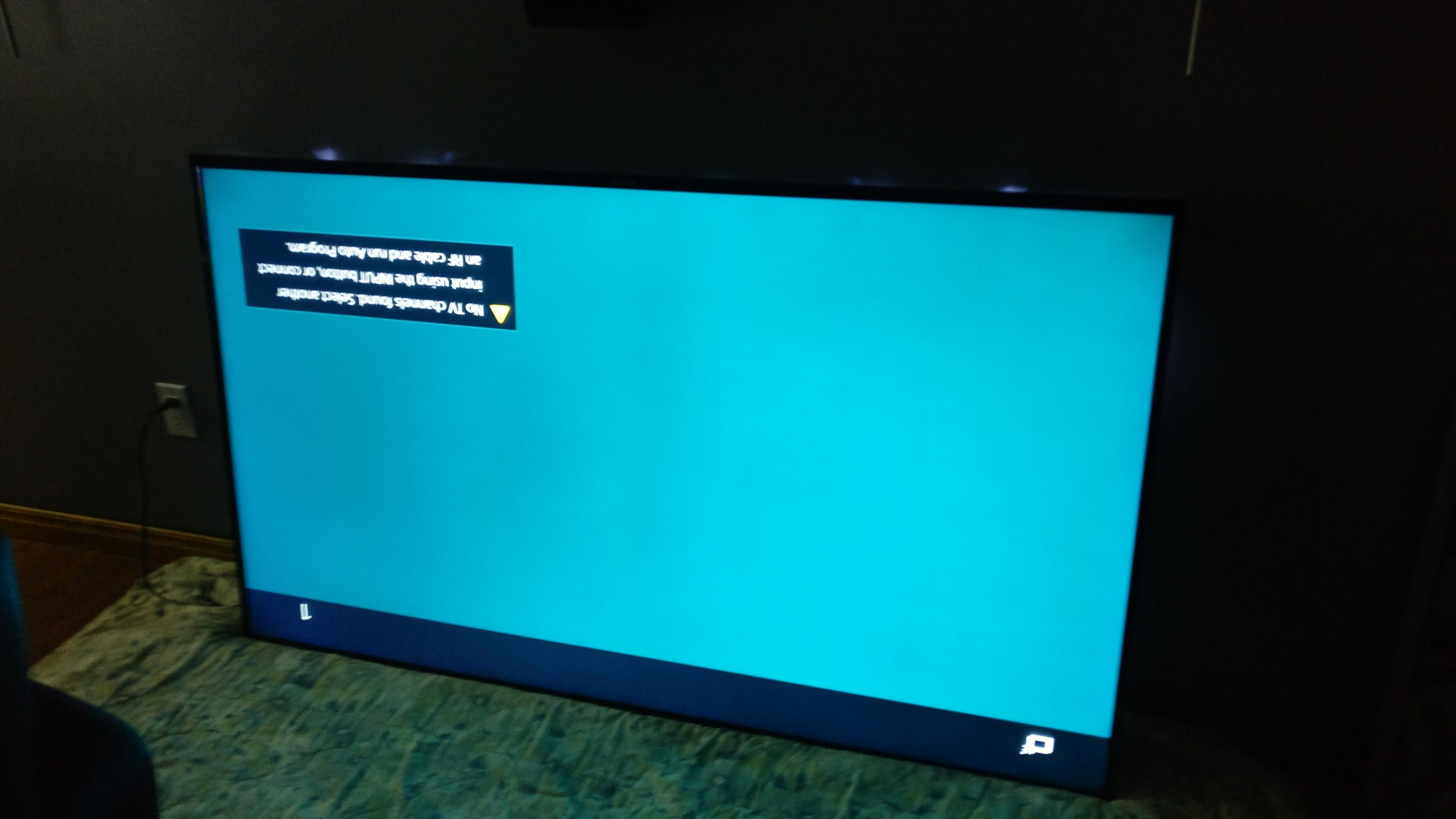

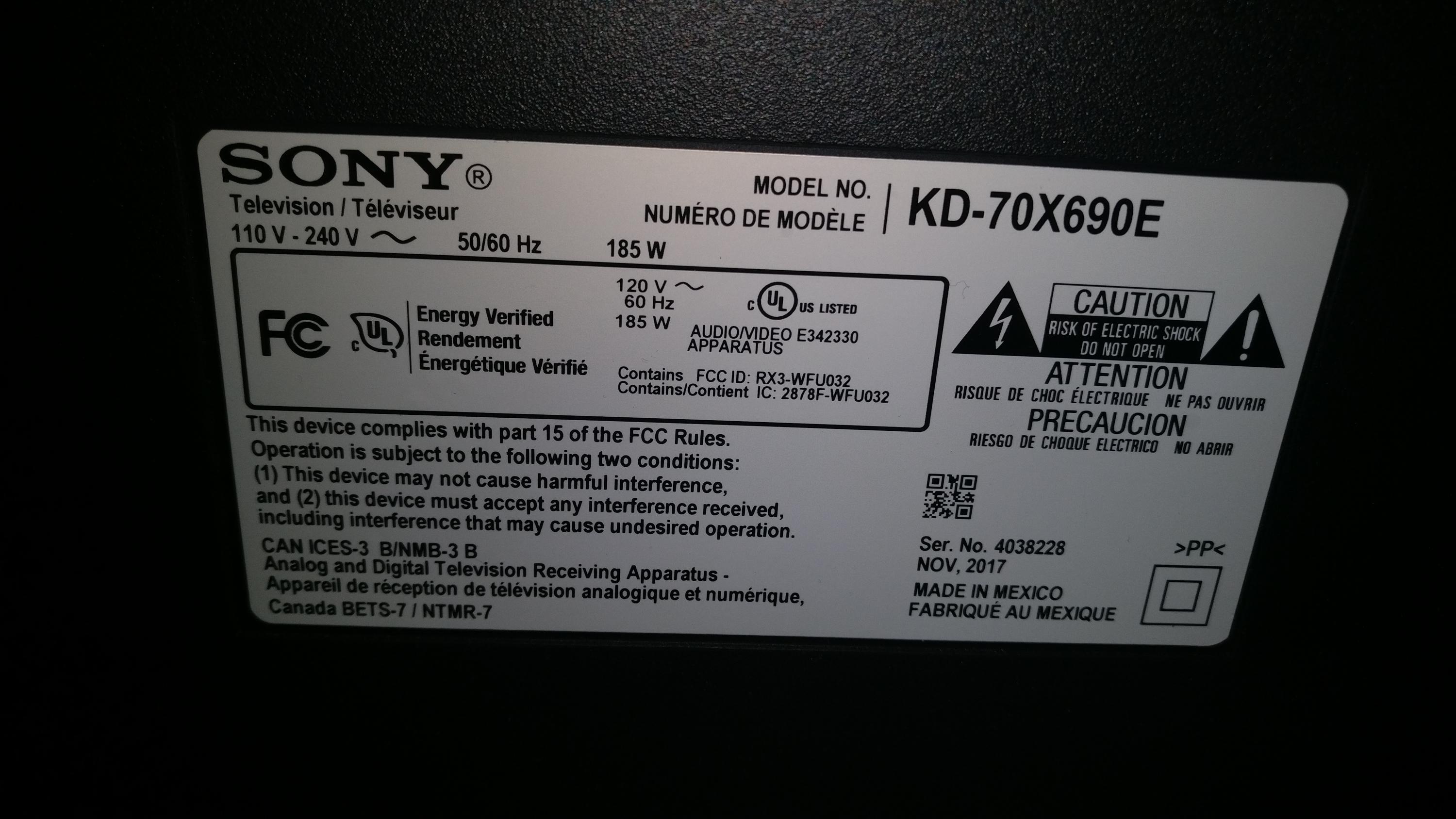

            I have a similar story from this weekend. I paid $200 for a KD70x690e 4k tv the owner said booted up sometimes to a blue screen but that was it. When I went to see it the backlight was strobing just better than once a second. Took a chance and dragged it home.
            Removed the back and reseated a few cables. No more strobing just a "tick tick tick" from the tcon. When I removed the right side ribbon the left side came up and the set was functional. Doing the same procedure for the other ribbon only made the tcon tick again.
            For a smaller set I may have been satisfied with a bad panel or at least the feeling pressing on would not be worth the effort. But this was a 70" Sony 4k so I thought maybe I would be rewarded by finding a shorted mlcc on the driver board. (the drivers are protected by a steel plate that runs the length of the tv and it wasn't clear to me how to remove it but I got it eventually )

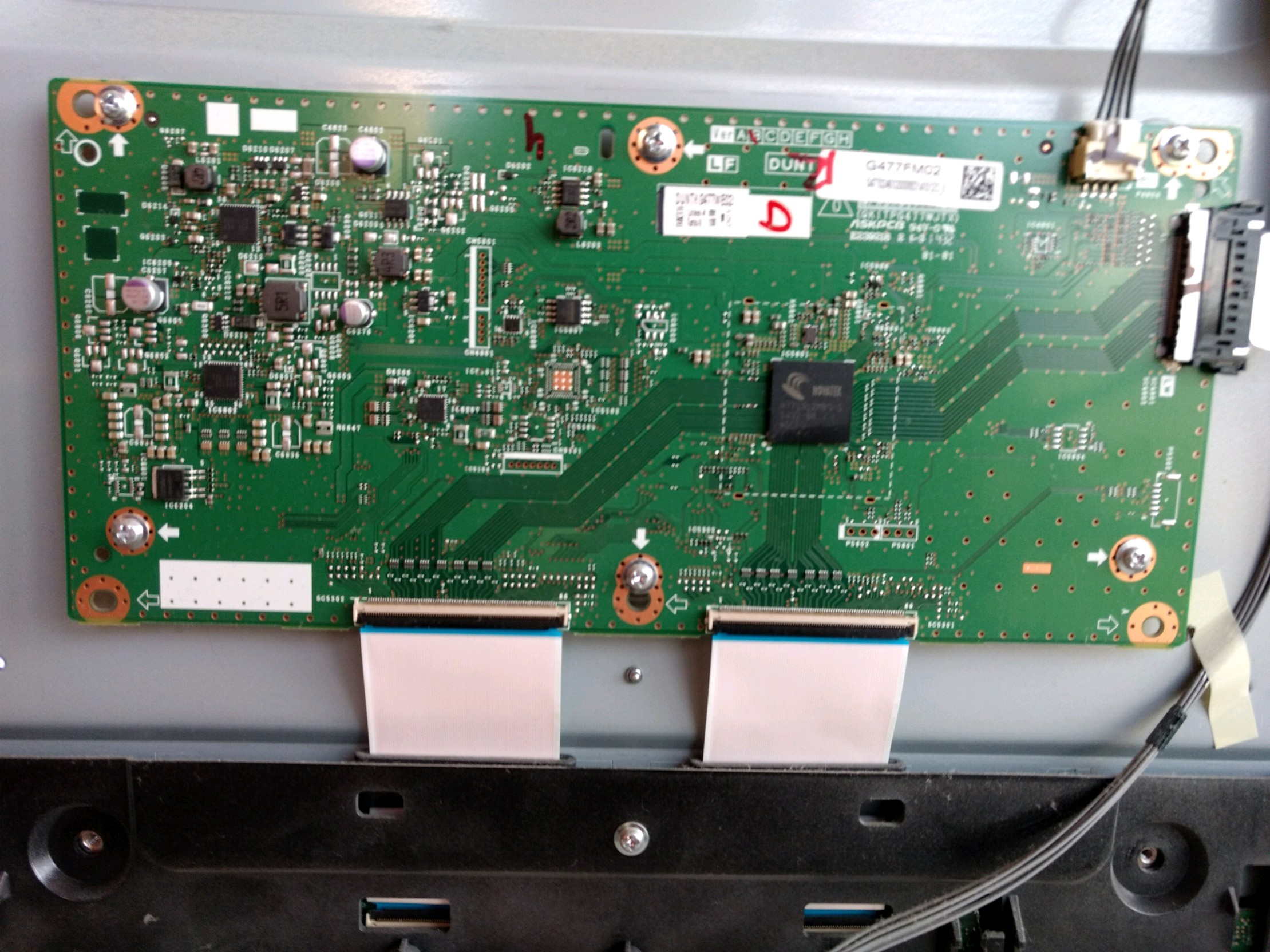

            There are two driver boards per side, connected with a FFC between them. On the bad side the cable was askew at the connector. Flipping the latch and reinserting it properly brought the bad side back to life.

                    So I got up this morning, went to turn on the Aquos, the backlights flash and no picture. I tried a hard reset, tried to bypass the error by holding input and volume down while plugging it in and no taco. I did see the backlights flash briefly then a bar about 5 inches tall flash across the bottom of the screen but no backlights behind it.
                    So I took the back off and pulled the ribbon cable from the t-con responsible for the last fault, fired it up and bingo...half a Sharp logo, so I re-installed the right ribbon cable to the t-con.....and the picture has returned.
                    It looks like this TV does have a problem, I just hope it isn't a bad panel that occasionally throws a monkey in to the wrench. I'm also glad I didn't sell this one....I'd sure hate for someone to get one of my TV 's and it come up lame!
                    Either way I'm super stoked up that the picture is back!

                      About 30 minutes later I confirmed the problem still exists with my 6600. Turn it on, backlights flash, no picture. I swapped the 6600 main board with the 660's, turn it on, backlights flash, no picture, problem still exists so I removed the ribbon cable from the right side of the T-CON, powered it up to clear the error, power off, re-connect the ribbon cable, power back on and the Sharp logo comes up...but it's stuck in "boot loop", logo, black screen, logo, lather rinse repeat. Looks like the 660 main board needs an EEPROM?
                      Once I re-installed the original main board and re-set the error like above I installed the t-con from the 660 in to the 6600 and confirmed it works! I used the TV for about 30 minutes and shut it off. The plan is to wait several hours and see if it will turn on.

                        Refused to turn on this morning. Replaced flat cable on the right side of the T-CON after cleaning the connections on the right buffer board. Turned it on and the screen started to go scrambled but straightened out after a few minutes. I think there may have still been some liquid alcohol in there, but once again we will see.
                        It's looking more and more like a bad panel. I hate to say it.
