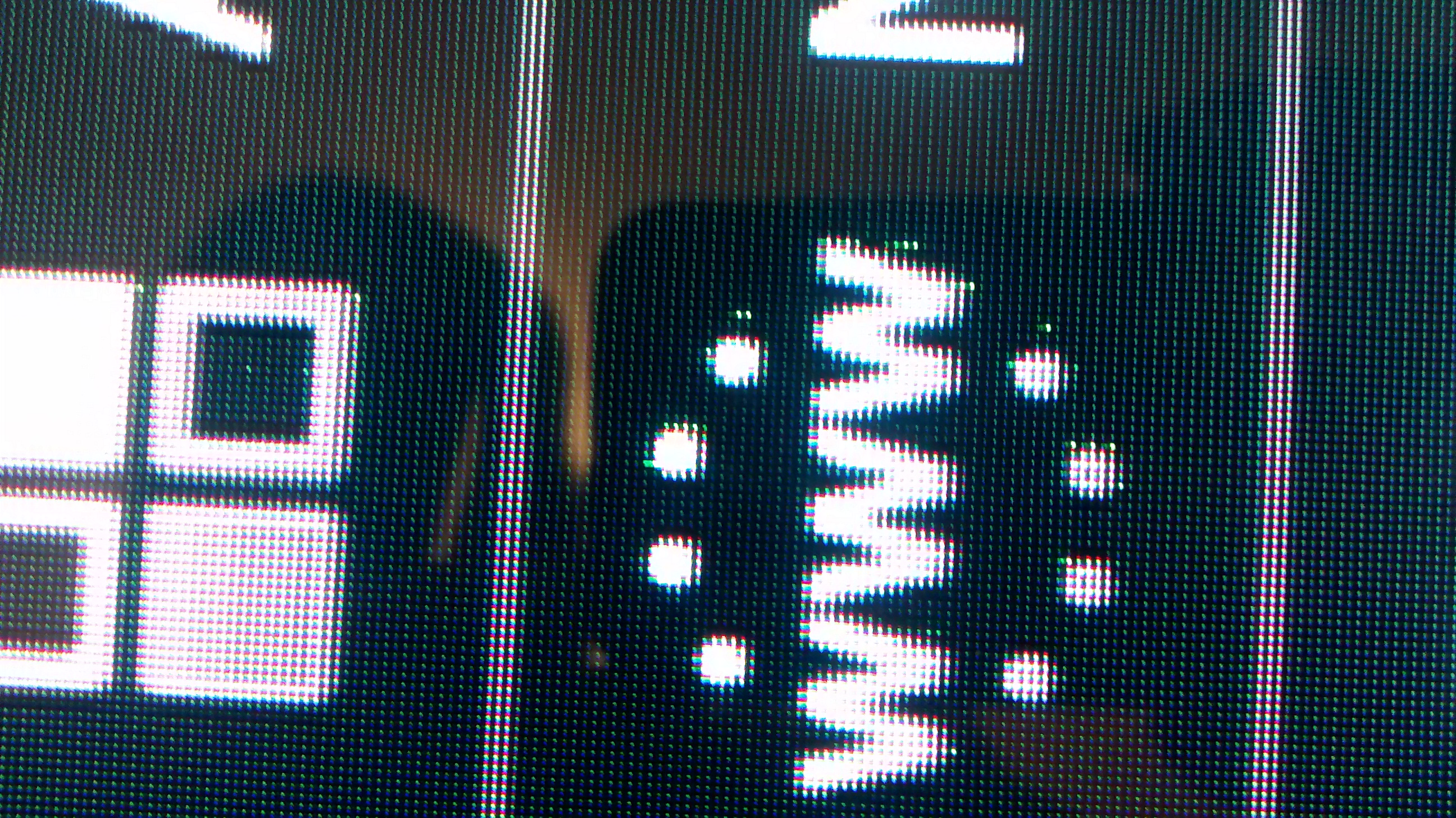

    This TV has vertical green lines whereever there is supposed to be black.
    There is also some smearing effect.
    I'd say it looks like a panel failure but maybe somebody has some good news for me?

        yes, it also shows on menu. whenever it should be black I suppose... In the attached pic the little green dots are not supposed to be there....
        The smearing effect makes me think this cannot be caused by TCon or others..
        On TCON my VGMA voltages are good (in sequence).

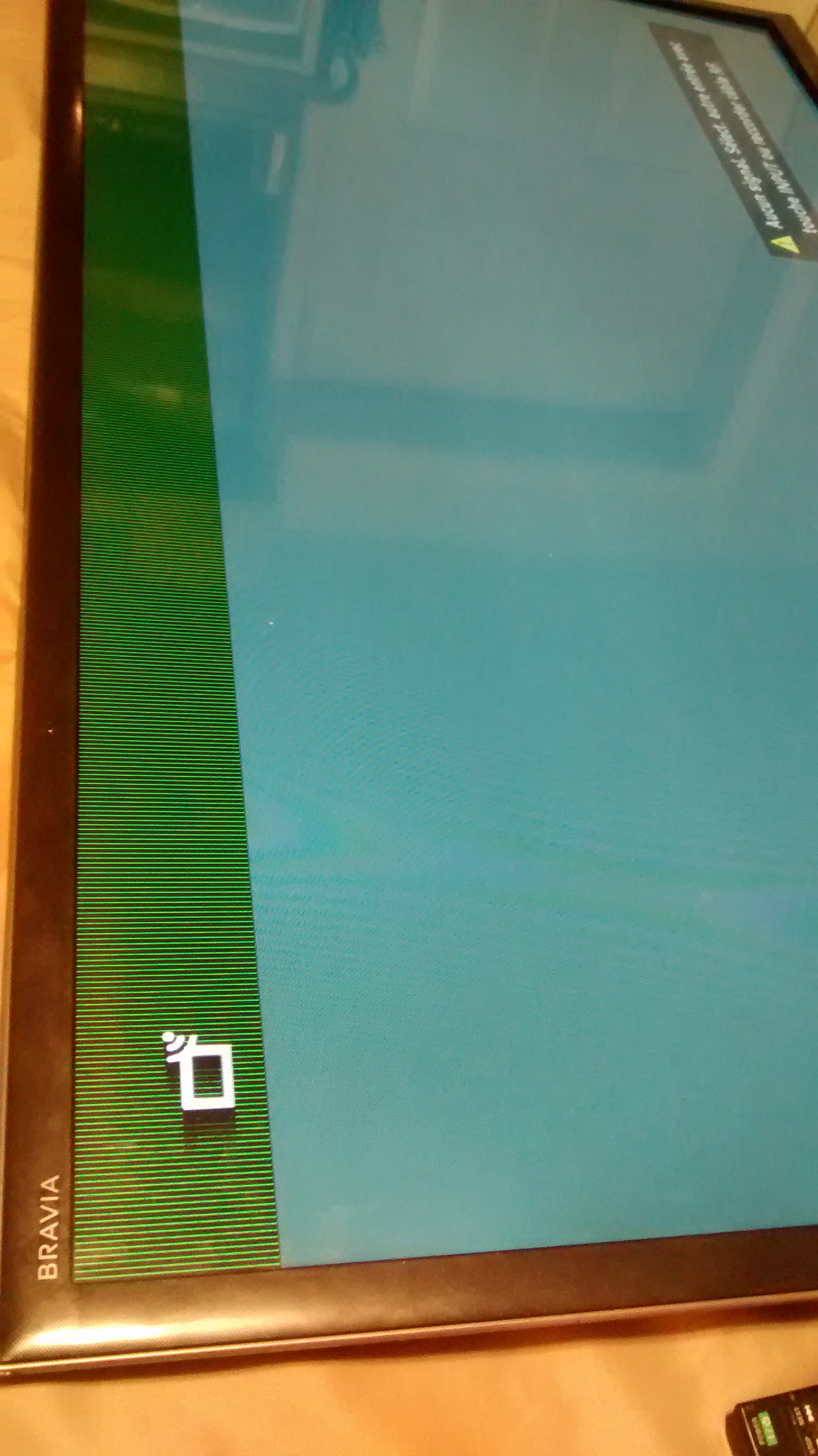

          Its hard to interpret from that pic as to where on screen the problem is showing. Its certainly unusual and doesn't look exactly vertical but more like a scan pattern left to right down the screen to the very definite cut off point.

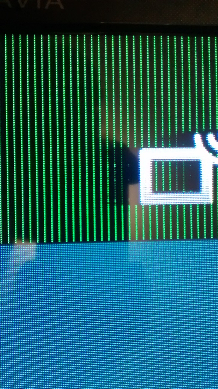

            ok here is another pic.
            The moire is due to my cellphone camera. It is vertical green lines.
            The appear anywhere where it's supposed to be black. Like when I turn on the TV for a second while there is no picture yet the whole screen looks like this.

                        you could do yourself a BIG favor if you input a KNOWN test pattern... like smpte color bars / test chart. Then post a picture, you will get a better "guess" as to the issue... although there is little chance that a panel issue will cause such a "uniform disturbance" on black areas across the panel without other things obviously happening.

                              I'm somewhat intrigued that the logo shadow seems unaffected with the green dots seemingly under it. What affects the LCD ? Well if on all inputs then first thought is tcon with service menu settings next in line and that leads to test pattern checks as budwich has suggested before tcon purchase.

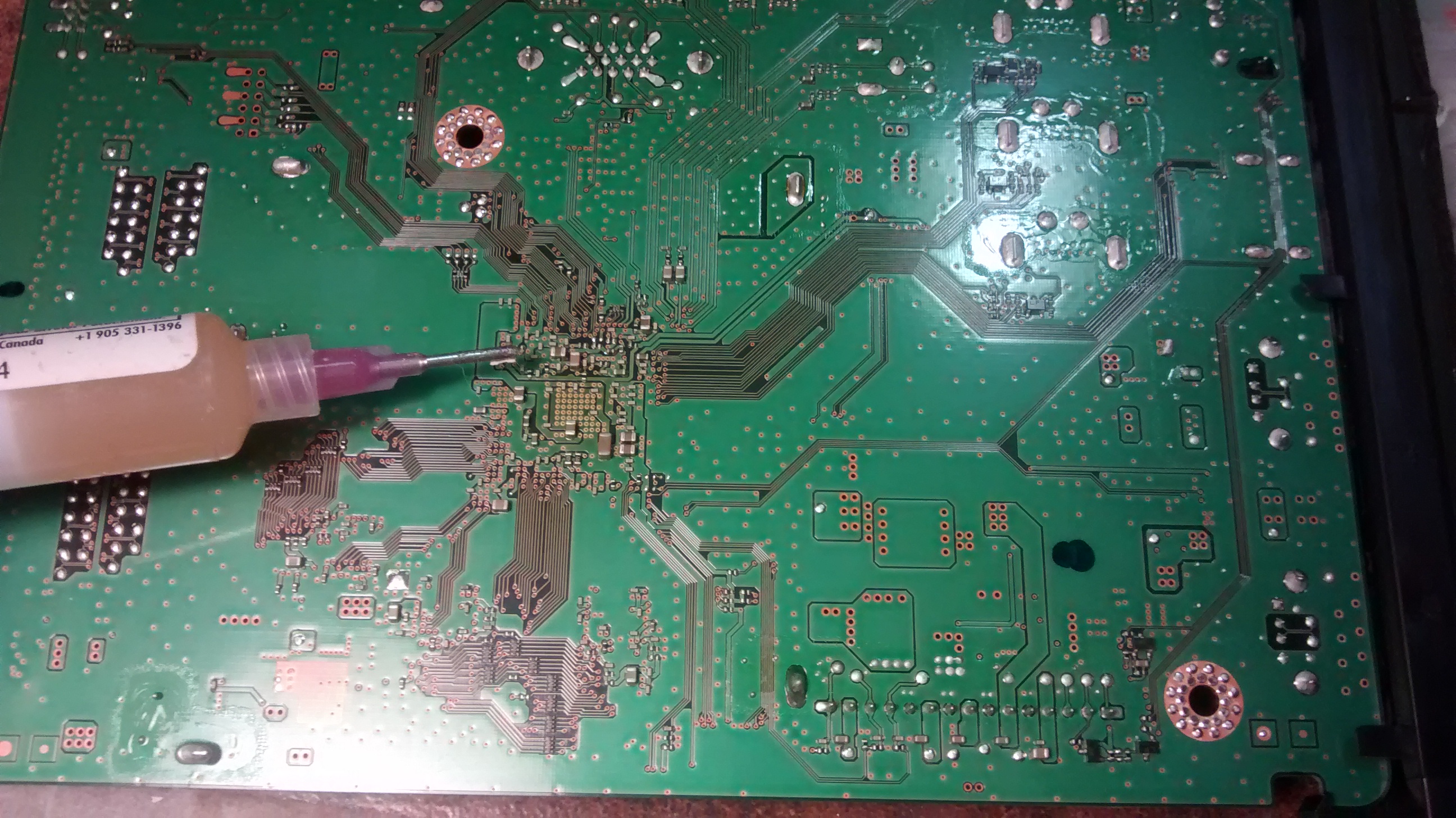

                                Finally it's an area under a processor on the mainboard that is sensitive to heat/cold but not to bending/pushing... Sometimes the picture is ok sometimes not
                                Gave it a hot air solder station sweep but didn't work. Now I first have to ask the TVs owner if he wants to take the risk attempting to repair the board. Probably an BGA chip (it's under a shield, not visible) or some via or some ceramic capacitor etc.
                                This gives it some closure at least and I know it's not the panel. Learned something
