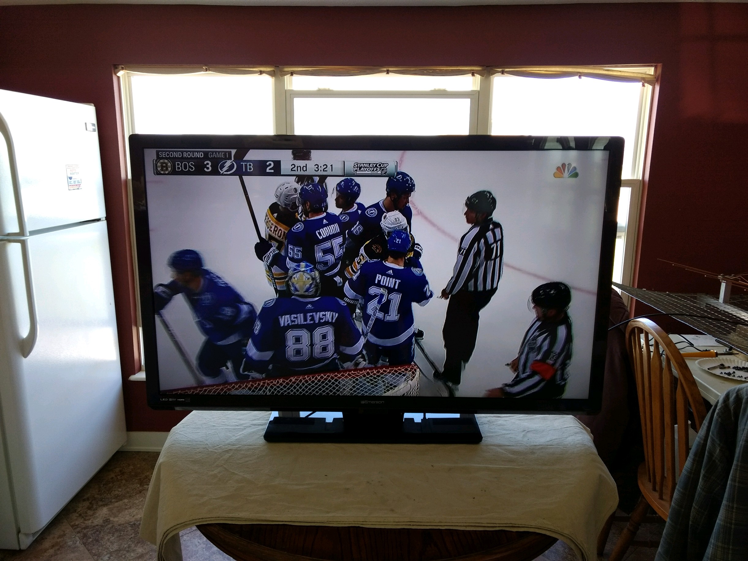

    I picked up this Emerson LF510EM4A last night with a broken screen. I got the same model TV from a Laundromat about a month ago. It had bad LED's and a good display screen.
    When I checked the panel part numbers they were the same!
    This morning I started swapping the screen. I tried lifting the broken one by hand. It flexed and cracked right down the middle. That's when I said it's time to go to Harbor Freight and get a couple suction cups.
    After getting them I took apart the Laundromat TV, suction cupped the screen and it came out and went back in perfect!
    The moral of the story: suction cups are a must for screen removal and replacement! They're just as handy as a bag around bread, a can around Pepsi and a pocket on a t-shirt!

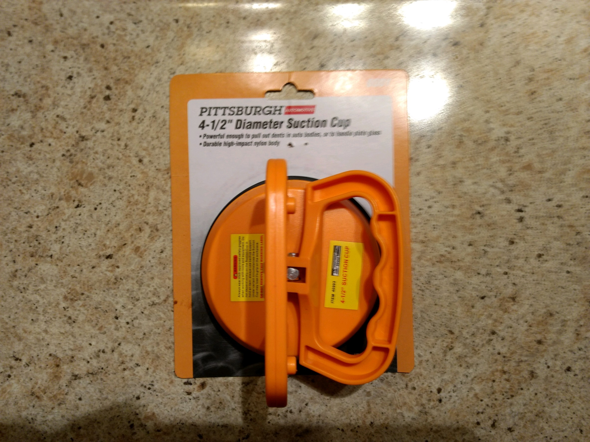

      What suction cups did you get? pictures? Thinking of getting some,I got a few 60" and a 55" curved that I have been stalling on in fear of crcking the screen.

        Here you go!
