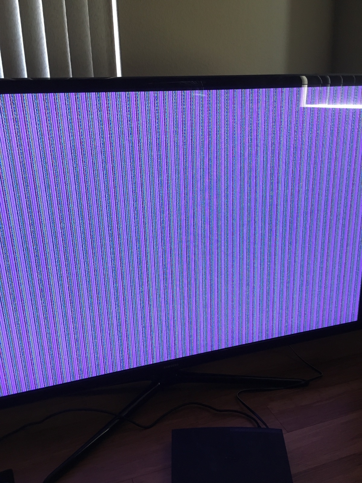

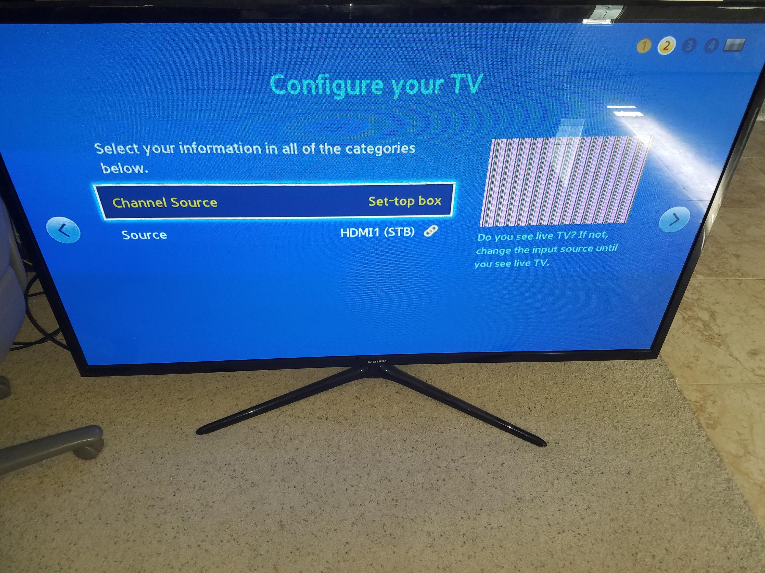

    Hi folks, just turned on my spare bedroom TV and found this... any idea where to start? Barely 2 years old Plasma TV

    Search the site to find how to run the self test patterns. If the test patterns run OK then it would look like a mainboard fault
      Re: Samsung PN60F5300B colorful panel
      Looks like mainboard fault. NVRAM. Yes run test patterns on logic board.

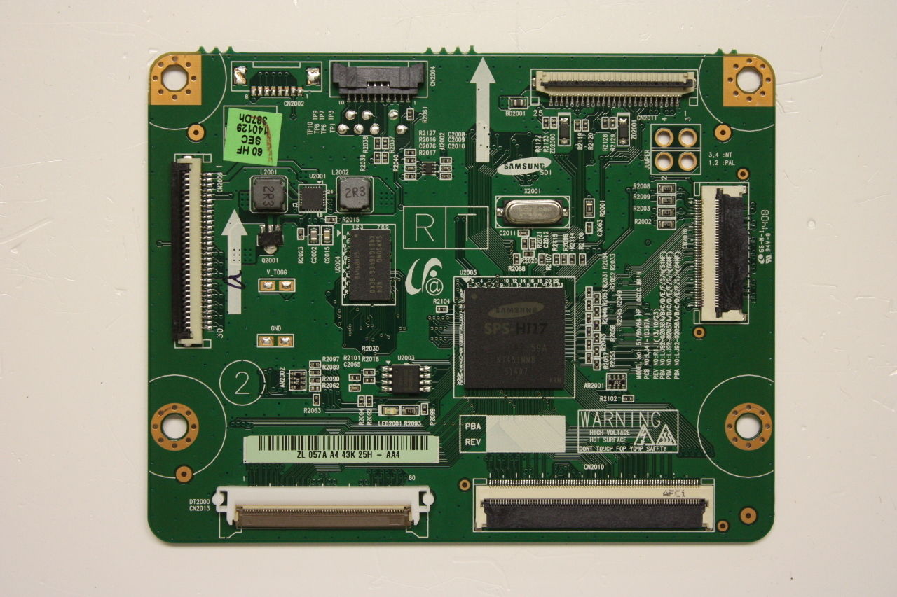

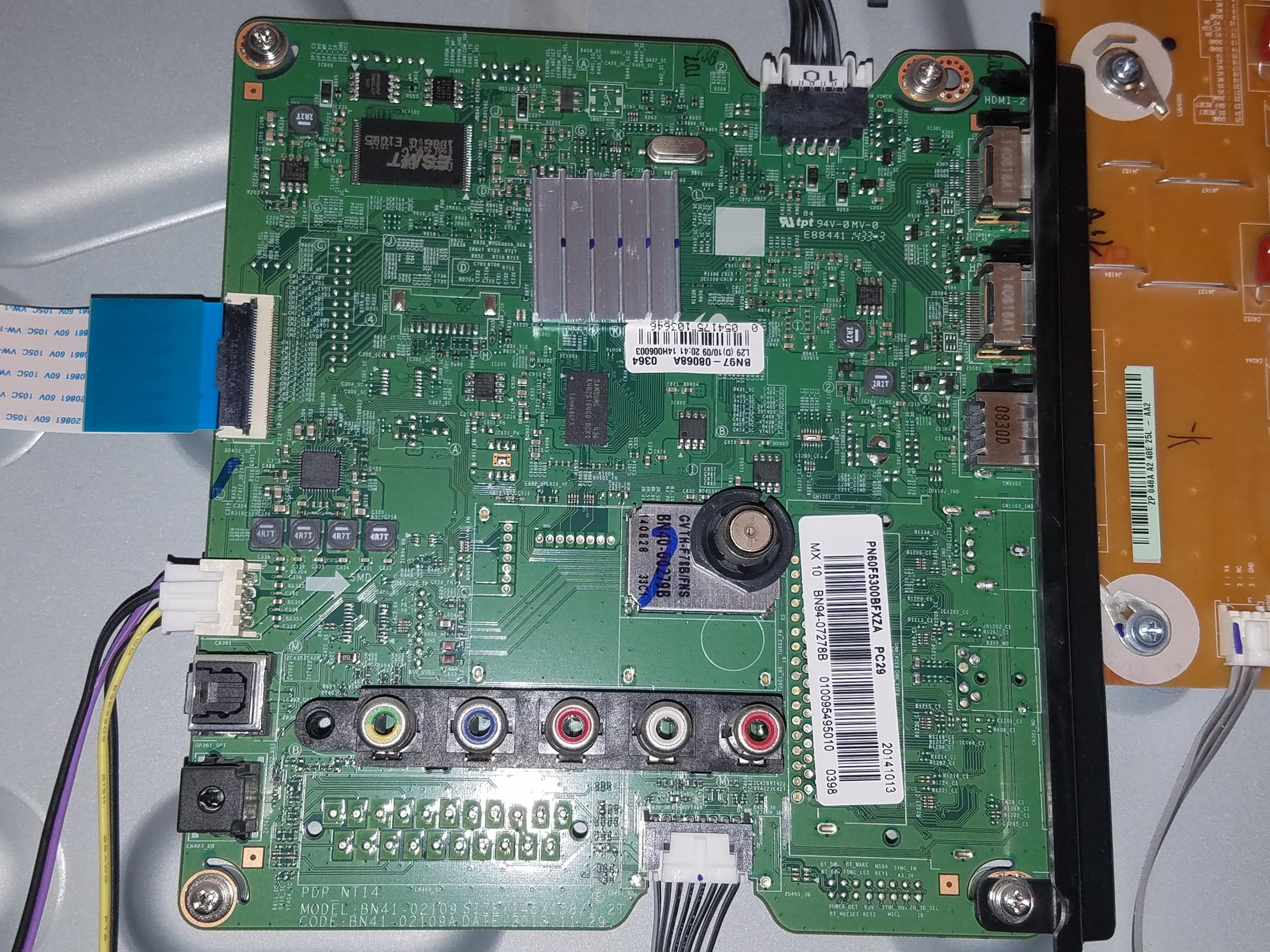

          Can you can post pictures of your boards which would be helpful. It may be integrated on the mainboard.
          Does this match your set?
          https://elektrotanya.com/samsung_200.../download.html

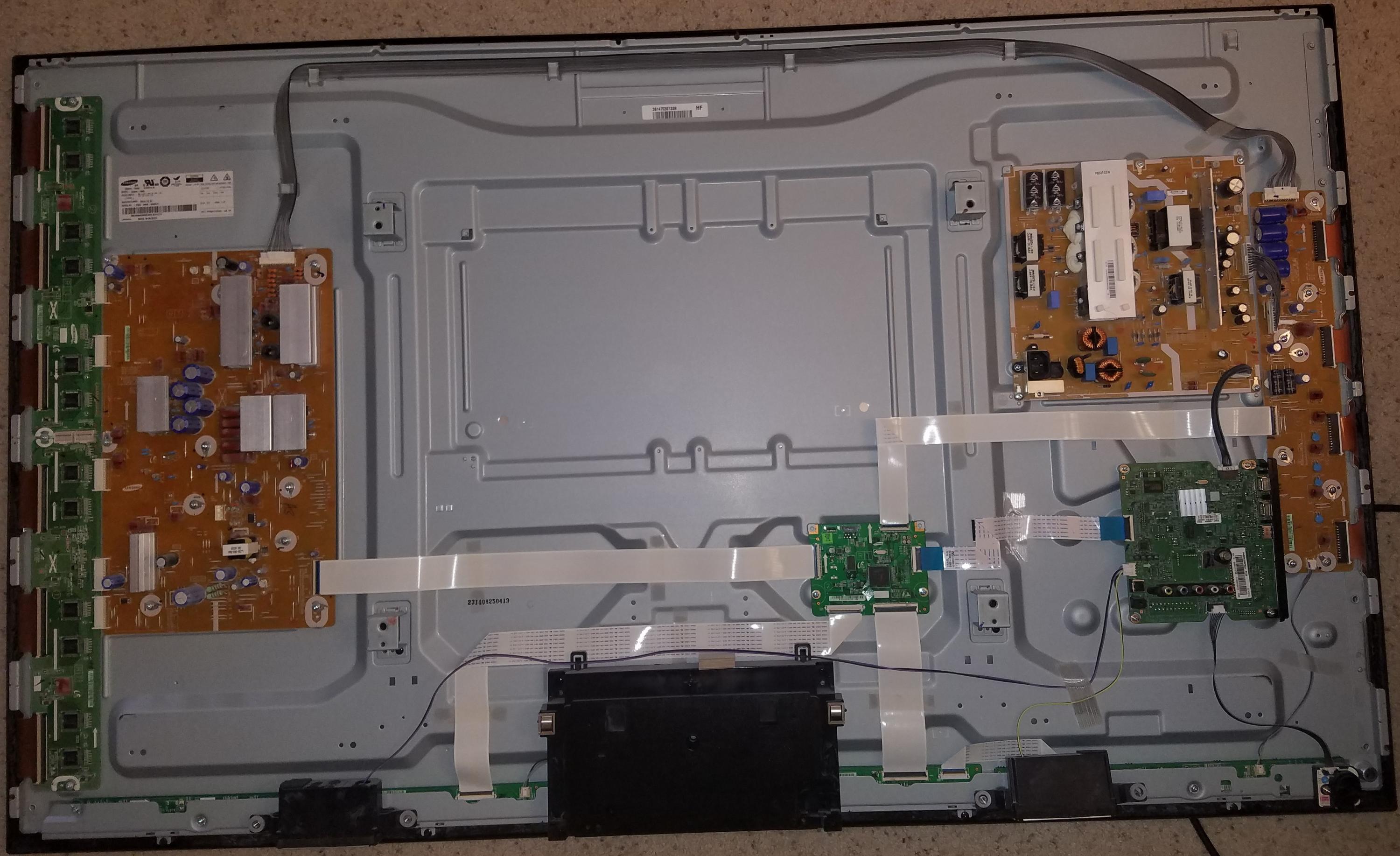

              Haven't had a chance to open up this beast.. but looking at the photos, does anyone with Plasma expertise know if this is a main board / Logic board issue?
              Menus seem to be fine, it's just video / audio sources are corrupt it seems. The "Test picture" as part of troubleshooting seems to show the same corrupt image. I'll get the boards pictured tonight
                Looking at the first picture I would think there's a fault on the mainboard, however I would wait to see what others think since I'm no expert. Have you tried inputting a signal on any other input, ie HDMI, AV, USB?
                Is this your control board?

                  Hi Dick_Barton.. Yes the very first photo is the photo of a DVD connected to HDMI1 / or HDMI2. When source is not detected, it's just a solid black screen

                    Is the circuit board in post#8 the same as in your set?

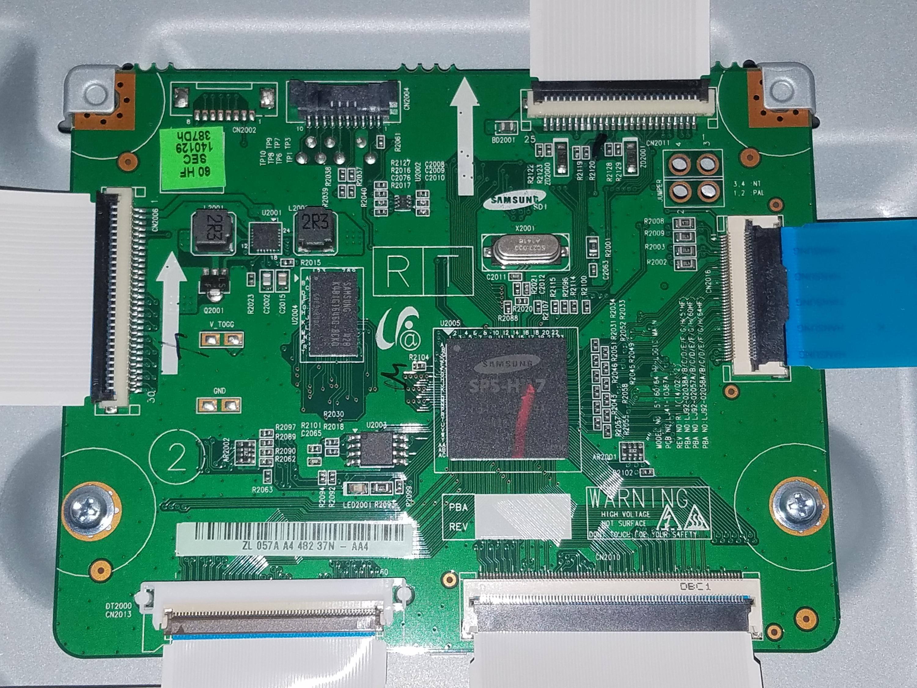

                      here is the beast without a cover on. Jumper 3 4 is labeled NT. Is this the one I'd short to get the test pattern?

                        Just shorted 3 and 4 pins, disconnected the LVD Cable.. and I got the full screen colors, white, then red, green, then gradiant, vertical horizontal diagonal.... so on..
                        So I guess that says it's the main card?? is it a reflow of bga issue, or Flash chip replacement?
                          It generally points to a faulty mainboard if it runs the self test with the mainboard disconnected and the pins on the control board shorted.
                          It tends to very hit and miss when heating up the mainboard and often if successful is (but not always) short lived.

                            Thank you. Someone suggested it might be the NVRAM, and Samsusng sell the NAND Flash IC, so I wasn't sure if reflowing is needed or replacing the Nand Flash IC, or maybe another IC.
