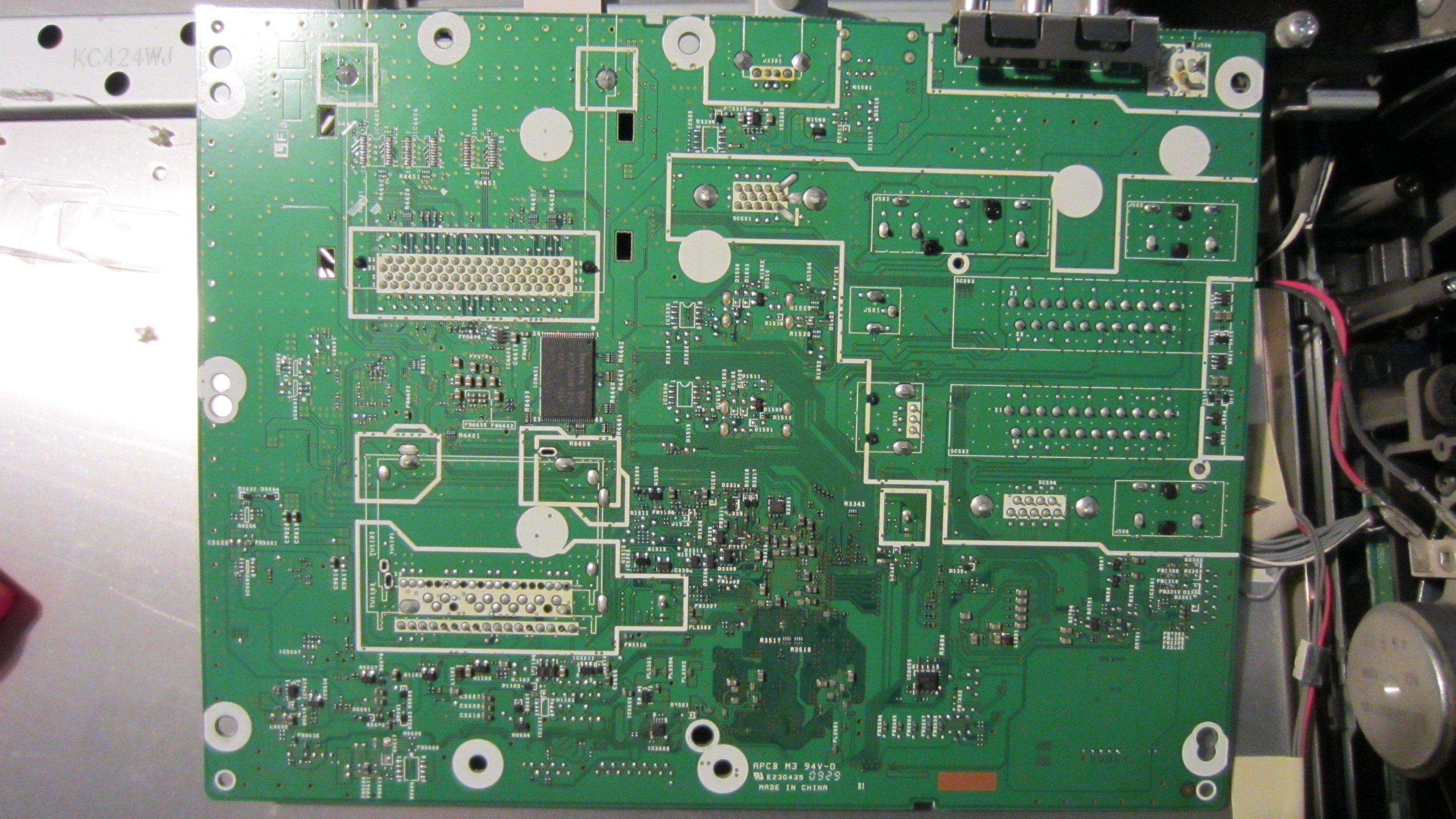

    Hi everyone,
    I've got a Sharp Aquos that is my friends and I said I'd have a quick look at it for him.
    He's owned it from new for about 8-9 years.
    It recently developed a fault where it will not turn on anymore - the red standby light comes on but that's it...no flashing codes here unfortunately.
    There is also no sign of the backlight flashing, or anything on the panel when viewed with a torch.

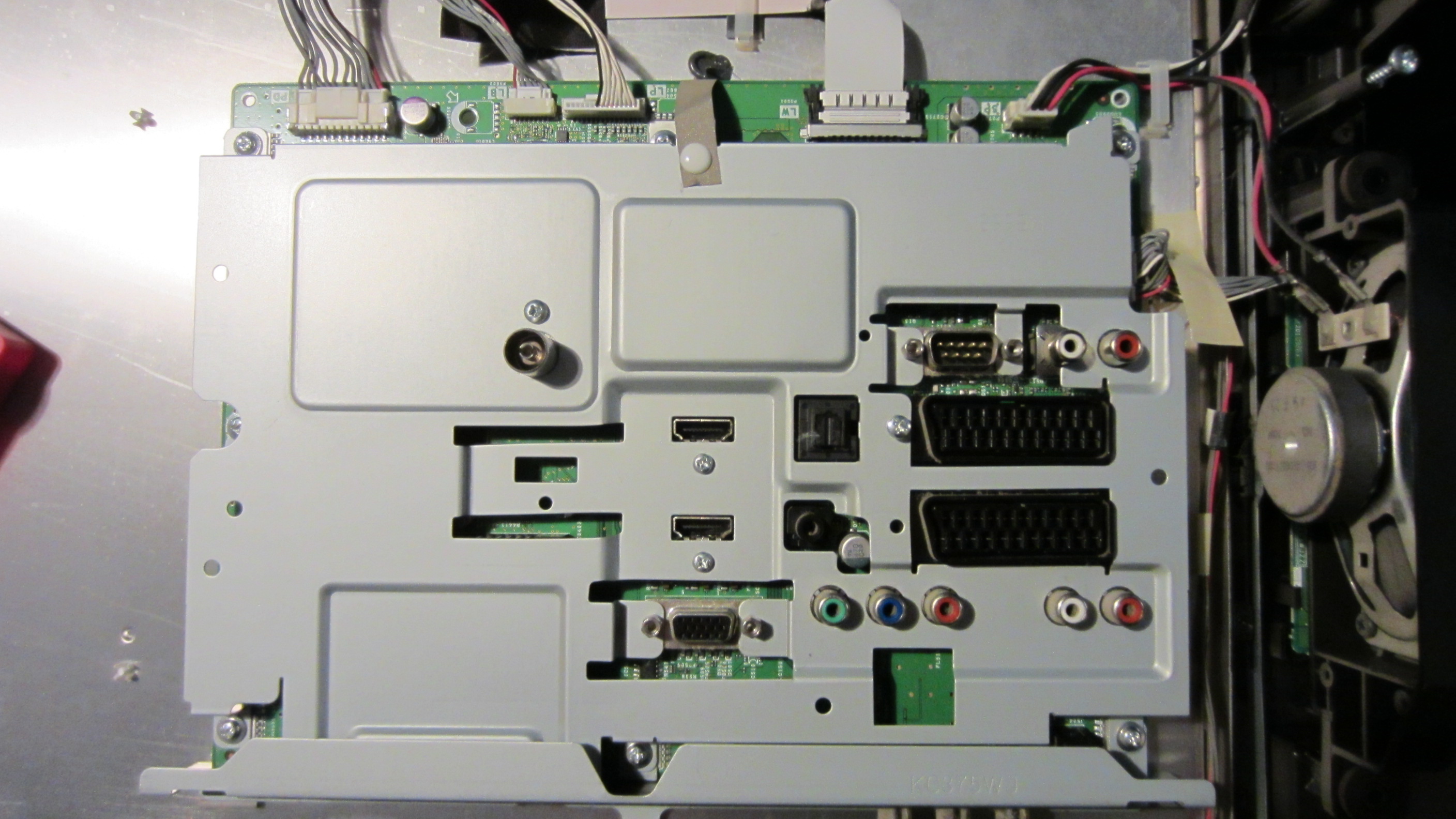

    I've done some very basic checks on the power board and main board.

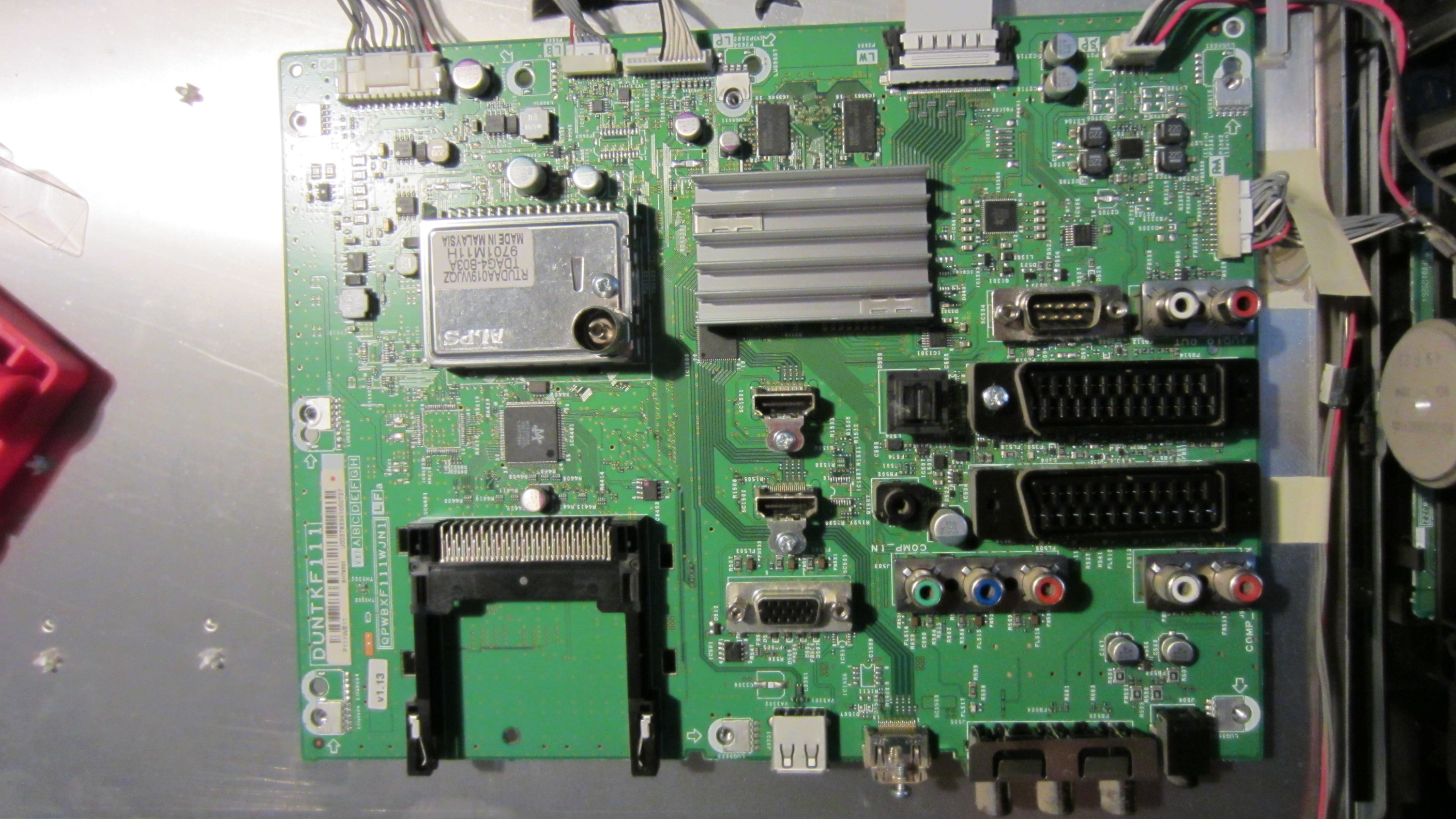

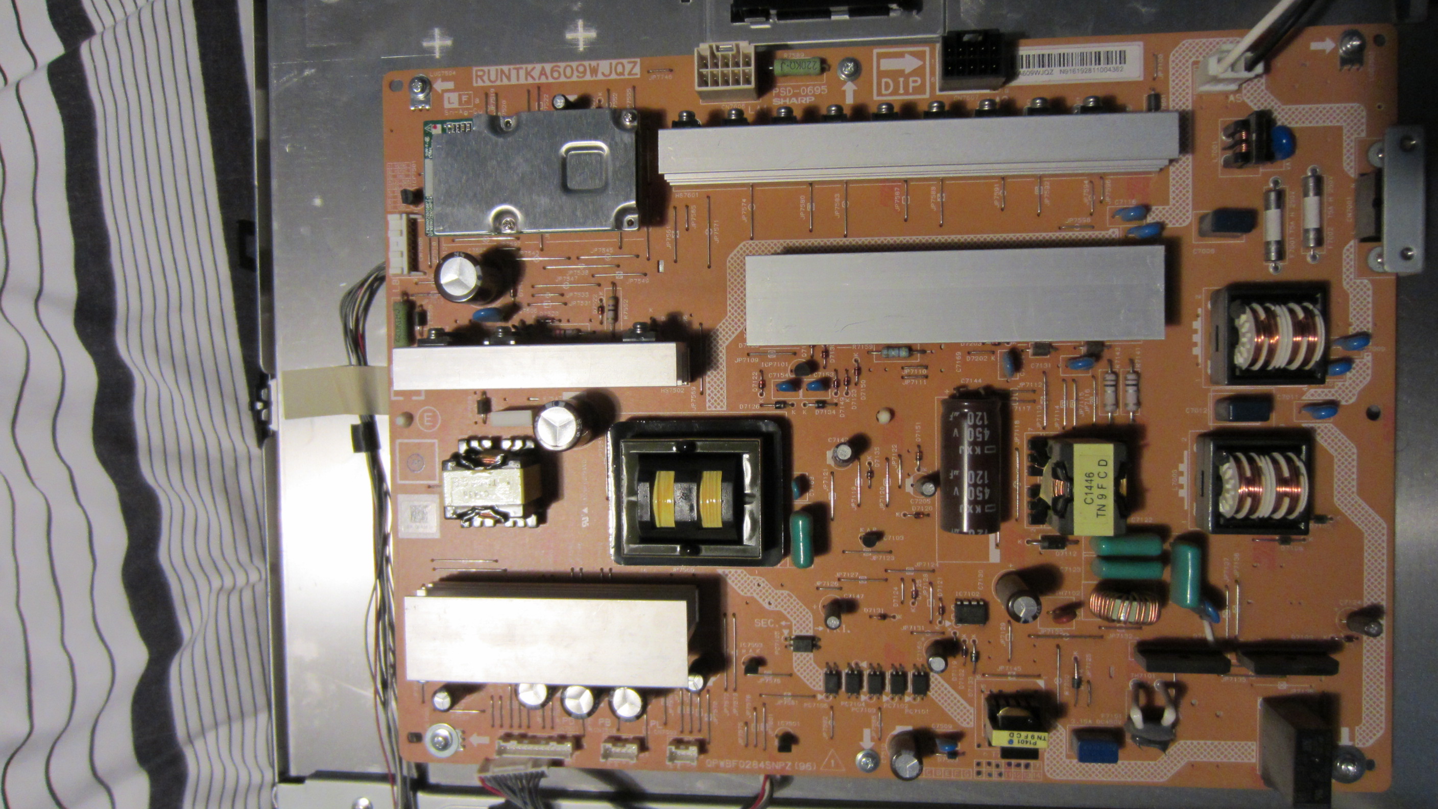

    • Power board is marked RUNTKA609WJQZ.
    • Main board is DUNTKF111

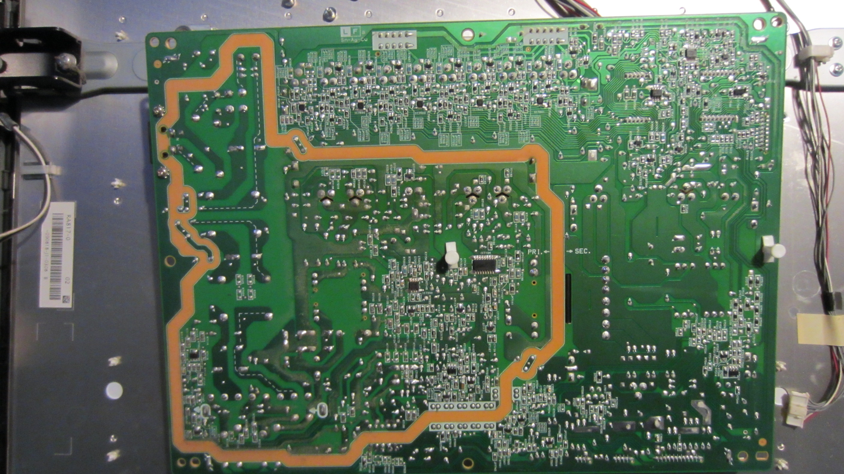

    If I power the unit on and probe the power board I can see that:
    1. CN7501 - BUS5V goes to 5V
    2. CN7501 - PS_ON goes to 2.57V
    3. CN7501 - AC DET goes to 3.3V
    4. CN7501 - PNL_POW stays 0V
    5. CN7501 - UR_13V goes briefly high then immediately decays to 0V
    6. CN7505 - PNL_12V stays 0V
    I've checked the big electrolytic C7144 and there is 400V DC across it.
    If I leave all plugs in but remove the backlight, the voltage at UR_13V still collapses.
    If I unplug all the boards and backlight, and jumper PS_ON to BUS5V I get UR_13V to go to 13V. PNL_12V stays at 0V.
    Any help gratefully received!
    Re: Sharp Aquos lc-40le600e stuck in standby - no lights flashing
    "If I unplug all the boards and backlight, and jumper PS_ON to BUS5V I get UR_13V to go to 13V. PNL_12V stays at 0V."
    You will need to also jump PNL_POW with resistor (470 ~ 1000 Ohms) to BUS5V to force on the PNL12V (no cable from PNL12V to T-CON).
      Hi budm, and thanks!
      From your info I've jumpered PNL_POW via a 470ohm from BUS_5V and the PNL_12V successfully comes up now.
      Again, this is with all other boards disconnected.
      I've managed to find the schematic of the power board but I presume we are looking more toward the main board based on this outcome?

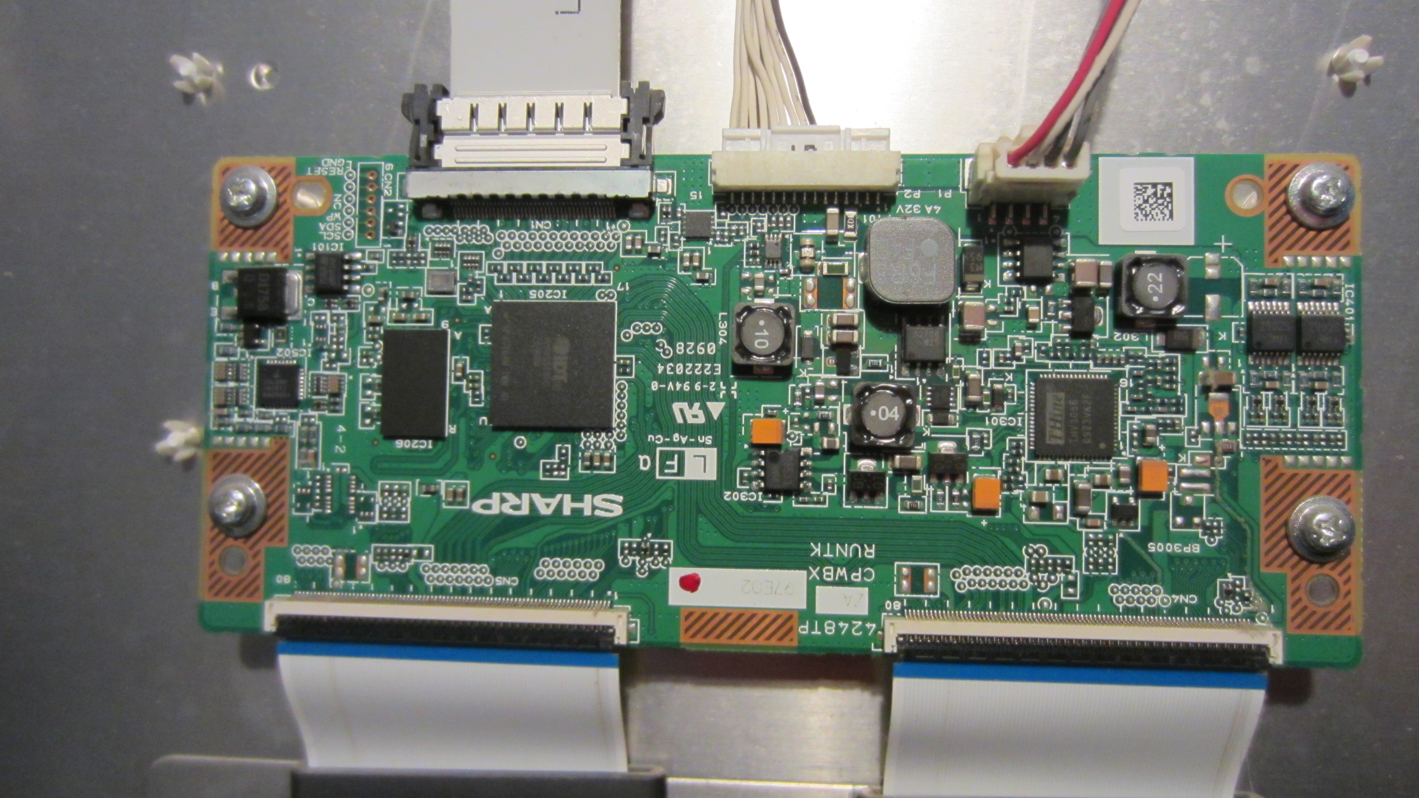

                  I've managed to get a little time to investigate this further.
                  If I remove some pins from CN7606 I can get the unit to go into the service menu with the backlight on.
                  The pins relate to backlight rows 2 and 3.
                  With those pins connected the tv will not turn on or enter the service menu.
                  If i swap the pins such that the backlight pins go to different driver pins on the psu board the fault seems to follow the backlight. So it sounds like the 2 backlight rows are faulty.
                  However if I remove the pins for backlight 2 & 3 and enter the service menu, I can plug the pins back in while the set is on (carefully of course) and they all light up. So there are no dead LEDs on the set.
                  Any thoughts please? It sounds like the tv is maybe just too tight with it's tolerances in the fault detection circuit on an old tv?
                      I had done that earlier but it didn't help.
                      But in fact I've just fixed it!
                      So...interestingly (but maybe not surprisingly for some of the experts) the problem was down to a dead gnat/midge in the LED2 connector - at the backlight end, not the PSU end.
                      Once I'd removed that I could power up in the service menu and again reset the status.
                      After that the TV now powers on properly.
                      And fortunately for my friend no new boards required.
