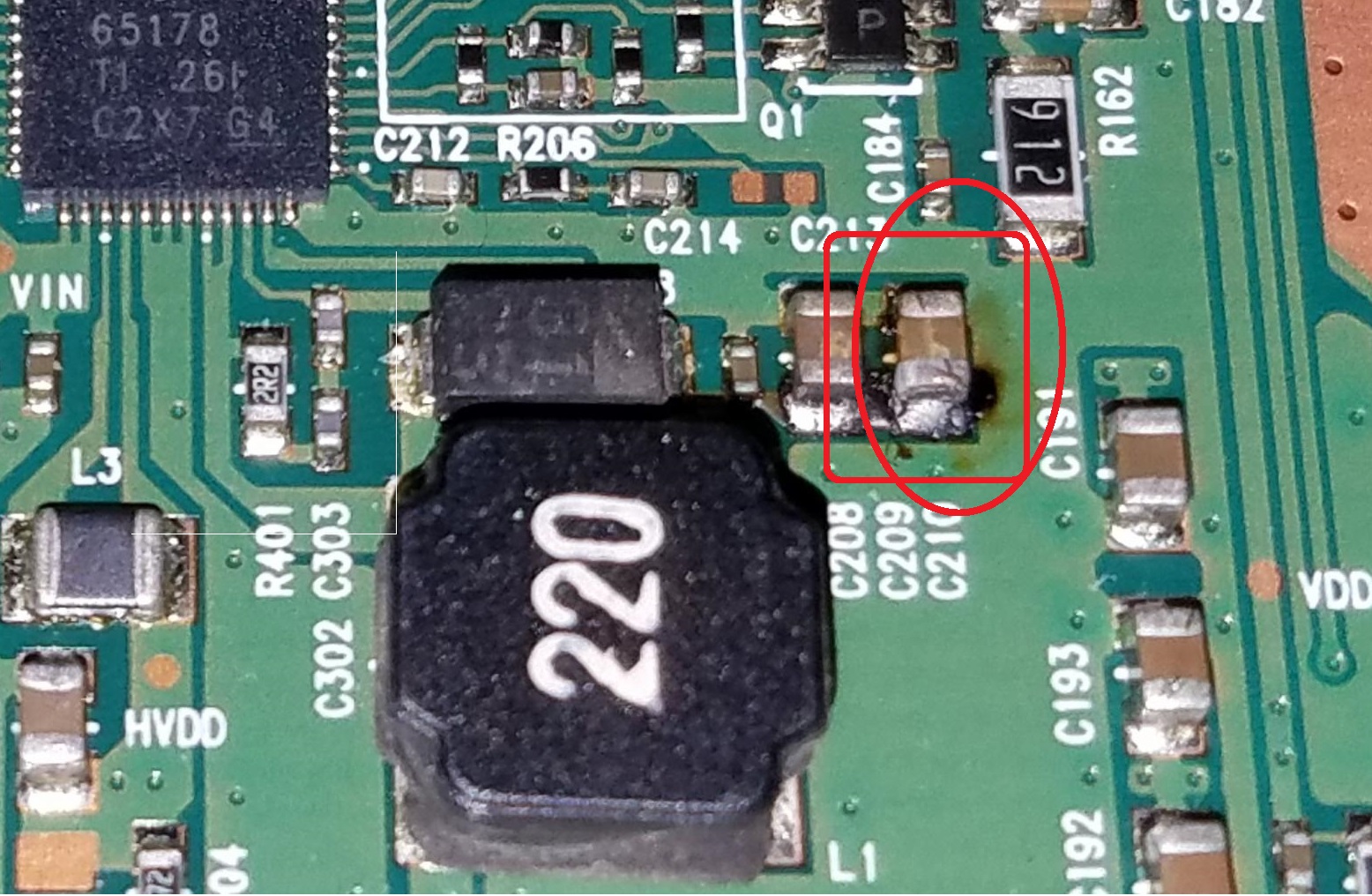

LG 47LM4600 Blown TCON fuse and Main Board Transistor
  • jason123
    • Oct 2015
    • 1060
    Re: LG 47LM4600 Blown TCON fuse and Main Board Transistor
    Thanks.. this helps a lot.. i'll look into the footprint of the SL22
    • jason123
      • Oct 2015
      • 1060
      Just reporting back - Replacement of the FET on the main board went well. Tested the TCON board outside the set with an external power supply (12 V) and current-limited shows a short on the board after replacing the fuse and both Diodes. Though the cap on the output didn't test "short" on the board and passed ESR test, upon applying voltage across it, it goes to almost short. Replacing the cap with a 25V 4.7uF did the trick.
      TV is up and running - Thank you budm for the help
