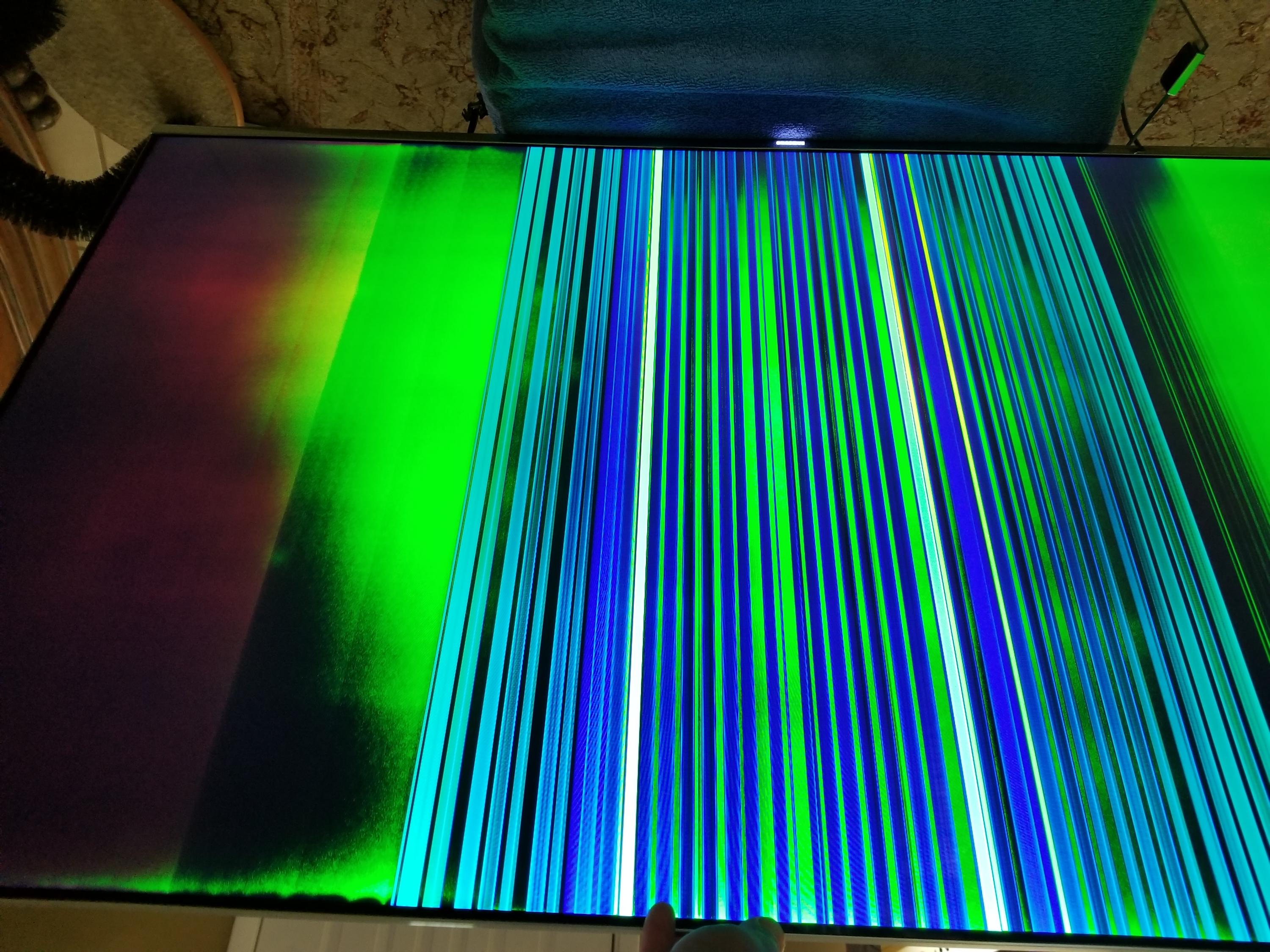

    Samsung UN55KS8000FXZA Bad Panel?
    Just wanting some opinions, or possible main board?

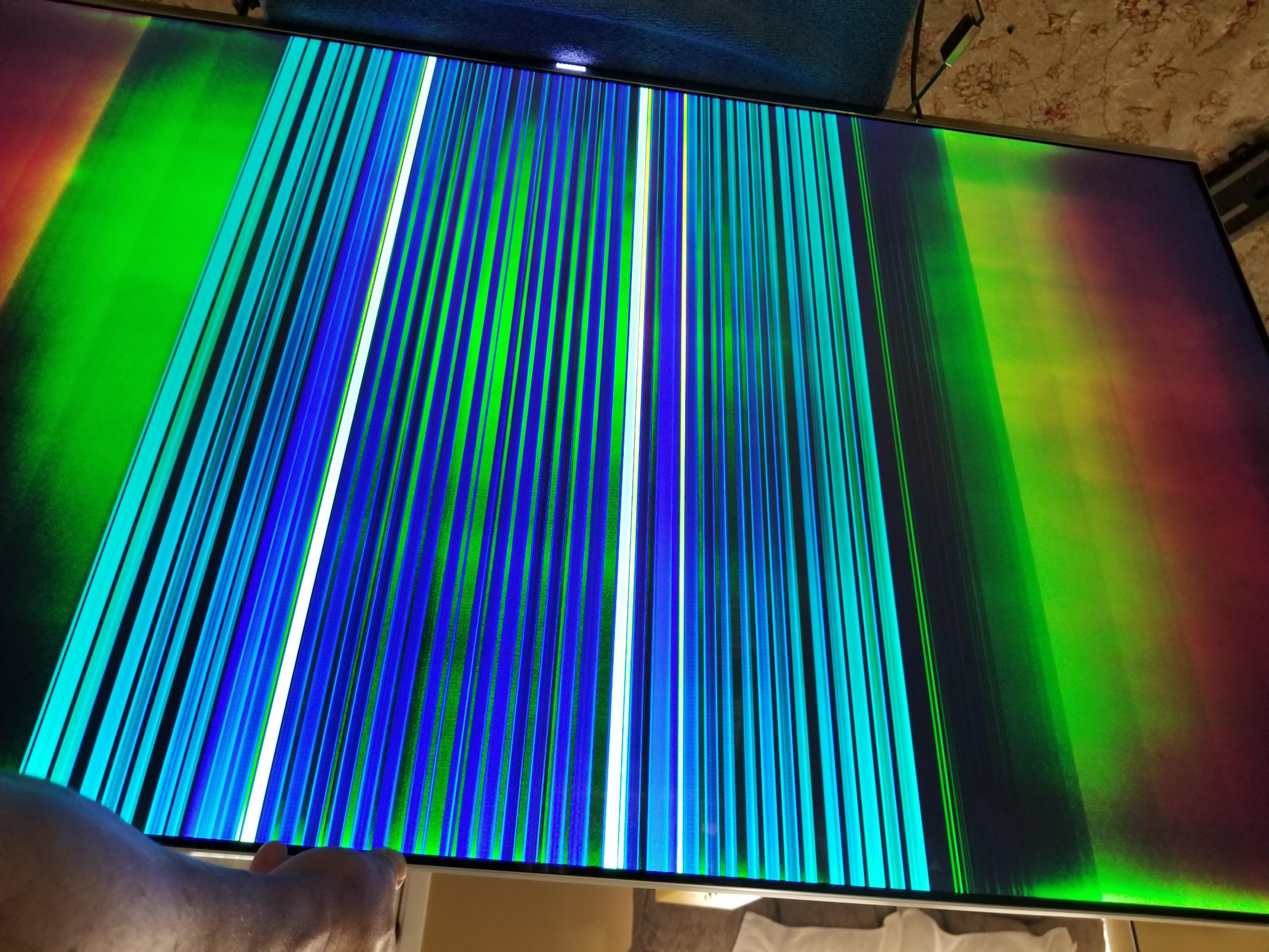

      Re: Samsung UN55KS8000FXZA Bad Panel?
      Vertical, sorry that pic is upside down. Also hazy colors on the sides that come and fade away.

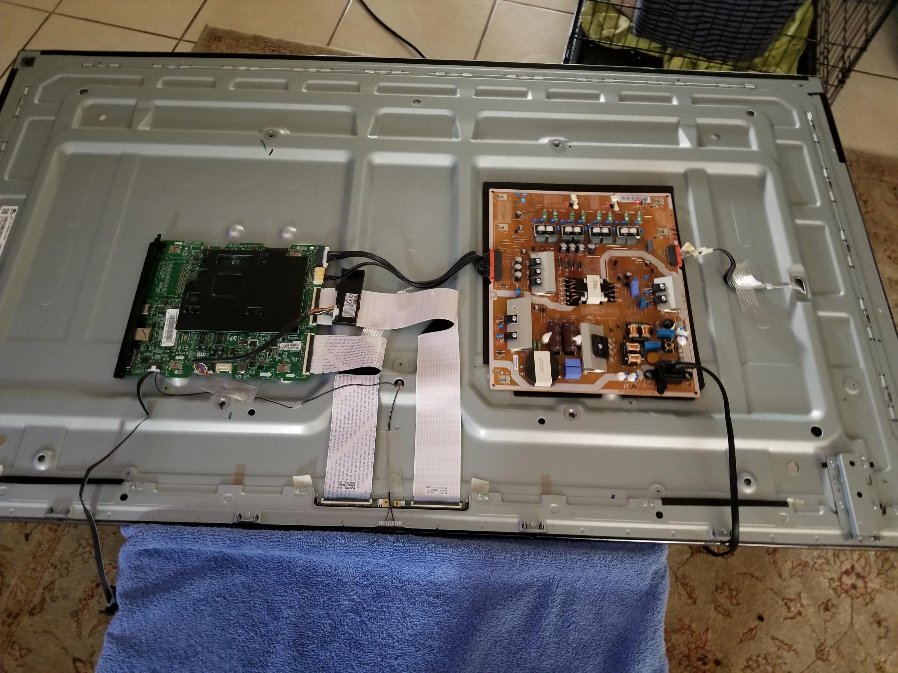

        Maybe try heating up mainboard with a hair dryer, check for changes in picture.
          Looks like some have fixed theirs by flipping the data cable that goes from powersupply to mainboard, bad or dirty connection I guess.
            Bad panel due to those dark clouds on the sides.
              Data cable? Do you mean from the main board to the panel?
                Bad panel was my first thought, the vertical lines looked same as this video, a lot of the replies said it cleared the problem up:
                https://www.youtube.com/watch?v=7-t8rOKHBw4
                  Mainboard to powersupply board.
                    Dark patches of dark clouds are the give away for bad panel.
                        It's the cable going between the two big boards.
                          I understand that, but that does not carry any video data as far as I know. They had an issue with the TV cycling on and off which makes more sense though.
                                I try one ribbon cable at a time that goes into the panel. Yuck
                                another LCD with tcon embedded.
                                  Tried that, won't stay on without both ribbons connected.
