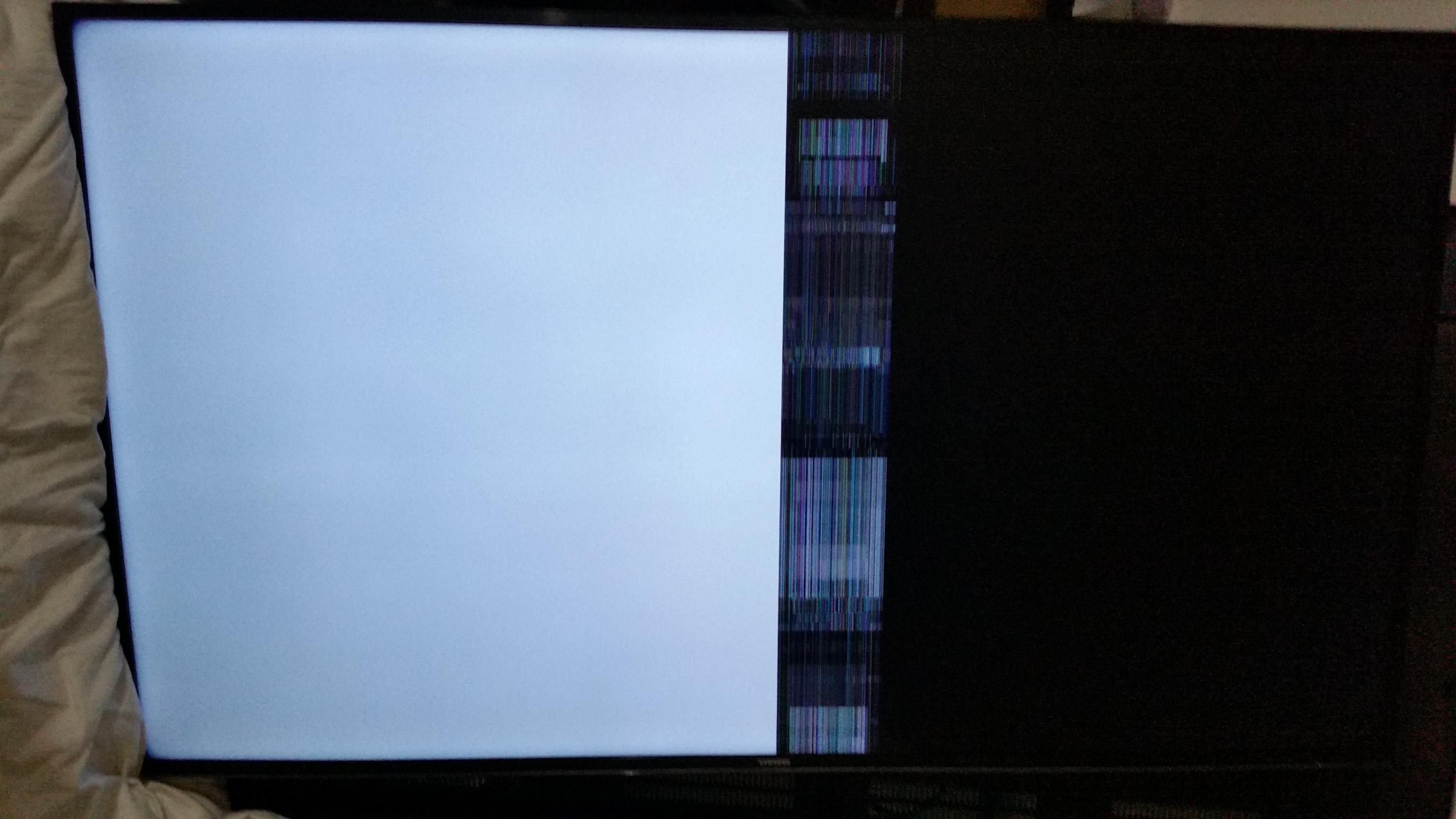

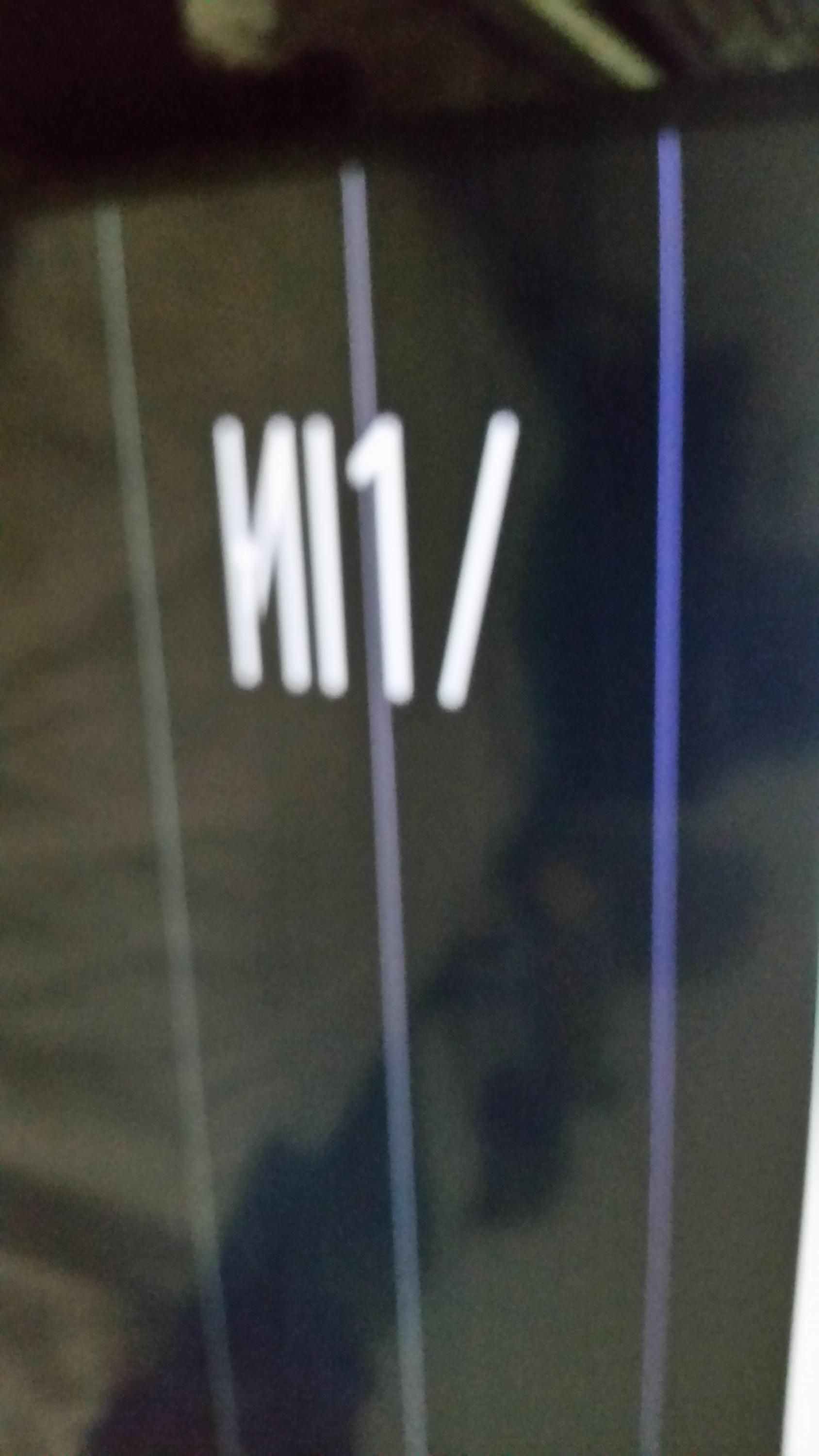

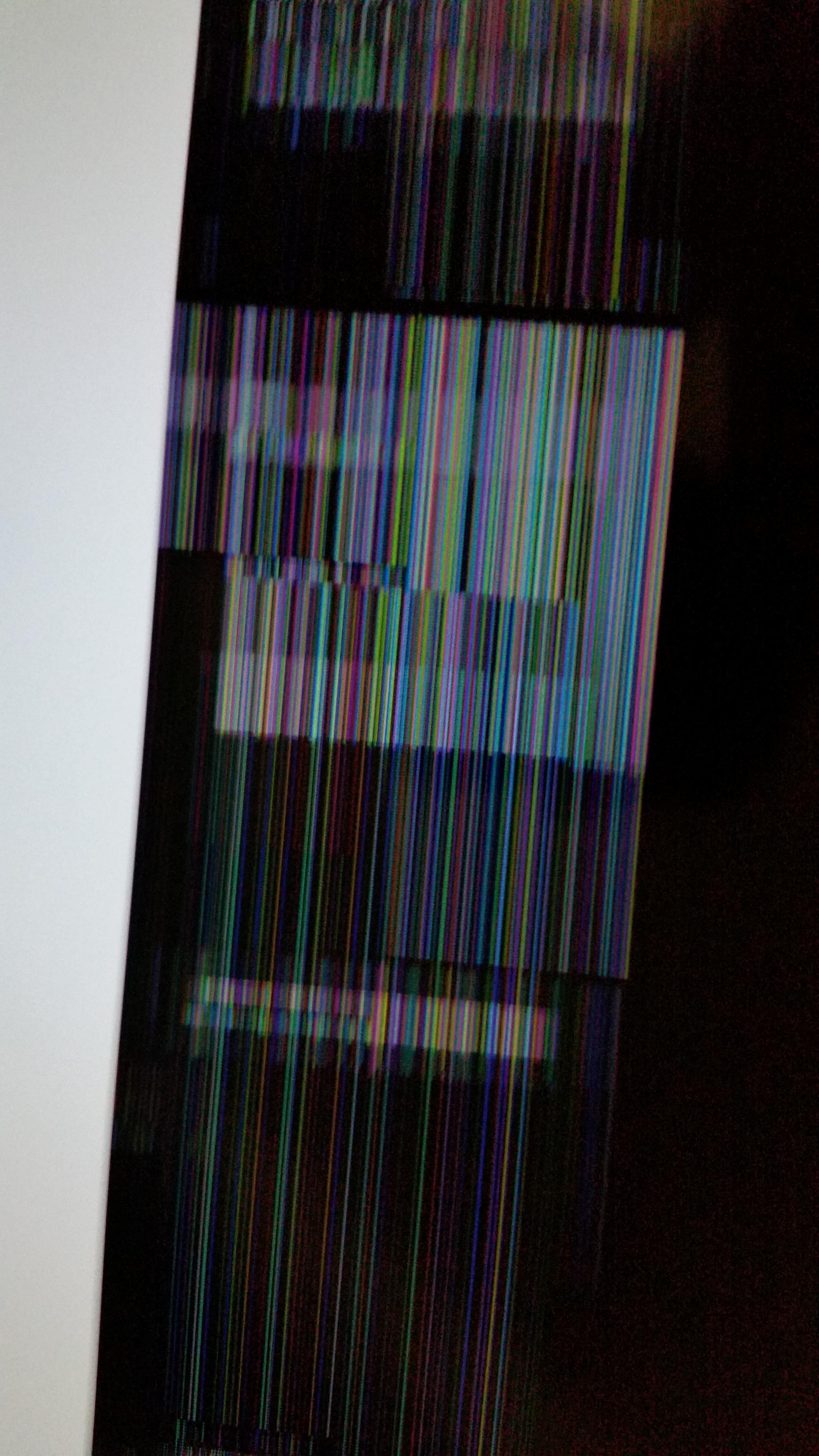

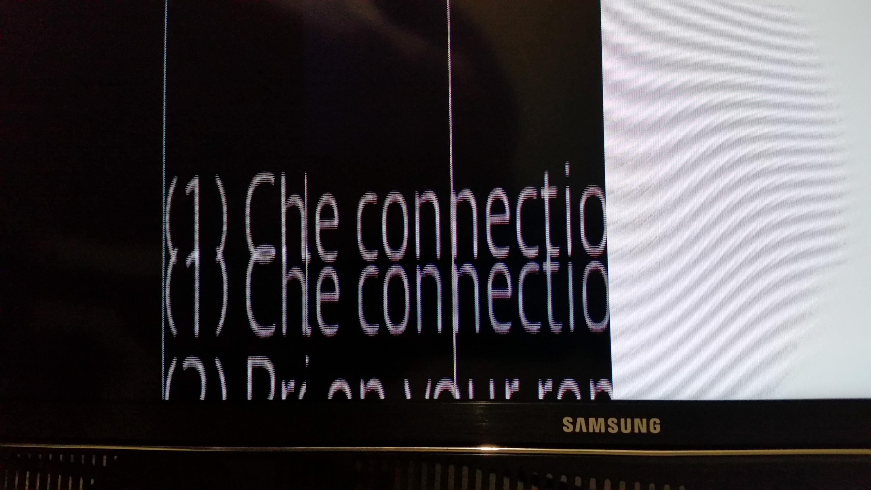

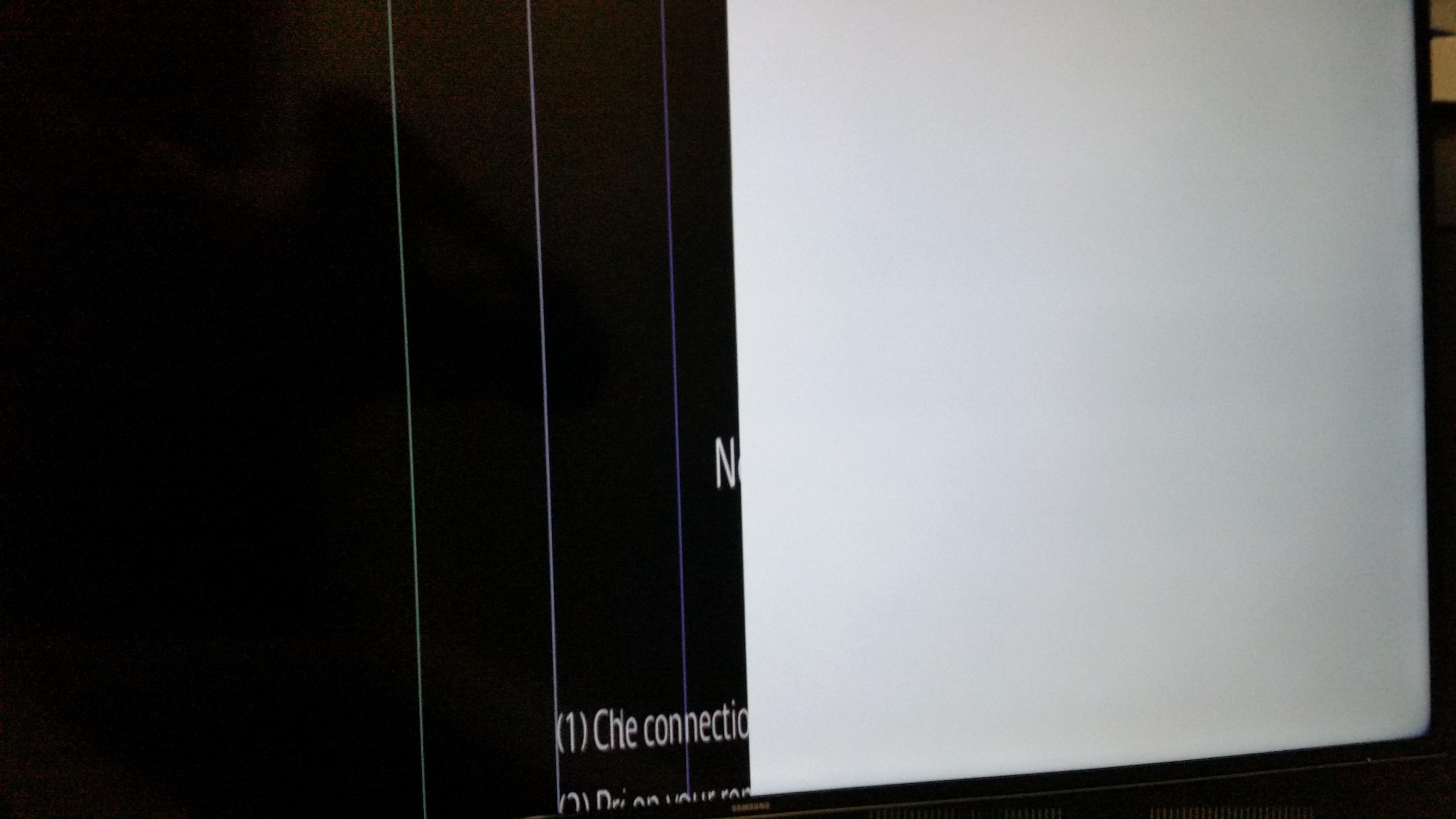

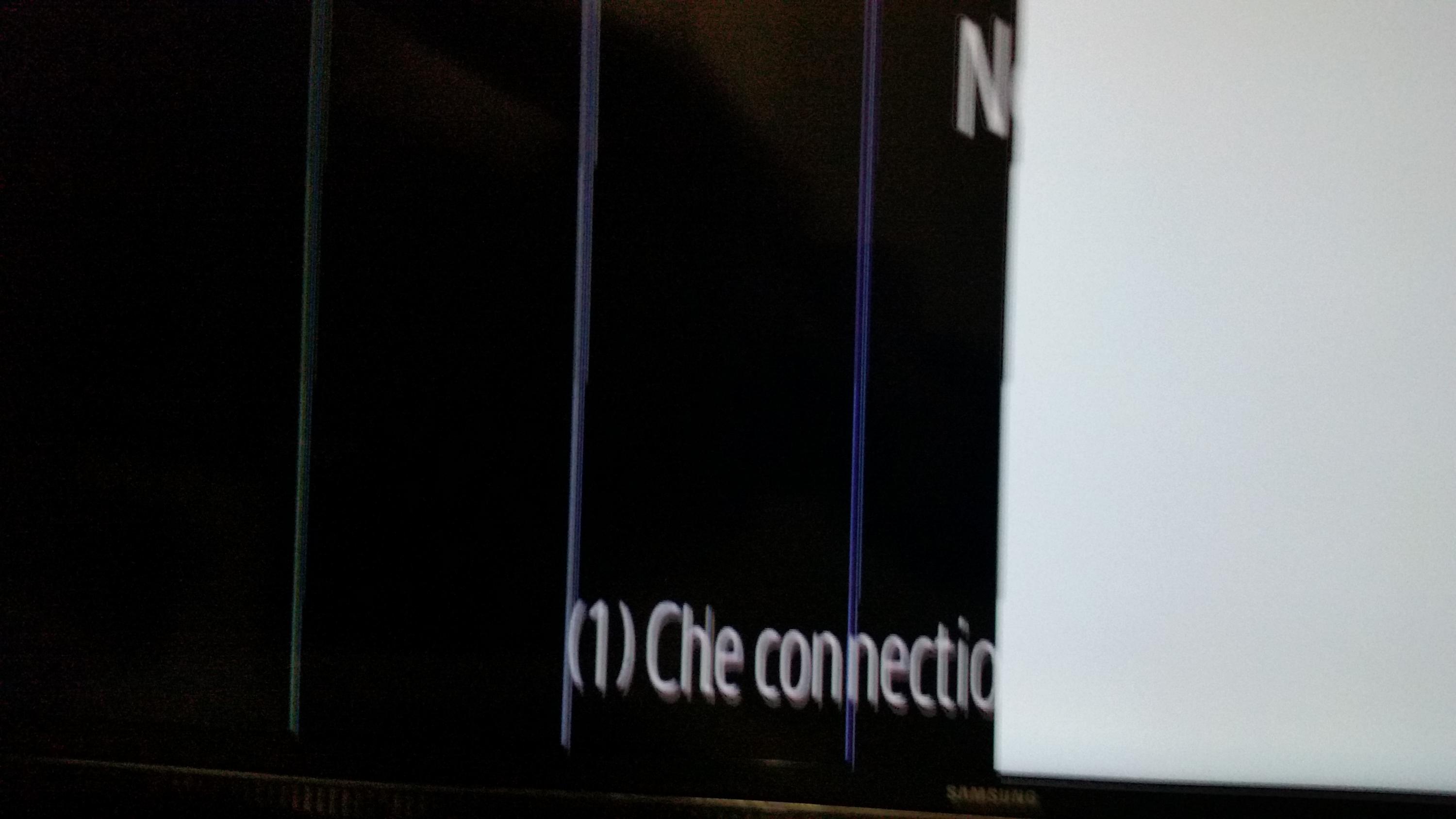

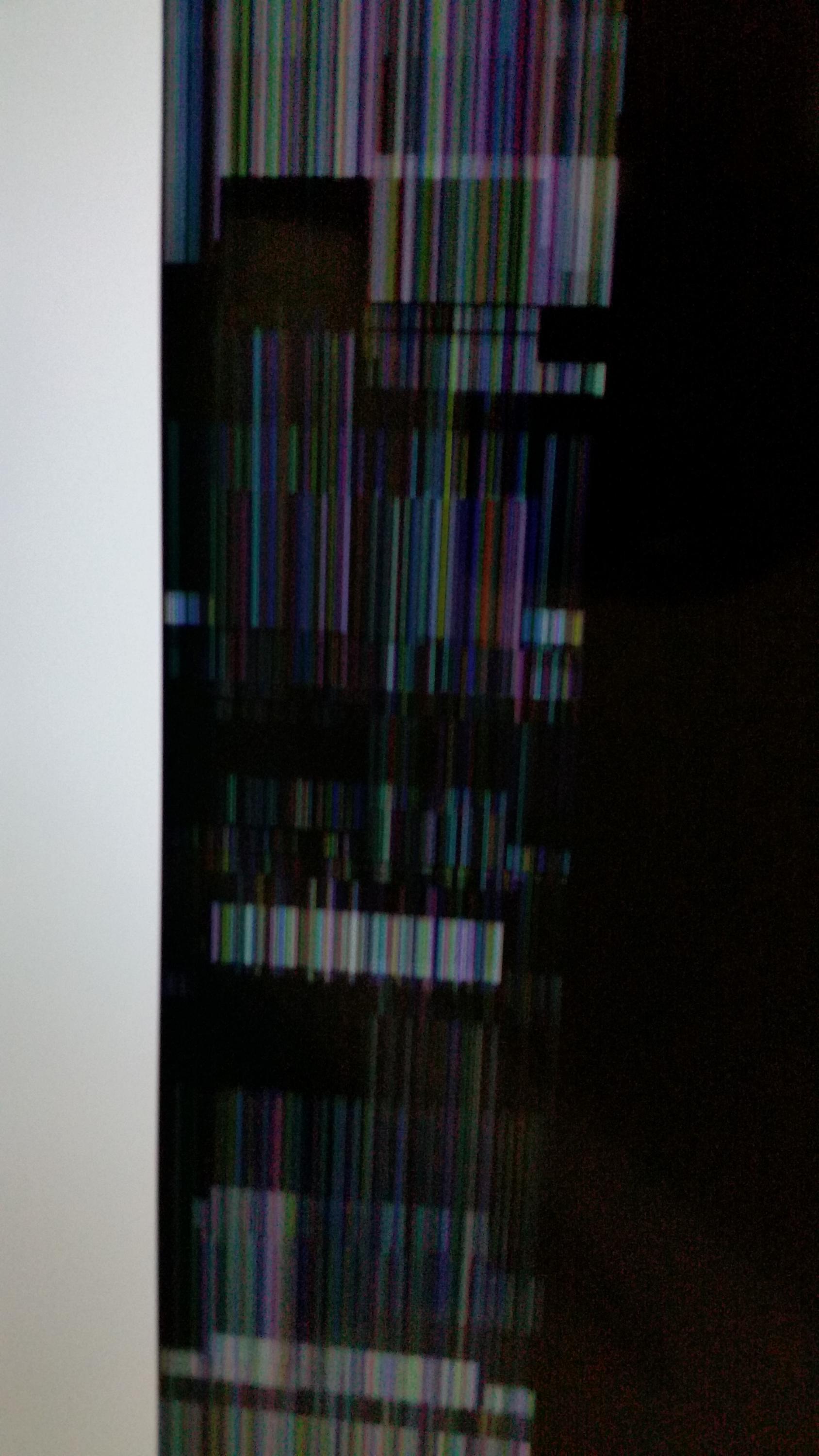

                    got the replacement tcon today, and now im getting this
                    looks like bad panel stuff but i hope i could be wrong, or its fixable somehow...
                    i still dont understand..it was working fine, everything great except the sound issue, i turned it off for maybe an hour, turned it back on and got no backlights. this was with the original tcon, which i tested one last time before swapping it, which now flickers and fades erratically the blue light on it even when the tcon is not connected to the panel at all. and when it dims too much it resets the tv. if the tcon is disconnected from mainboard, backlights stay on and tv doesnt reset.
                    switching to the replacement TCON i get what you see in the pictures. the left side displays something, but has a few vertical lines, and the text seems stretched taller, and cut off/spliced weird.
                    the right side displays only black except for a 4 inch vertical bar that is doing crazy shit, moving from top to bottom real fast in a loop.
                    can a bad TCON take out a panel, or vice versa?
                    am i screwed here or what?

                      can a bad TCON take out a panel, or vice versa? probably not directly but maybe a bad audio section can impact powering / dc levels / grounding in other circuits that might have taken out a capacitor or two in the bottom edge board. :-(

                        so are you saying a bad mainboard can take out a panel? but it has to go thru the TCON first...wouldnt it just take out the TCON?
                        what can i do, if anything to try to salvage this game of whack a mole?
                        can i actually repair the edge board? (this is the thin board that connects to the panel itself, yes?)

                          Bad panel can take out tcon. https://www.youtube.com/watch?v=yTnkOfwBGGE

                            If all your lines are vertical, you may have gotten a bad tcon replacement.

                              my response was just a "suggestion" of possibilities BUT it is also possible that the main board (that has the sound processing on it along with other things like maybe switched voltage control going to the tcon) is impacted.

                                ok well i would like to believe my panel is still good but what can i test to narrow it down for sure?
