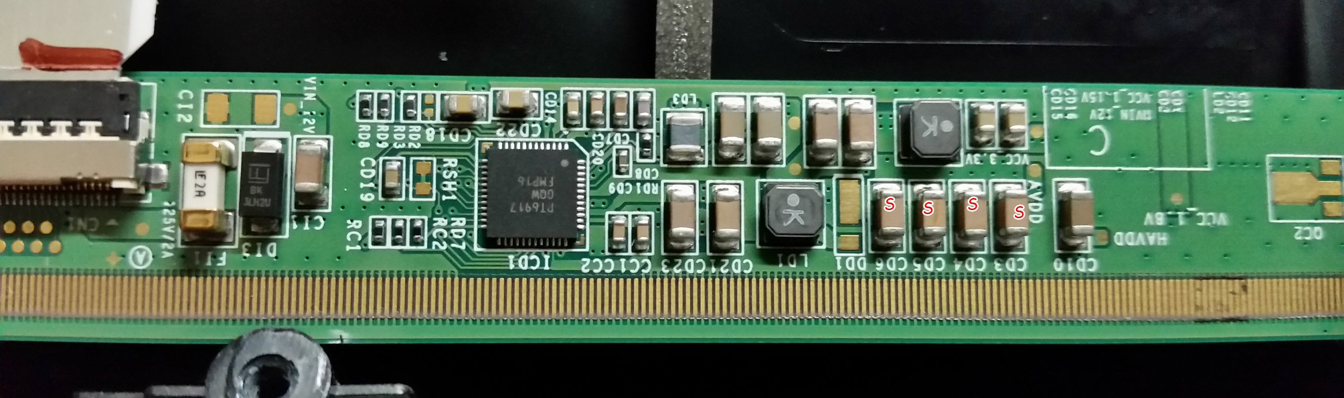

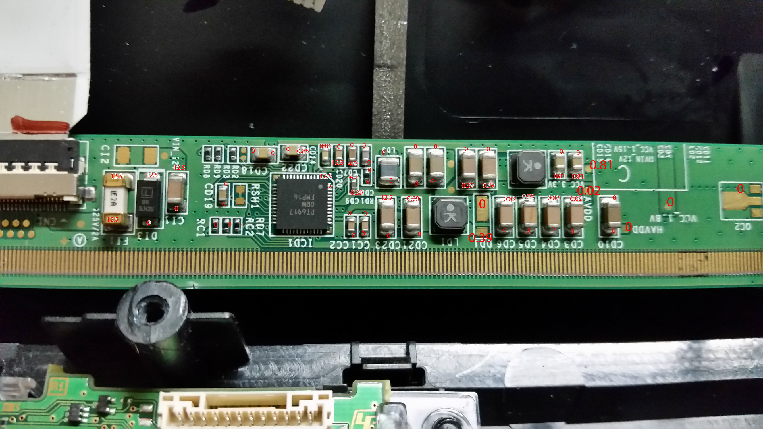

          ok to respond to andrew
          and i added a couple more voltages to the picture (they are bigger font)
          1. Vin: 12V (we confirmed as present)
          2. Vdd (Vlogic, Vddd): 3.3V - I cant find this, but i find VCC 3.3v which sits at 0.81
          3. Vda (Vs, Vsource, Vdda Avdd): 14V to 20V - i have AVDD which reads 0.02v
          4. Vgh (Vgon, Von, Vddg): 20V to 30V - i dont see this marking anywhere
          5. Vgl (Vgoff, Voff, Veeg): -5V to -7V - i dont see this marking anywhere
          now to find that datasheet for ICD1
          which has markings
          PT6917
          GQW
          FMP16
          i found this but it says its for a LED Driver...which im pretty sure isnt what im looking for?

              Re: Sony KDL-40W600B blank backlit screen with sound
              triplefour i have first read your posts count that is more than mine, i thought you were familiar with electronics...
              you better to check voltages also in this picture, only capacitors:
              https://www.badcaps.net/forum/attach...5&d=1526164190
              ICD1 is not working, to make sure it is bad or is another, you can try to solder a jumper wire from cathode of DI3 (near the fuse, upper pad) to one of those 2 condensers connected to LD1 in your last picture, on the pads that measure ,39v. In this way you can maybe ensure that the internal switch for the Avdd in ICD1 is working or not, maybe from this depends all subsequent voltages that are missing. I don't know which voltage sequence has this board, not all are the same, it's possible that the voltages generated in the part of the link above is not working and do not switch on ICD1. Bye...

                        • triplefour
                          • May 2014
                          • 1747
                          #32

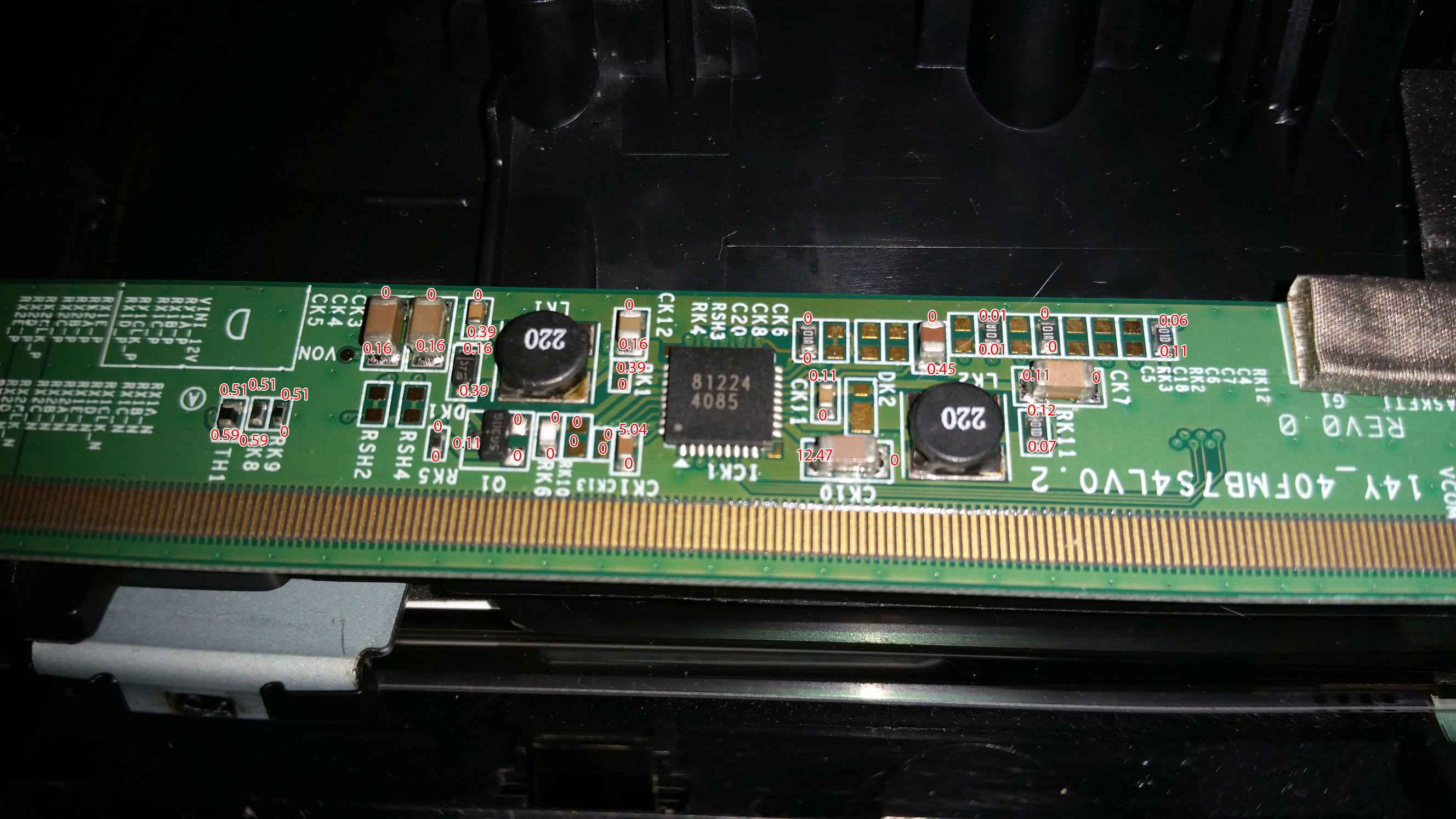

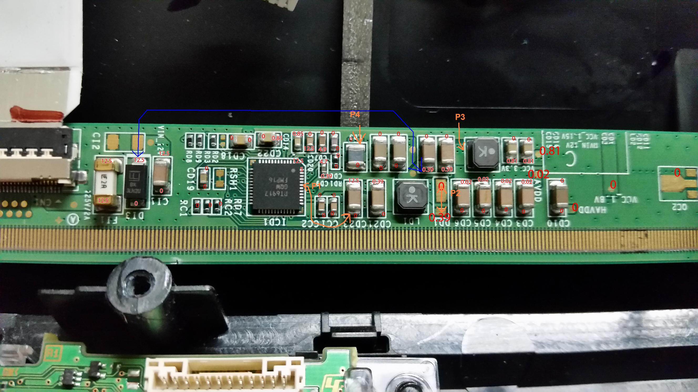

                          ok here are the voltages in that area
                          im interested in this jumper idea you speak of but i need clearer instructions what to jump...
                          in the second picture i drew a line indicating what i think you're saying.
                          is that the jumper i should make?
                          i dont know what that component is with the K on it...is that a condenser, as you called it? what does that do?
                          it has 4 solder pads..which one would i solder to?

                          • Davi.p
                            Hobbist Tech
                            • Sep 2009
                            • 4462
                            • Italy - Milan
                            #33
                            First the component with K is inductance and has only 2 terminals (maybe seems 4 but are connec. 2 at 2). I have marked on first picture in blue the jumper you can do, then points P1,P2 you must measure in diode mode between 2 arrows, points P3,P4 you must check in continuity to which pins of the chip them are connected to and then test those 2 double points with diode mode, if those tests shows approx a 0Volt (all this tests without current) then the mosfets/diodes inside the chips are bad.
                            In the second picture i've marked P1,P2 to test in diode mode, same as above, P3,P4 i.e. Q1/DK1 are a mosfet and a diode you must test in diode mode if them are bad.

                              • Davi.p
                                Hobbist Tech
                                • Sep 2009
                                • 4462
                                • Italy - Milan
                                #35
                                OK i've made an "error" in the first photo, there's no need to touch the IC pin, follow where it goes and you touch there, in this case it goes on the bottom contact of LD1.
                                i was able to measure P1 and P2 in the first picture and i got around .5 in diode mode.
                                1. You said you can't touch the IC pin so how do you have measured P1?
                                2. P1/P2 are semiconductor's diode test, them must be measured on way and reverse with probes..
                                Diode mode is not continuity..
                                i only have one setting on my meter that beeps if theres continuity and shows what i thought was a forward voltage drop...but i hardly know what that means...
                                I don't know your tester, take the instruction and read... the basis... how do you think you can repair complex circuits with no knowledge of a simple tester usage?
                                .i dont quite understand what you mean about tracing those points to what pin of the IC they are connected to.
                                The continuity mode of a tester ususally is a set where a low ohm connection makes a beep so you find to where is also connected a capacitor or other component. You can use also low ohm setting but is slower because tester reading is usually slow.
                                and then once ive figured out those 2 pins, am i to test in diode mode between those 2 pins on the IC?
                                I'm sorry i've made a mistake, imagine that points P3 and P4 are internally in IC connected to a mosfet each, the Source pin, and its Drain pin is connected to Tcon's VCC (12v), so by thruth you have to test in "diode" from P3 to 12vcc (both ways) and P4 to 12vcc (idem). Internally P3 and P4 are also connected to a diode that goes to GND so you can measure P3/P4 to GND

                                • triplefour
                                  • May 2014
                                  • 1747
                                  #36

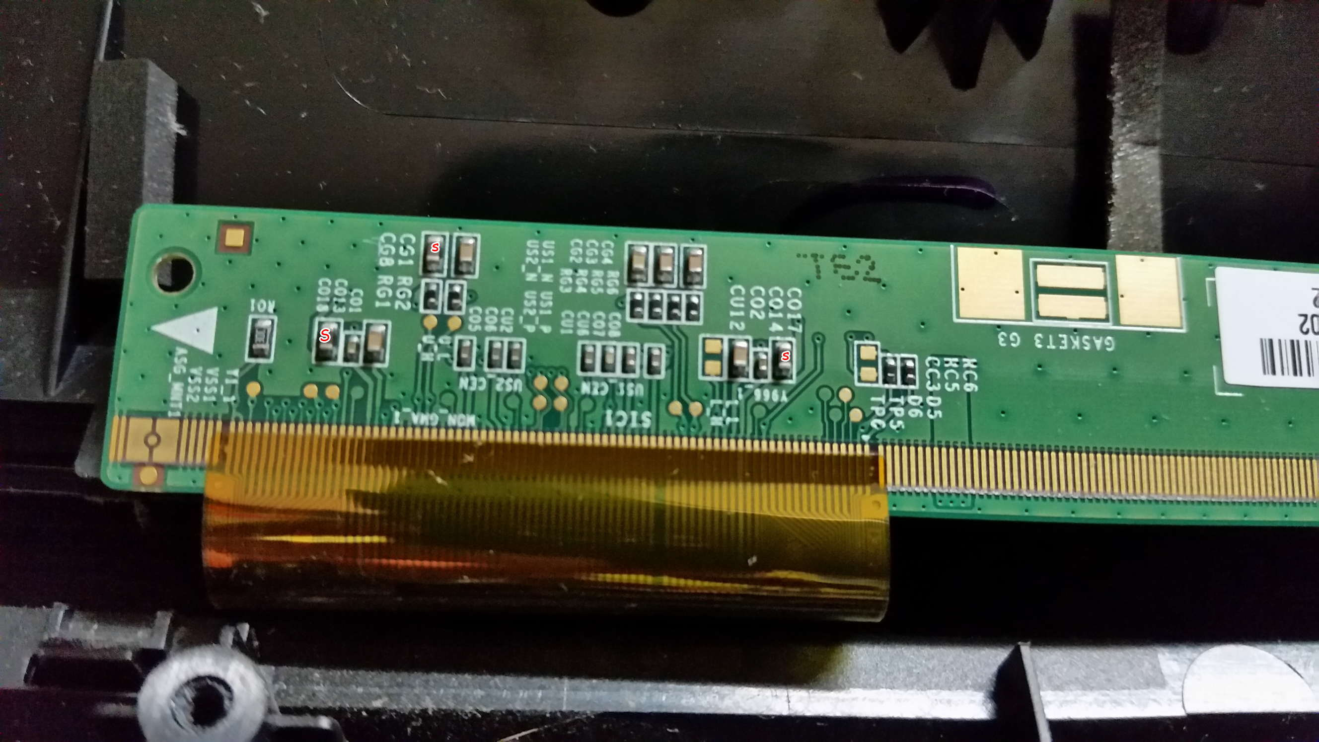

                                  here is a picture of my meter. i was able to measure P1 and P2 because P2 is really easy and P1, the pin on the IC kinda sticks out a little so i was kinda sure i was on the right pin...for the other ones i just cant be sure...
                                  you say i have to test in "diode" from P3 to 12vcc
                                  but where is 12vcc? is that a pin on the IC?
                                  sorry for not following well. maybe its late. maybe it will make more sense in the morning.
                                  i did start looking for shorted caps as finntricky mentioned and did notice a few. second and third picture has them marked. they measure 0.05 on the diode setting and the meter beeps.
                                  im pretty sure i could replace those using the hot air machine but where do i get the replacement caps? they have no marking on them

                                  • Davi.p
                                    Hobbist Tech
                                    • Sep 2009
                                    • 4462
                                    • Italy - Milan
                                    #37
                                    12vcc is on the main white fuse FI1. Those 4 caps (2ND PIC) are probably not shorted, you have to remove them and test them with ohm meter and test their solder place the same way.

                                      • Davi.p
