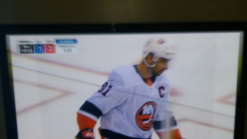

    Finnaly decided to try and fix this panasonic tv i found at the dump..after checking out the site i found it was the sc board..thanks to 2005tw for the info on using a 5081 board insted of the 5105ab as i had in this tv..evrything seems fine watching anything but a white background..pic is included..i can live with it as its not too noticable other then watching hockey...

    Bit of burn in by the looks of it.

      Was thinking that...but when i put it on 4by 3 aspect thers still about a inch on each side.....dosont really bother me...still has great color..

        Why the green edge both sides ??

          Thats just a reflection from the plastc frame..must be from my led light bulb..heres another pic..
