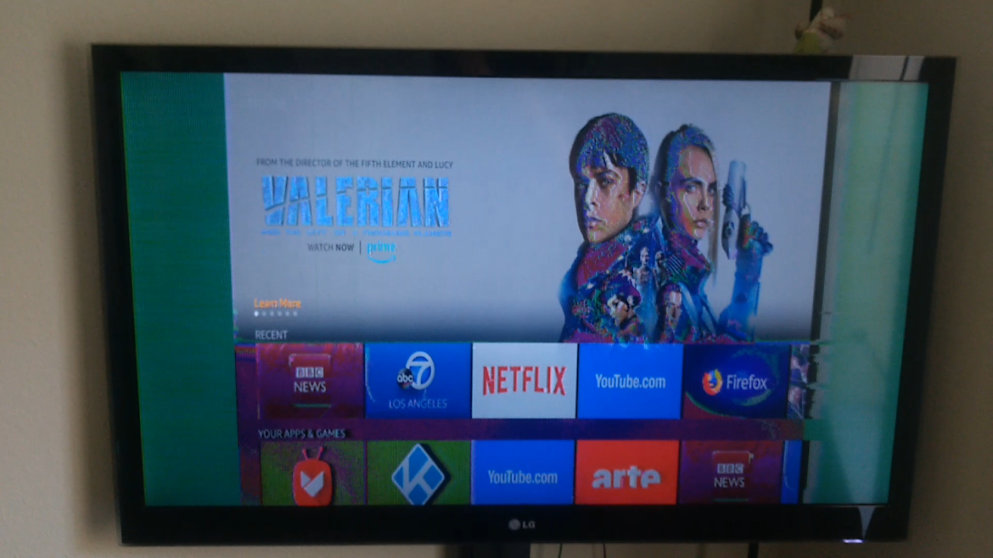

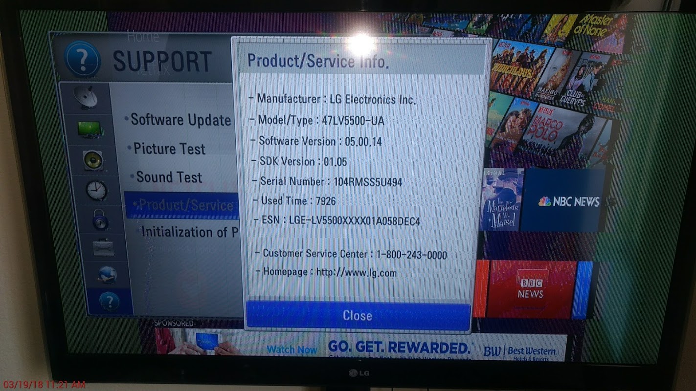

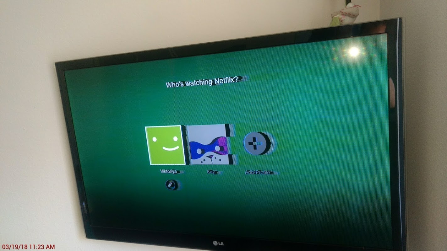

    My dear TV, an LG 47LV5500-UA stopped working "normally" yesterday for no apparent reason.
    I have sound, but entire display is weird with vertical lines and misaligned images (not solarization, but rather fuzzy unsharp picture), you can see the images but it's completely fuzzy/off...
    The issue also happens on the TV menus and all inputs / channels.
    I Can't afford a new TV and really would like to fix this few years old out of warranty TV...
    I don't have much to lose at this point... I know it's hard to diagnose but with your help, I'm sure I can follow "detailed" direction and get it back to life !
    The attachement show up the issue. I hope it's an easy fix (replacement part only)
    Thank you

          Appears to be a faulty LVDS connection on the wire that goes between the main board and the T con. I suppose it could also be a bad main board
            Re: LG 47LV5500-UA TV display problem
            +1, I would try re-seating the cables between T-CON and the Main board, also make sure all the circuit boards mounting screws are tight.
                    OK, so the reset didn't do anything nor did resetting all the cables.
                    I now also know where the TCON is located.
                    There's basically 3 electronic boards behind this TV:
                    1 in the center / middle = Brown color where power supply goes to
                    1 on the right = GREEN color, I understand that is the main board?
                    1 at the center bottom behind a metallic plate (TCON I understand)
                    So, what do you recommend next in order of priority ? Replacing main board or Tcon ?
                    I also found videos about baking the main board at 385 for 10 min and letting it cool off slowly resulting in miraculous reviving of TV !!!
                    Thank you for your experienced / technical feedback
