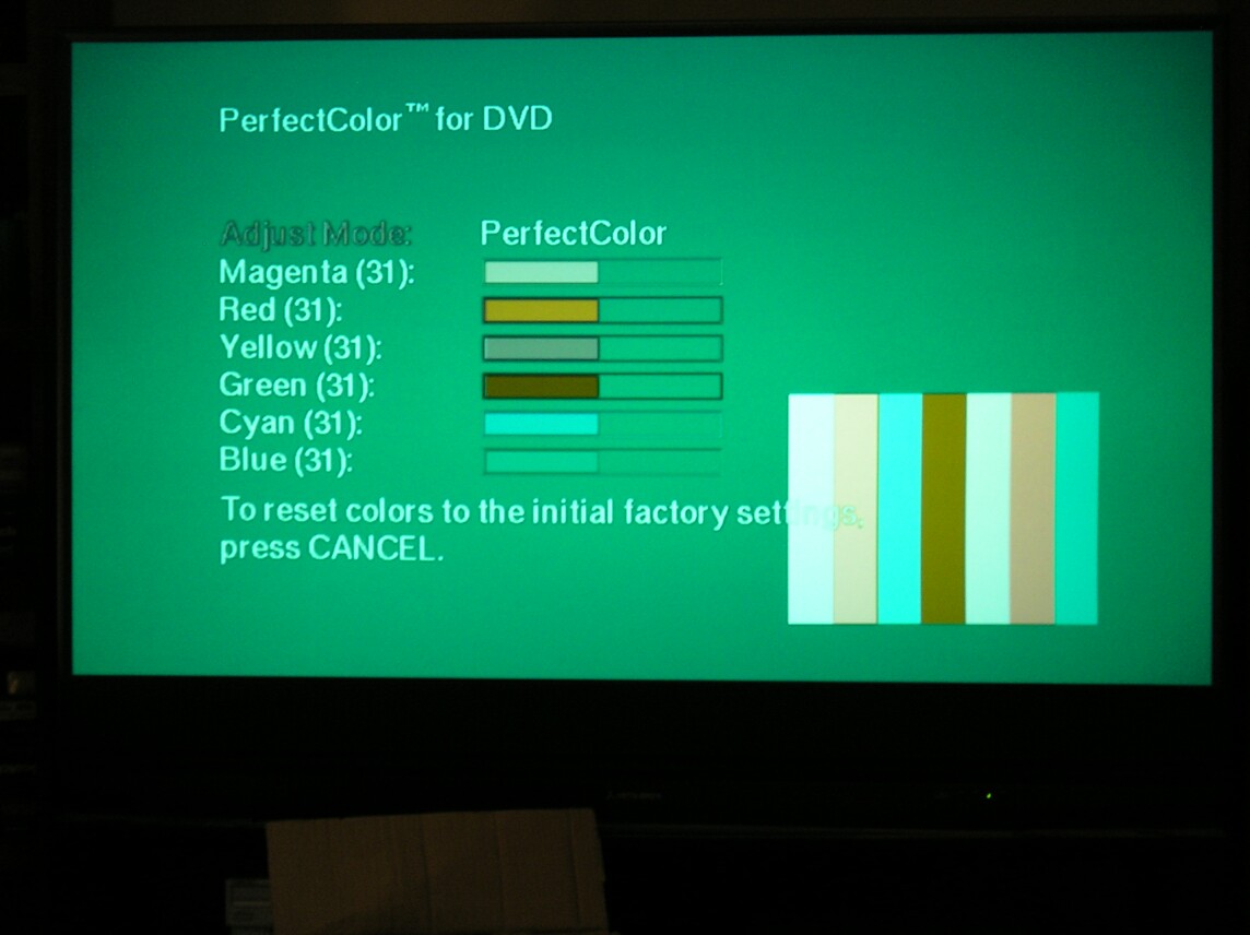

    This one is personal. The subject is a 65" Mitsibishi DLP HDTV, Model WD-65731. It has developed a problem with color shifting. I've done extensive searching but have been unable to find a forum that is frequented by TV technicians, or even a post by someone who has had the same problem solved.
    The problem was first noted about 9 months ago. It would occur in the late afternoon if the TV had been on for several hours. (At that time of the day the temperature in the room would be in the low 80's. It gradually got worse until it now occurs within an hour on even a cool day.
    The first sign of a problem is a slight flickering which gets worse, eventually it will stabilize at the bad state. All air filters are clear, all fans I can reach are working. The local Mitsubishi authorized service center has indicated they want me to bring the set in.
    Picture 1 is the set with a good picture, Picture 2 is the set with the bad picture. Does any one know a more appropriate forum?

      Sounds like color wheel drifting especially if the bearing is failing. Also you should hear bad noises also.
      Cheers, Wizard
          Cheers, Wizard
          Thanks. A combination of elderly ears and tinnitus pretty much prevents me from hearing any bearing noise.
          I presume the solution would be to replace the optical engine? I do have the service manual, but of course they don't include troubleshooting information. Asking as politely as I know how, what's your confidence level in the diagnosis?

              Invite a person with good hearing and advise you on the potiential noise with this tv. particularly when turning on and running.
              Color wheel is easy to do, just swapping out but price is kinda expensive. 120-150.
              Cheers, Wizard

                      It can be any kinds of noises. Squeal, groan, harsh whir etc. if it get bad. Eventually they fail to spin soon enough. Need some one to listen. I am deaf and I sometimes had to get someone to listen for me.
                      Cheers, Wizard
                        Re: Mitsubishi DLP
                        Sounds like the bearings are dry and it's slowing down as it warms up. It's audible, but perhaps not by you.

                                  Nothing positive, unfortunately. By standing close to the TV set with the sound muted I can hear several 'spinning' sounds. A shortage of mature, (but still good) ears has hampered efforts to identify changes in the sound. I tried having my granddaughter help, but she can't hear anything that doesn't relate to Hannah Montana.
                                  The next idea involves recording the sound using a computer and doing 'good' and 'bad' comparisons. That should reduce the human factor, but will have to wait on other demands of 'real life'. (In addition to being disabled with COPD, my wife feels I should be chief cook and bottle washer. My daughter-in-law is undergoing dialysis, so I am also babysitter to our 4 year old grandson and taxi driver for our 9 year old granddaughter when their mother isn't available. Added duties include garbage hauler, lawn boy, and computer repairman. Now my wife has decided to emulate Michelle Obama and plant a garden. Guess who is designated to prepare the soil and put in an irrigation system?) Before you feel too sorry for me, I'll tell you I just bought a 'dead' LCD TV on eBay, and am looking forward to fixing it's power supply.
                                  I have investigated, but have failed to find a part number for the color wheel, let alone a source of same. What little information I can find indicates the light engine is not serviceable. The best price I can find for a rebuilt light engine ( 938P059020) is at Tri-State Module. $379 sounds better than $900 from UED, but without at least SOME clue that this will solve the problem, I'm reluctant to break open the wallet.
