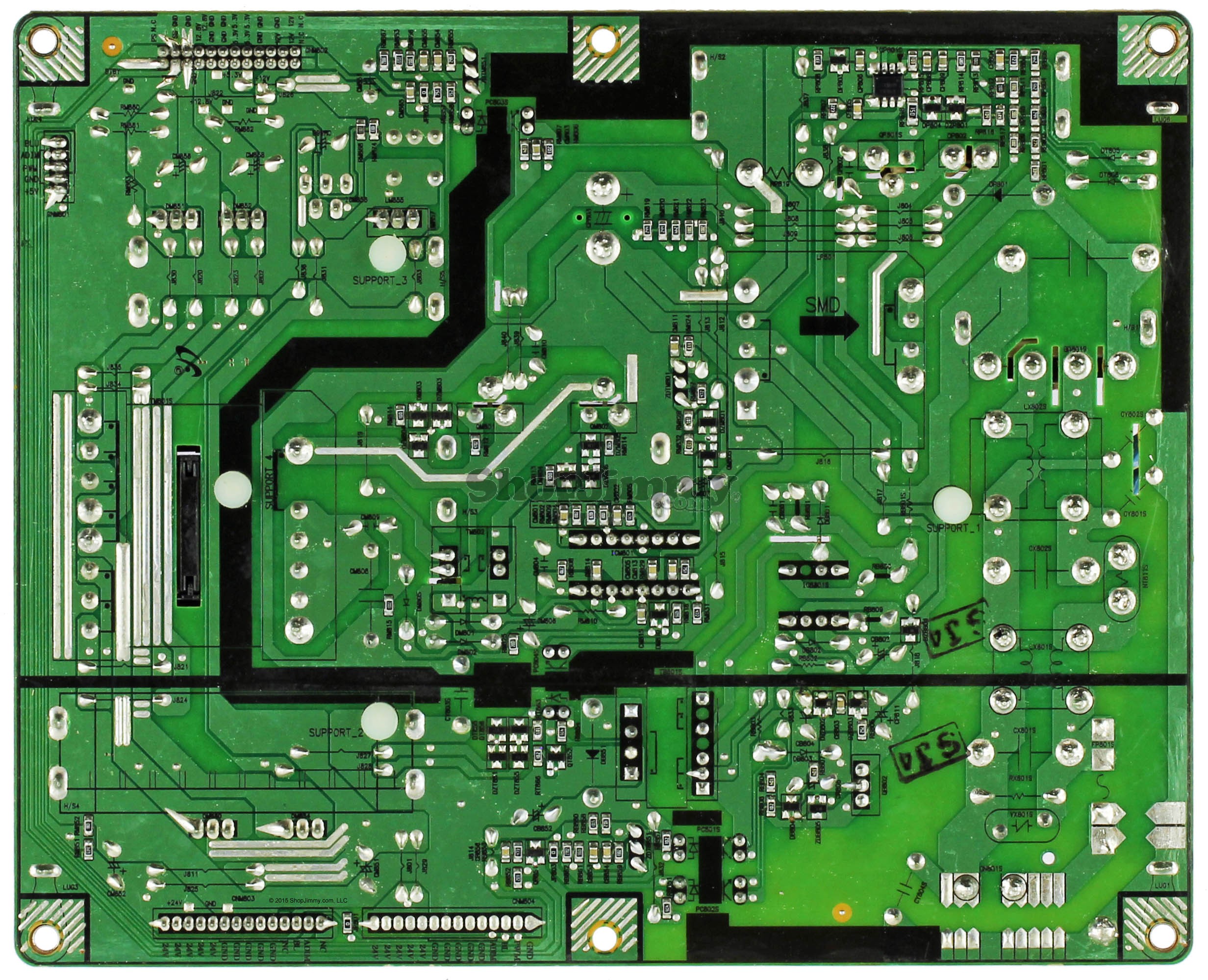

                                Re: Samsung BN44-00214A Power Supply for LN32A450C1DXZA
                                Originally posted by kenmoe
                                I have done multiple searches and have come up empty, so I have decided to post here. I am currently working on a Samsung BN44-00214A. When I originally got the tv, it would turn on for a few minutes then shut off. It would not turn on again unless it was unplugged from the wall for several hours. After checking voltages on the power-supply board, I have been able to figure out that the standby circuit works fine, but the 12v is showing 4v and the 24v rail showing 8v. This is happening even when the power-supply is not hooked up to the mainboard and getting the power on signal back from the mainboard. Any insight would be wonderful, Thank you!
                                Can we see the pictures of the whole power supply board?
                                1) This PS board uses those bad brown glue which is corrosive and conductive.
                                2) This PS board does not have pull-up resistor to force on the power supply when not connected to the main board so the switched 12V for the audio amplifier and the 24V for the inverter should not be present. So we need to verify for sure that is not error in reading when board is not connected to the main board.
                                3) Disconnect the cable that carries the 24V to the inverter board and then check the 24V output pin of the power supply board to see what you get and see if the TV will stay on and be able to turn it on and off or not (You will not have backlights of course).
                                4) If you still having problem turning TV on and off without 24V cbale connected then we need the stand by Voltage reading to see if it is steady at around 5V or not when the TV is turned on, then we need the PS-ON pin reading when the TV comes on and after it goes into shut down by itself.
                                5) We can also do the force on the power supply with the resistor and then you need to check and see if you do have 380V or so measured between the two legs of the main cap which you will have to be really careful since we are making measurement in the deadly side of the circuit. The 12v/24v power supply needs that boosted Voltage to work.
                                6) This board is known for bad DC BLOCKER/COUPLING cap CN808 (0.16uF 630V) that will cause low 12V/24V output due to losing its capacitance.
                                Pictures provided by shopjimmy.
                                  Look at CP801 very closely, see if it has any bulging or leaking.
                                    I should have mentioned that i did remove all the glue from the board as I had also read it can become conductive.So I put the PS back it the tv, hooked up the main board but left the inverter board disconnected. The TV did not turn on. There is a steady 5.2v at the stb pin, and a red light on the front of the tv. There is 7v present on the 24v pin, and 4v present on the 12v pin when inverter board is connected and diconnected. Both the 12v and 24v readings are not very stable, while the stb is. I didn't get any reading from the pwr on pin, even while pressing the power button.
                                      When CNM801 is connected i am reading 3.5 v at pin 5 or the 24v detect pin. When disconnected, I am getting a reading of 1.5v on the power supply and 5v coming from the mainboard.
                                        "he TV did not turn on. There is a steady 5.2v at the stb pin, and a red light on the front of the tv." So the POWER LED on the front of the TV did not change state and no startup chime either when the TV is turned on and off?
