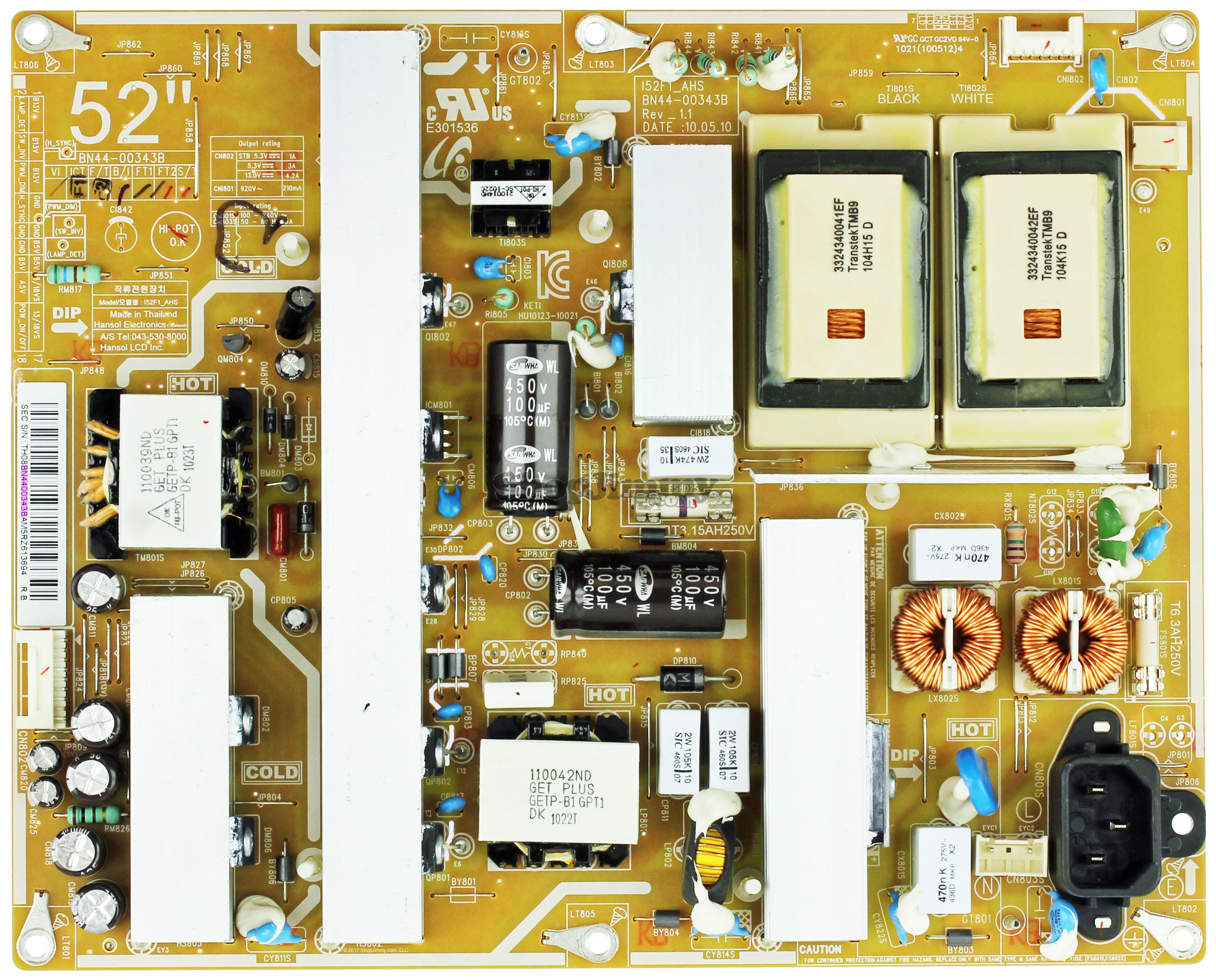

    So this Samsung LN52C530 comes to me from the free pile. I figure these will be good to learn on and maybe help offset the cost on ones I mess up.
    Has sound, confirmed picture but no backlights and no power from the plug that goes over to the backlight inverter board.
    What I'm hoping to find is a flow chart/repair guide for the power board and give this a go solo, just haven't found anything and hoped someone could point me towards one?
    If there's any checks I can do that anyone knows of that would be great too.

    You have power supply/inver board combo, the long green board connected to the lamp is the balance board.
    You need to report the DC V reading of each pin of the connector CN802 that goes to the main board when TV is OFF and when the power switch is activated.
    You MUST, repeat, MUST pin down the pin name and follow by the Voltage readings.
    I.E.
    Pin 1 B13V = ???VDC when TV off, ??VDC when power switch is activated.
    Do them in that format so we can easily see what we have or do not have.
    The exposed pins you can see from the top side of the board are ODD number pins.
    We also need the DCV of connector CNI802.
    What ever you do, do not try to measure the high Voltage connector going out of the power supply/inverter board unless you want to damage your meter.
    BTW, this power supply/inverter board BN44-00343B is known for having problem with low PFC Voltage that will cause the backlights to flicker.

                  Ok here's what I have: (s = steady voltage reading)
                  PIN VDCoff VDCon
                  CN802:
                  1: 0 12.46s
                  2: 0 0
                  3: 0 12.46s
                  4: 0 5.14s
                  5: 0 12.46s
                  6: 0 1.65s
                  7: 0 0
                  8: 0 1.82s
                  9: 0 0
                  10: 0 0
                  11: 0 5.15s
                  12: 0 0
                  13: 0 5.15s
                  14: 0 5.15s
                  15: 0 12.45s
                  16: 5.15s 5.15s
                  17: 0 12.45s
                  18: 0 .87s
                  CNI802 (checked w/TV on)
                  1: 12.36s
                  2: 0
                  3: 0
                  4: 0
                  5: 0
                  6: 9.1s
                  7: 9.1s
                  CP802: 166s 390
                  CP803: 166s 390-391

                        CP802: 166s 390
                        CP803: 166s 390-391 this looks good, you have the voltage required to turn on backlights, I'd do the backlight test in the video.

                            First set of numbers is from connector CN801, First number is the pin number, second is voltage on that pin TV off and third is voltage on that pin TV on.

                                I couldn't tell which was the bl_on signal voltage on your readings, if that's good, it usually reads around 3 or 5 volts, then I don't know why the backlights wouldn't come on, unless its a bad ccfl/single backlight or one of those transformers on that balancer board.
                                  Re: LN52C530 sound, picture, no backlights/volts from power supply
                                  The bl_on signal comes from the mainboard, if you are not getting that the backlight wil not come on, then the problem would be with the mainboard or the connector harness going from mainboard to powersupply.
                                    If you don't have the bl_on voltage present you could try unplug balancer from powersupply board and see if you get the bl_on voltage.
                                      No volts A/C on all sense lines.
