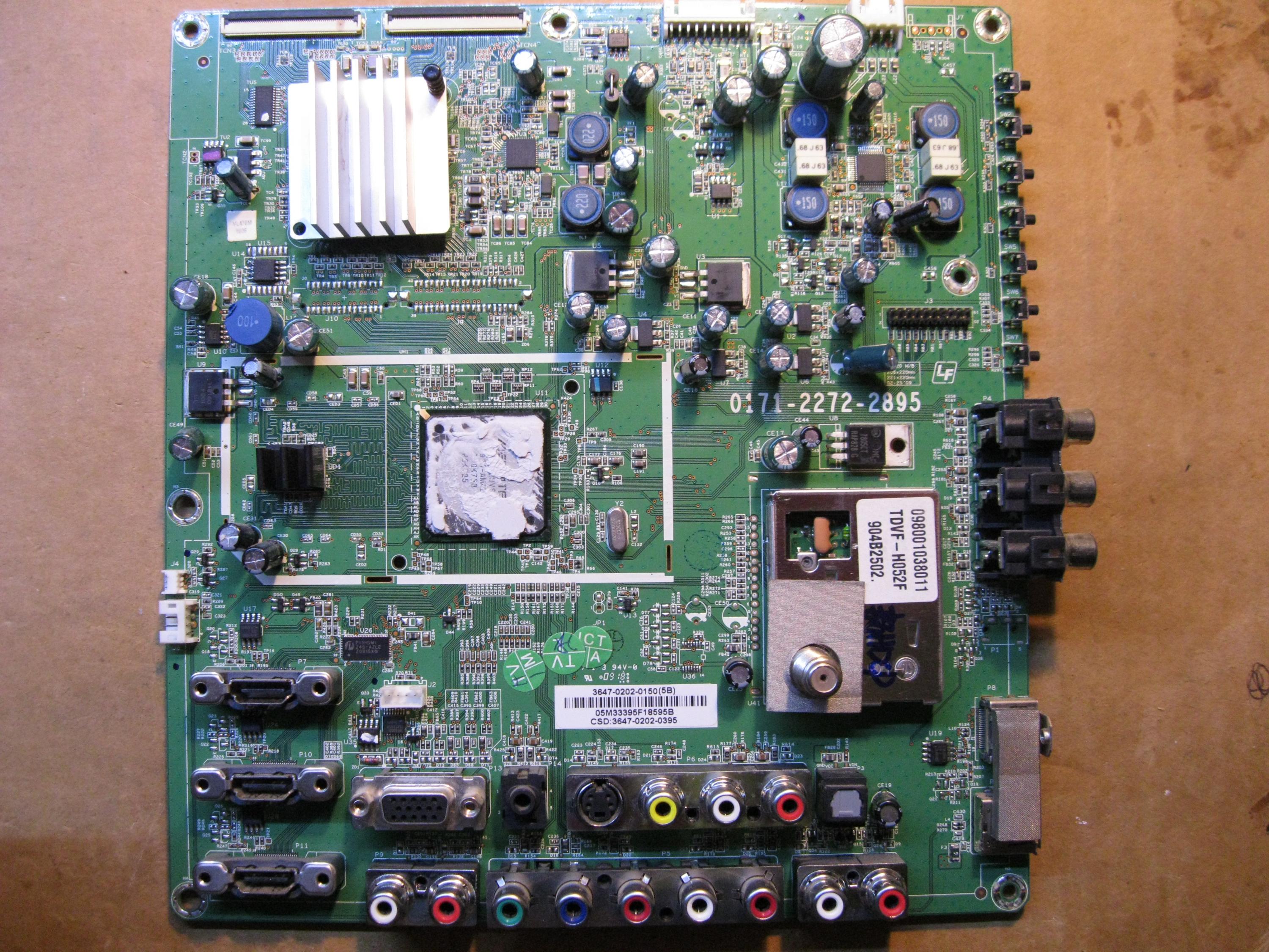

    Have a Vizio VL470M, Upon plug in, VIZIO light is yellow, no response from on button on TV. All voltages coming out of PS are good. All voltage checks on Main out are good except "inv" on is 0v. (orange wire). Any ideas?
    Re: Vizio VL470M
    Inv_on is generated by Main board.
    How about other control signal like 'Dim'?
    We also need the pictures of the whole backside of the TV showing all the boards.

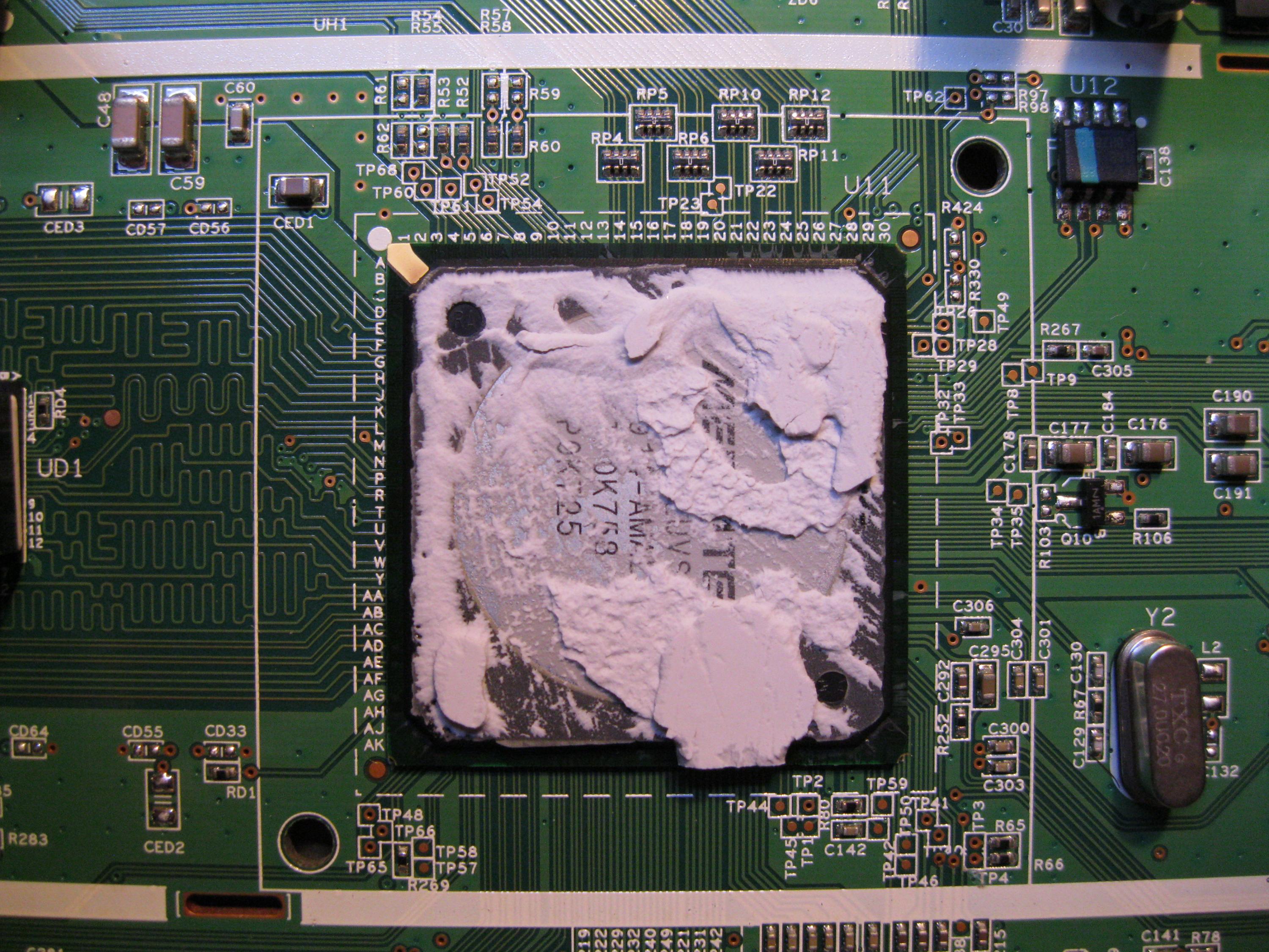

      After checking U14 (EEPROM) and finding it OK, I put the main PCB on my hot plate at 350* for about 10 min to reflow U11. Put board back in and TV fired right up! Go figure!!!!
