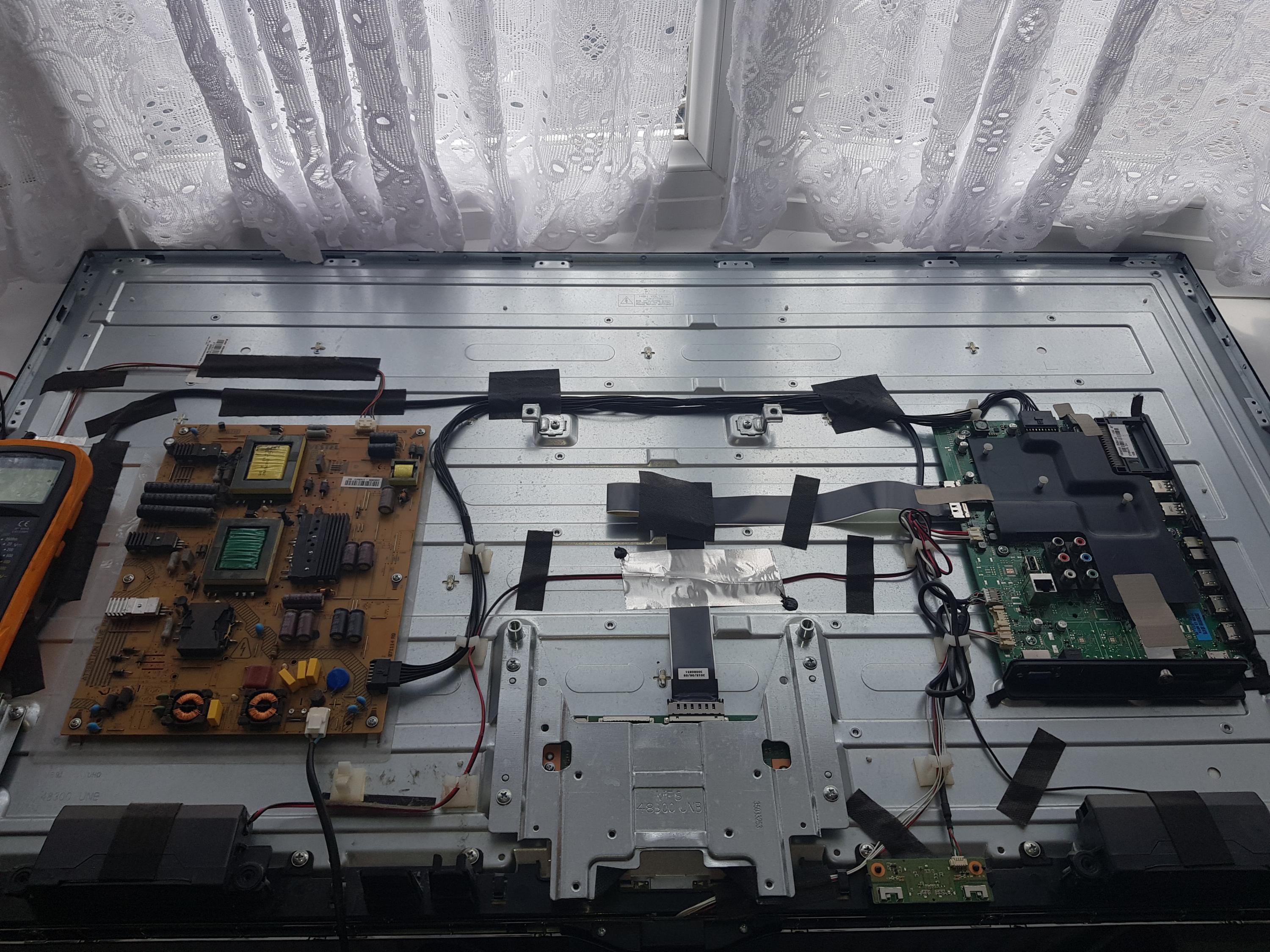

    Hi guys
    hav'nt been around for a little while, but just got this panny/vestal in.
    tv turns on and can see pic with torch, and it did have a brief led flash, but no longer,
    17IPS20 power board
    now longer flashes the LEDS on boot, checked volts, and LED voltage is steady at 79v, it did max at 180v once while testing, is it possible the the driver chip has give up ? how can i test it, all other voltages seem to be correct,

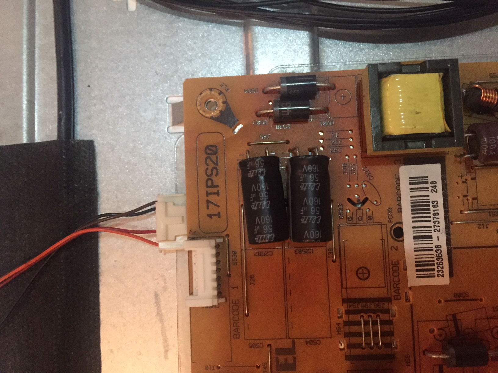

    So if the TV is off, put the LED connector back in place, and then you attach the meter probes to the negtive leg and positive leg of either one of the two 56uF 160DC cap and then turn on the TV, you do not see the Voltage jumps up 10 180V any more?
    If you did have the LED connector in place when you get that reading of 180V, it is telling me that you have open circuit in the LED string some where.
    When the LED power supply does not see the load the output will go up to the max which will then trip the over Voltage shut down then all you get will be the feeding Voltage that feed the boost converter circuit, in this case, it is around 80VDC.
    It can also be that the BL-ON is not present to turn on the backlights driver circuit.
    So lets verify for sure if the boost converter is working or not.
    There are many threads about this power supply board but there are many version of this 17IPS20 PCB which can be stuffed in may ways to make a bunch of different PCBA's.
    That barcode is the number of the PCBA.
    Is it 23253638? or 23253538? I have a hard time reading all the numbers on that barcode.

      Re: Panasonic TX-48CX400B low LED volts
      thank you, i did'nt even think about getting BL ON from main board, so i will check that.
      the LED plug was in while testing, but still remained at 79v with no increase of volts,
      had a read of the threads on here and also watched a few vid's on you tube,
      before asking here for some inspiration, but i think something has sorted and can't find it at the moment, but i'll see if i have the signal from the main board when i get home tonight so i can rule that out.
      i can't believe i did'nt think of checking it.

        23253538 is the correct one

          checked what i think is the BL_ON off pin 5 and get 3.28v when i turn the set on, still only get 79v at LED plug, but im getting 390v on the 3 main caps, 47uf 450v
          • finntricky
            • Jan 2014
            • 449
            • uk
            checked what i think is the BL_ON/OFF on pin 5 power board to main board connector and get 3.28 volts on turn on, and holds steady,
            the 3 big caps rated 450v gives me 390v, so if i have the right pin, and the 3.28v is right, then the LED circuit is being told to turn on, but still only get 79v at LED plug, even when plug connected,

                  So far the PFC Voltage booster is working because you are getting 390VDC on the main filter caps which also means the PS-ON is present.
                  The key point right now is that we are not 100% sure if pin 5 of the connector is BL-ON/OFF or not.
                  Can you identify the PS-ON pin.
                  And If I remember correctly, some of these VESTEL boards use ACTIVE LOW for the control signals, but no matter what it uses, you should see the signal toggles from one state to another state when TV is toggle on and off.

                    i used this sch, not R9 version but R6, as that is all i could find, pin 5 volts are 0v when tv is off, and 3.28 when on, the problem is with these boards is there are not any volts or markings on them to say what they are or should be
                      I have that diagram also but after looking at you board and the schematic, they are really that close to what you have on the board.
                      But one thing you may be able to do is to look at the LED driver IC to see if it uses the same one as used in your board or not, the schematic show U500 as MP3394, if it is then you can check the VCC pin and the EN (BL_ON/OFF) pin to see what you have.
                        BTW, you need to check those two diodes by the two 56uF 160DC caps that I had you measure the Voltage earlier, check the RESISTANCE of those two diodes to see if they show low resistance readings in both direction or not, if those diodes conduct both ways then you will not get the Boosted Voltage.
