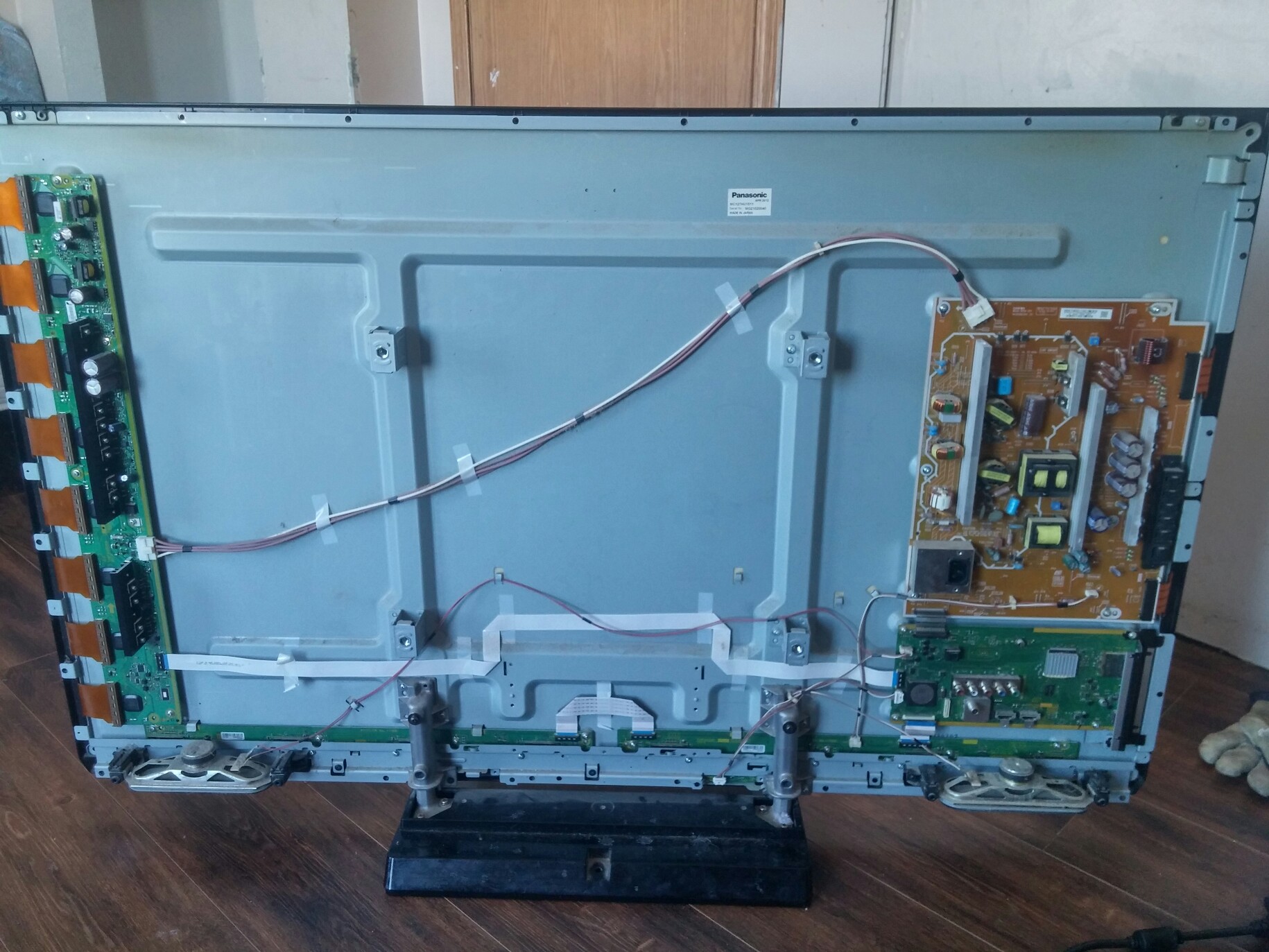

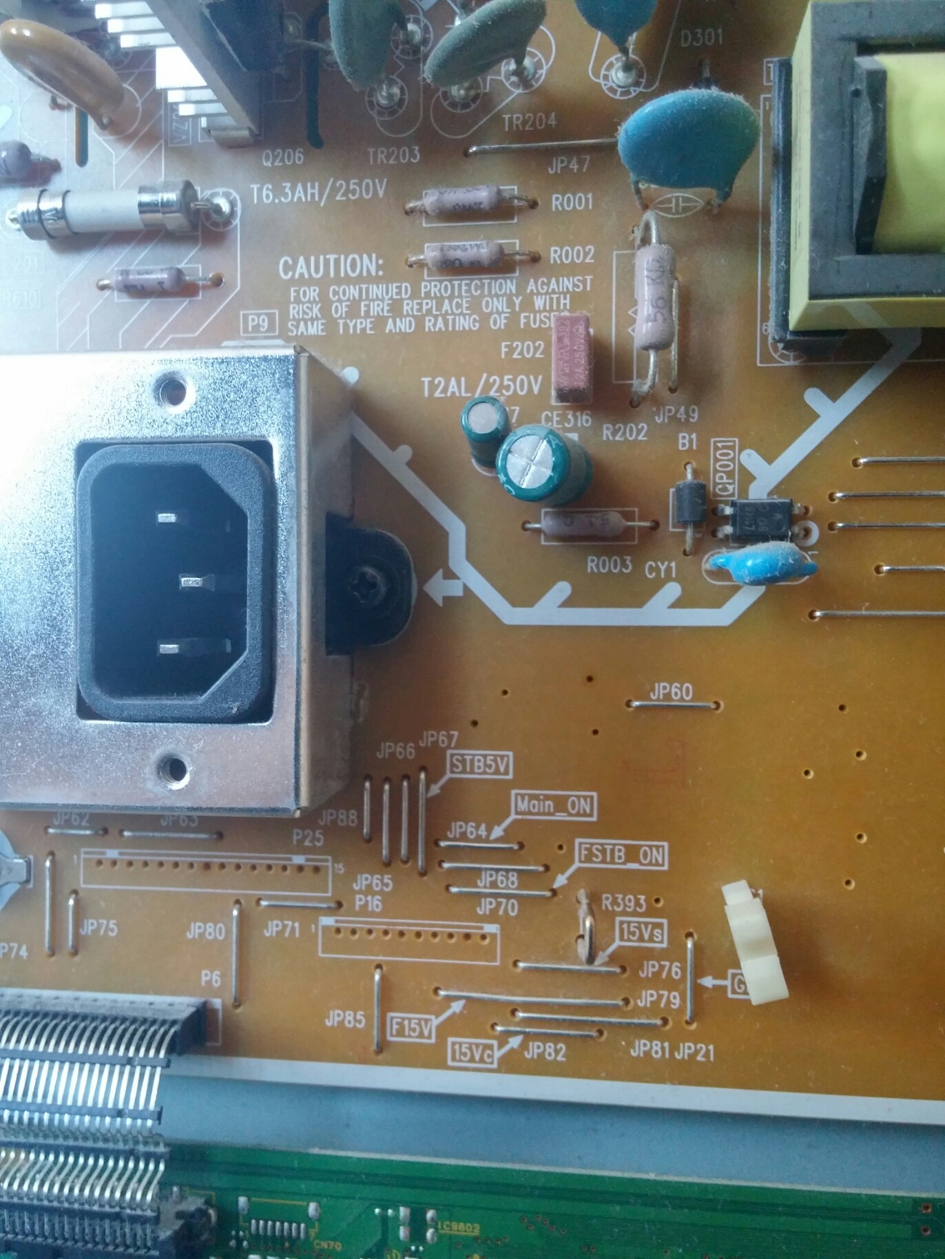

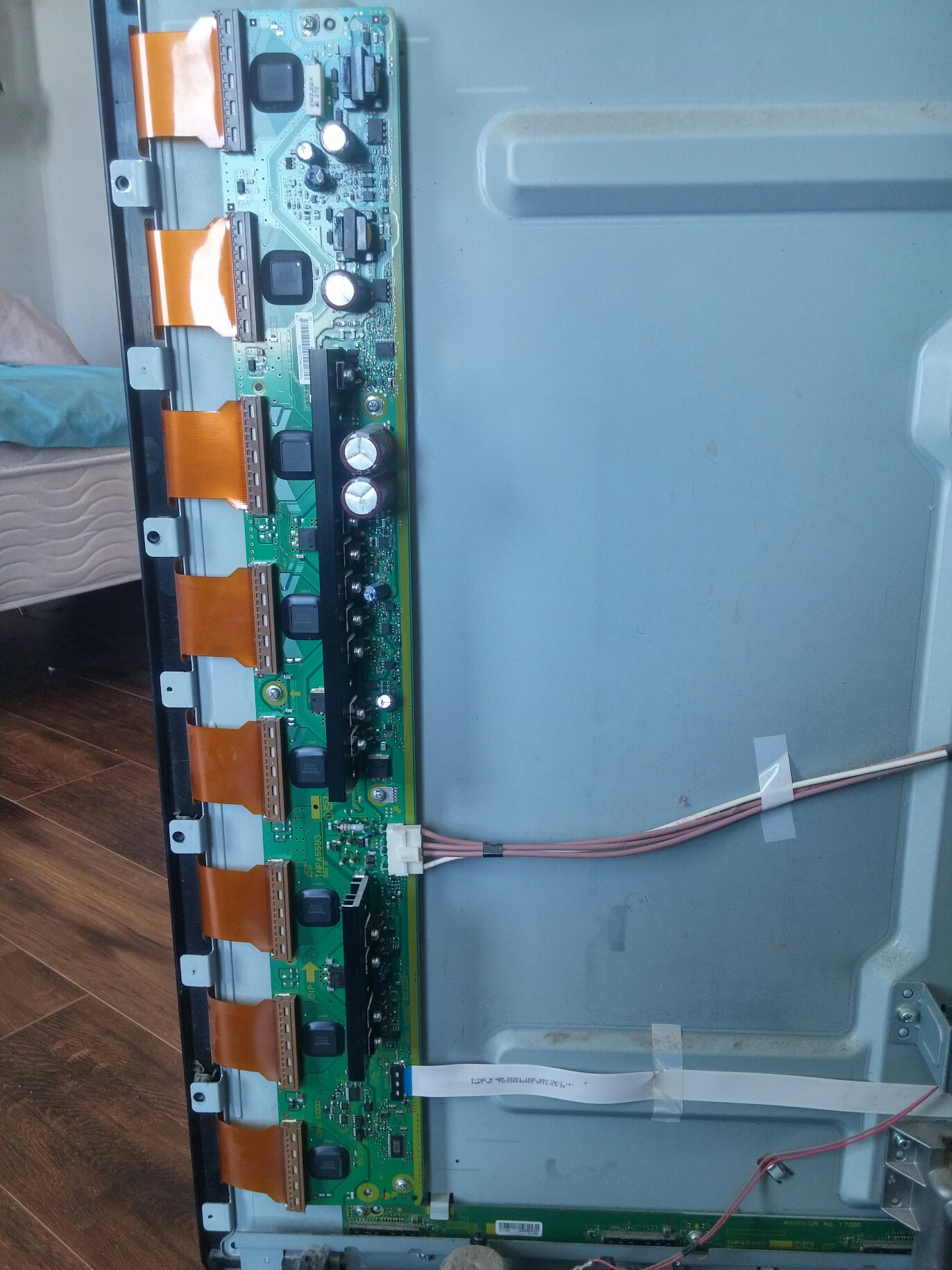

    Panasonic tc-50x5 7 blinks
    Have a Panasonic here thays giving me 7 blinks ...checked around and they say its the sn board...tnpa5593....I unplugged the connectors and it gave me 6 blinks..someone on YouTube said that was his problem when he had this issue...bought a replacement but still get 7 blinks.....checked all connections ...have 5v. At standby...getting 165 at vsus...trying to resize my pics...but it don't let me ...

    Re: Panasonic tc-50x5 7 blinks
    Did youtube guy buy a board or did you? Ebay has them from $15 to $125. Check all transistors that have a Q , for example Q421,Q451, for shorts.
      I bought a new board....hers the pics
