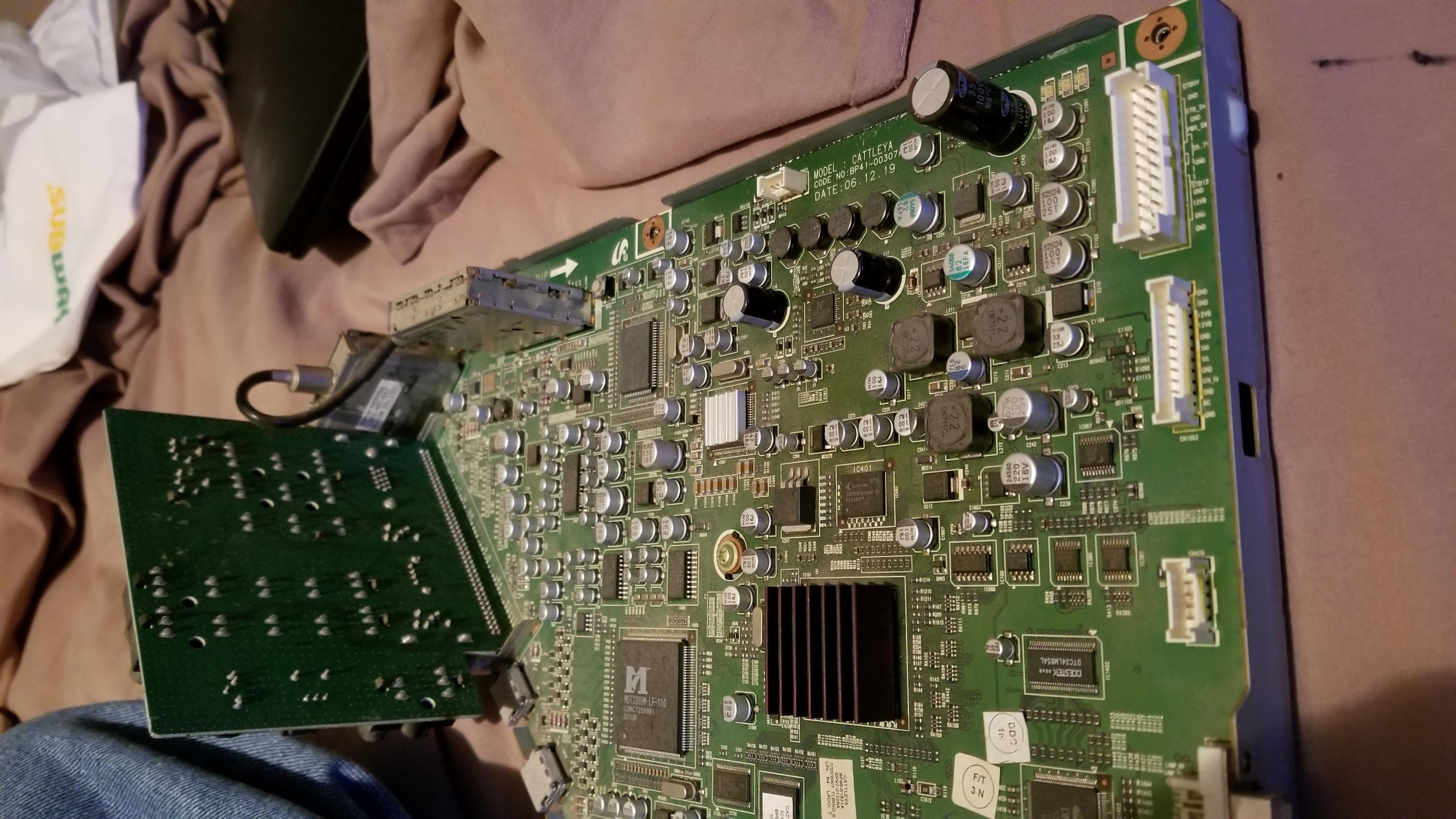

    My friends said it started doing this popping before about a 15 min lamp overheat every time.
    The power board had 7 year old crapXons that bloated the ballast lamp cap.
    I replaced all the power board caps and the lamp cap. It stays on now but about 20 mins in the speakers start popping (randomly, every few seconds). Muted it stops it, so it could be pre amp or pre post amp.
    Here is the video board. Should I try replacing those other lytics? I'm pretty sure some of these are not polymers. In fact I see a few vents. The cans are samwha rg and sd. Seemingly general purpose.

    Re: Audio popping on samsung dlp
    Your admin demands a response!
    Just kidding. But really guys, what do you think?
    Model is hlt5675s, probably should have put the model in the title or at least the first post
      I just talked to the sister, she said it did it with the soundbar, and continued after the tv was turned off (standby)
      After I booted it up with the recapped power board, the speakers were turned off in the sound settings
