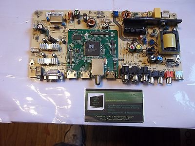

      Here is photo of the cheap made all in one board lol

          Picture of the board is low res so I cannot zoom in to look at the board in details especially at the LED connector.
          Are there any labels for the connectors' pins?
          We also need to see how may wires there are on the LED connector.

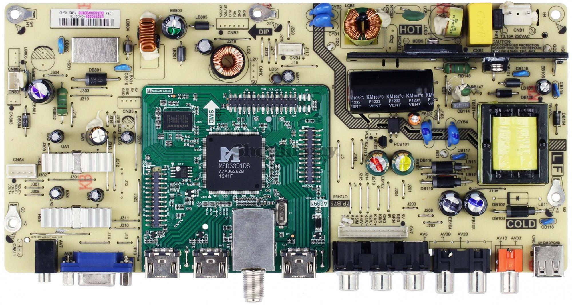

                This pic better?

                            EB803 looks as though its started to vent?

                                    thats not my board photo..it is a stock board from shop jimmy
