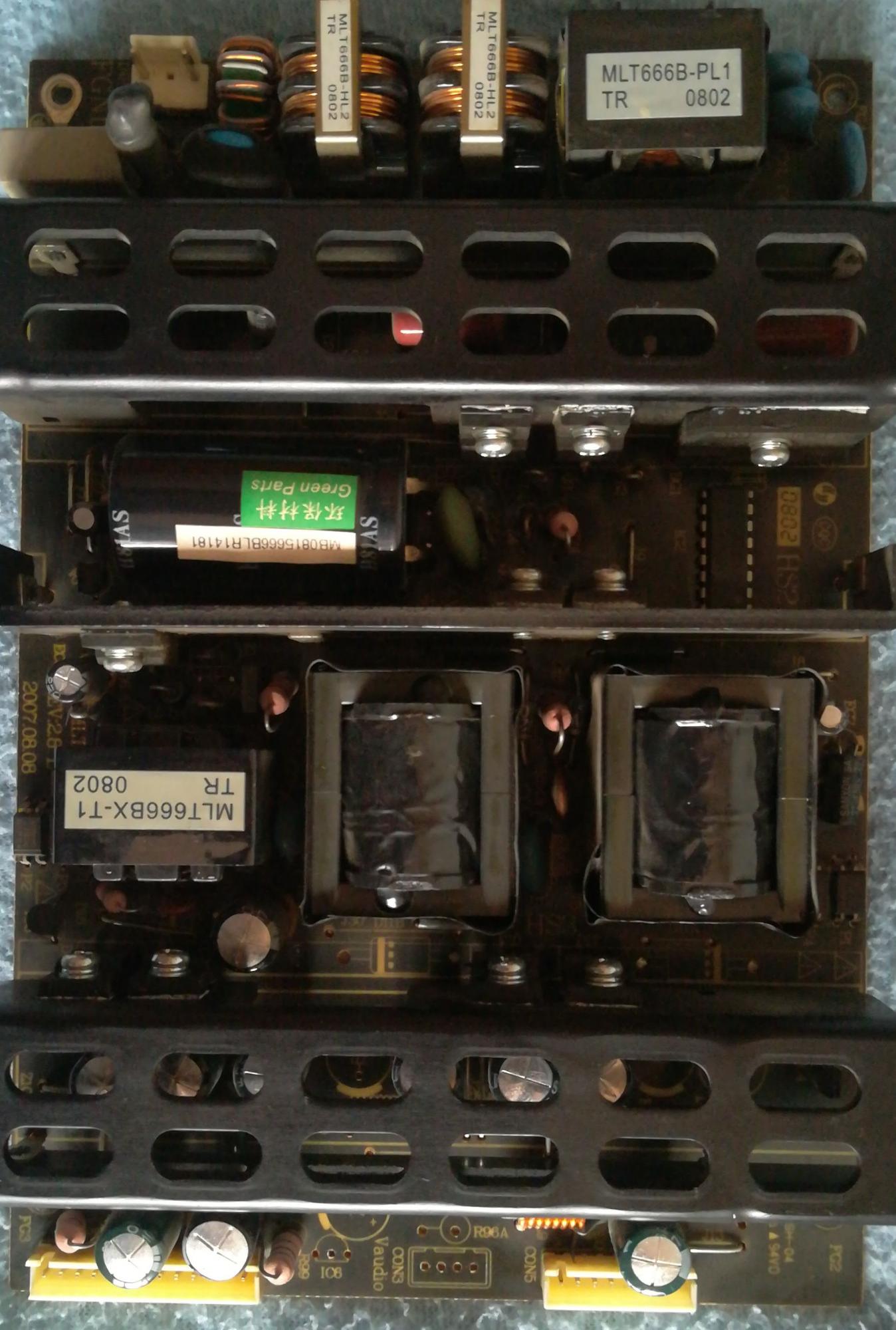

    Hello guys, I have this 32" Imperial Tv that "took it's time to show the video, now doens't turn on at all" to fix.
    The PSU is a MLT666 Rev 2.8L and as you can see from the pictures I'm attaching it has a lot of bad caps.

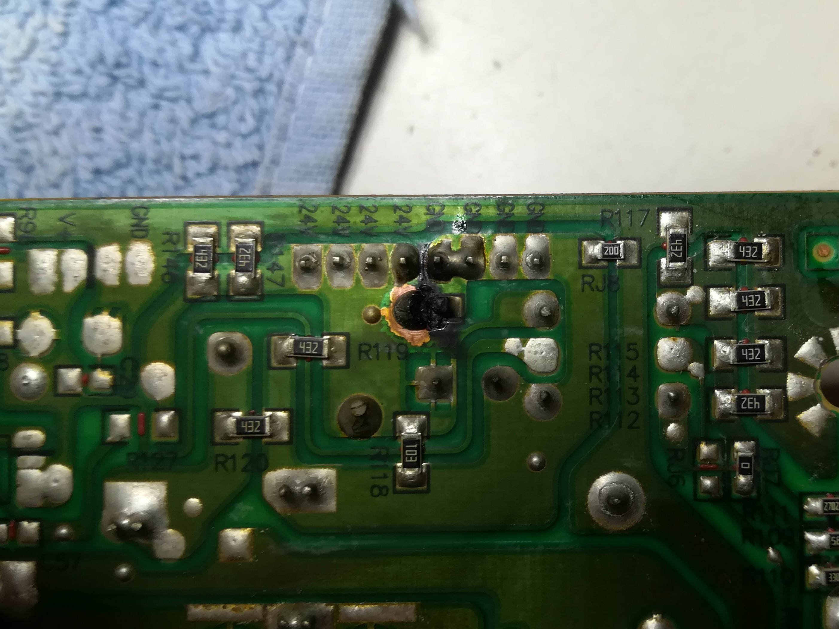

    So I turn it upside down and I see that cap completely gone, I'm sure it's a cap as it is drawn as such on the schematic but I don't have any idea about it's value, so I figured that's no point in doing any work if I'm gonna be stuck on that.
    Can somebody help me?
    Re: MLT666 Rev 2.8 L - Smd capacitor
    That is just MLCC connected in parallel with the electrolytics caps for the 24VDC power supply output, it will be 0.1uF 50V rating.
      Thanks a lot buddy
