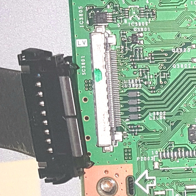

                After further investigations the flat ribbon cable seems to be damaged.
                Any suggestions how to find replacement? There is no part number on it ....
                  Re: LC70LE747 sharp Aquos repair
                  Can you post a picture of the faulty cable?
                    Is this sufficient?
                      You may find one on Ebay. It's called an LVDS cable.
