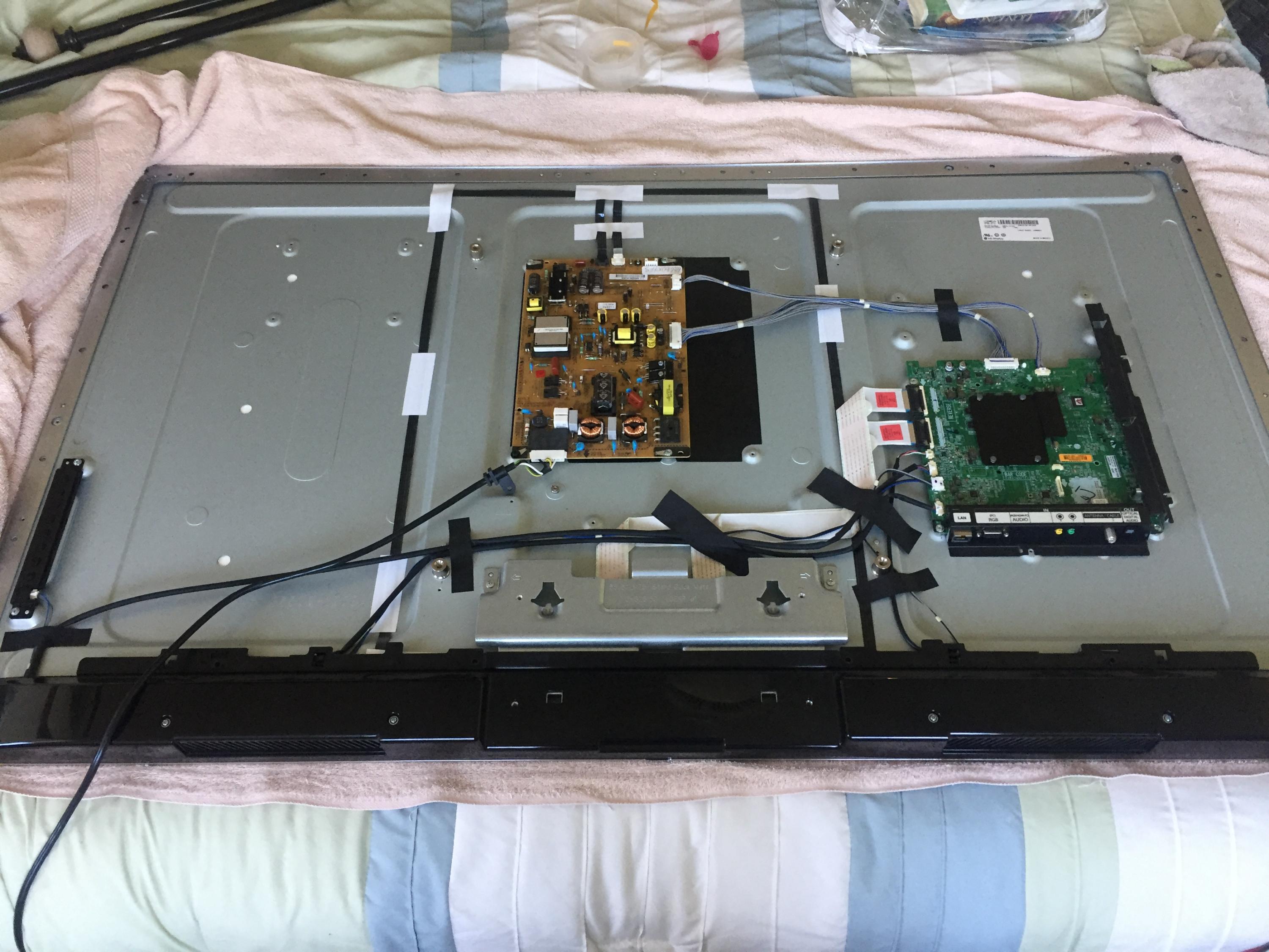

    Hey everyone- this forum has been a huge help in the past and I have been able to fix three TVs from your advice, my own and some friends. I am current stumped though.
    I have an LG 55LM6700 that powers on, the LG logo screen comes up for 2-3 seconds then goes away, and after that I have no picture. The backlight is ON. In a dark room, the front screen is a dark glow, and with the back off, you can see the LEDs come on from inside.
    The previous owner said they got 'two boards from LG and it was hard because they are discontinued and out of stock.' I don't know what the symptoms were before that led to them contacting LG.
    There is no T-Con board, only a power supply and mainboard. No visual capacitors blown. I tested the large obvious glass fuzes and they are good.
    Will post pictures and what I have tested so far. Appreciate your help.

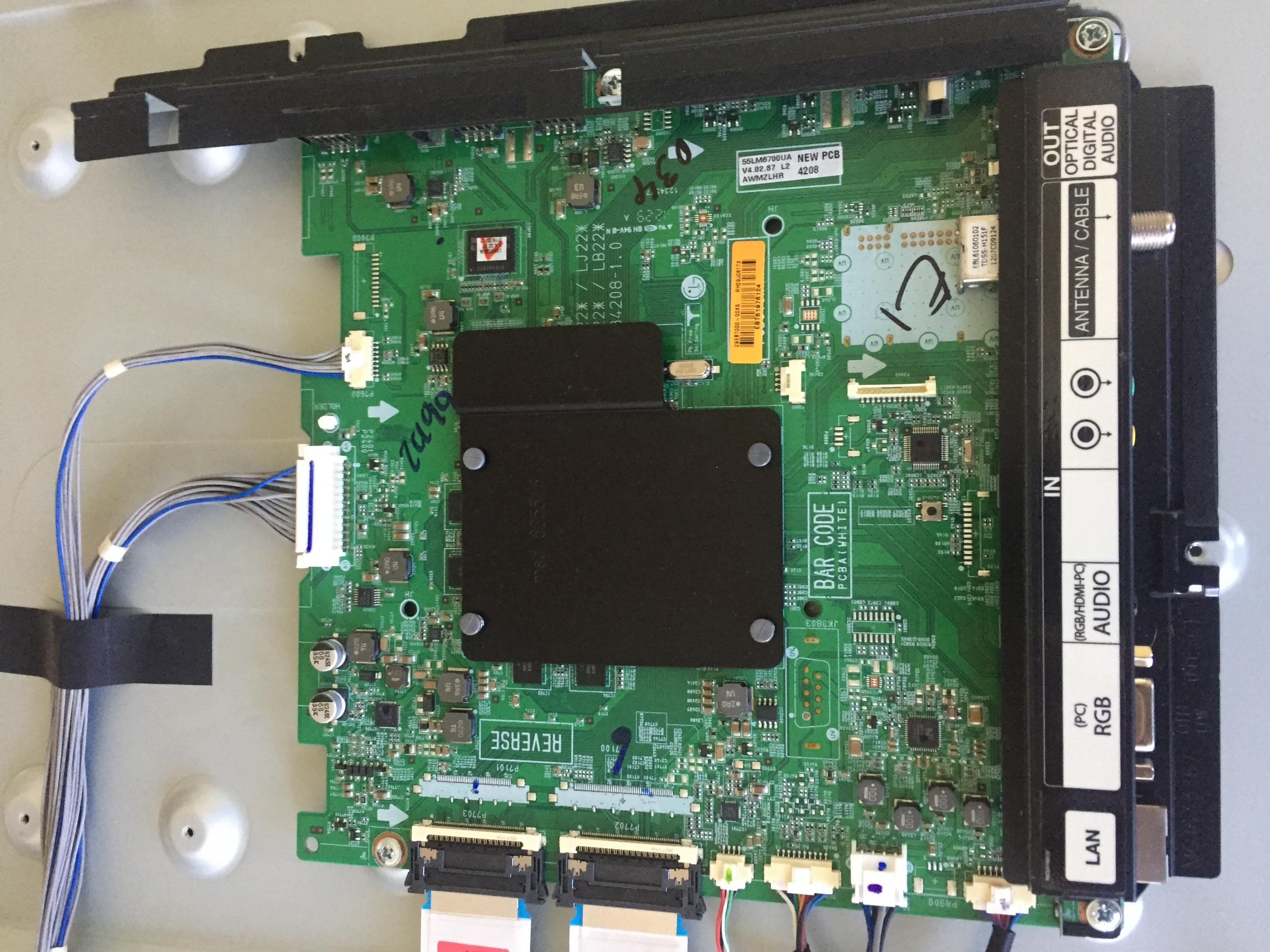

    Re: LG 55LM6700 LED/3D- Powers On, No Picture
    Back of TV
    Power Supply
    Main board

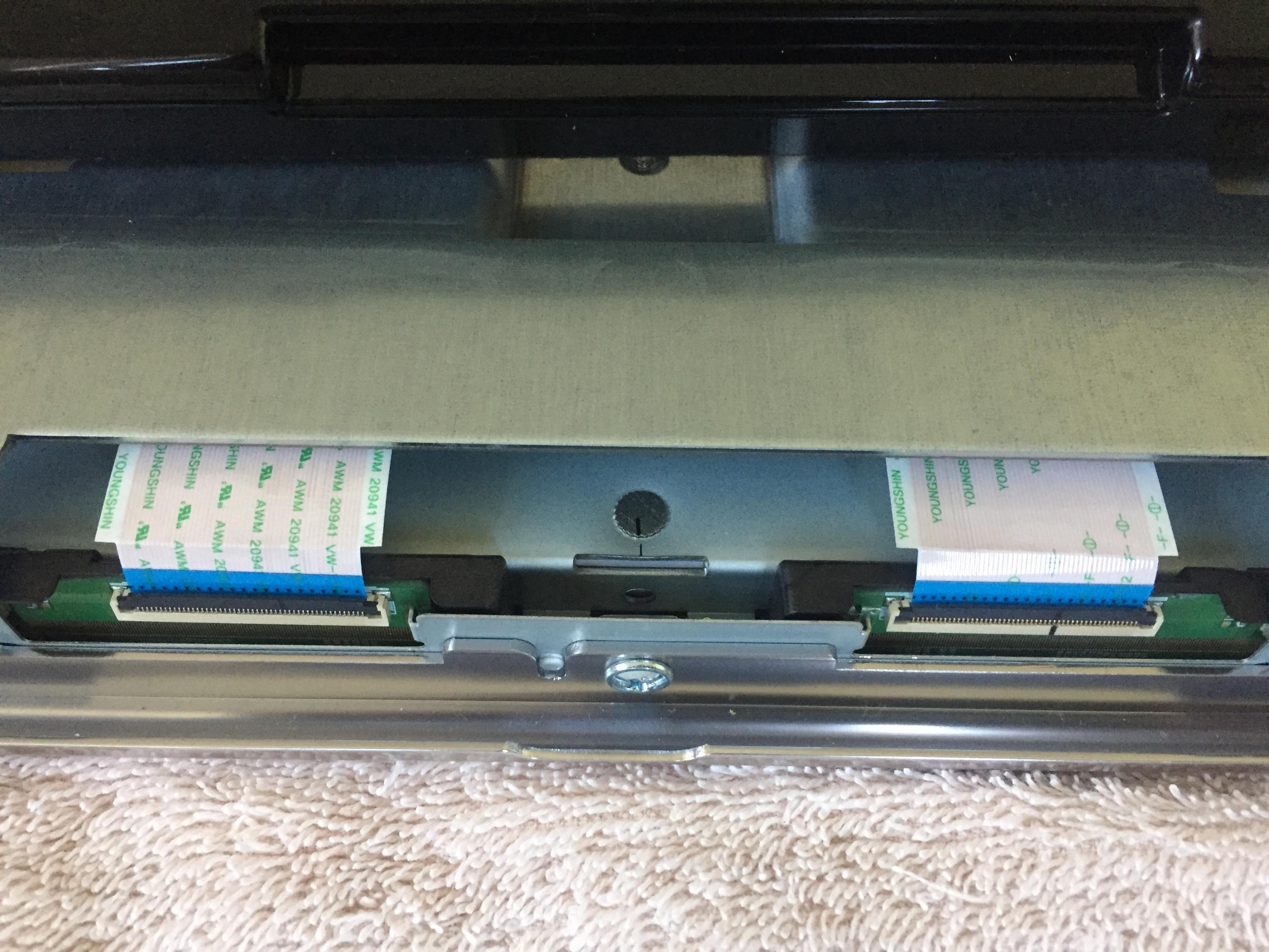

      Have you checked under the stand bracket for the tcon ?

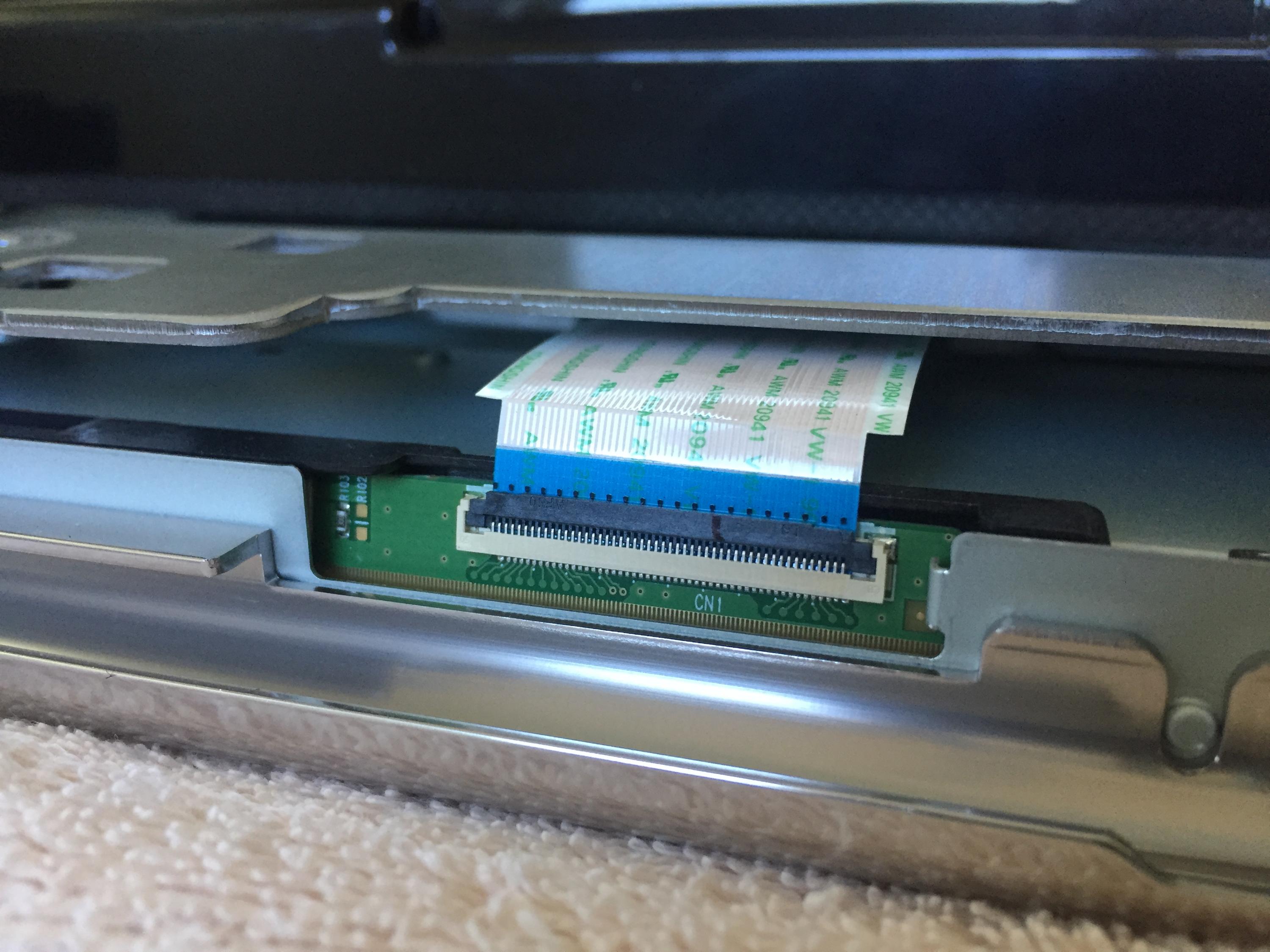

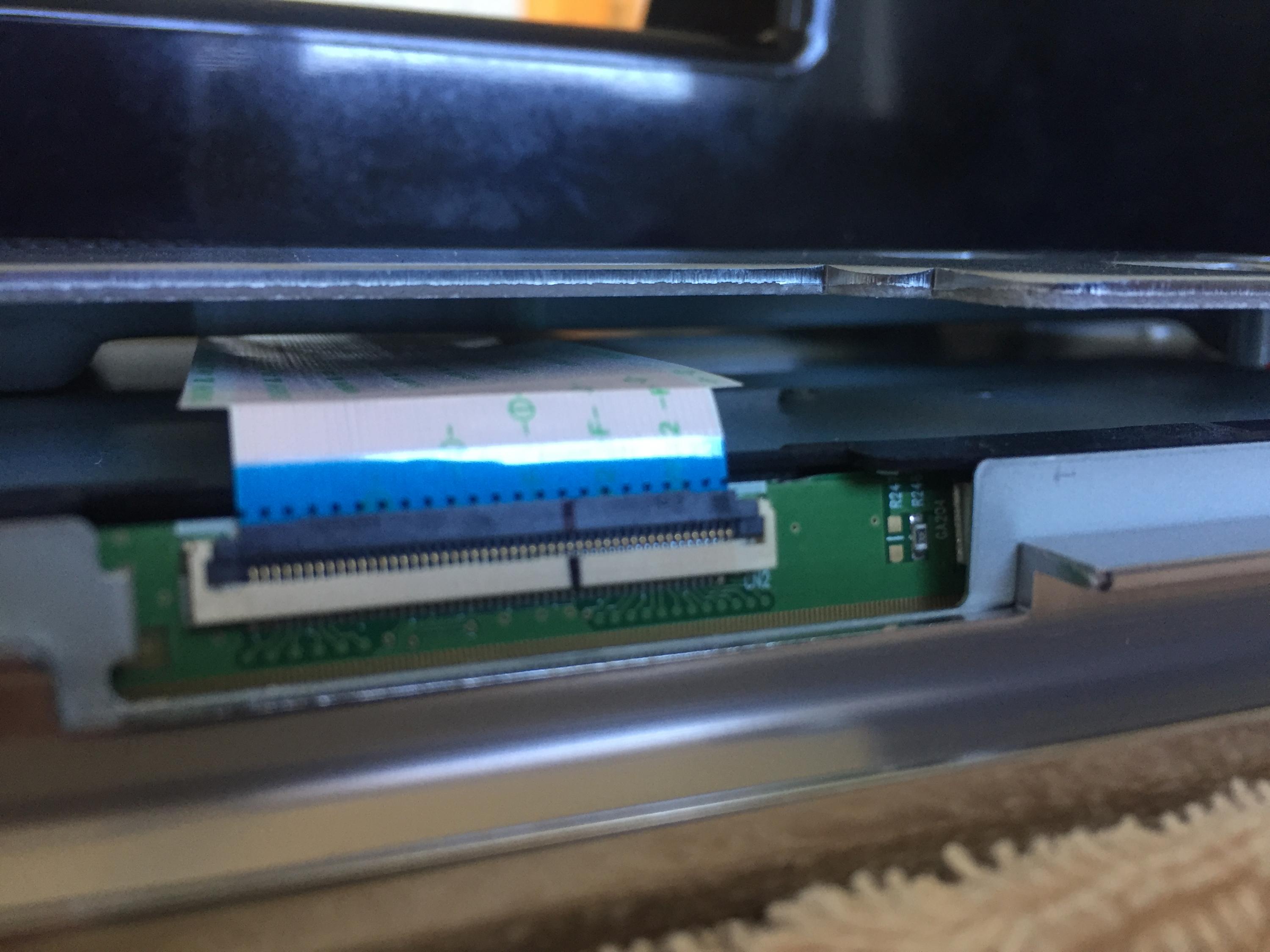

          Diif-thanks for the quick reply
          Here is a pic under the stand of where the two LVDS cables connect to panel. It appears there are two separate small boards in there. Are they TCON boards?

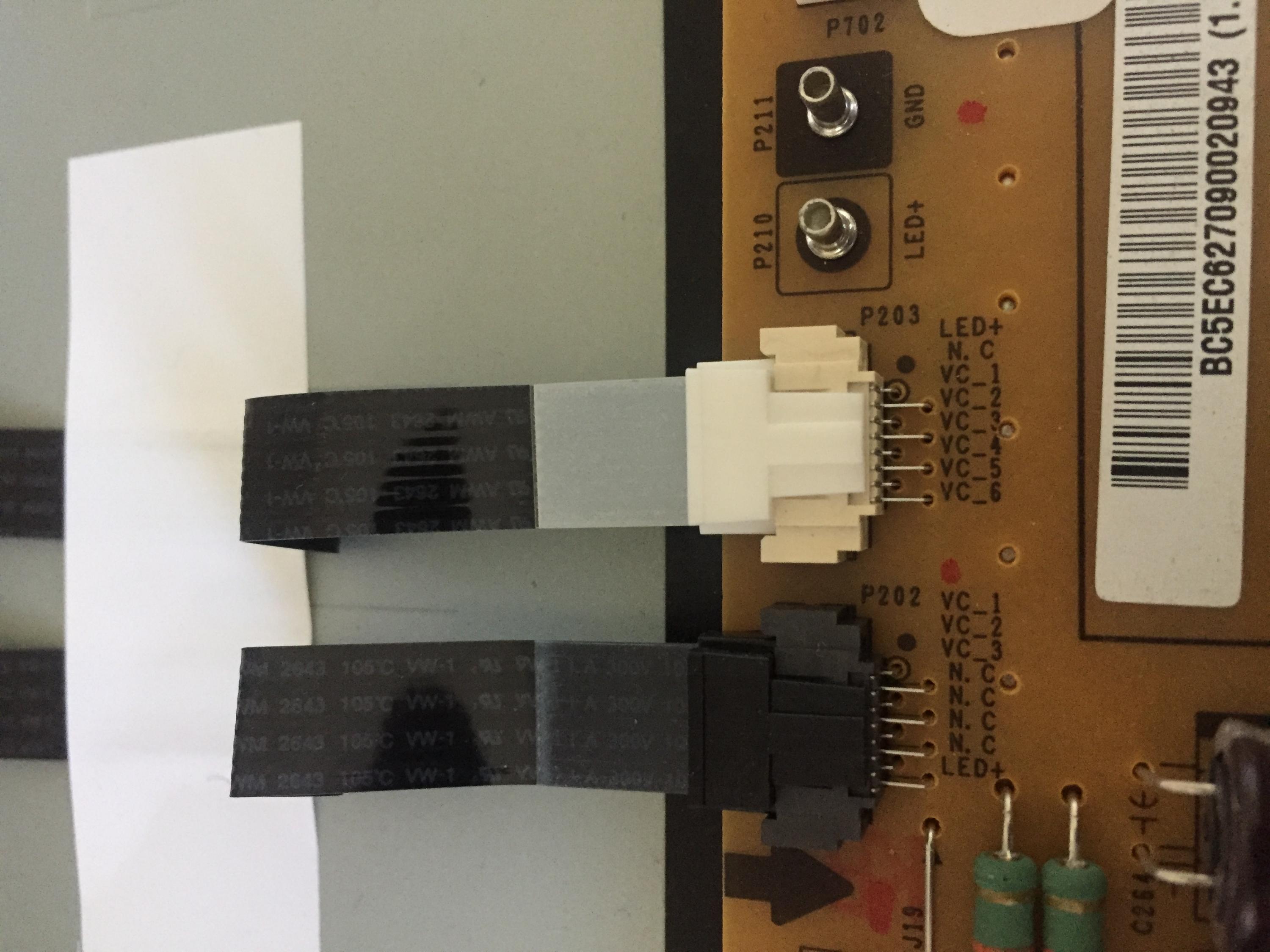

            Here is the connectors in the LED driver section at top of power supply and the volts i tested with set on:
            P210: 81.1V
            P211: 0
            Connectors Left to right:
            Black connector
            1. 81.1V
            2. 0
            3. 0
            4. 0
            5. 0
            6. 19.4V
            7. 19.4V
            8. 19.4V
            White:
            1. 19.4
            2. 19.4
            3. 19.4
            4. 19.4
            5. 19.4
            6. 19.4
            7. 0
            8. 81.1

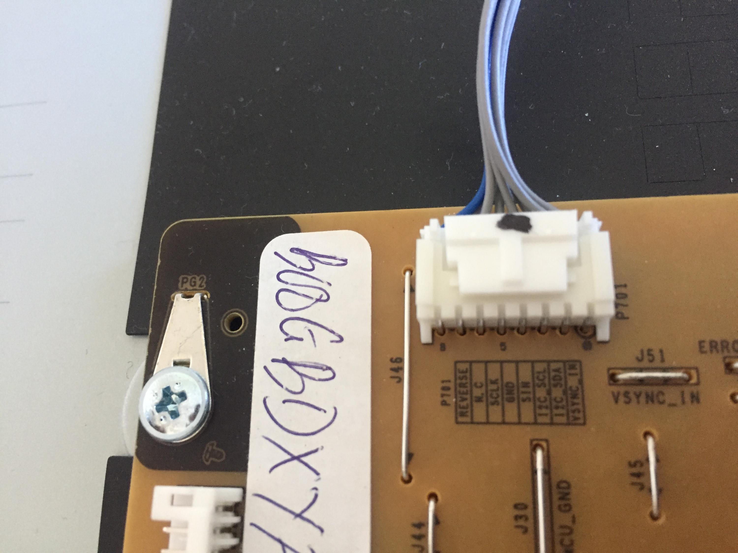

              Okay last picture and the closest I have come to a possible problem. On this small connector (P701) at the top right of power supply to the main board here is what i get with the set on:
              top to bottom:
              1. 0
              2. 0
              3. 0
              4. 0
              5. 0.1V (this seemed odd)
              6. 3.2V
              7. 3.2V
              8. 0
              same readings at the main board side
                You have the classic bga fault. Take off the heatsink on the mainboard and hit the chip with a heatgun on low with a reducing nozzle for about 1 min. Let it cool and then try it. It will work but for how long? I had one that made it 3 weeks and 25 that are still going after a year.
                • Chris24
                  • Feb 2014
                  • 42
                  Thanks- timmy
                  Dumb question: can I accomplish the same by putting the main board in the oven on 385 for 10 minutes as seen in other places on the web? I do not have a heat gun but could take the board somewhere probably.
