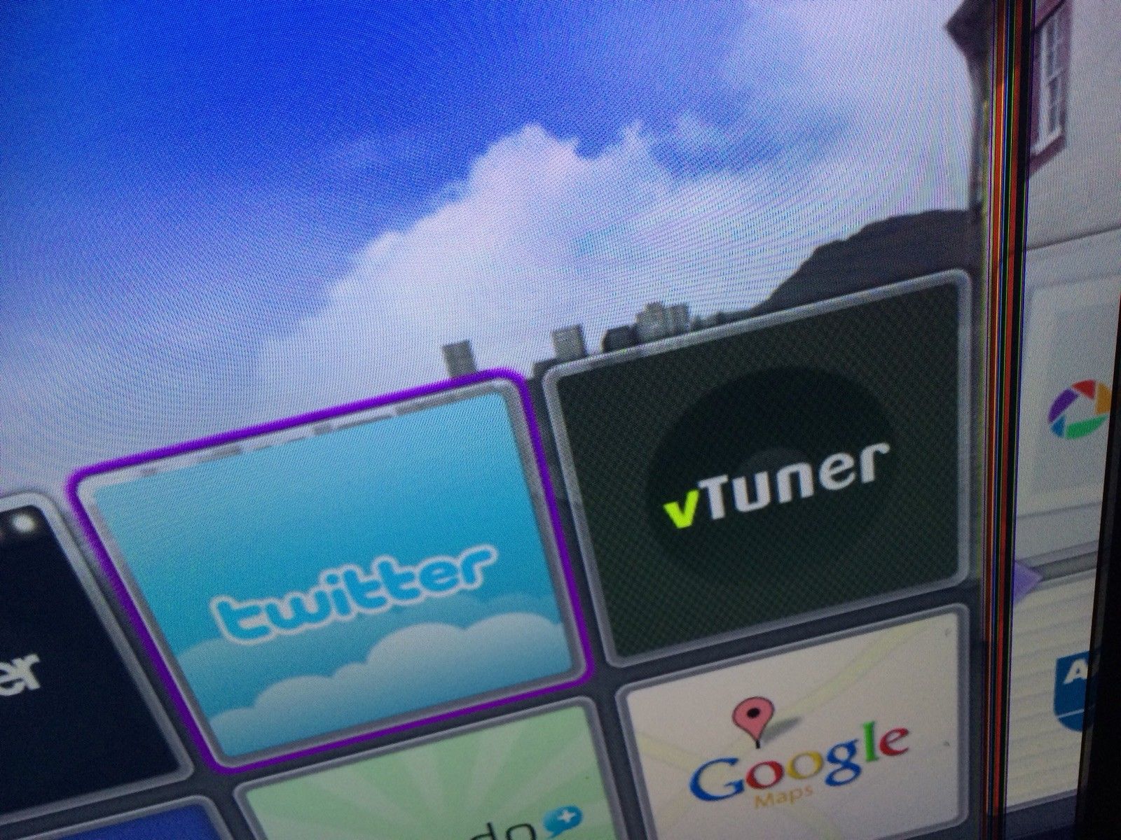

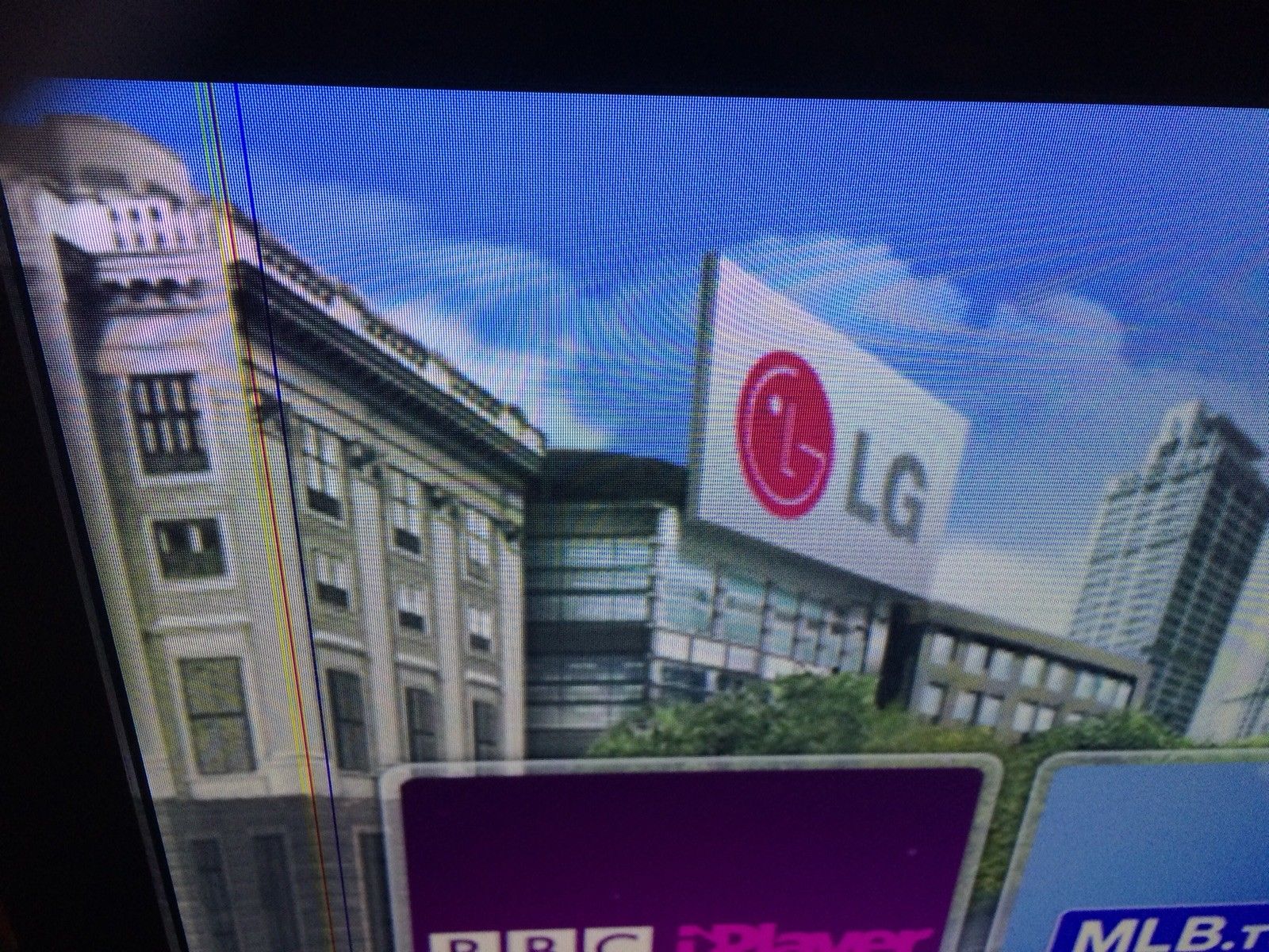

    Hi what can anyone tell me about the screen,panel or is it a tcon issue,i have cleaned connecting ribbon but no change.

    Looks like tab bond on panel

      Death by windex? Look at ribbons coming out of panel at bottom,look closely at them where the lines are. Corrosion on them?

        windex ? from the panel to the tcon ok,even cleaned ! could it be the tab bond,where do i buy replacement bonding ? not sure the panel even comes apart.

          Basically not repairable
            Re: LG lines
            you answer is contradicting ? first off its ribbon bond then not repairable.
              Re: LG lines
              Ribbon bonds aren't repairable without multi-thousand dollar machines. No contradiction at all.
                Re: LG lines
                That's not a contradiction. Not all ribbon bond failures are repairable. Generally only those between the ribbon and PCB are. Those between the ribbon and panel are essentially not repairable unless you have an LCD panel rebond jig...not going to happen.
                too long didn't read - panel's fucked.

                  Didn't see the photo with the lines down. Post deleted.

                        Death by windex(household product people use to clean glass surfaces),might have a different name in your knack of the woods,is an expression used by many of us here .
                        What it means is that when people clean their tv screen with a product like windex or any other liquid type cleaner,that in the process of doing that fluid can run down the panel and hang like drops off the bottom of the panel,inside the tv,right where the ribbon cables come out of the panel. Over time this can cause damage to those ribbons.
                        Hope that gives you a better idea of what I was trying to say.

                          Liquid can run down the screen and cables and sit in the connectors and corrode the contacts.
                          I have been lucky and been able to repair a couple in the past by soldering in fine wires direct to the soldered pins on the ffc sockets.
                          I've also see it destroy tab bonds.
                          Only way know for sure is to strip the panel down.
