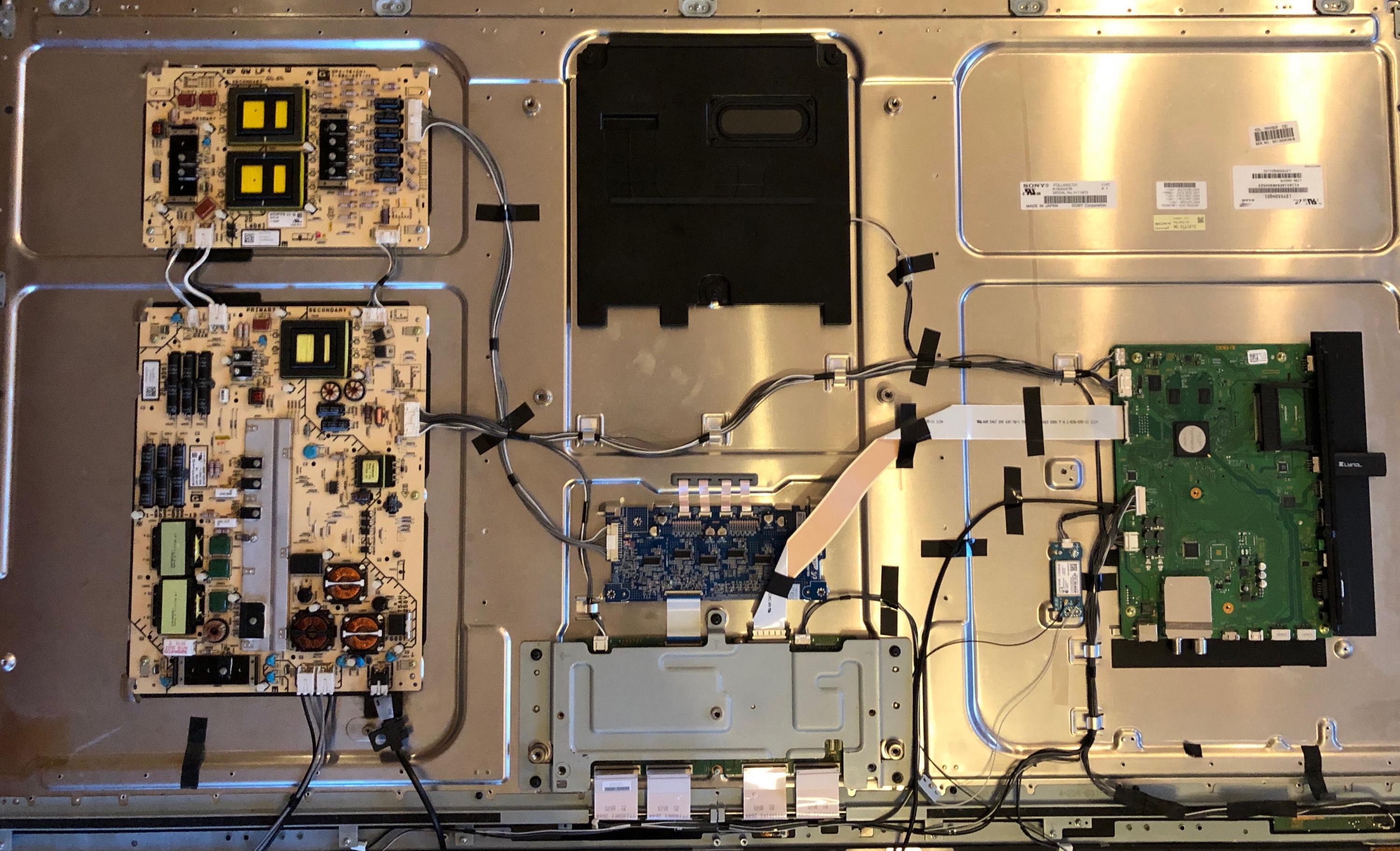

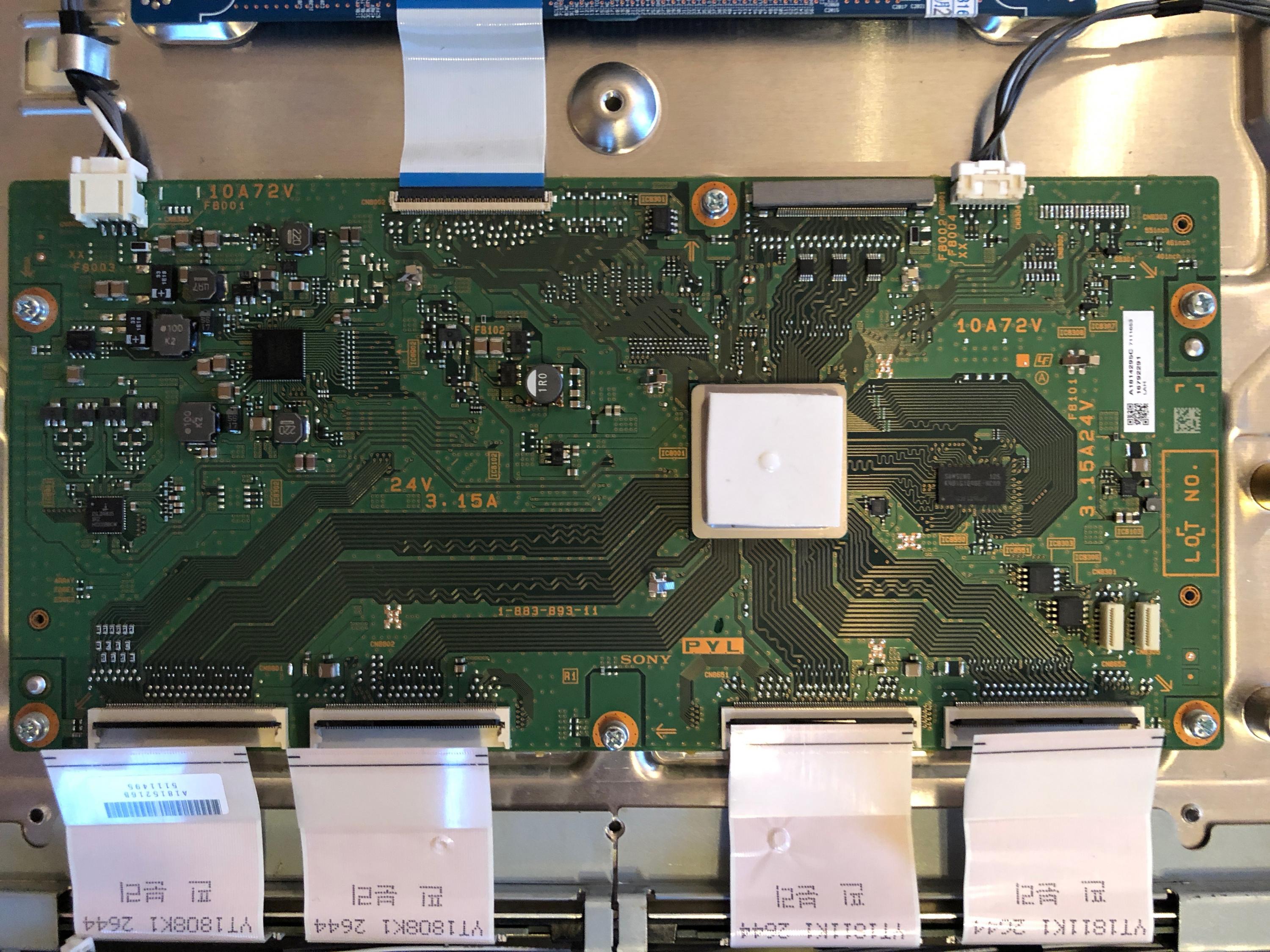

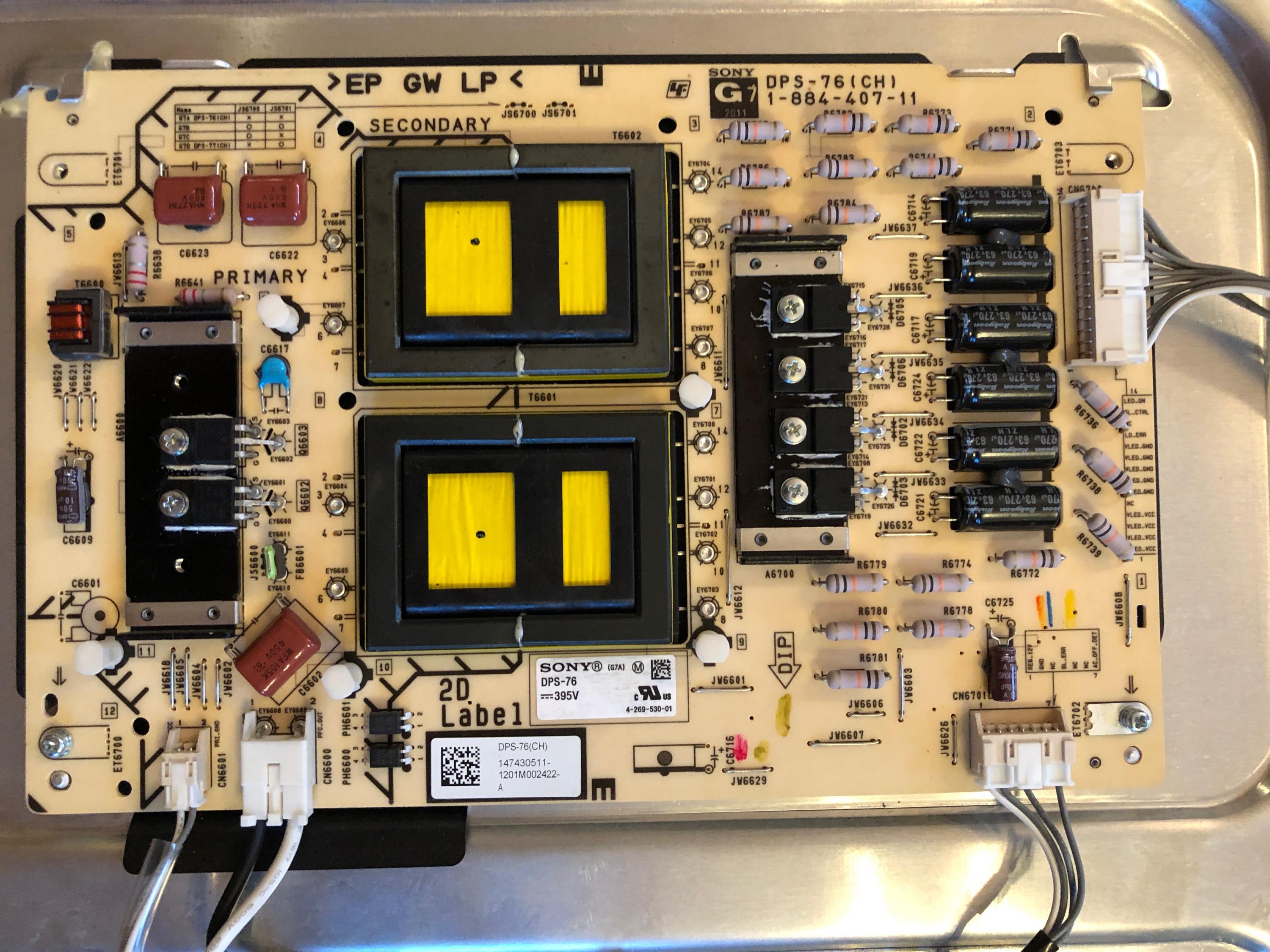

    Can we see good clear pictures of the whole backside of the TV showing all the boards and then the pictures of each board?
    So did you check page 18 and the flow chart for the 4 TIMES Blinking (Balancer error) per service manual page 69?

      Re: Sony KDL-55HX825

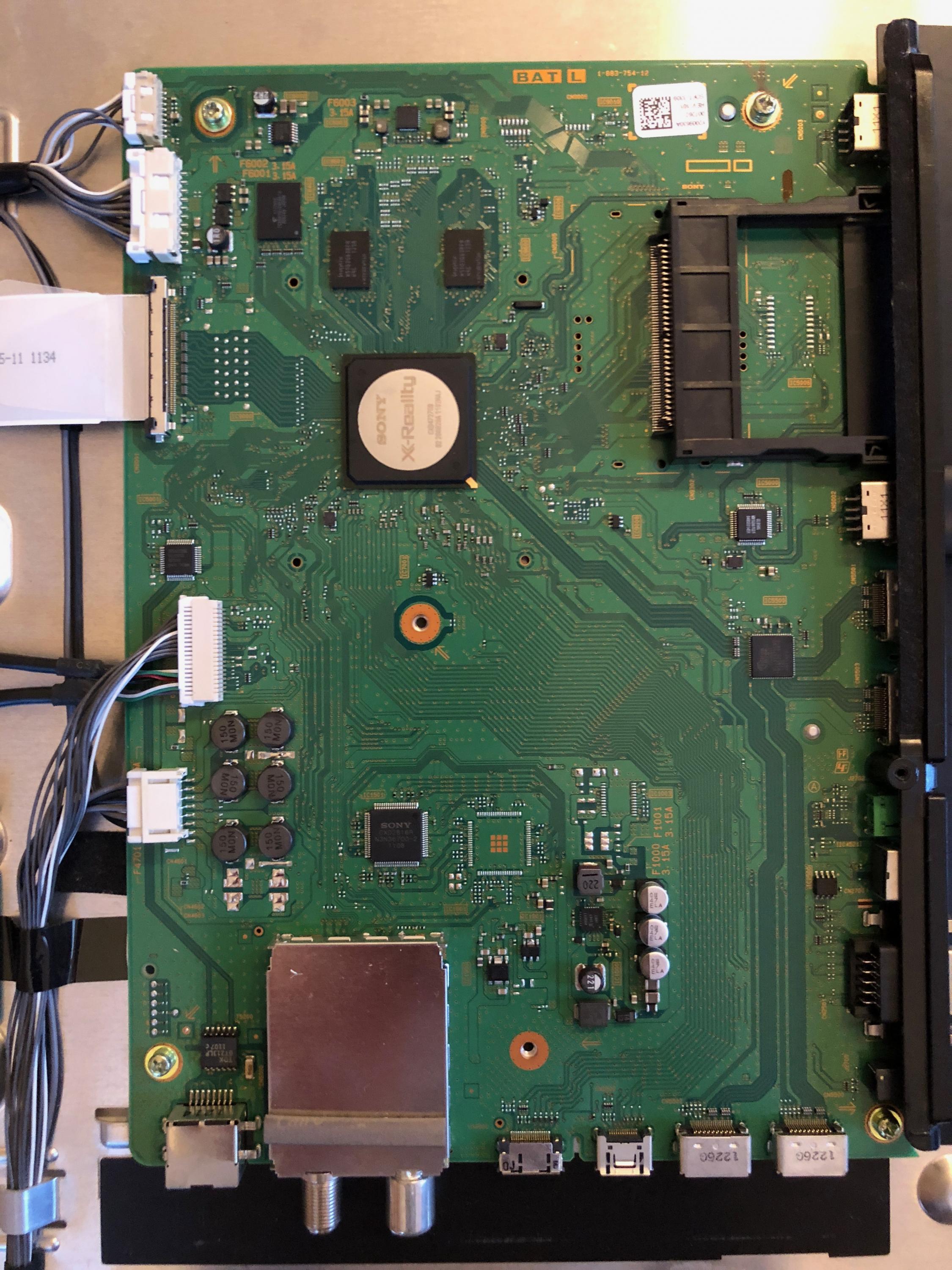

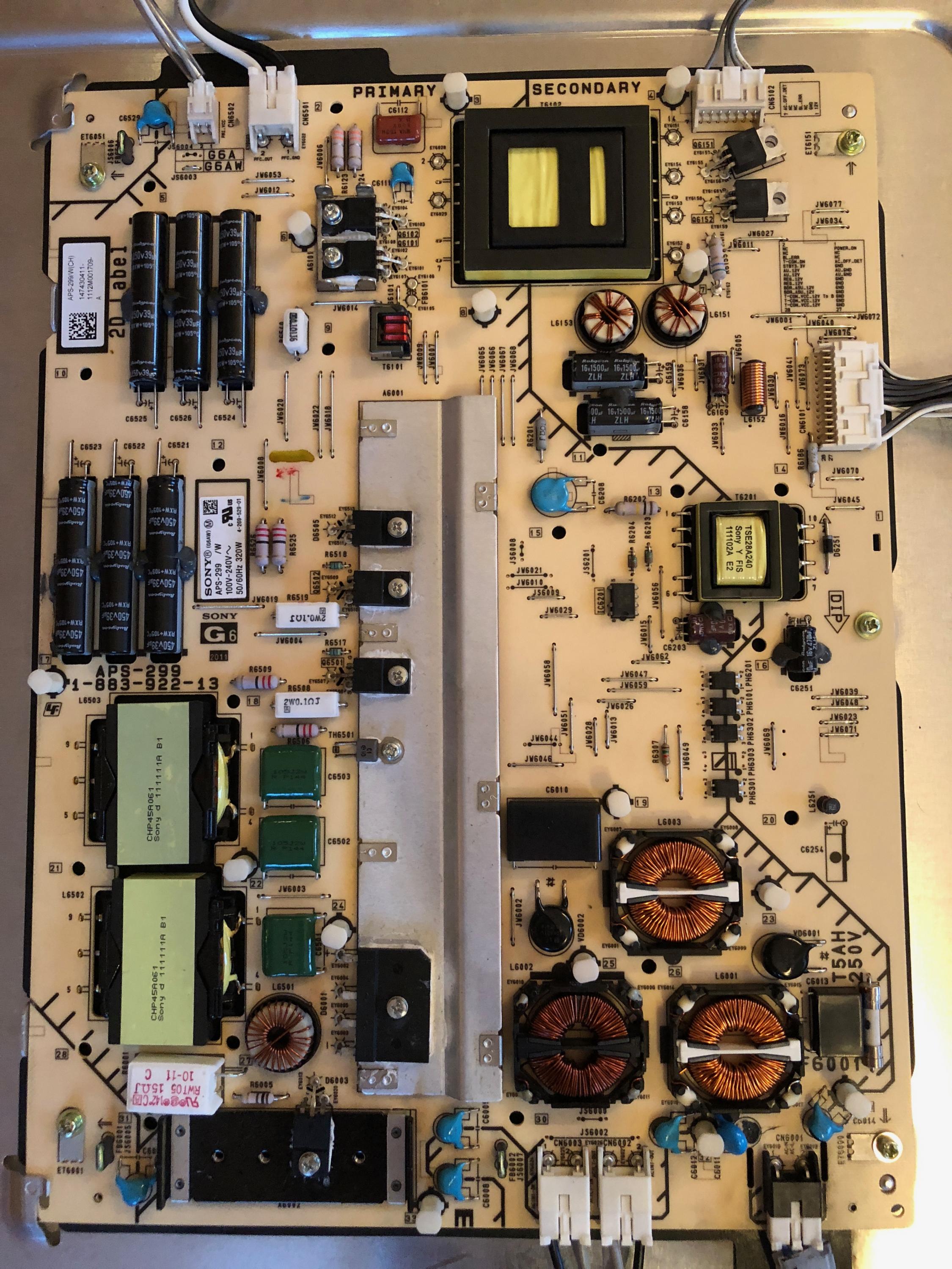

      Thank you for your answer.
      I attached the pictures to this post.
      Yes I went through the flow chart.
      But now I would have to change some boards to find the failure.
      At the moment I don't want to order new boards because they are expensive and it would take 3-4 weeks delivery time (To Germany).
      I rather prefer to find the damage and repair the faulty board by myself.
      I had luck with many other monitors and TVs before.
      But this device is more complex and it would take a long time to go though the whole schematics.
      Is there an easy way to bypass the failure detection at the start?
      I think if the TV would stay on at startup, troubleshooting would be much easier.

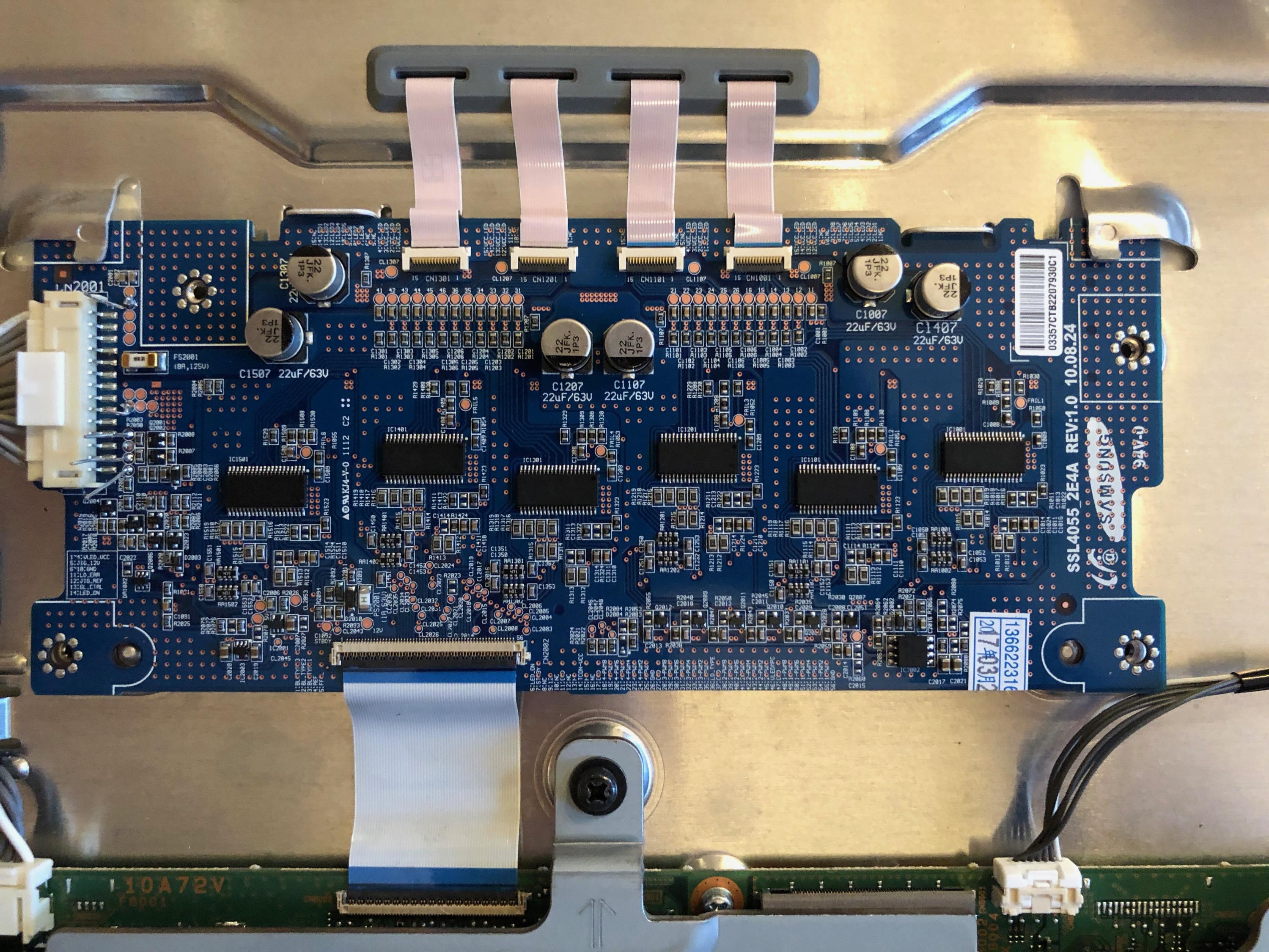

      I think my next step is to go through the LED driver.
      Am I right with the presumption that the LED Driver just gets about 60V input, an enable signal, and PWM signals from the TCON for every single LED strip?
      I know, that the LEDs are arranged in arrays of 10 LEDs per string.
      There are six 6-channel BD9422EFV LED driver ICs on the board. (data sheet: https://cdn.badcaps-static.com/pdfs/...3152ef0dda.pdf)
      It looks like there are 4 channels used of each IC. So I get a sum of 10 LEDs * 6 * 4 = 240 LEDs.
      My idea is to power the LED driver with an external power supply and put a high power LED to each output.
      Then I would put the same pwm signal to all inputs.
      If the output differs I know that there must be a failure.
      Do you think this would work?

              Ok I will go to the tcon board now.
              Until now I know, that when I disconnect the tcon power supply the TV blinks 5 times.
              I will check the fuses the board now!

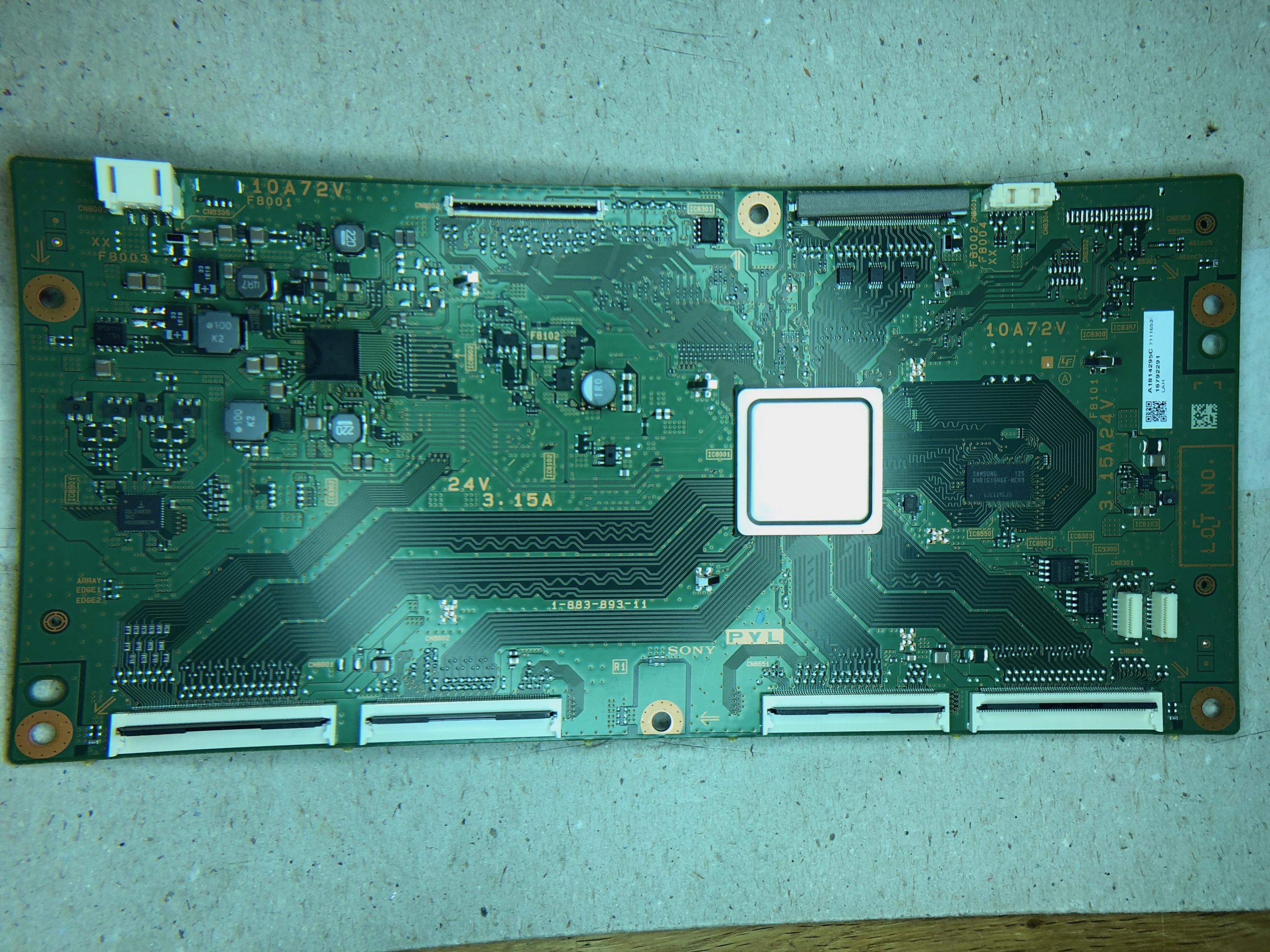

                I checked the fuses:
                • F8001
                • F8002
                • F8101
                • F8102
                They are all at 0 ohms.
                I think I should check the ISL24835 regulator now.
                Edit:

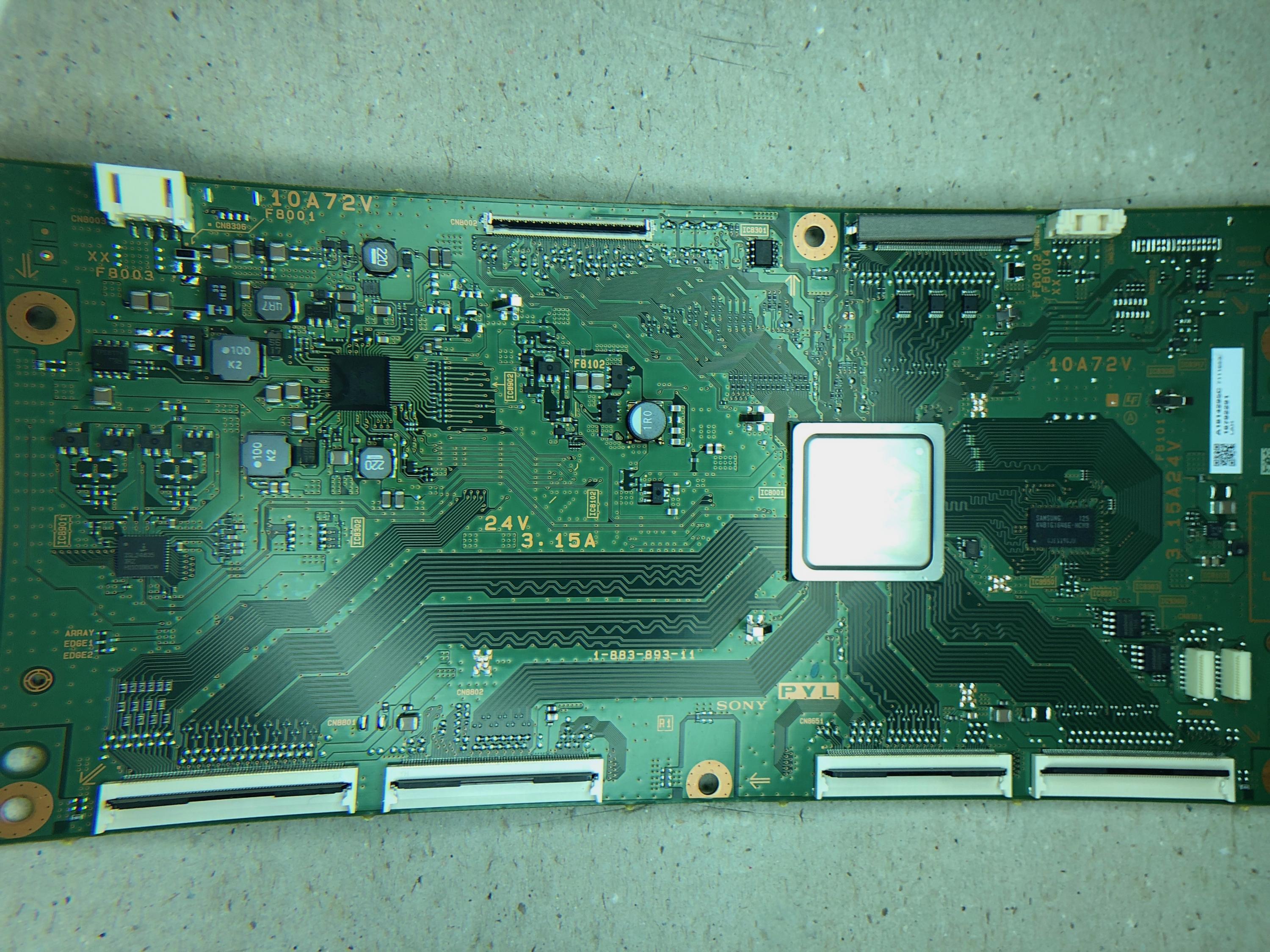

                I added better pictures of the tcon board.
                  I had this problem and changing out the led driver board for the local dimming system solved my problem. One of the BD9422EFV on the LED driver board was faulty. If you did this connect one LED string at a time from the driver board you may see that the picture comes up with 1 section not working. I was able to monitor the output voltages at 1 point and noticed that the LED driver circuit was not putting out voltage to one string. Somewhere I measured a direct short in the driver BD9422EFV.
                      Thanks, I will try this. When I try to start the TV the backlight shows up only in the bottom middle of the screen for a very short time.
                        Yes it could be the tcon as it interprets signals from mainboard where to light up the panel with local dimming. Could be is not sending the LED driver board the proper signals there could be a shutdown as well. As in a mis communication error between the 2 boards.
                        However sense you are seeing some form of backlight come on, The area that should be lit up the most upon turn on would be the middle of the screen where the Sony logo shows.

                          Ok, that makes sense now.
                          I measured all outputs and inputs on the led driver. Found no shorts, everywhere at least 5M ohm.
                          Then I found a sticker on the LED driver board. There is written „13662231671“ and „2017 03 21“. May the second line be the production date? If yes then the LED driver was already replaced by someone before.

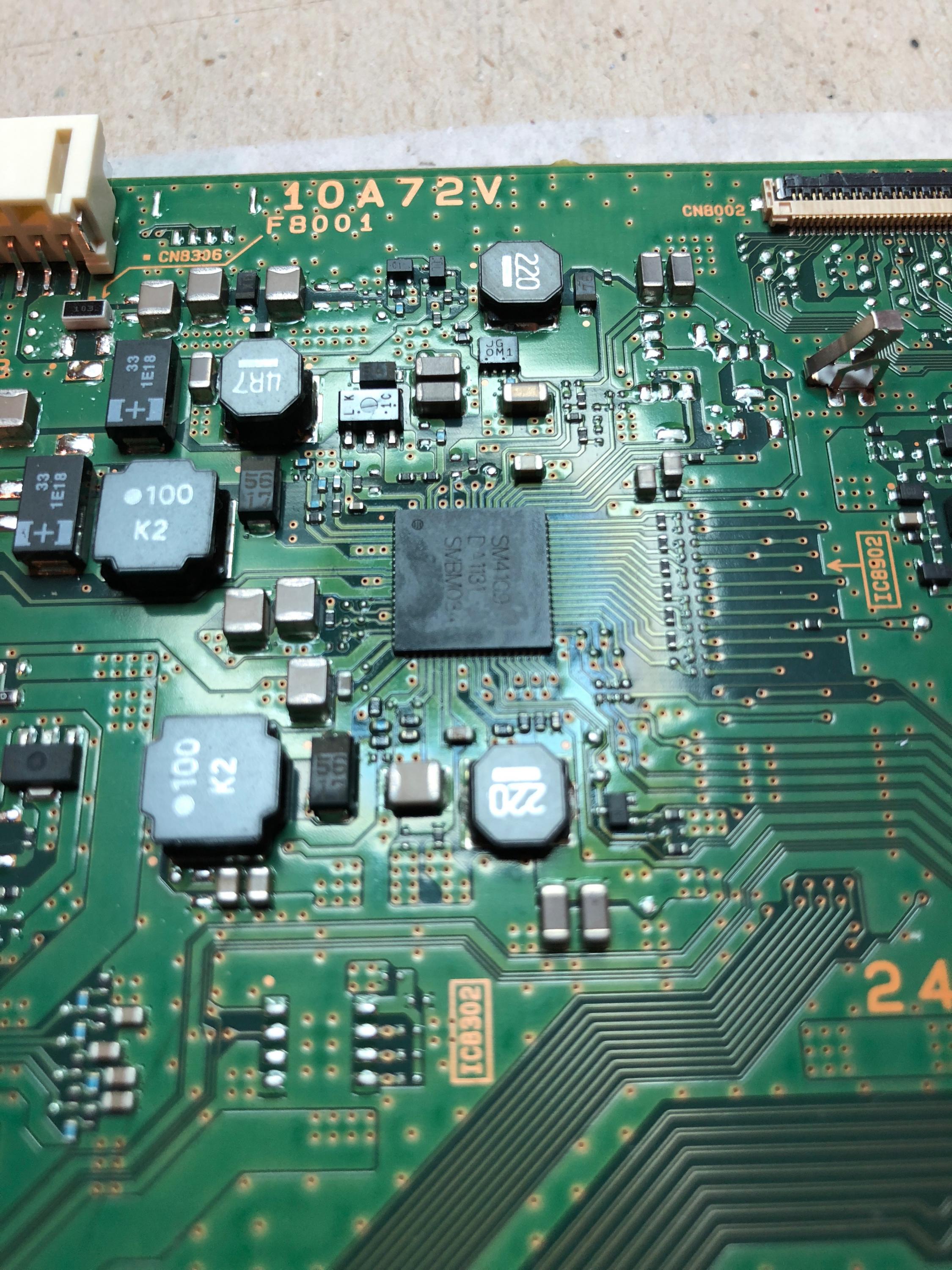

                            Hey guys, what do you think about this?
                            At a closer look to the T-Con board I found this thermal discoloration around the IC.
                            I can't find the data sheet of this IC. I think it must be a DC-DC converter.

                                Thank you all for your help!
                                The TV is back to life now. The problem was the mainboard.
                                I got a mainboard from a KDL-46HX825. After flashing new firmware it worked!
