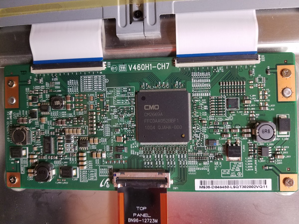

    As the title says, I have a Samsung UN46C6400 which powers on, the LED backlight comes on, sound works, and all the touch buttons work - but there's no picture. When powered on with no input the LED lights are fairly dim, but then when you connect an active HDMI source the backlight gets much brighter and sound comes out of the speakers.
    My initial instinct was a bad T-con board, so I ordered a replacement from eBay - which says it was taken from a working TV with a broken LCD. But after I swapped it out the TV still exhibits the same symptoms. I've messaged the seller to confirm if the board was truly tested to be 100% working, meaning actually got a picture on a TV with that board installed in it, and I'm waiting for a reply.
    In the meantime, is it possible that it could be something else? If the main board or power supply board were bad then I don't think everything else would be working 100% like it does, would it? Or how about a bad connector cable from the main board to the t-con? Is there any chance of that? Or is the board I got from that seller probably defective also? Any way to test it? I don't see any visible issues with either one (bad capacitors, cracked solder joints, etc).
    Looking for some input before trying to buy another part to fix it, since I'm already into the TV $50 before any repairs and it's probably only worth $200-$250 in working condition.
    Thanks!!

      Need some pictures. Do you have power to t-con?

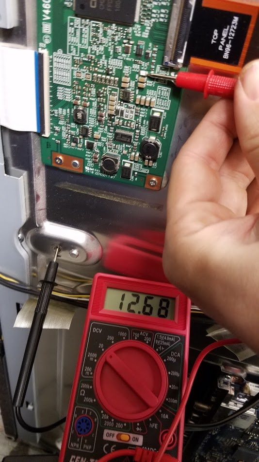

        Do you have 12VDC at both ends of the fuse with ref. to GND?
        There are also many Voltage Test points on the T-CON.

              We need pictures of the boards and the DC Voltage reading with ref. to GND on both ends of the SDM fuse on the T-CON board.

                I just heard back from the eBay seller I bough the t-con board from, and he told me he buys broken TV's and parts them out on eBay, and that particular board came from a TV where the screen was shattered so he can't say with 100% certainty if it actually worked or not. So he offered me a refund and no need to send it back. I'm guess it was probably bad also, in fact maybe since the TV stopped working the owner got mad and took a baseball bat to it - hence the broken screen! LOL
                So before I order another board, is there a was to test that the proper power/signal is getting to the t-con board? I looked on ShopJimmy.com and I see the boards for sale, but I didn't see anywhere that talked about how to test the signal coming from the main board.
                • TVTinkerer
                  • 21
                  Re: Samsung UN46C6400 - TV powers on, backlight comes on, buttons work, but no pic.
                  Also, one odd thing is the board that was in the TV when I got it is P/N 35-D046450. However, when I looked on ShopJimmy that board shows it's for the TV model UN46C6500VF and mine is UN46C6400RF. The boards listed for my TV are either BN81-05772A or LJ94-03436D. http://www.shopjimmy.com/catalogsear...UN46C6400RFXZA
                  Is it possible that this TV stopped working, someone tried swapping out the t-con board with another in an attempt to fix it, but mistakenly used the wrong board and then got rid of it when it still didn't work? So it may not even have the correct board in it? Is there any way to tell what board this TV should have in it by looking at the LCD panel model number?

                      I found my panel number which is T460FBE2-DB, and when I looked that up the only matching T-con board is P/N BN81-04456A (also called 35-D052600).

                          Which one is the fuse that I need to test? Is it C_DF1 just above and to the left of the cable that connects to the main board?
                            It's white with the letter N on it. Up and left from the left hand side of the LVDS connector.

                              Finally had a chance to check the voltage, I get 27V on either side of that fuse. I assume that means the fuse is good? Anything else I should check?
                                You better check your meter and meter setting, there is NO WAY you can have 27Vdc on that T-CON fuse without the T-CON and main board blown up. It should be only 12VDC.
                                  Originally posted by budm
                                  You better check your meter and meter setting, there is NO WAY you can have 27Vdc on that T-CON fuse with out the T-CON and main board blown up. It should be only 12VDC.
                                  I'm an idiot, I had it in AC mode! Looks like it's 12.67-12.68VDC, same reading on both sides of the fuse.

                                      I did notice that while the name on the top of the new board I received is the same (V460H1-CH7), the actual model number is different (orig board 35-D046450, new board 35-D052554). But according to some resources I've looked at (such as this eBay listing which shows compatible p/n's: https://www.ebay.com/itm/142518918534) they *should* be interchangeable.
