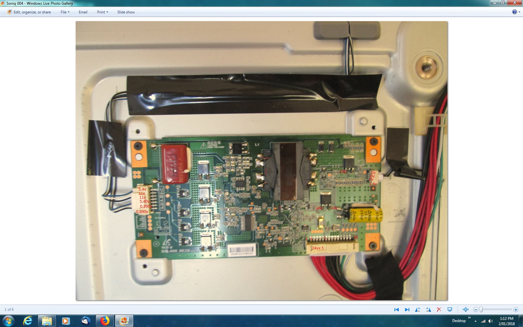

      I don't know the model but being a Soniq would check voltages on the 4 regulators on lhs.
        Re: Soniq Smart TV, No Backlight.
        https://www.badcaps.net/forum/attach...4&d=1514874427
        Can we get better picture that is in focused? I cannot read the designators, labels, etc.

          OK, I've found the problem for sure, its a failed LED backlight. I measured the voltage on the power going to the backlight LEDs from the LED driver board 3 of them read 11volts and one read .895volts. I unclipped the plug from the LED driver board and all the LED driver board readings were 11volts. So, its the number 4 LED backlight ribbon and probably #3 as well. I contacted Soniq to source some LED ribbons for it but they said they don't have any because that model is out of production. Is there some way I can adapt, cut down to size some other LED ribbons or replace the individual failed LEDs? This is all that's wrong with this excellent TV, can anyone help me with this?

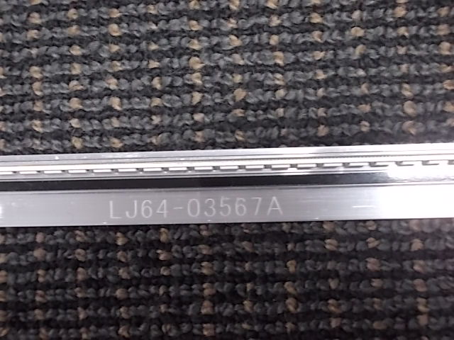

                                    You may try contacting comtek in post #12
                                    Panel spec.
                                    http://www.datasheetspdf.com/datasheet/LTA400HM21.html
                                    I believe the LED strip P/N is LJ64-03567A.
                                    You should search around and verify, you may want to open up the panel and see.
                                    Is this your LED driver board?
                                    http://www.shopjimmy.com/samsung-lj9...led-driver.htm

                                      Yes, thats the right driver board and the right LED strip. Soniq Australia just replied with a photo of the LED strip, now I just have to figure out the right individual LEDs to source and repair the strip? Do any of the numbers on the strip identify the LEDs used by any chance?

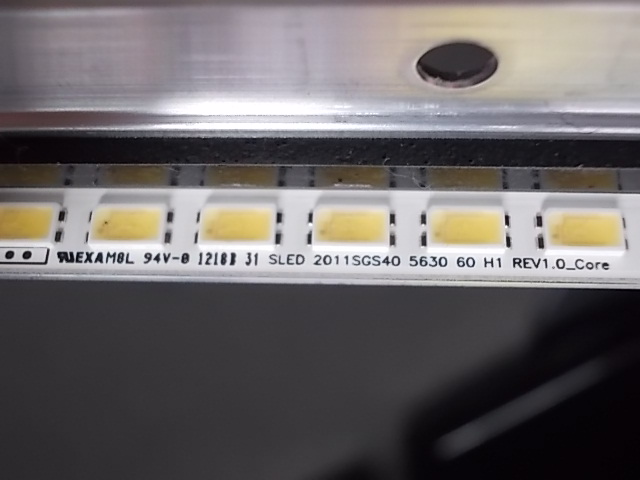

                                        Whats going on here? It looks like carpet. lol But I suppose it's for dispersing the light from the lights around the edges of the screen? I checked ebay for 5630 LEDs, that was a number on the strip. I can get a 5-meter strip of 300 5630 LEDs for $5. Would that be right? I haven't dismantled the display because I want to know what I'm in for first and if I can get the right LEDs? P.S. Something went wrong when I tried to upload the other photo, this post disappeared, so I uploaded it to the last post. lol
