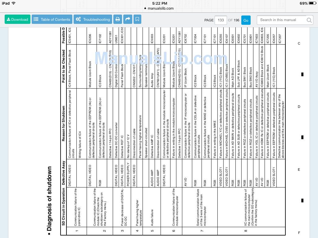

            I found a aerv man for pro810hdi
            It says 3 green flash shutdown is power decrease of the digital dc to dc converter

              Here is a screenshot.....where the circled 3 is defines the area where 3 flash code exists
              What is the digital video assy?

                Here is another screenshot...the 3 on left means 3 green flash sequence error

                          Flashing green 3 times is DEW_DET, I suspect the tv got wet, there is a moisture sensor on the y drive assy, plug CN2002
