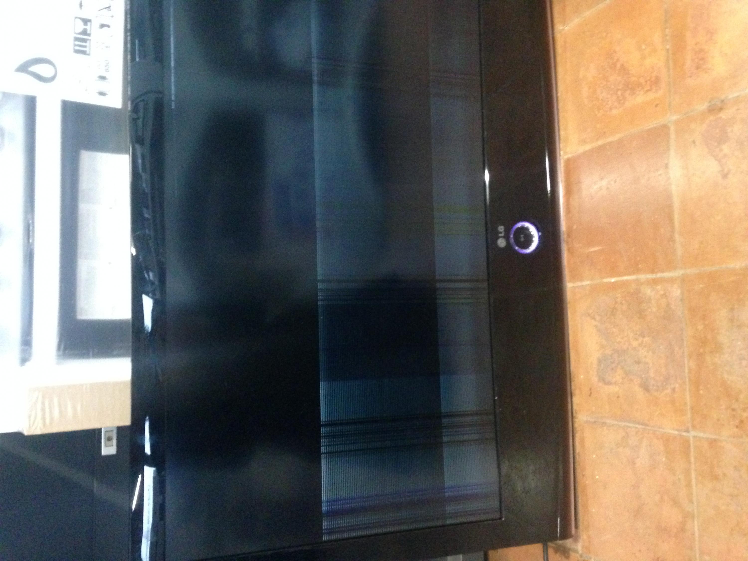

LG 37LH7000 vertical lines, no image

    Hi guys! I don't have a lot of experience so ask you to help the TV has vertical lines, no image, sound ok. T-con is changed, no effect. Cables are cleaned, no effect. I've also checked all pins on t-con going from main to t-con. Voltages on main seem to be ok. Bad panel?..
    sorry for pic. don't know how to turn it
    thanks

    Re: LG 37LH7000 vertical lines, no image
    Yes this looks like another bad panel, I'm afraid.
      Thanks!
