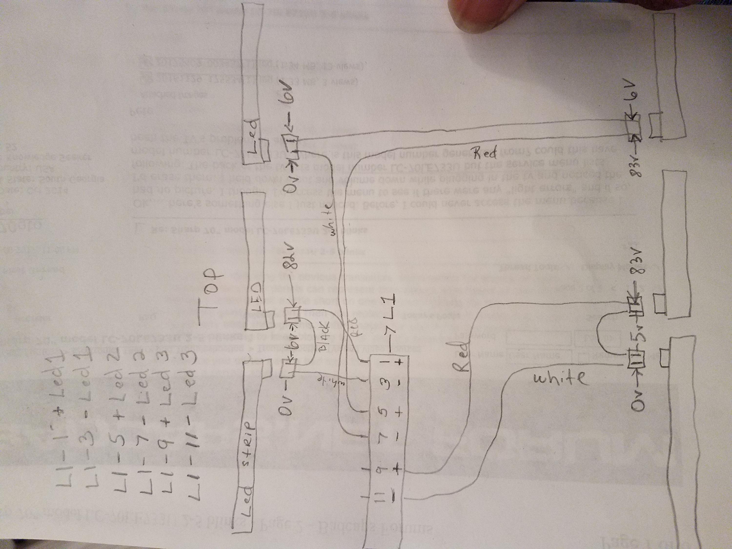

        I had removed the panel and tested all led backlights.
        I used my led backlight tester.
        All leds lit up bright

            Originally posted by budwich
            OK. well, i would do the "disconnect the corner cable" as suggested earlier and see what the results are from doing that... this "test" is done with all tcon cables connected.
            Ok disconnected the left corner and nothing.
            V light lit up
            Did not have flash fault code re-appear.
            Im thinkin maybe backlight led issues...
            I took some measurement with dmm with leds connected and power on.
            Might have power board issues or whats preventing leds from coming on...

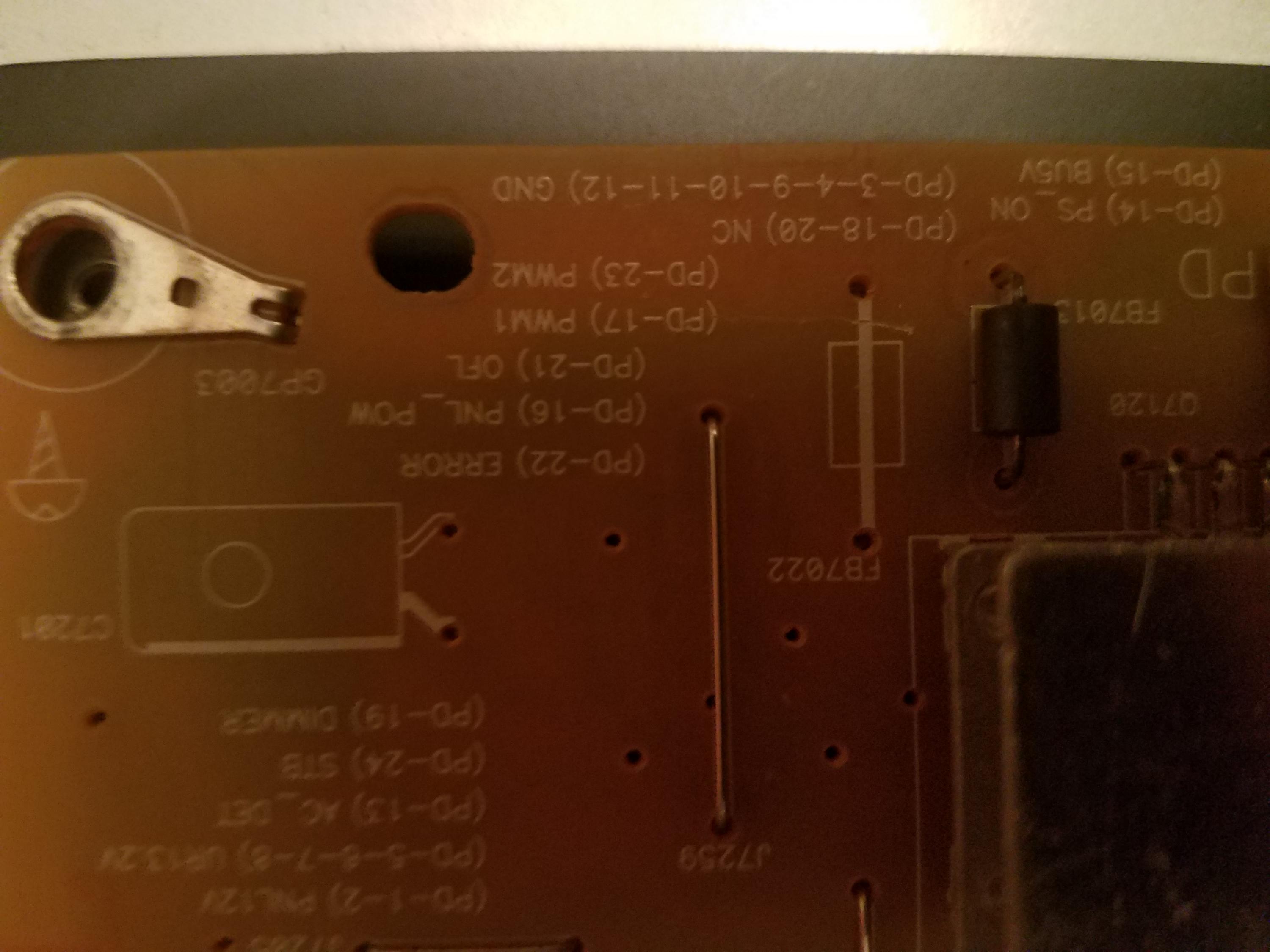

              PWM signals from the T-CON are used for controlling the brightness of the backlights base on the scene of the video for dimming control so they can claim fake high contrast ratio, no PWM = no backlights. You have 3 sets of edge-lit LEDs, thus 3 LED drivers circuits.
              What do happen if you disconnect just that cable from the T-CON? Also test the PWM pins too without the cable in place.
              Those 83 V LED voltage reading are made against chassis GND?
              STB = BL-ON, that siganl will be locked out if ERROR pin is HIGH.
              You are 100% sure that PNL-12V is present and not drops out afetr seconds or two?

                The 83 volts for led is against chasis ground.
                Pnl-12 is pin 16 reads 3v
                Error voltage is reads 0v

                  PNL_POW PIN 16 (3V =ON) is the command signal to turn on switched 12V to feed the PNL-12V pin on the other connector that goes to the T-CON board.
                  So do you have 12VDC at PNL-12V or not for sure?
