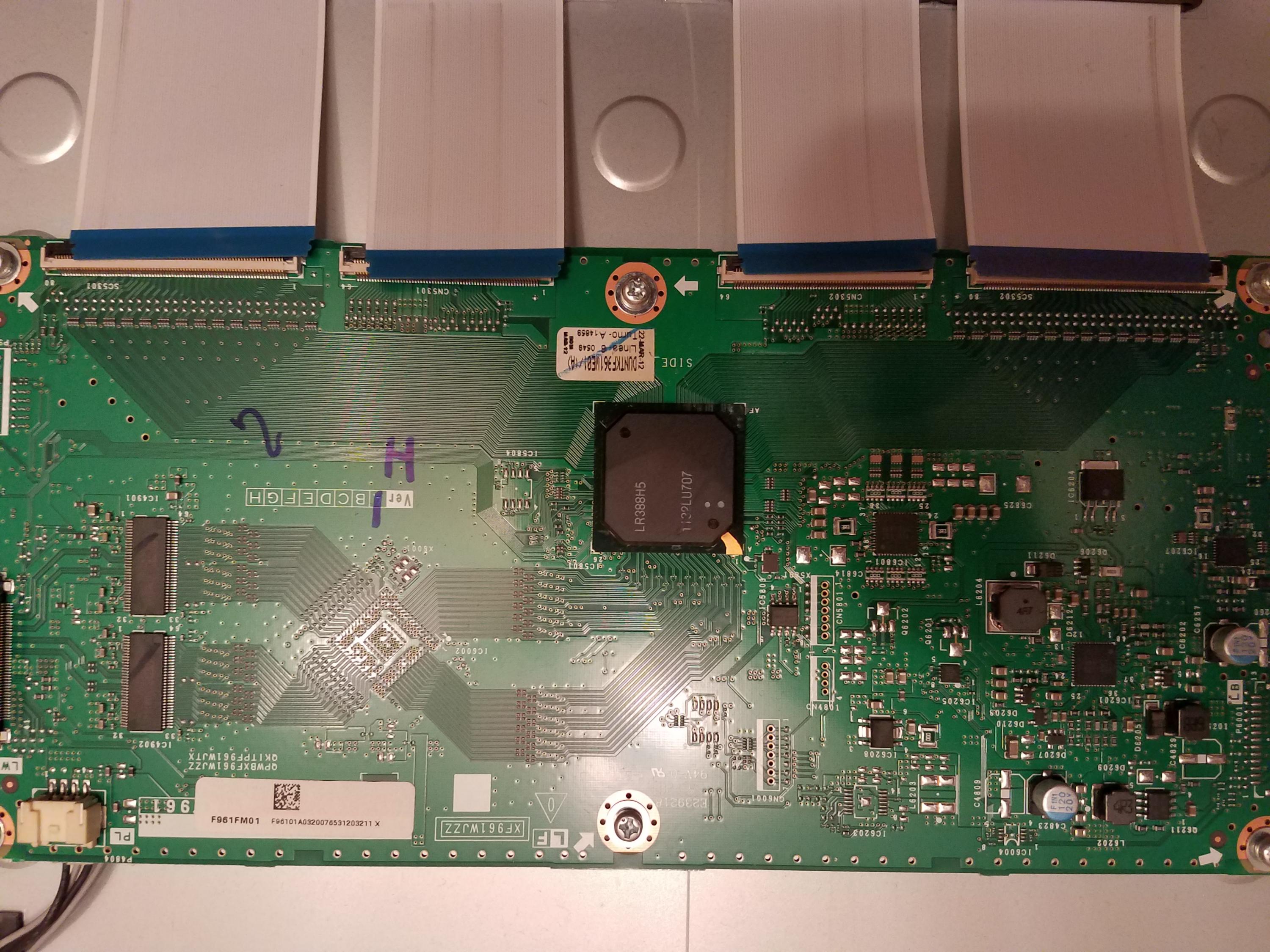

    I have a sharp tv with a blink code of 2 blinks and 5 flashes. I have no back lights when it is powered on.
    I removed the back and tested all back light. They all work.
    I took reading and it seem everything points to the main board. Any help... im also thinking i will need schematics for this tv and a reset to get rid of fault code.
    The tcon board looks like it had some thermal issues from pictures

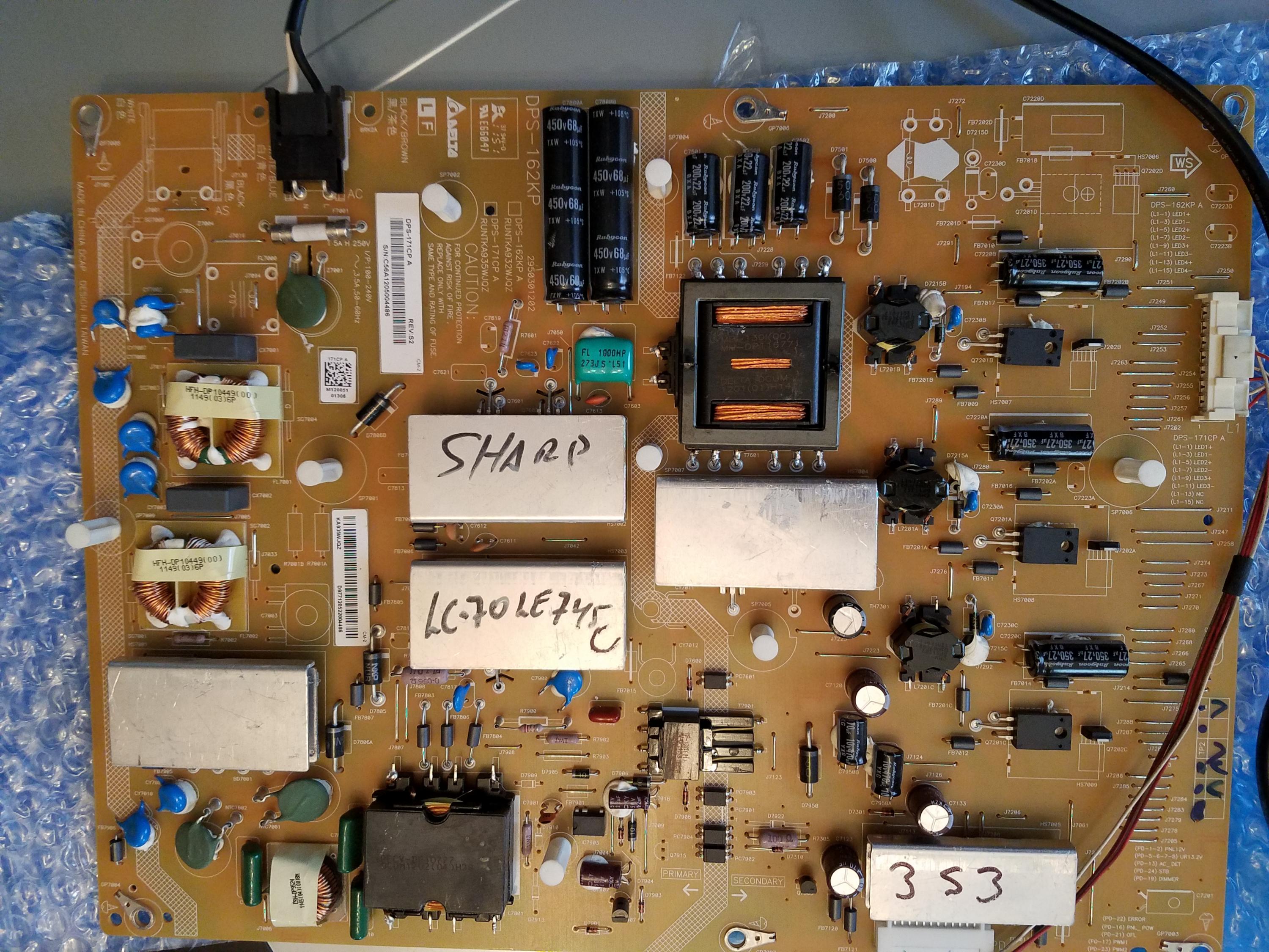

      pin 15 stby voltage is present, but pin 14 ps/on command is missing.
      so right now you are not getting your on command from the main board to turn on the ps.

          if your attempted "power checking" was done with the tcon disconnected as shown in your pictures, then it is unlikely that you will get "ps-on"... you need to have at least one "side" of the tcon connected to something (ie. two cables).
          • freakaftr8
            • Oct 2012
            • 3743
            Re: Sharp LC-70C8570U
            I believe sharp tcon will function without the panel connected is long as a tcon is connected

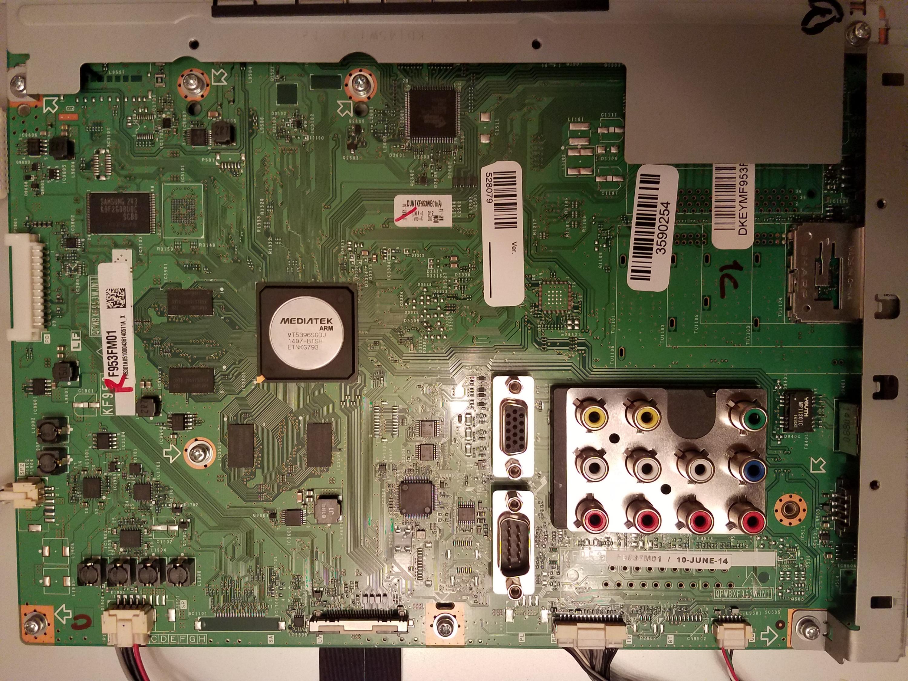

                    I am suspecting main board....
                    Any schematics or where i might find...
                    This board is expensive and hard to find...
                    Dkeymf953fm01... or would fm06 or other versions work

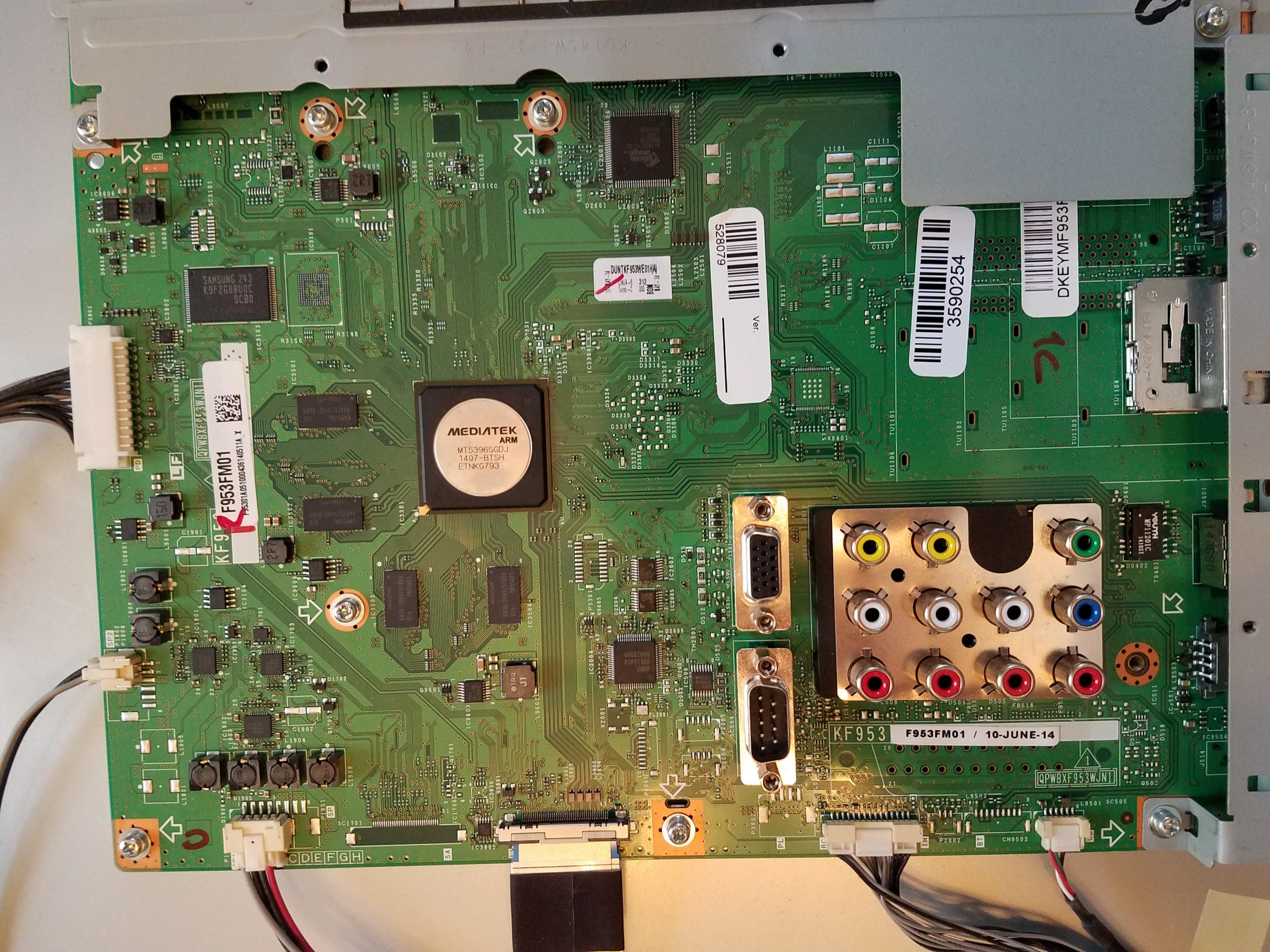

                        Green led light is flashing on main board...
                        I am goin to retest power supply point..
                        Still same fault code 2/5 no leds light up and they were tested good

                          Ok results from power supply reading.
                          Also reading from Led connector 83 volts.
                          This is with power ON condition

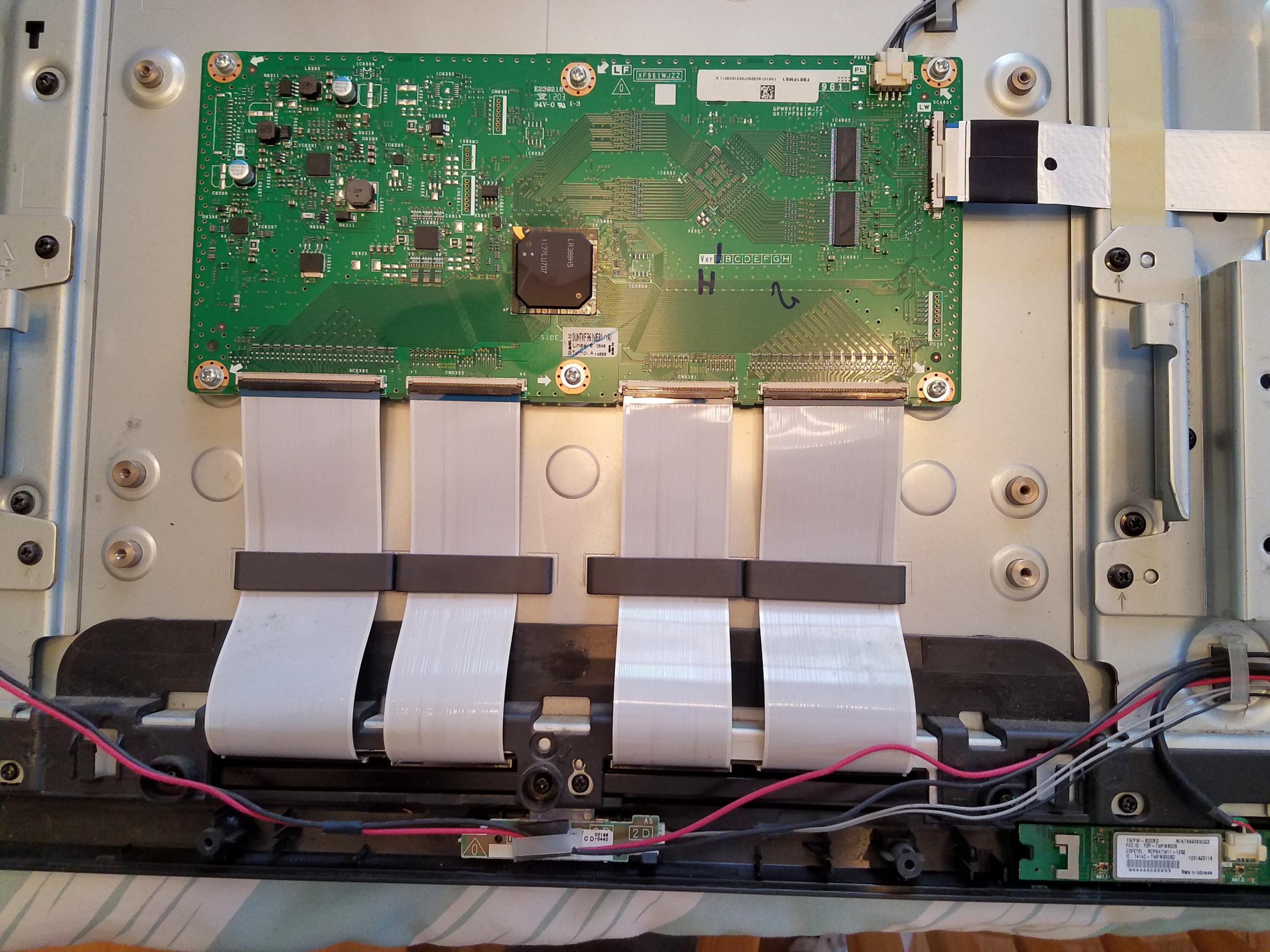

                                    Ok try the same procedure with all 4 ribbons disconnected from tcon to panel. That you will still have the tcon connected to mainboard Then try just the left two thenr the right two
                                    • nelson6861
                                      • Jul 2016
                                      • 67
                                      Ok i will
                                      • nelson6861
                                        • Jul 2016
                                        • 67
                                        Right ribbon cable disconnected /left connected to t-con board.
                                        -no fault code flashes
                                        -no picture or backlights
                                        Left ribbon cable disconnected / right connected to tcon board
                                        - 2/5 flash fault code
                                        - no picture or backlights
