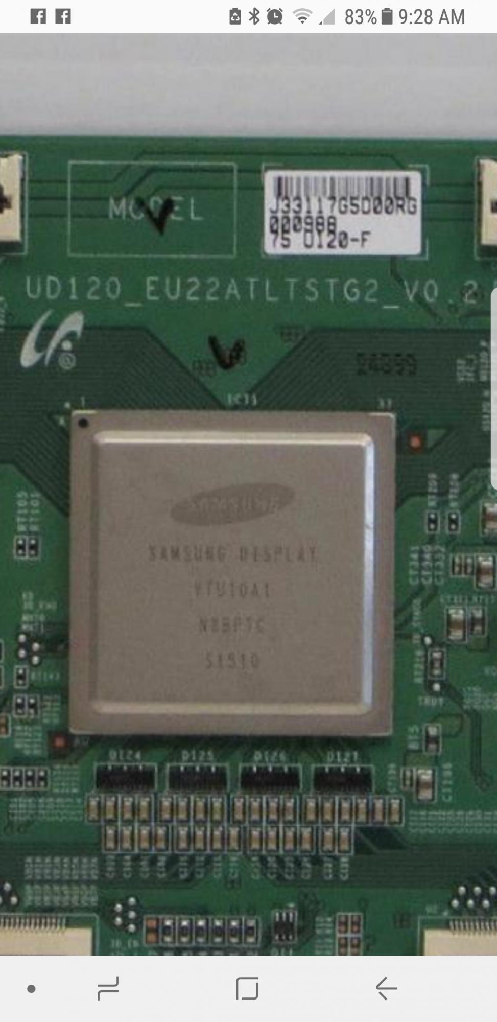

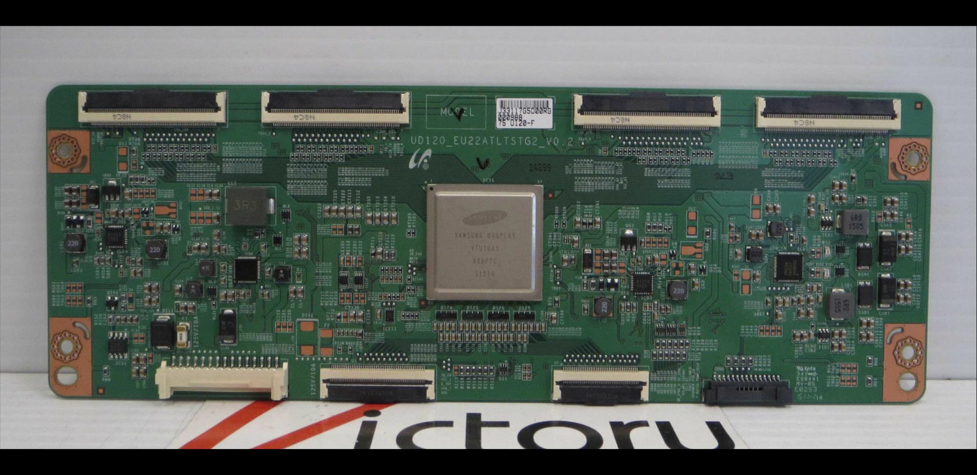

            #65
            Re: Sony XBR75X850C no picture backlights on
            Yes this is a Samsung LCD panel.
            Tcon Part number LJ94-32255G
            That part number is definitely Samsung
            It's a good idea about reading in the eeprom.
            I tried feeding 16 from another tcon. Did not get good results most likely because of cross talk.
            But check this out. Similar tcon, same processor IC. For a Samsung un75ju641df uses same everything.

              #66
              same what? I don't see ic markings...
              • freakaftr8
                • Oct 2012
                • 3743
                #67
                Main processor.
                Samsung model.
                Mine is also VTU10A1

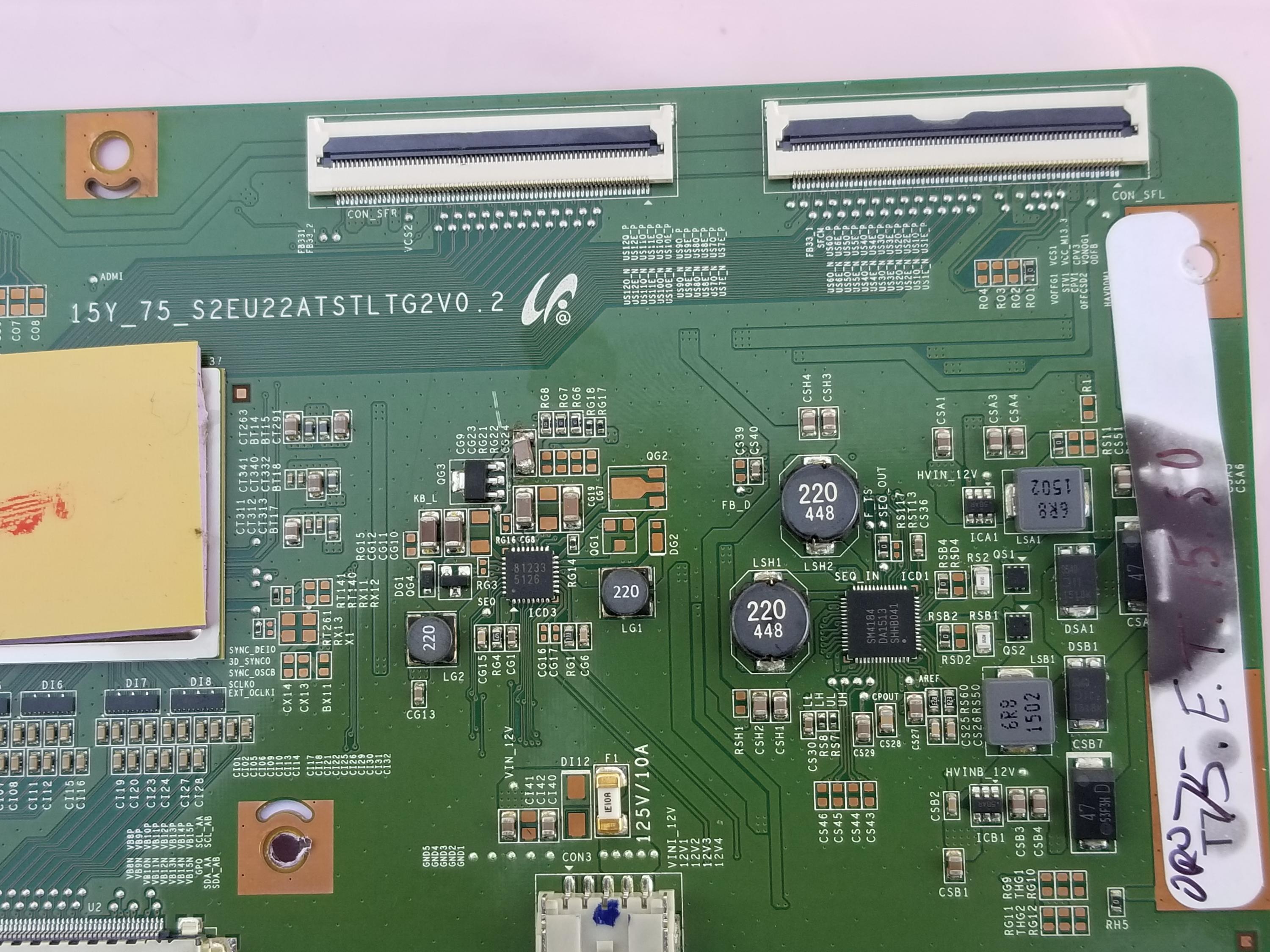

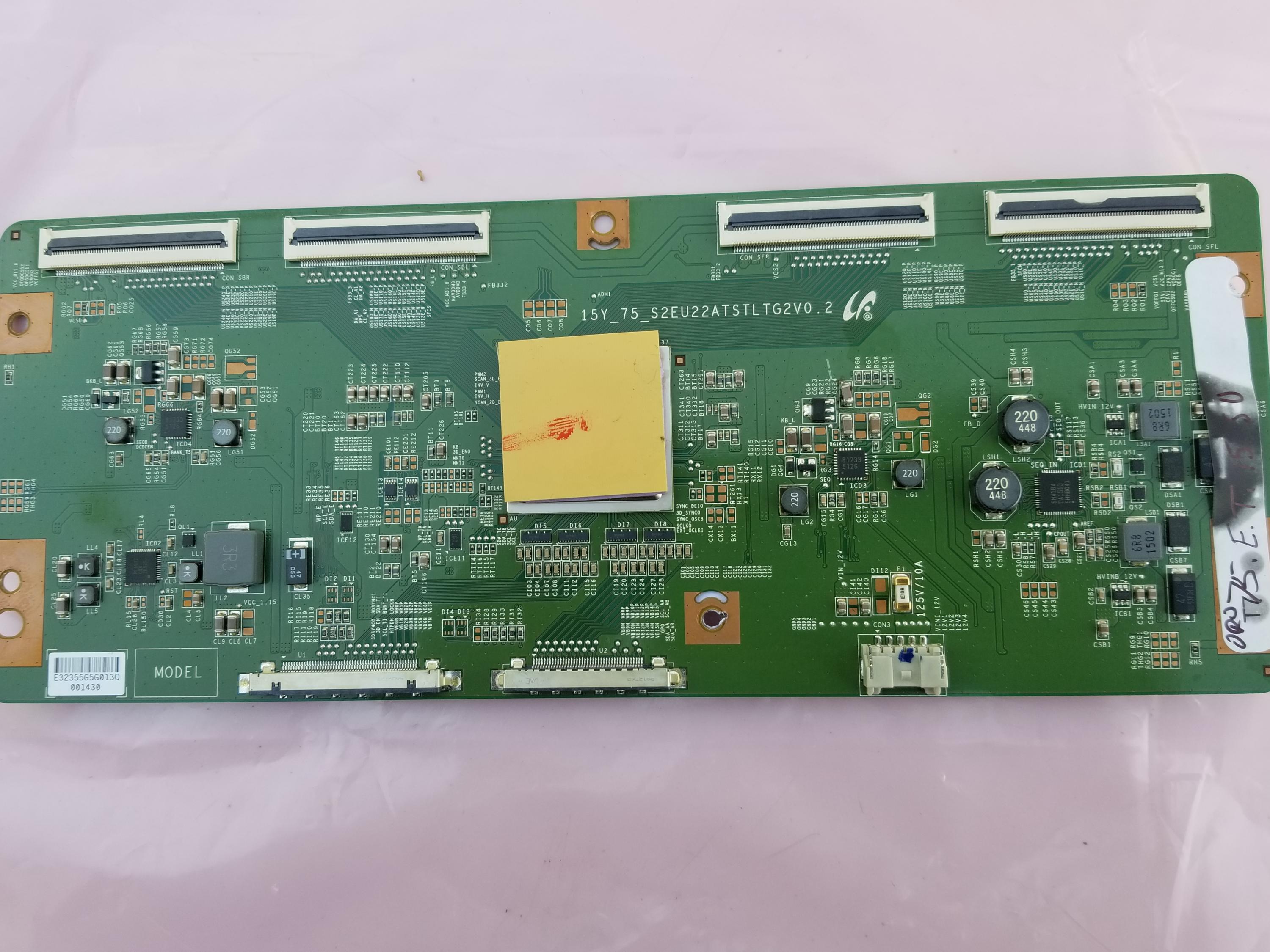

                    #69
                    Here are better hi res photos of my board. Ignore CG9, I took it off and resoldered it in testing, but I didn't do a good job keeping it straight.

                      #70
                      Originally posted by Davi.p
                      But it don't helps you! :-J
                      It may help because I have one in my possession putting out all the proper voltages and it uses the same regulators as the Sony board.
                      LVDS inputs are a different clamp style But outputs are identical to my panel

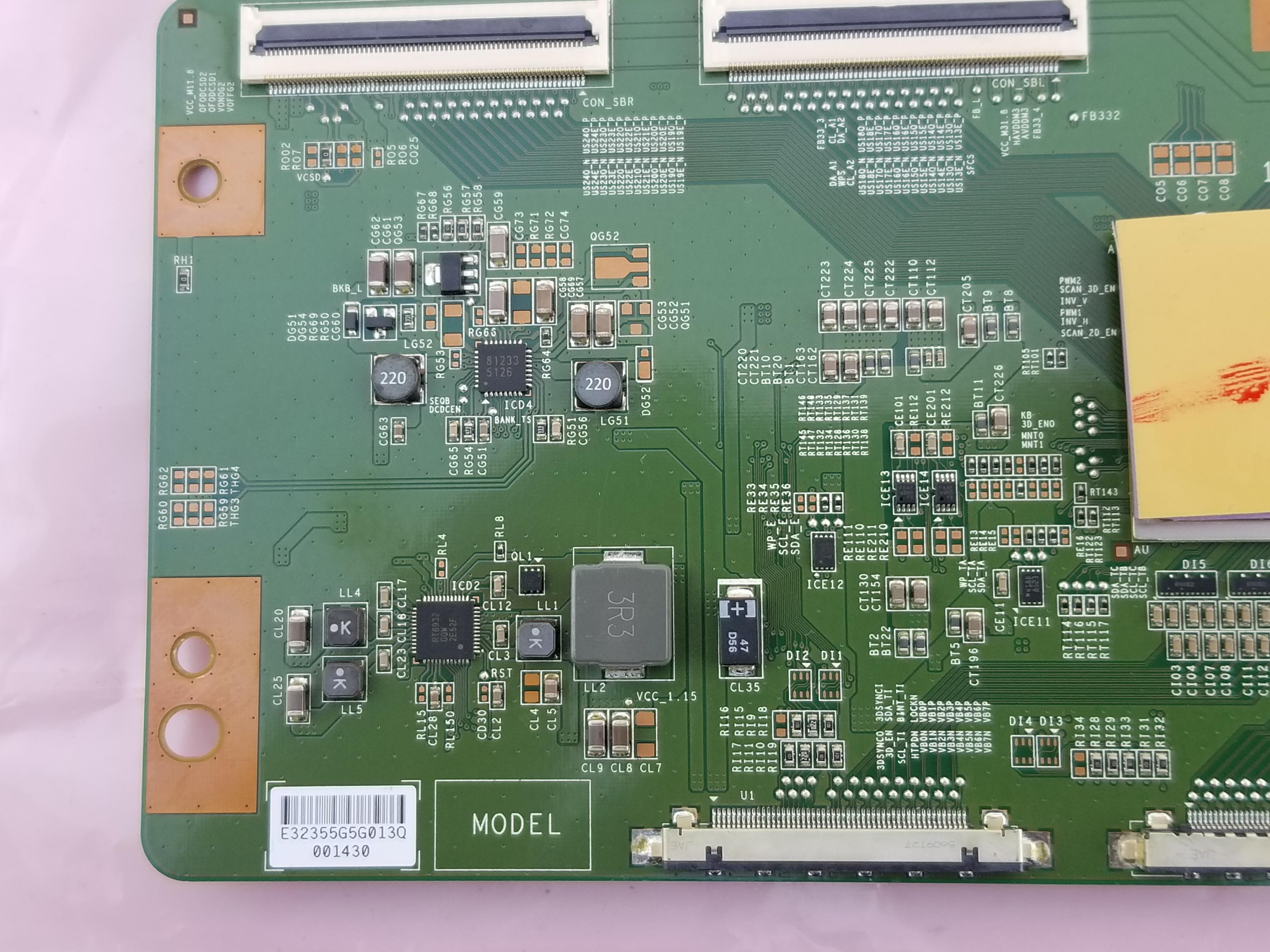

                          #72
                          First of all i wanna make sure you are checking the right places, VON it is measured on the cathode of DG51 (left upper area, 2nd photo), VOFF probably on the CG52-3 or CG57-8 (same area), VON and VOFF are repeated on the last photo (same chip type), VON on cathode of DG1, VOFF on CG7-8. AVDD is formed by the power components in parallel (A-B) QS1-2, LSA1-B1, DSA1-B1, CSA7-B7, with the switches ICA1-B1 that feeds VIN12v to those DC-DC boost. AVDD is measured on CSA7-B7. You have to test those points in volt, and if no volt check all the diodes,mosfets,bjts. IF the protection is shutting down at powerup, if you have followed my big Sony journey, you can search for a timing cap, much probably CS36 that is the smaller, it has to be small.. you can cross your fingers and short it for 1-2secs or more at powerup and see if something warms up too much or the tensions come out... good luck..

                              #74
                              On CHS1-2 and CSH3-4 you have to find probably 3,3v
                              • freakaftr8
                                • Oct 2012
                                • 3743
                                #75
                                All those test points are dead except CS36 is the 5v in. I took a gamble and tried shorting that cap anyway. Nothing does far in for some reason this doesn't even have an effect on the bucking regulators for the 1.1v ICD2, This area seems to be unaffected by anything that I do. of course this runs the core voltage for the CPU
                                • freakaftr8
                                  • Oct 2012
                                  • 3743
                                  #76
                                  ChS1 and 2 are bothh dead also. They do come alive when I inject 16v into HVDD But this is backfeeding and not really affecting ICD1 or ICD3.

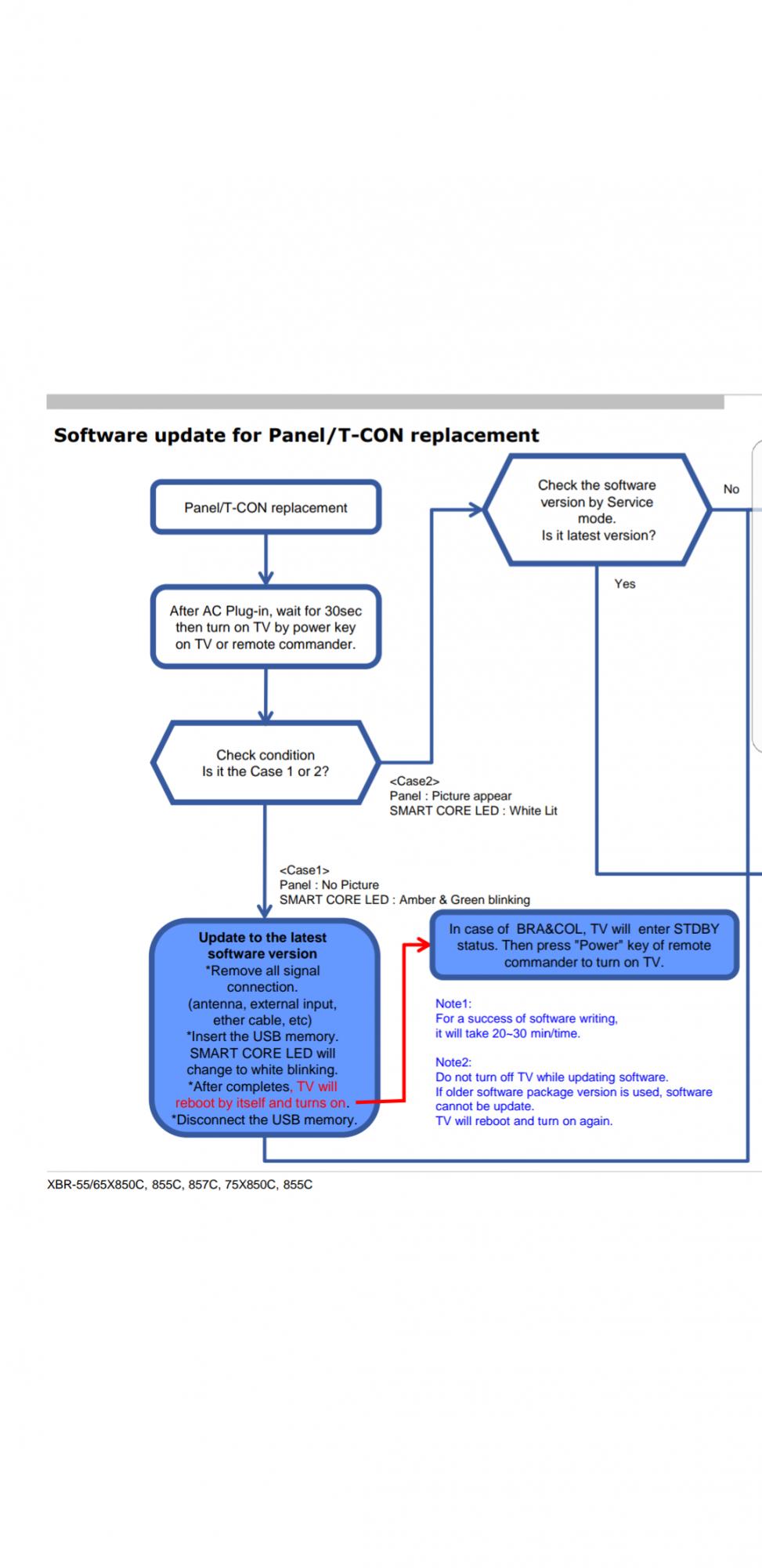

                                      • will62
                                        • Dec 2016
                                        • 229
                                        • usa
                                        #79
                                        Hey freak, do you have this already?
                                        https://www.manualslib.com/download/...r-55x850c.html
                                        • freakaftr8
                                          • Oct 2012
                                          • 3743
                                          #80
                                          Wow no I didn't! Thank you!
                                          Interesting read here. Wonder how the mainboard mutes the picture when firmware needs upgrade to new tcon/panel?
