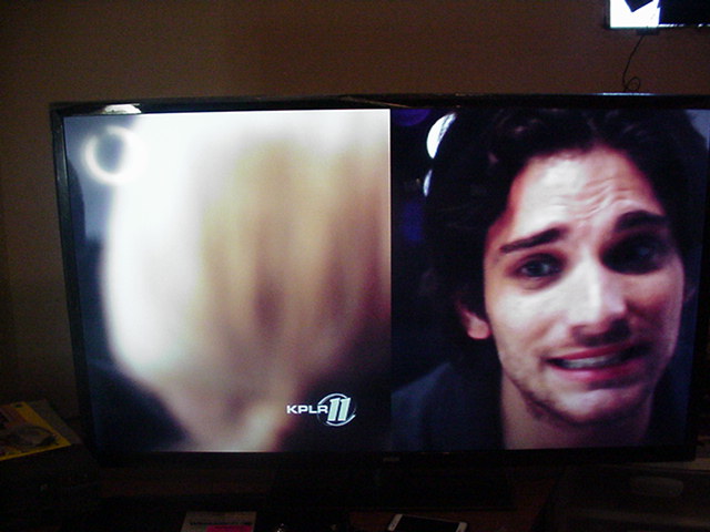

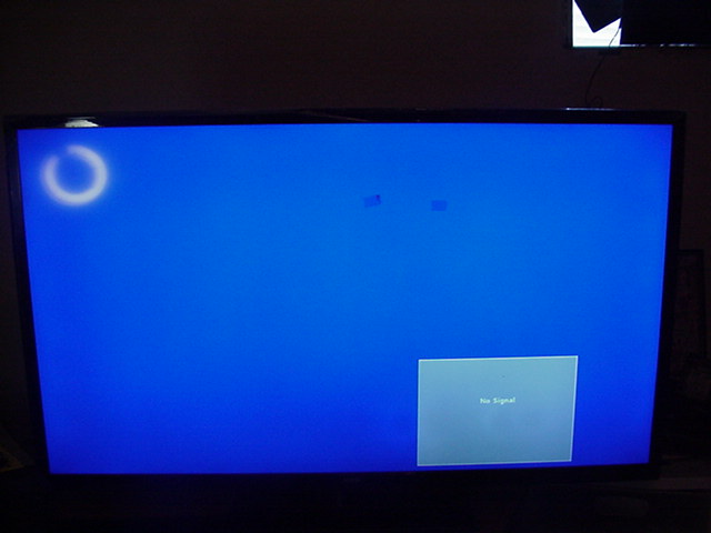

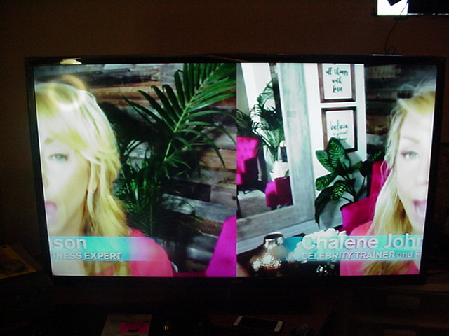

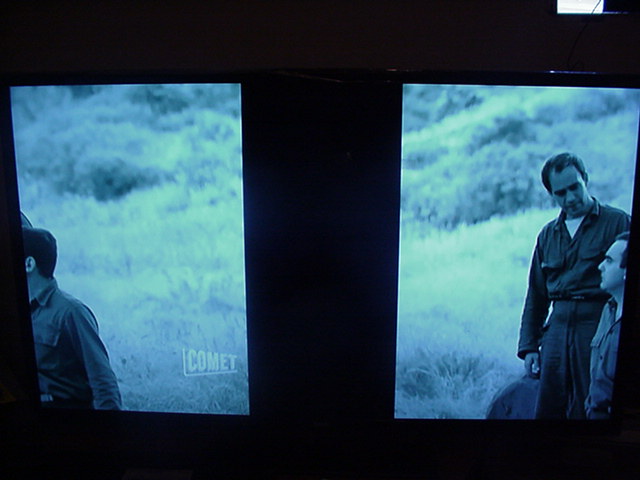

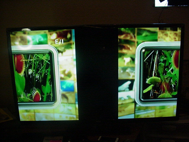

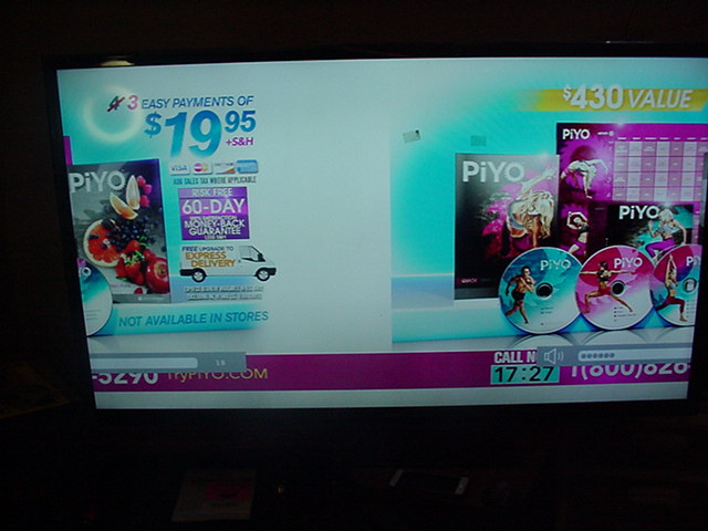

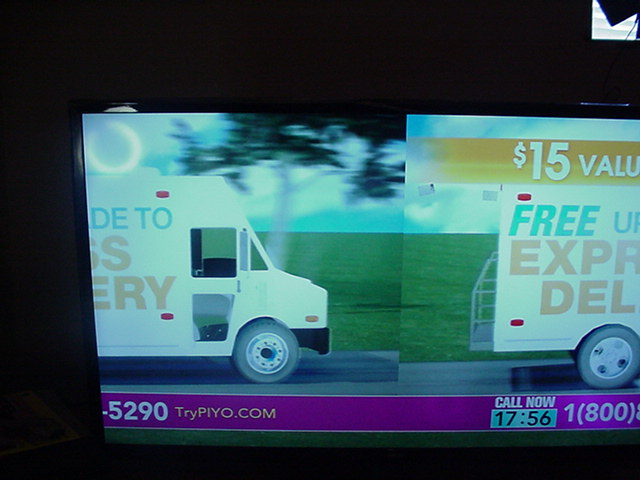

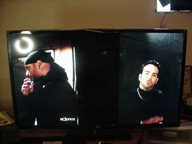

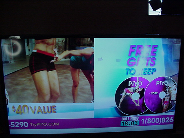

    RCA LED55C55R120Q picture is backwards(left side and right side swapped?)otherwise has clear picture. I have attached pics .If you look closely there is a thin line dead center of screen . HELP!!

    Re: Rca picture in half??
    Mainboard issue. Possible eeprom related.

      Has it been worked on?
        main board from another size set?
          Replaced led strips. swapped all boards ,Is there an eeprom update? Can the screen layers cause a problerm? Thanks for the input!
            Are ribbon cables to panel correct?
              Seems to be connected properly

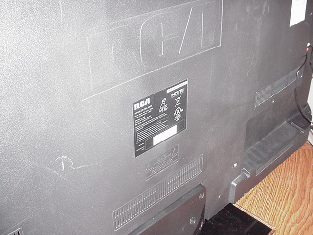

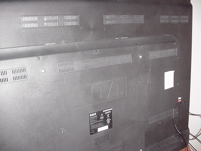

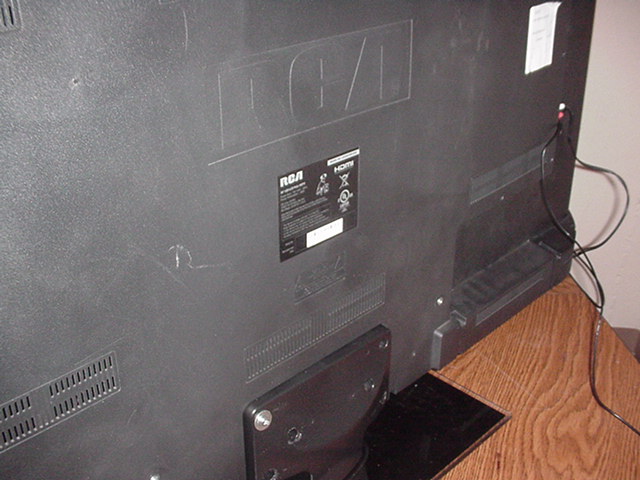

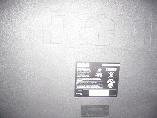

                Got pictures of back of tv?
                • parkerc
                  • Jun 2014
                  • 17
                  • usa
                  Here they are??
                  • parkerc
                    • Jun 2014
                    • 17
                    • usa
                    Is there a firmware upgrade for this TV??
                      Pssh!
                      Its the fricken Zebra cable connecting the very last wire to the LCD panel-The thin cable soldered directly to the glass panel.
                      Try pushing lightly on the plastic bezel under the missing line. Does it get better?
                      Try pushing lightly on the LCD panel. Does it get worse?
                      You'll probably have to actually lay it on its back and remove the bezel around the screen, then push very lightly on the very thin and delicate flat cable connecting the TConn to the LCD. A rubber eraser may be helpful. If it goes away then the solder joints have separated. The only way to fix it is to use a hot air gun or soldering iron to reattach them while pushing down lightly, gently and carefully(basically on the edge of the glass!). Silicon would be helpful here.
                      This sort of job is best left to an experienced professional. the manufacturer uses a long tool that pushes down and heats up the solder.

                        Originally posted by parkerc
                        Here they are??
                        I think the "other guy" was asking for pictures of the back of the set WITH the back cover removed.... :-) so he can see what's happening with the cabling.
                            Oh, HAHAHAHA. NEVERMIND! I should have clicked on the photos. I thought it was just a black line!
                              kinda looks looks like the transmission is set to sbs 3d mode... are you sure the lcd panel tcon cables werent installed backwards somehow?? that or its set to a different panel type in diagnostics.those rca branded sets use the same main baord numbers for many different model tvs with different firmware and sometimes hardware... I had a 50" I repaired give me grief because a seller of the replacement mainboard made and assumption and sold me the wrong board.... you have to be sure the serial number range matches the part number for the board and not just the number printed on the board itself.

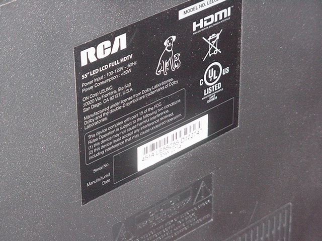

                                Here they are??
                                Is this a joke? Come on man these pictures are useless.. You didnt even get the model number it the one legible pic...
