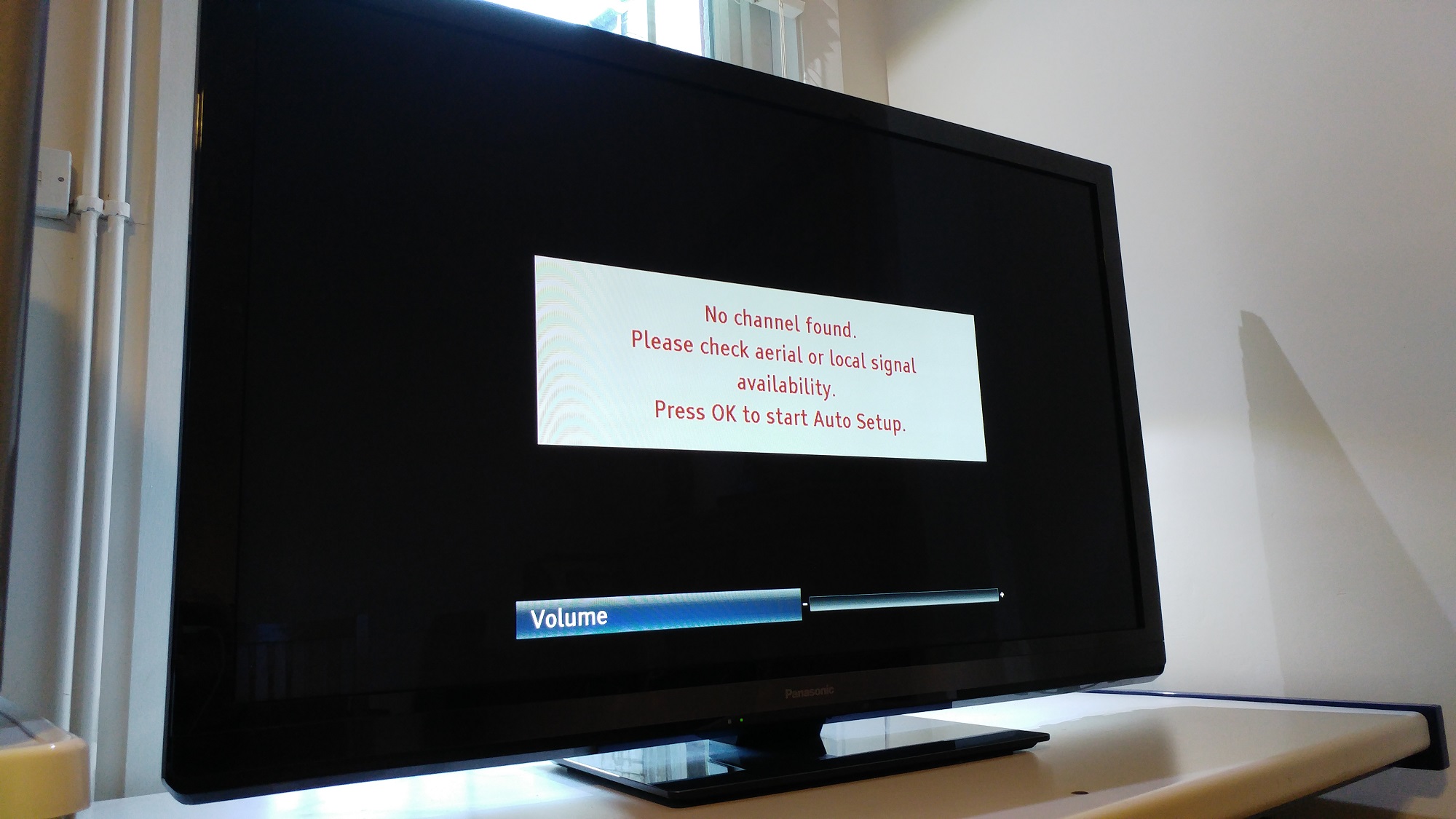

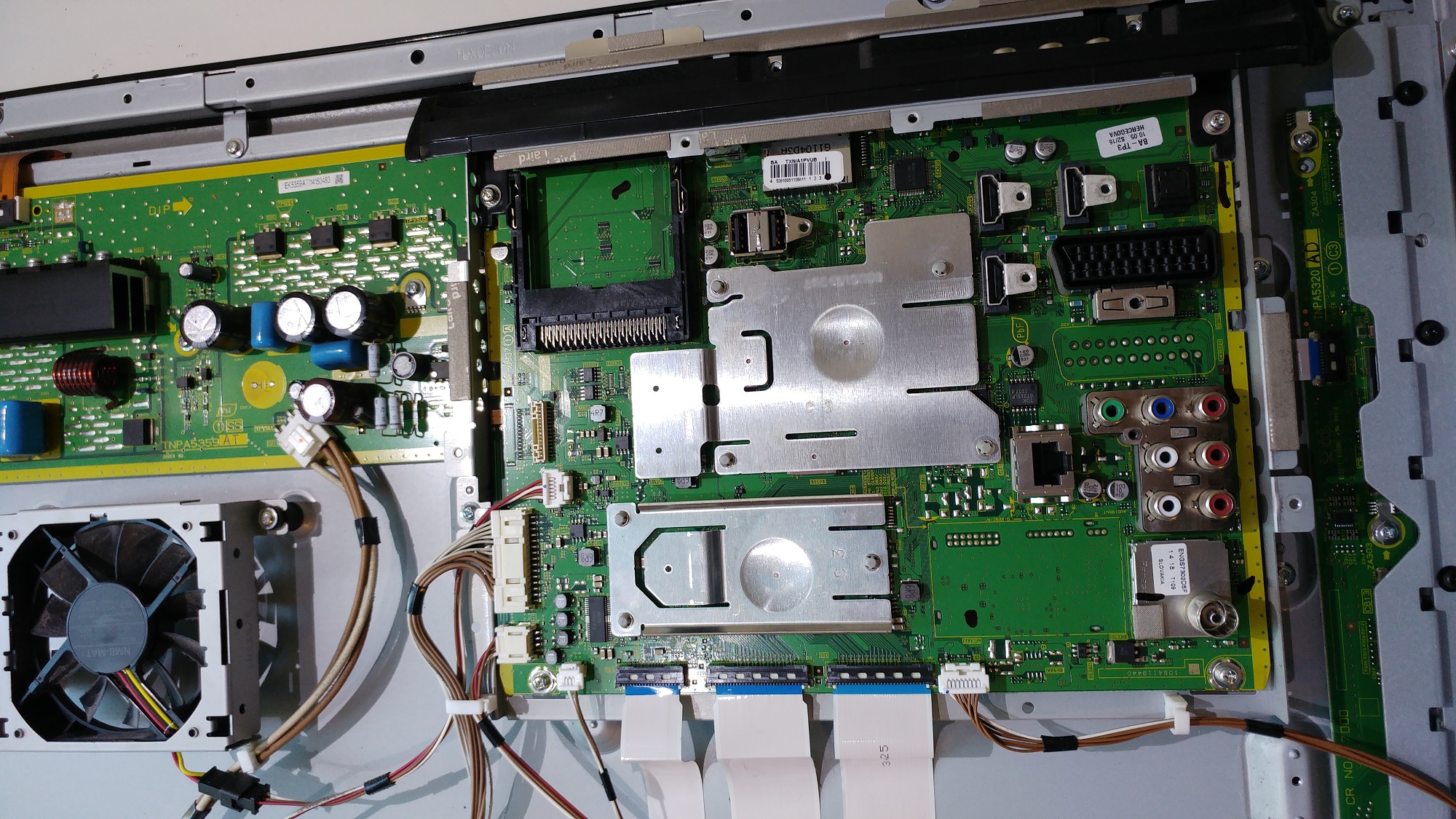

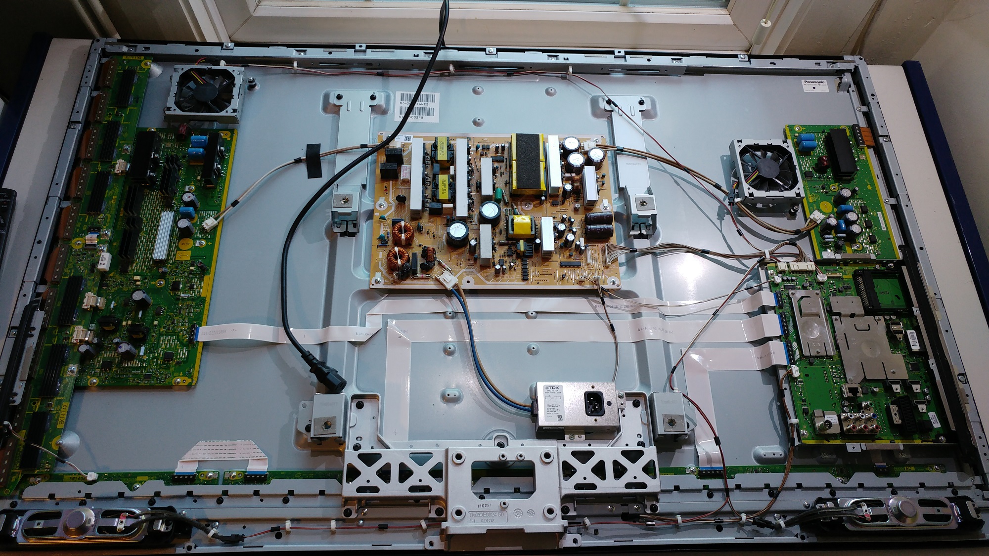

    Hi, After I fixed the tv had the 7 red Blinks . In my case was a shorted upper buffer board TNPA5336.
    I just put the tv together and I have noticed the volume not working .
    If I press the volume up/down button from remote nothing happening .
    I checked with a headphone and I have sound .
    Main board is TXN/A1PVUB ,Any help would be much appreciated !!! Thanks

    Re: Panasonic TX-P50G30B No Sound, Picture OK
    Check your speaker connection, they could have broken off the board. If the H/phones work then the Audio circuits are OK.

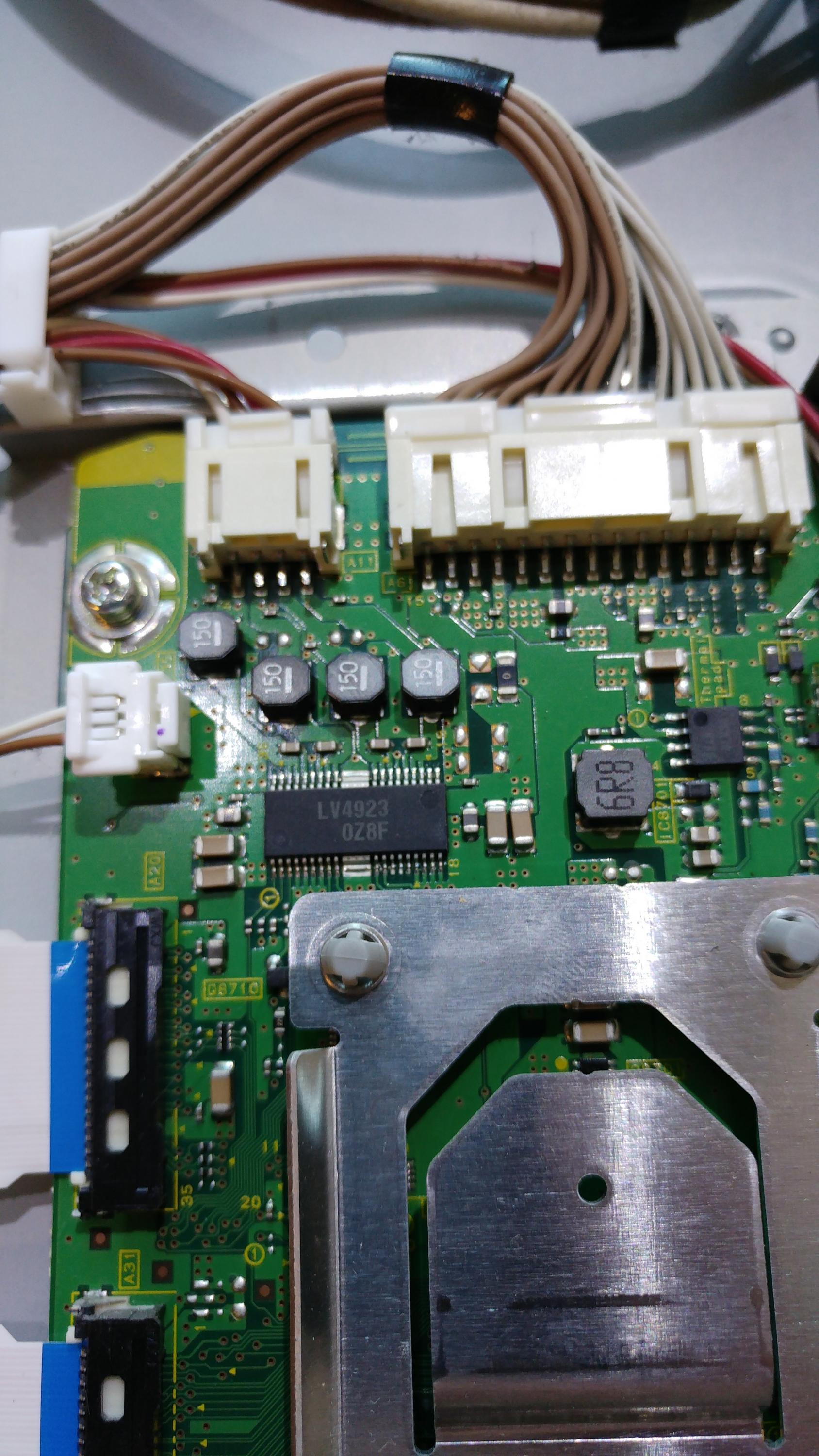

      I have checked the speaker connectors and the speakers and they are working fine.
      I have noticed that the line for the volume is not getting that green colour when is pressed.
      Could be something with the software? I have checked and has the latest. I already factory reset it and the same.
      Could be something from the service menu?
      • matyka
        • Jan 2015
        • 179
        • Uk
        hello, the fix in my case was Access the secretive hotel mode.
        To access it on my particular version I had to hold down the -/V button on the side of the TV and press “AV” on the remote three times.
        A menu then pops up providing access to a few settings including a maximum volume etc. Off hotel mode and tv sound is back .
