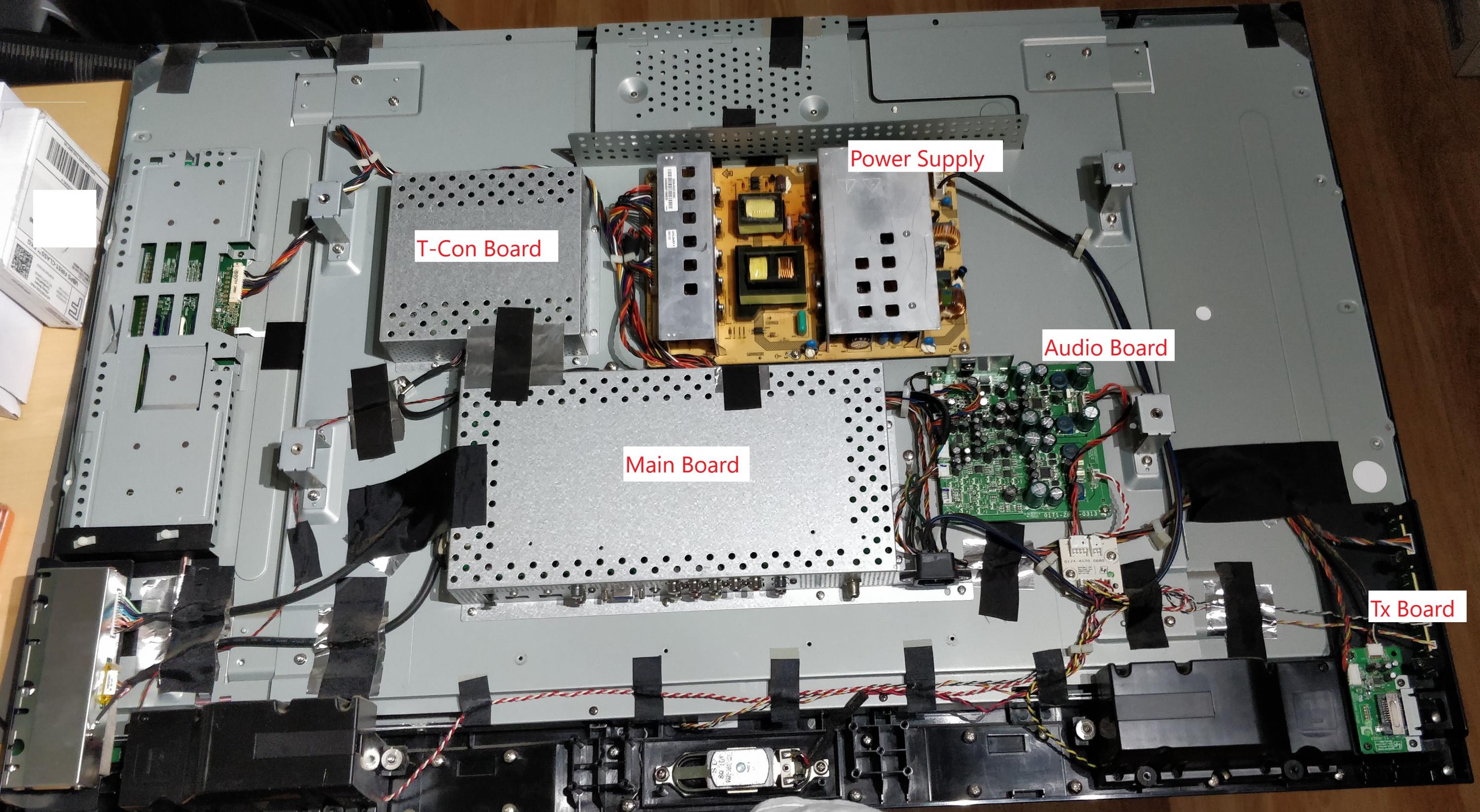

              Re: Vizio SV420XVT1A no sound
              Can we at least see the pictures of the whole backside of the TV showing all the boards?
              Dose it have RCA Audio line out jacks (Red and White jacks) that you can connected to powered speakers to see if you do get sound or not?
              Does it have headphone jack?
              • sawickipeter
                • May 2010
                • 7

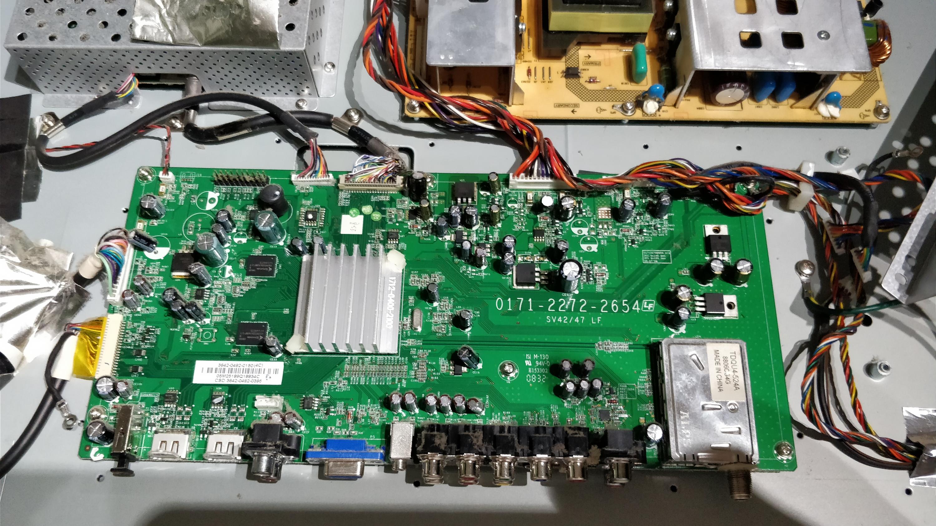

                Attached are pictures of the boards. The square board is the audio board. The rectangular is the main board. This TV has RCA audio output jacks but I do not have any device i can plug into it to test. Unfortunately there are no headphone audio jacks on this unit either.
                  SOLUTION, to anyone reading with this problem. The main board may have a bad 630UF capacitor its the biggest one one the board. Set the analog output to variable on the tv menu. On the main board u will notice a 4 pin output on the audio out section. Take the cord running to the sd card, that is the same size, (it runs to the separate audio board) Hook that cable to the 4 pin audio test port next above the audio out. The sound will now work. You will loose whatever the SD thing does but that looks useless anyway so i dont it will be missed. The sound will now work.
                  • PeterKiryluk
                    • Feb 2013
                    • 4
                    Correction NOT ALL THE CONNECTIONS ONLY THE BROWN WIRE. out of the 4
                    • T33
                      • Apr 2021
                      hi, i just joined and have seen the pics. i dont have a background in this and yes i know i dont have any business insid the tv but......it's all discontinued now so i need to fix it. now then what/where is the sd card? what/where is the test port? maybe point these out on the pic? thanks
