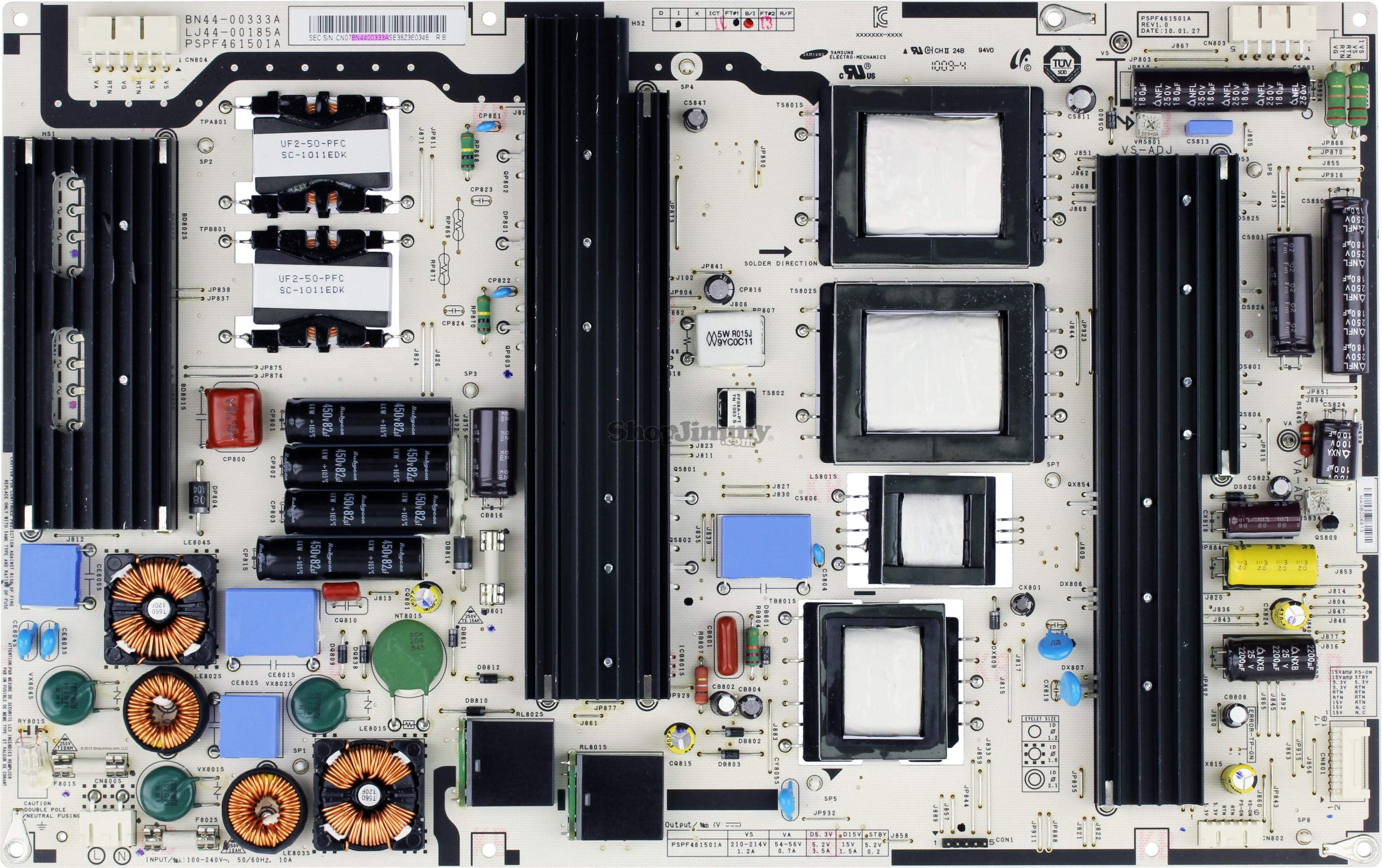

    Need Help in Learning
    I would like to test the board (BN 44-00333A). I have a few questions regarding reading label on connector CN801 (SMPS to Main board).
    Label
    15V PS-ON
    15V STBY
    5.3V 5.3V
    5.3V RTN
    RTN RTN
    15V RTN
    15V NC
    15V NC
    Question: 1 – The voltages given in the left column. Are these the voltages when the TV is in ON position and the voltages on right column, when the TV is in standby positon or it is something else?
    Would you explain the followings?
    PIN 3 from top: 5.3V 5.3V
    PIN 8 from tip: 15V NC
    Question 2: From my research, the STBY voltage is 5V. However, on (BN 44-00333A) it is 15V. Is it correct?
    Question 3: Self testing SMPS
    It requires the followings modifications on CN 802 (SMPS to Logic Board)
    a) Use jumper cable, connect PS-ON pin with RTN pin.
    b) Similarly, connect pin VS-ON with pin STBY5V. In my case STBY is 15 volts. Do I have to use pin (15 V STBY) or I have to use some other pin with 5 volts.
    c) Read voltages on SMPS.
    Thank you.

    There are two rows of pins on that connector
    IE: pin 17 = 15vamp pin 18 = PS-ON
    pin 15 = 15Vamp pin 16 = STBY
    pin 13 = 5.3V pin 14 = 5.3v
    pin 11 = 5.3v pin 12 = RTN
    etc
    stby would be +5 volts
    NC means No Connection
    RTN return or ground
    If the power supply board has pull up resistors for the pS-ON then unpluging the connector to the main board would turn the power supply on. If it does'nt then with the mainboard plug disconnected, put about a 1K resistor between PS-ON and STBY +5

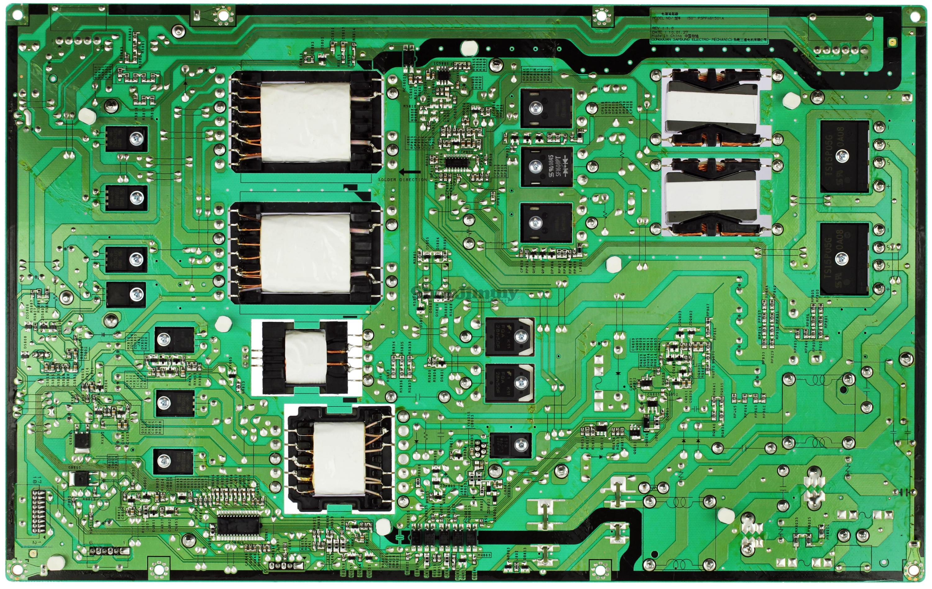

      Re: Smps (bn 44-000333a)
      The connector CN801 has ODD Column pins which you can see and probe from the tops side of the board, the EVEN Column pins you will have to probe from the back side of the connector where the wires go in or flip the board over to get to the even pins.
      The label for each pins show what their functions are.
      If you look at the print you will see that
      The ODD column pins are:
      Pin 1, 3, 5 are 15V
      Pin 7, 9 =GND return
      Pin 11, 13 = 5.3V
      Pin 17, 15 are for 15V amp
      The EVEN Column pins are as shown on the print, I.E. Pin 18 = PS-ON
      The power supply board will have Standby Voltages, Switched Voltages, the Command Voltages. So you will to learn what the Voltages are on how the board functions.
      Pictures provided by Shopjimmy.
