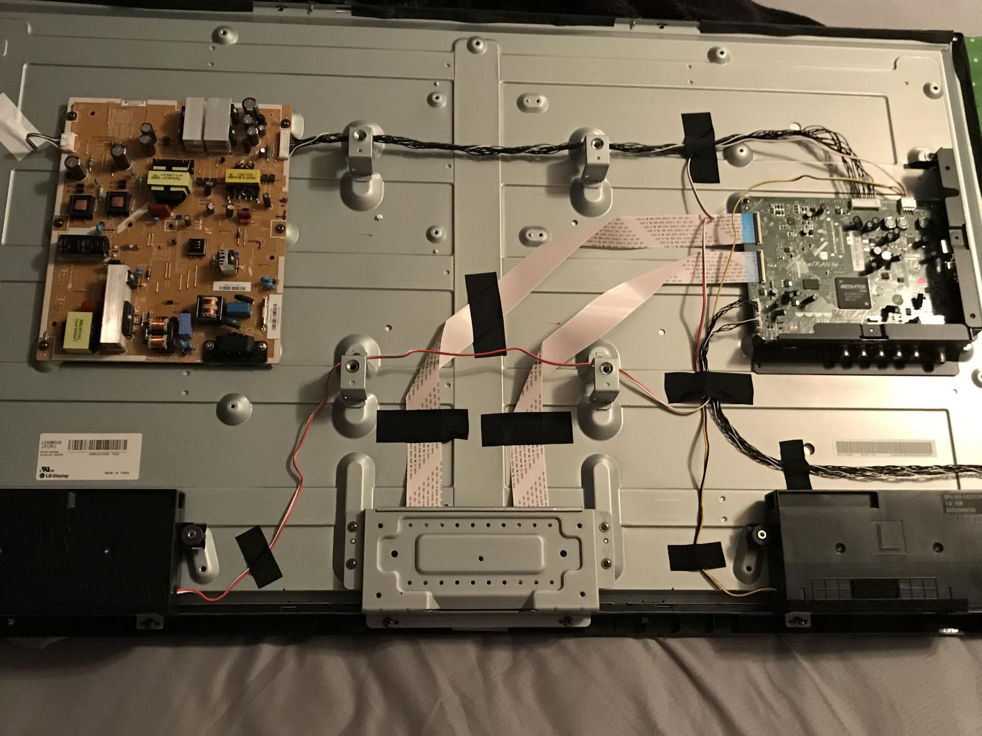

    1) We need pin names follow by the Voltage reading for each pin.Without the name those readings you report mean nothing.
    2) We need good clear pictures of the boards and how all the boards are connected together.
    3) We do not have the TV in front of us to look at so the more details you provide the more helps and correct information you will receive.

        Re: Bad main board or power supply? Vizio E420-a0

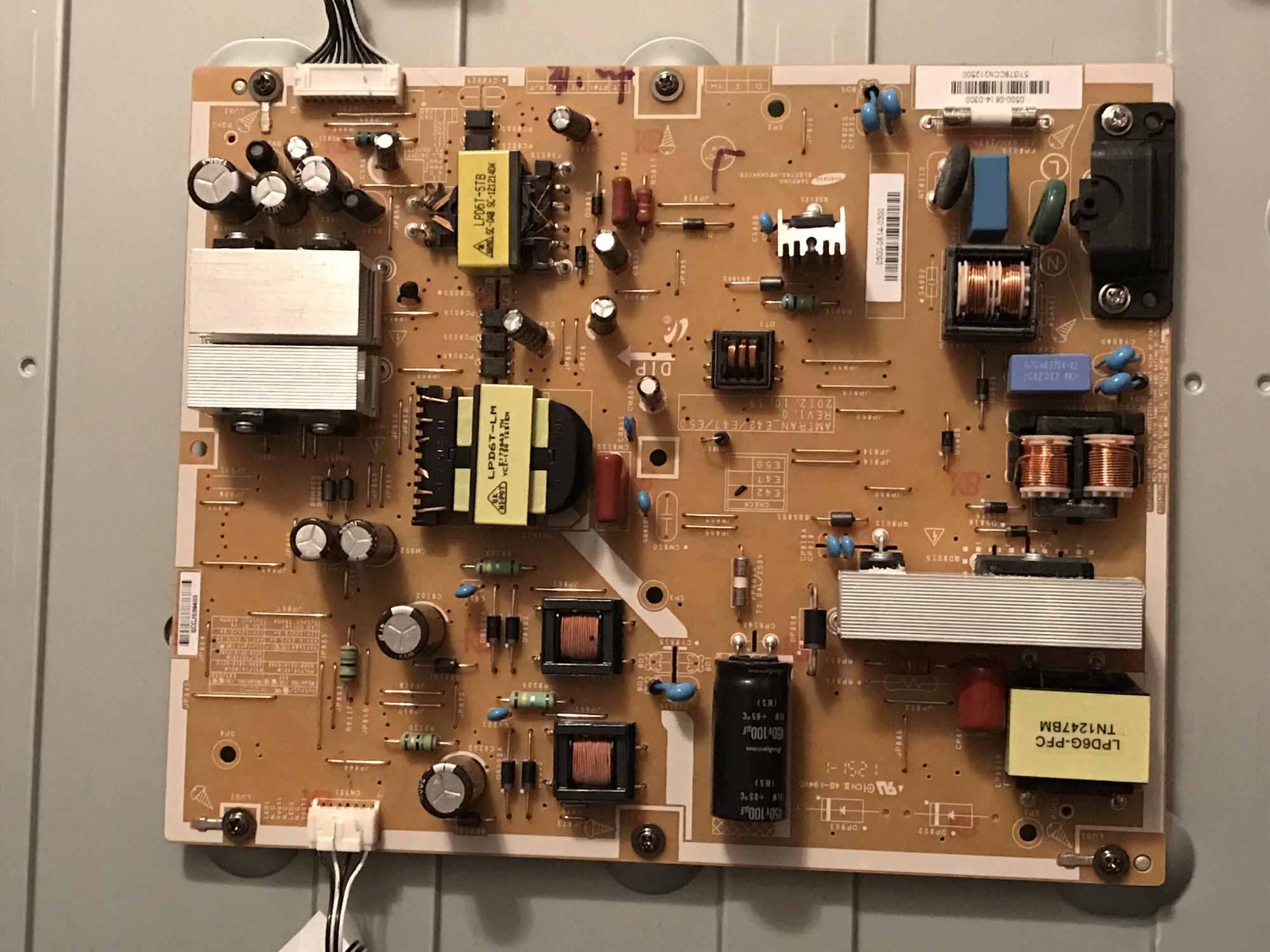

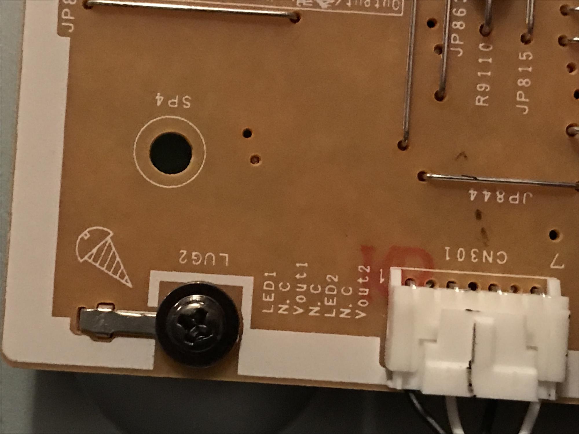

        Okay I have attached pictures and here are the pins names with voltage.
        CN301 both on and off
        Led1 zero vdc
        Vout1 zero vdc
        Led2 zero vdc
        Vout2 zero vdc

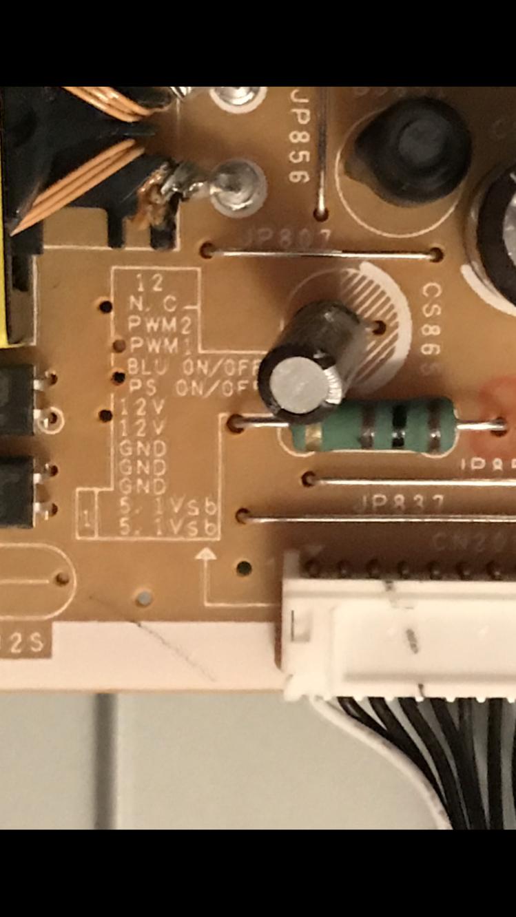

        CN201 both on and off
        5. 1vsb =5.3vdc
        5. 1vsb=5.3vdc
        Gnd = zero
        Gnd = zero
        Gnd = zero
        12v = 0.15vdc
        12v = 0.15vdc
        Ps on/off = zero
        Blu on/off= zero
        Pwm 1 = 1.8vdc
        Pwm 2= 1.8vdc
        N.C = zero

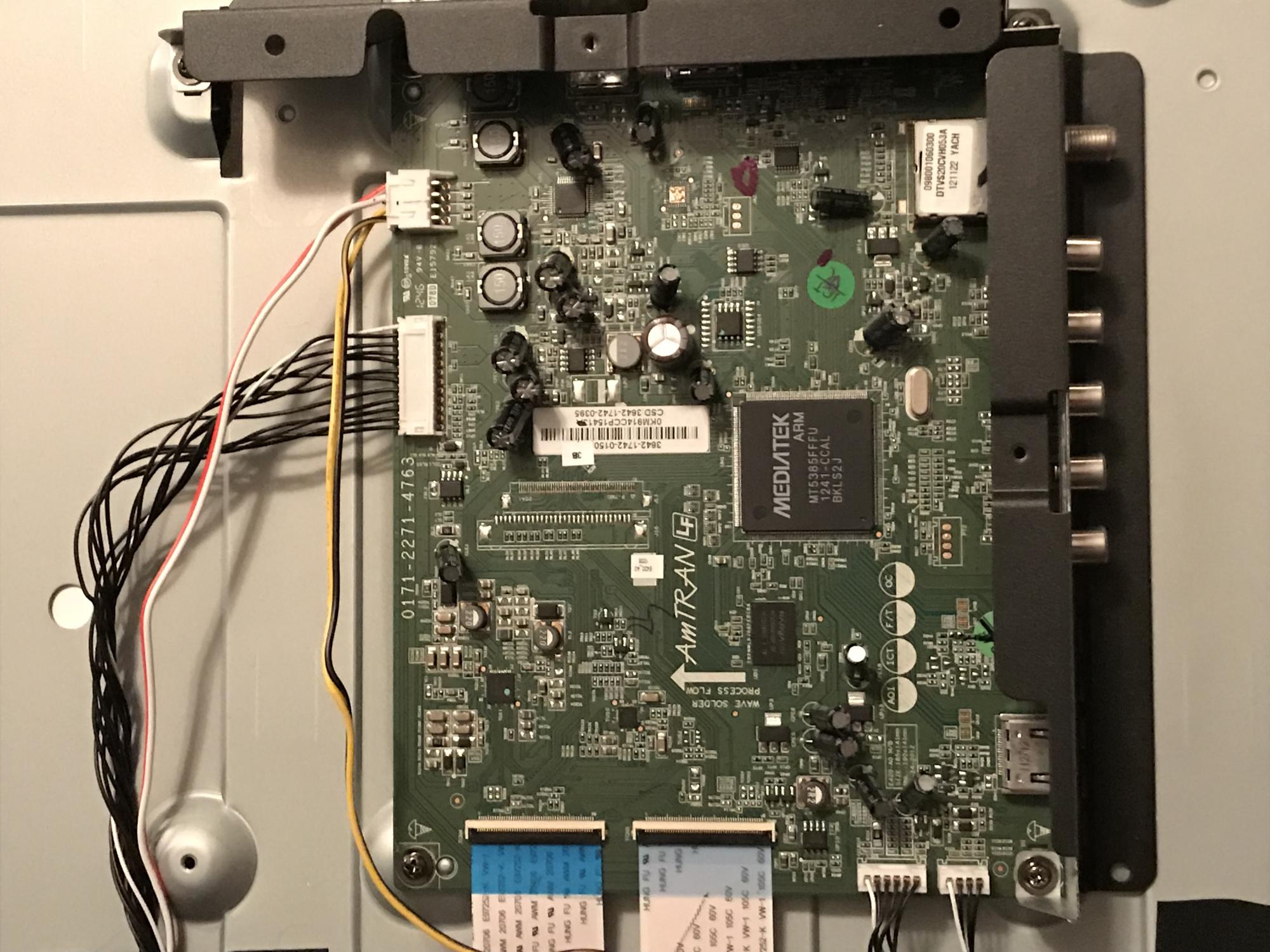

          Ps on/off = zero
          Blu on/off= zero
          The main board is not sending the PS-ON to turn on the rest of the power supply, it also does not send the BL-ON ti turn on the backlighst circuits.
          Go to shopjimmy.com to see if there is EEPROM that will fix this symptom or not.
              Have you tried freezing the EEPROM with a can of air upside down, then plug the tv in and turn it on?
                      Quick update I believe you were correct it was the EEPROM chip. TVs up and running !!!! Thank you all for your help. ��������
