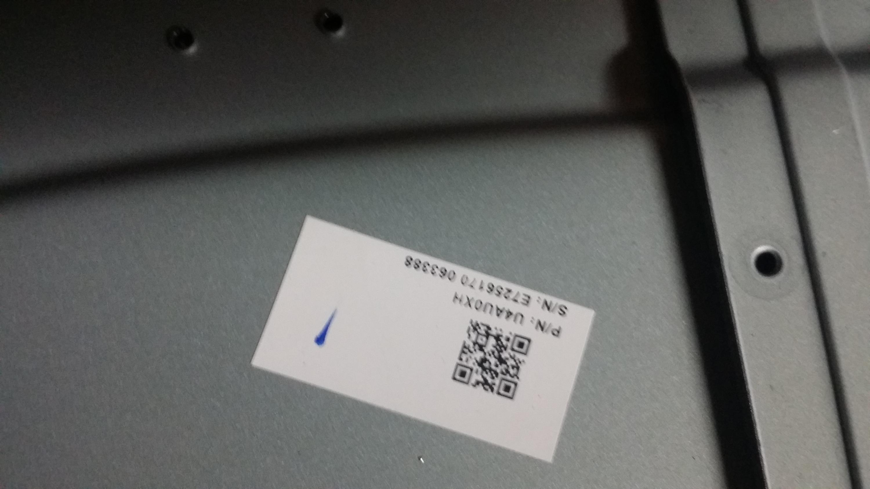

                    • heavymachines
                      • Mar 2011
                      • 1028
                      Re: Mangavox 50ME314V/F7 "Funai junk"
                      panel sticker is....
                      P/N: U4AUOXH
                      S/N: E7256170 063388
                      power board stickers are as follows
                      BARCODE
                      14112P01A
                      A4GU6-MPW
                      E7255590
                      STICKER
                      A4GU6MPW C
                      7255590
                          I do not need the LCD panel sticker.
                          So is there chassis number on the model sticker? I.E. FL?????
                          Can we see the picture of model number sticker?

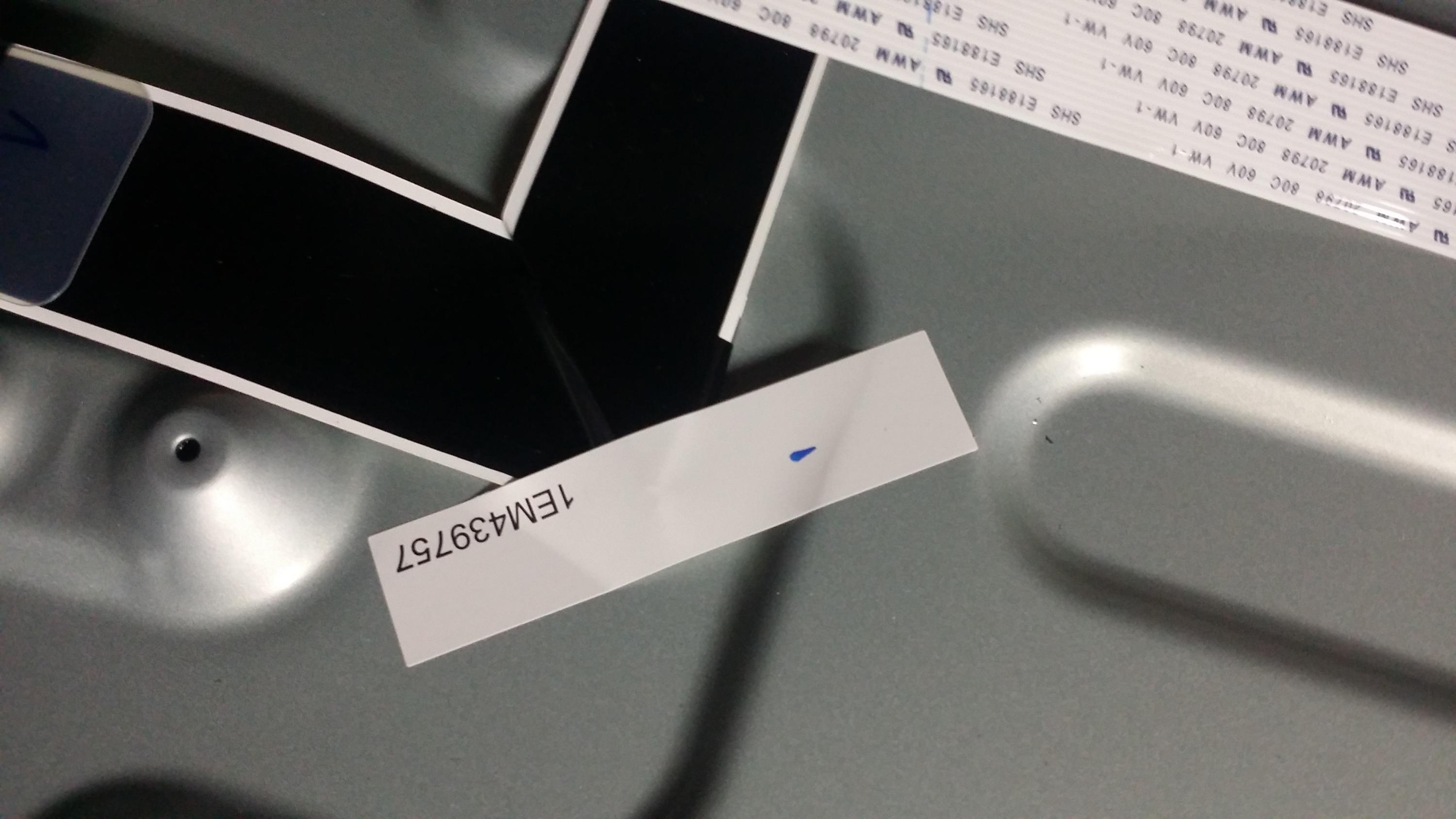

                            Not that i see, but here i took pics of everything i could find on this beast.
                            oops just noticed some pics are flipped but readable.
                            i included main stickers as well in case we need it later
