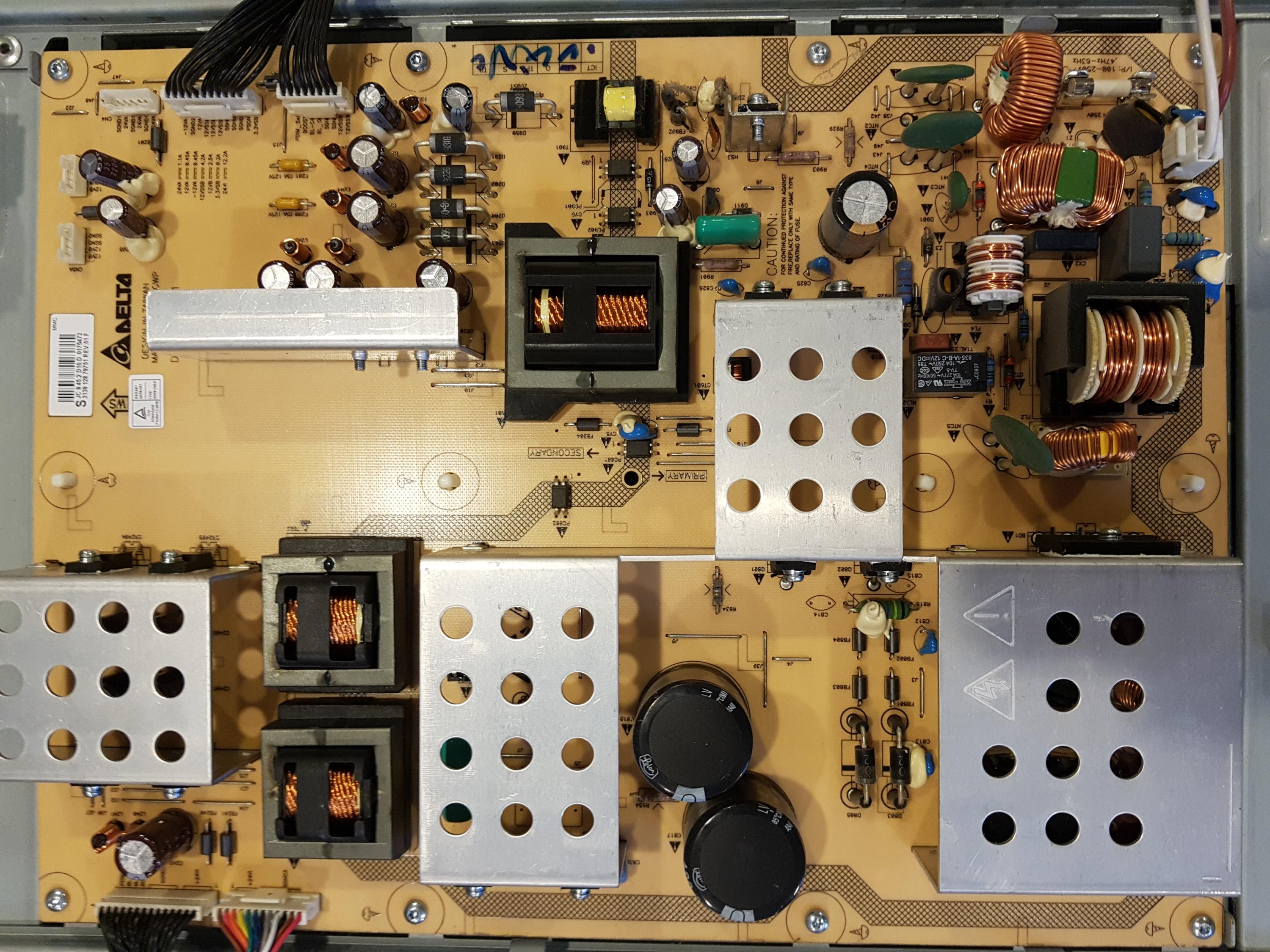

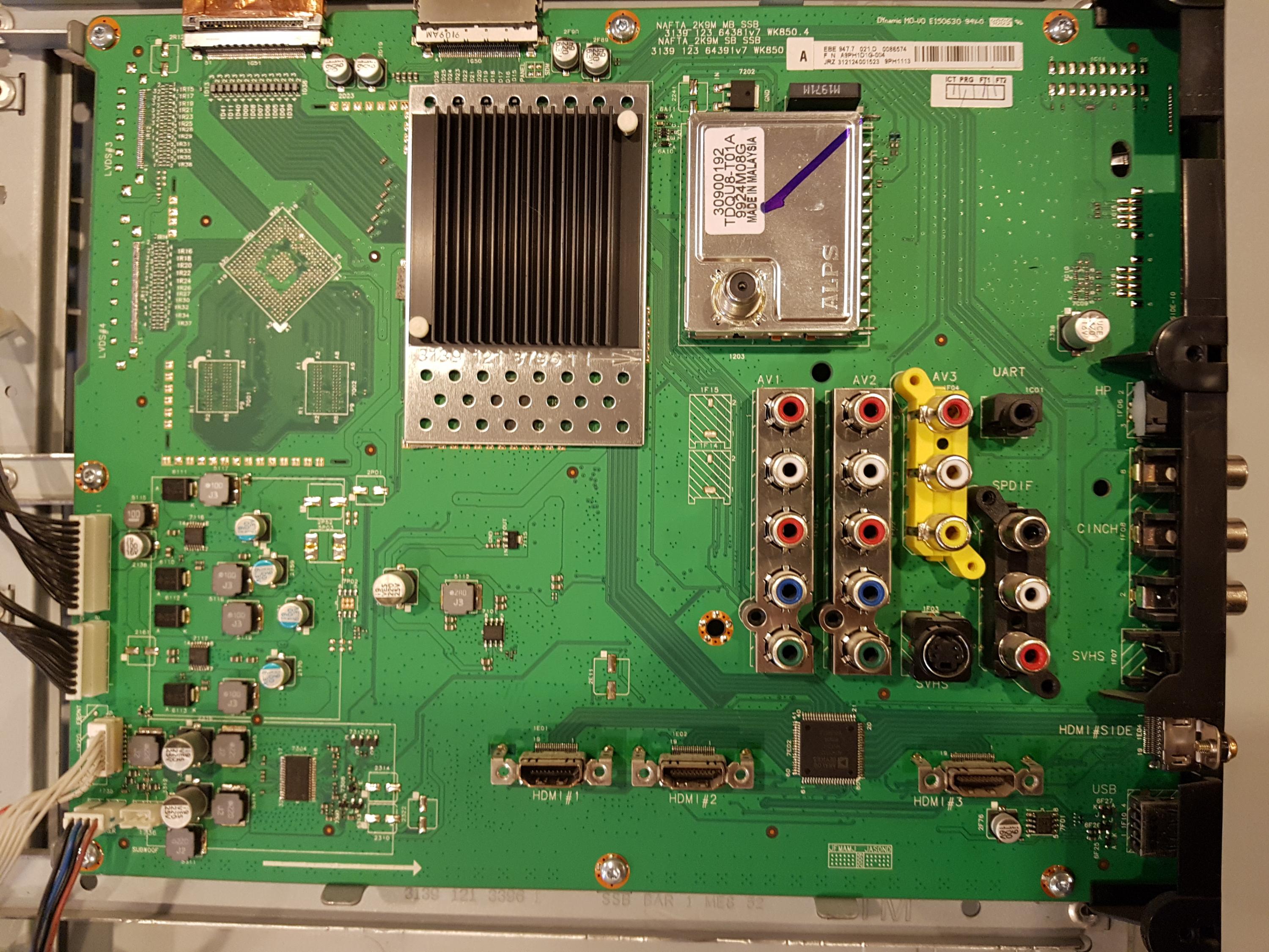

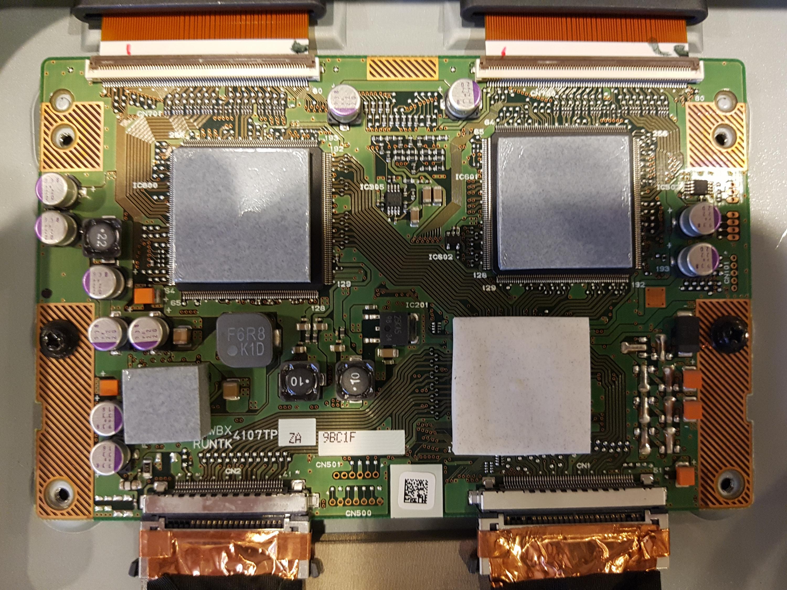

                      Sorry for the delayed reply. By day I am a teacher, who just got through a very busy part of the year. Now I have some time again to try to diagnose and repair, if you'd be so kind as to offer some help .
                      I've attached pictures of the main board, power supply, and tcon board. What is the next logical step?

                        Re: Philips 52PFL5704D/F7--backlight, no picture
                        next thing to do is check that you have 12 volt on the t-con fuse. it is on the bottom left.

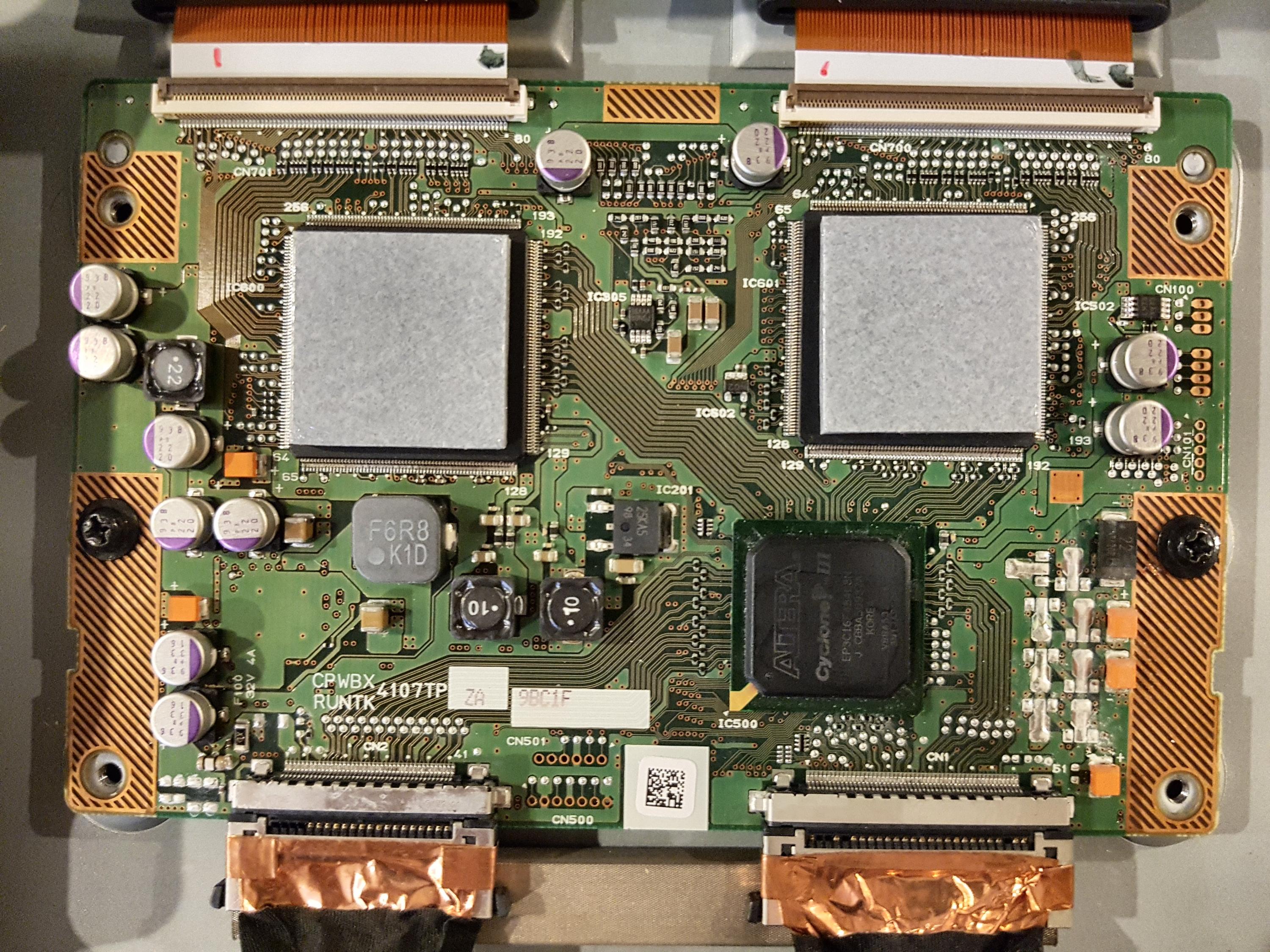

                          The tcon photo is the only one needed but need to be re done, without your shadow on.. and remove those 2 bottom silicon pads.
                          If you want to go ahead you can modify the photo with adding of each electrolytic voltage.
                            Hopefully this photo is sufficient. Poor lighting in my basement .
                                Do you see those silver cylinders? Them are electrolytic capacitor (EL.CO.) , test the voltage on them (purple band is the negative) and report measurements on the picture using Windows Paint or other SW..
