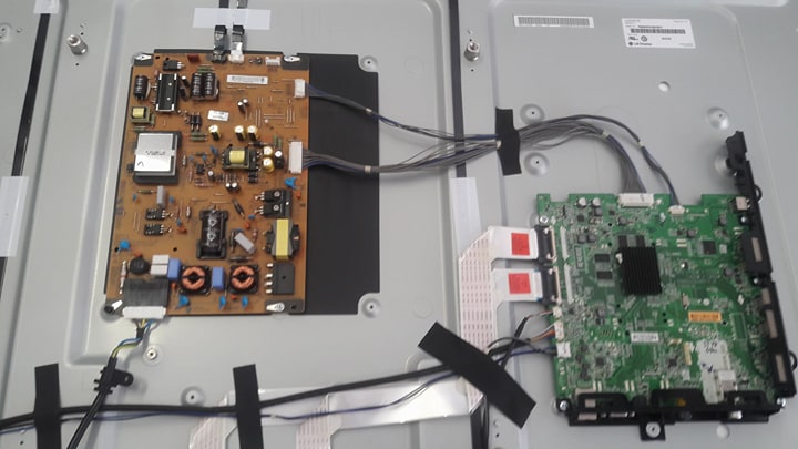

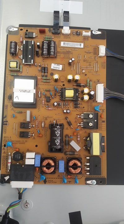

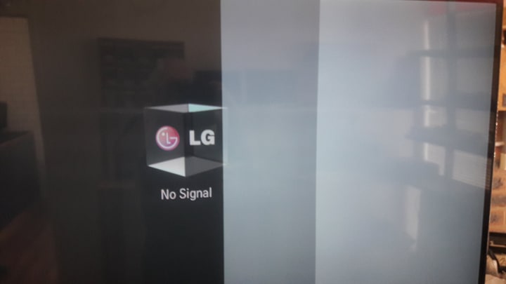

    I have an issue with vertical segments on the screen from the right side through to centre. Have checked all voltage settings on power board nd have come back with correct pin settings. From the main board there are 2 lvds cables from main board to the base of the set connecting to 2 individual inverter boards. Trying to locate possible replacement boards, but can not locate or find these items. any help would be appreciated.

    Pictures of problem would help

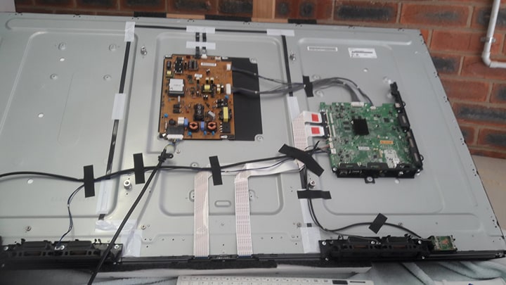

      Please find attached photos of tv

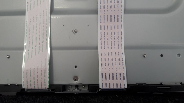

        Re: Lg 55lm6410-tb
        I would check my cables from main board to panel. Don't look like they are seated correctly

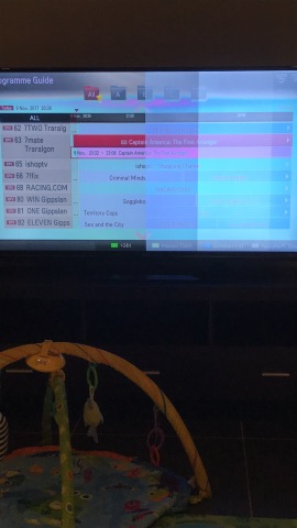

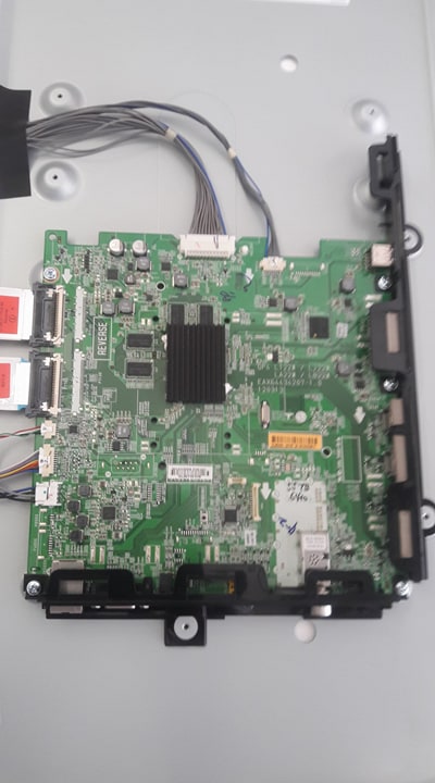

          Ok checked LVDS cables are seated correctly i even took them out and did the beep continuty test to make sure no breaks i even swaped the LVDS cables from leftto right to see if it changed still fault remains in same postion
          here is another pic of symptom
          do you think it will be the main board fault
          because i dont want to pay $200 for a main board if this is not the issue
          any help or advice to confirm the main board
          cheers
          Wayne
            Re: Lg 55lm6410-tb
            You have the tab bonding board/T-CON on the bottom edge of the TV, these boards get damaged a lot due to cleaning liquid seeps on to the board and eats away traces and causes corrosion. I would also check the resistance of all MLCC on the board.
